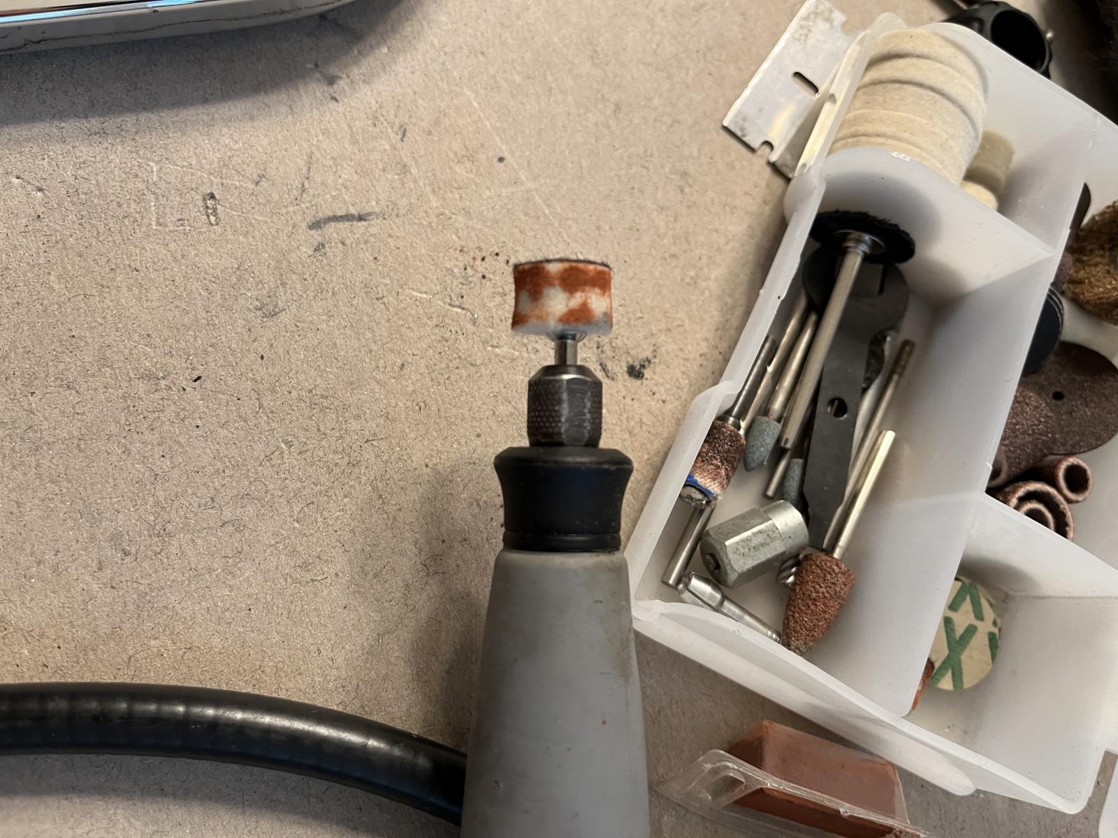

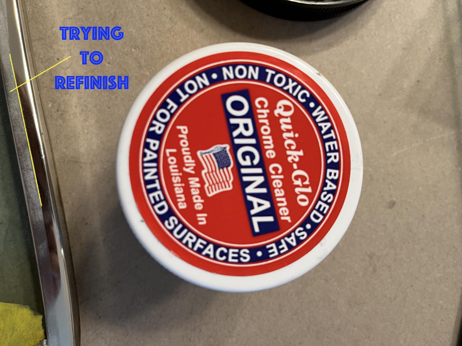

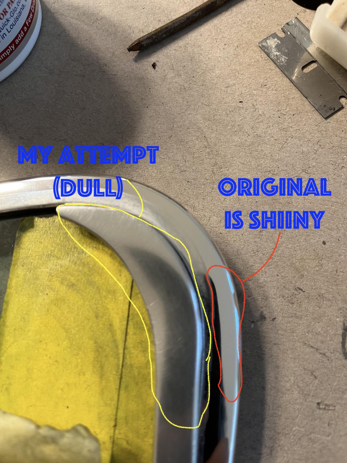

reawakening an older thread; its 2022 and i'm trying to polish the ALUMINUM trim around the front window. not getting the shine i need. whats the latest black-magic to do this? first time doing it; I did all teh layers of sandpaper I had from 250 to 2000 and then a 000 steel wool with the polish shown; then also dusted off my dremel w/ the little red block of wax. not nearly close!!! Tools of the trade I have on-hand and tried...
