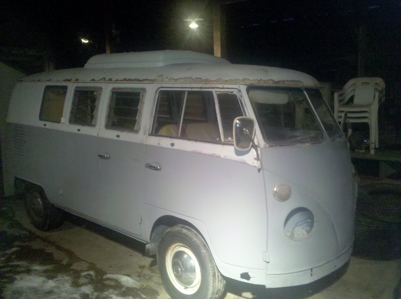

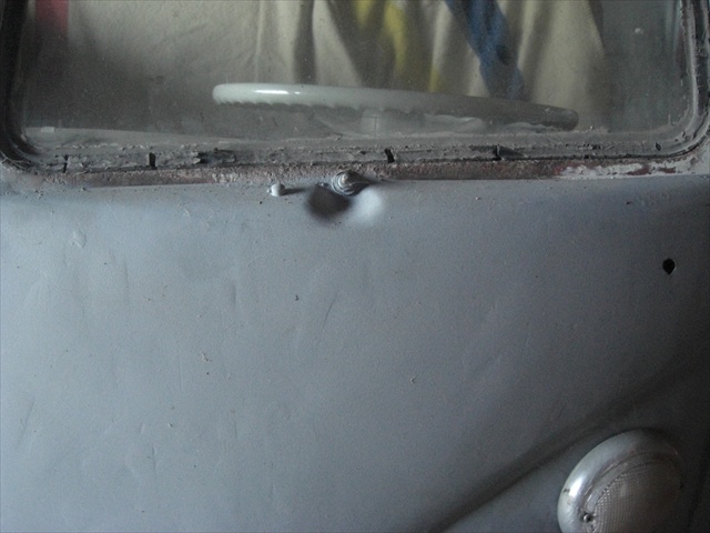

I've been wanting to start this dicussion for some time and I'm even more eager to get this restoration started, though, it isn't going to start for some time.

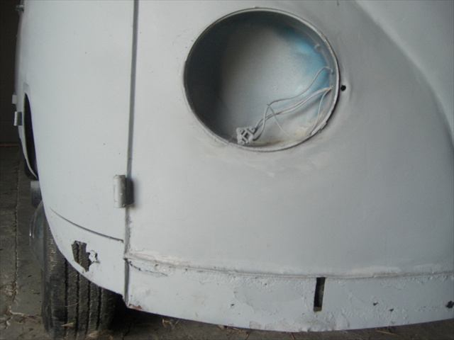

First task will be getting the body work completed. I would like to send her down to metwiz, so I'm using this as a vehicle to document the current condition and to post pictures that I can send to him to review. Hopefully, he and I can then discuss where we are and where we can go from here.
Here she is:

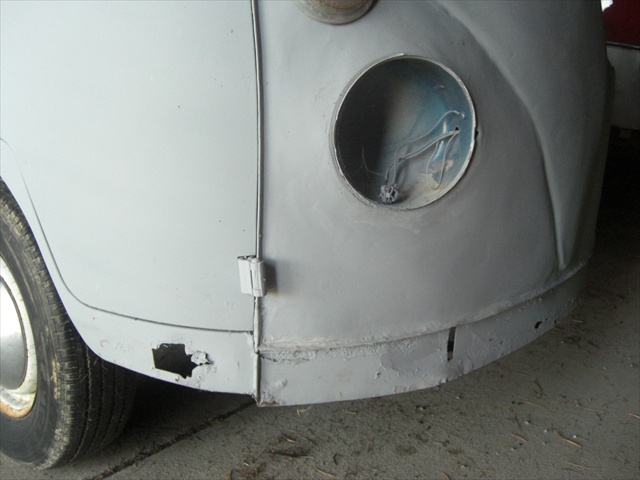

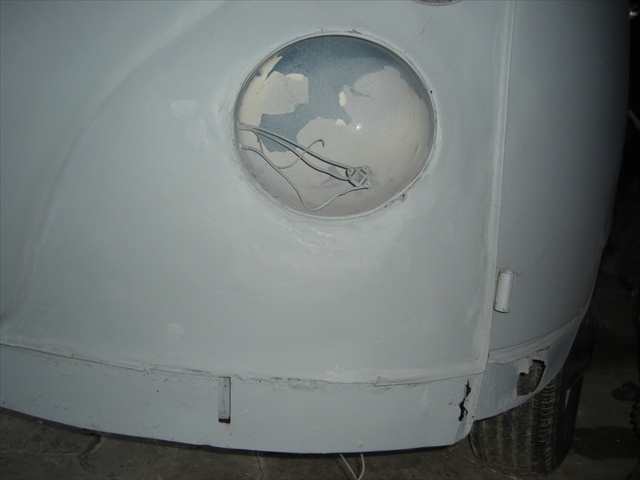

I think I'll just be replacing the nose and valance completely:
Inner valance:

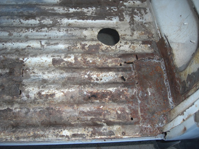

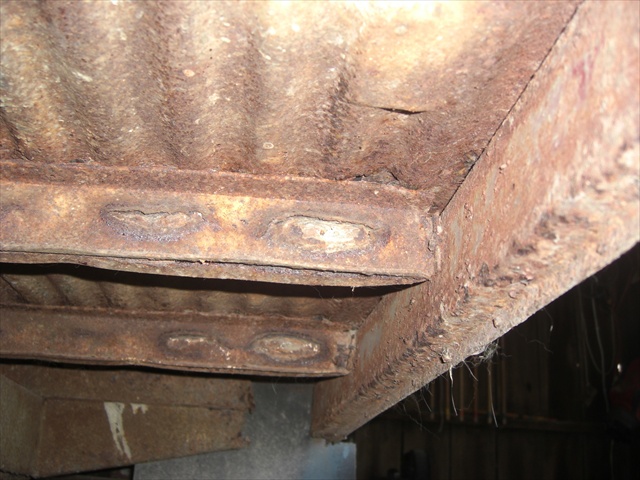

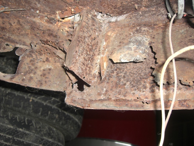

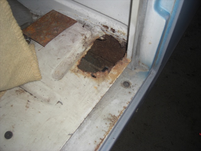

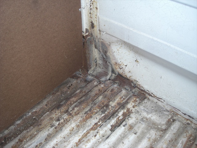

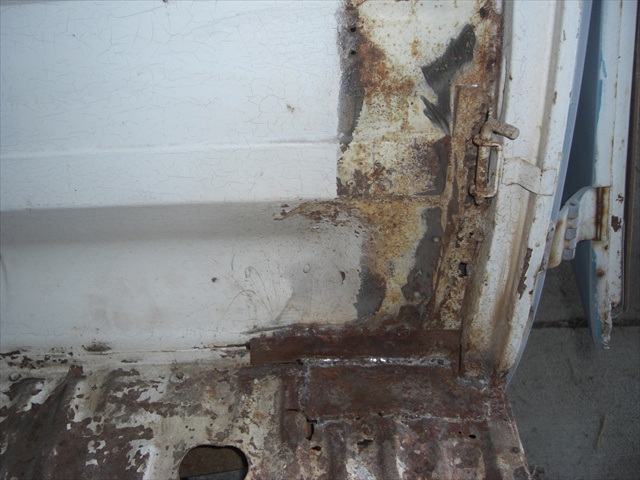

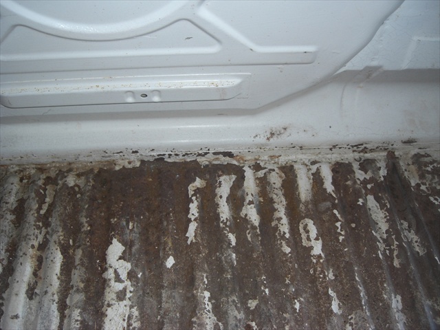

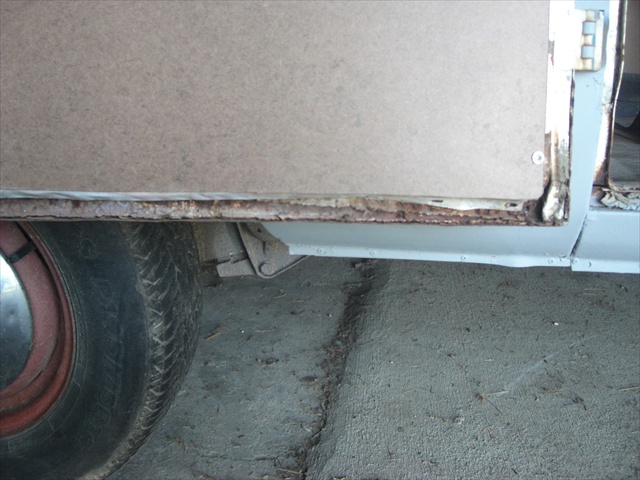

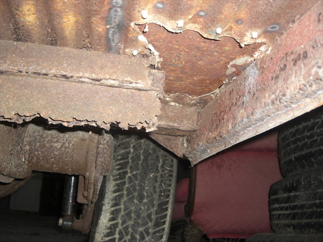

Front Floors:

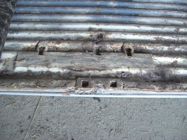

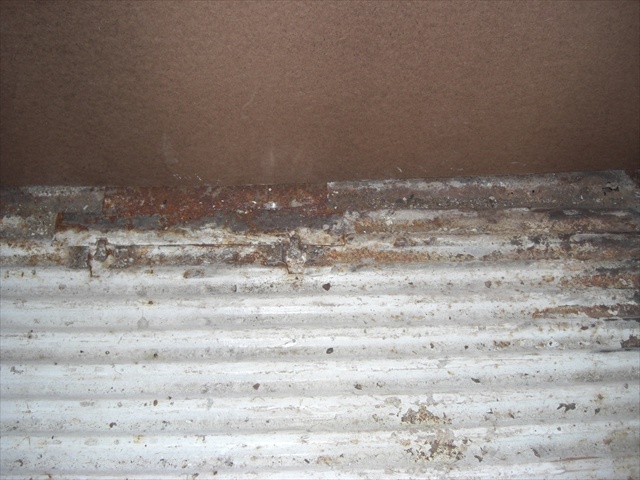

Cargo Floors:

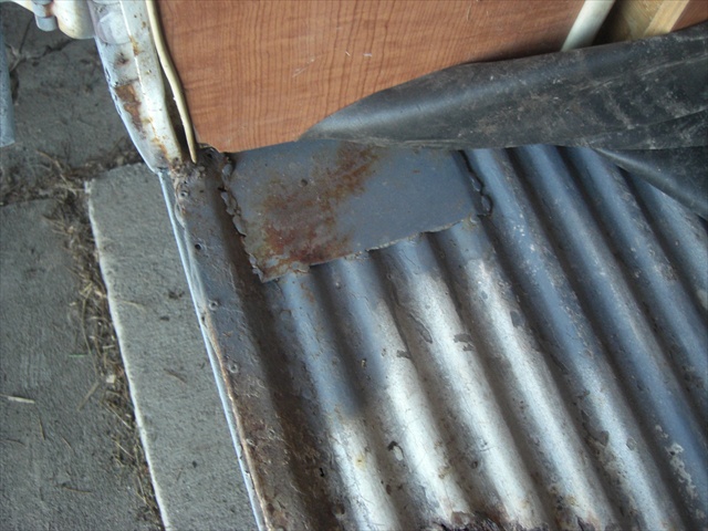

Cargo Door Bottoms:

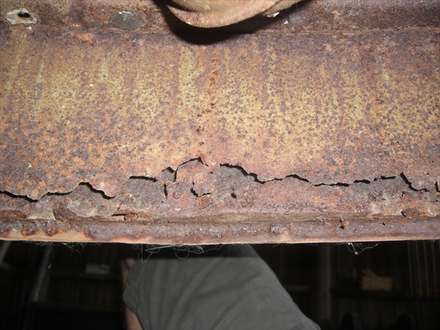

PostPosted: Sun Oct 10, 2010 9:53 pm    Post subject: Reply with quote

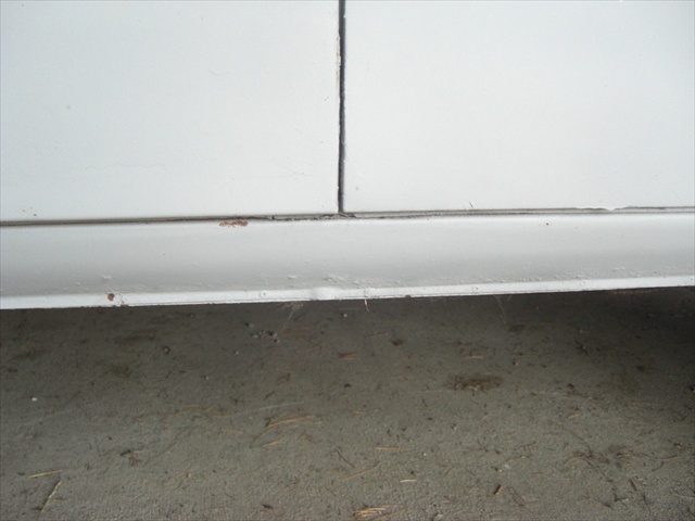

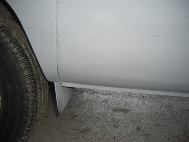

Passenger Rocker:
Driver Side Rocker:
Well, that's were I'm at right now. Like I said, this is going to be a pretty slow project.
The bus came with a complete single port engine and a complete dual port engine, as well as a dual port longblock. I'll be looking over the engines in the near future and making a decision which one will be getting the rebuild. Right now, I'm leaning single port.

Good luck on the project. I love watching buses like this get the extreme makeover. The nose on that thing is especially nasty.... Total "Bogata Look"

I see at least $3-4K in green metal needed.
Nice riveted rockers. Shocked
Removing the lacquer primer and bondo might help the body evaluation.

Pull your SO-42 interior, bag and tag each and every bracket, clip, screw.
Compare what you have to the SO-42 interior in the Samba archive.
Did that poptop leak the 20 or so years your bus sat outside? If so, the
laminate is probably shot. If not, preserve the interior away from water and rodents.
By the looks of this bus, the shell is a goner, unless you plan on spending a boatload of greenbacks. Where do you start???
You could find a clean '65-'67 Kombi or Standard and transfer a good interior into it with some fitting, or else part out the shell, sell the good
interior Westy components and drive train and find a useable safe-to-drive Westy.

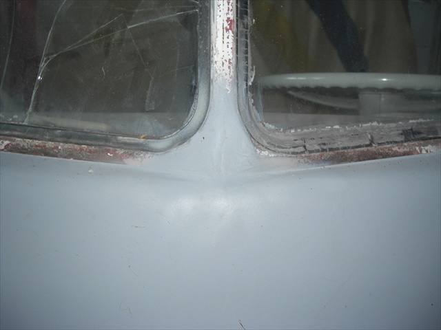

My thoughts as well. That shell is not worth repairing. It needs a new nose, all new floors, frame parts, rockers, doors, doglegs. And look at the gutters. What will be left? If it were a more desirable model, it would be worth it. But that thing is a mess.
dawerks
Joined: September 15, 2010
Posts: 2349
dawerks is offline
PostPosted: Tue Oct 12, 2010 9:26 am    Post subject: Reply with quote
Devils advocate;

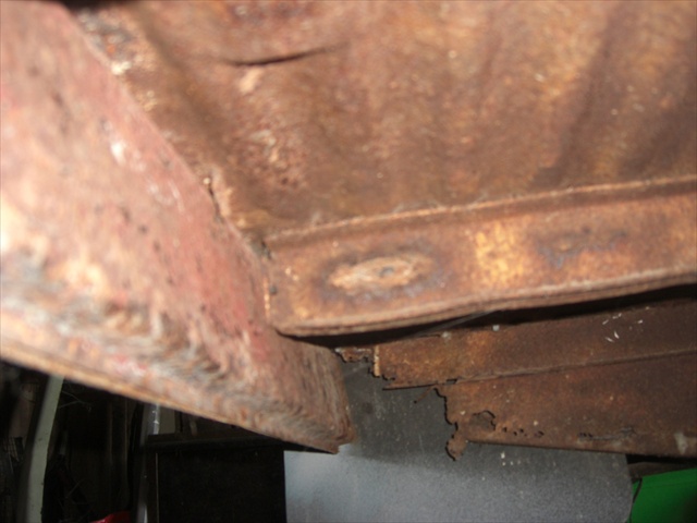

Your frame is pretty decent. I say that because it looks like the po cut the corners off and hacked the outriggers/tophats. The inner rocker looks pretty nice! Usually they are non existent.
I personally would fix the outriggers/top hats. And LEAVE the rockers etc alone. Then fix the drivers side floor a little bit and drive it. Get it running/driving/stopping and then drive it till it's no more. The nose is horrible, but, eeeh, it's ok. Same with the rockers etc. It looks really bad but it's not that terrible. Spray with some anti-rust and rollllll it. That bus could easily be around another 10 years.

x3 on no sentimantality - to get that bus back to a drveable state will be muy greenbacks. a quick look tells me that the bottom 6"-12" of the bus inner and outer would need replacing.. we're talking the nose, inner outer valance, inner outer rockets, doglegs blah blah blah and that it not even tackling, tires, mechanical, running gera blah blah blah.
i agree grab every campmobile piece you can get off of it (including drilling out the rivetted front curtain rods) and find a better body to transfer to a better bus@!

A quick look says outriggers, top hats, jacking points, the outer cargo floors, lower nose inner and out, window beds, some dogleg partss, front floor at least 1/4's, front seat belt point - this is already 100+ hours. Factor in paid time and you get an idea of the end bill for this Bus. Just go in knowing this will hurt.
Also be observant of the roof gutter - there looks to be issues there.
