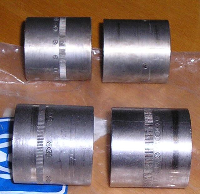

On a Vanagon either an aircooled or water cooled the spec is 360ft*lbs
from what I read it depends on who you ask and which publisher. Do you have a link to the technical bulletin showing the change?
Here is my point. This image below is from a 2006 post in the Vanagon forum. The spacer on the left is the one that came with a 1981 air cooled Vanagon (it was posted by someone I know who owns that 1981 Vanagon). The one on the right is the replacement VW now sells that he upgraded to. The torque for the nut and the thinner spacer in 1981 was still 253 ft lbs. It was raised to 360 ft lbs on later water cooled models that use the thicker spacer on the right. I don't think it is appropriate to suggest everyone should torque the older style thinner spacer to 360 ft lbs. VW felt there was some need to use the thicker spacer when they upgraded the specifications for the axles - probably the greater HP in the water cooled engines. That is my opinion.
