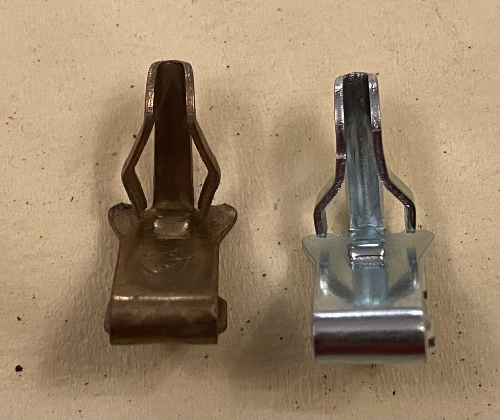

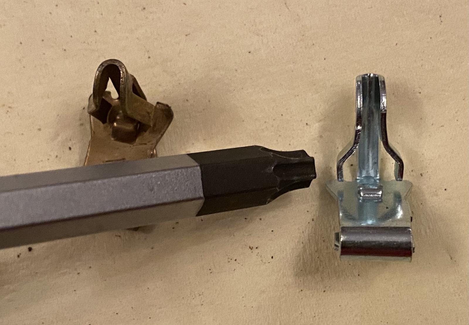

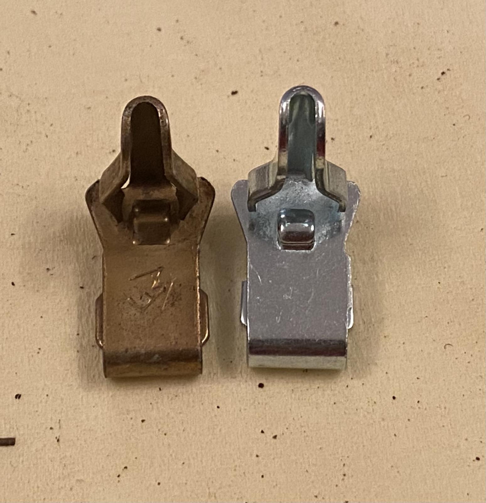

My retaining clips (those horrible porcupine bleeders that also hold the outside brightwork surround and scraper) had ripped the rubber off the back sides of the felts, so I built up the rubber a bit with Permatex UltraBlack:

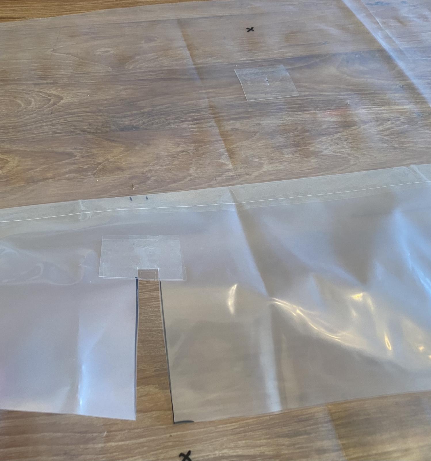

Put on your thinking cap. You must think now. Shoo away the kids and the dog. Look at your LEFT door panel sitting on the clean soft towel. It's "inside" surface, the cardboard and the screws and clips are looking up at you. You need to make a new vapor barrier out of plastic sheeting (4 mil, minimum) that will be "more inside". On your new vapor barrier, you must make a new flap that will be "even more inside still". Get your new sheeting laid out in a very approximate way over the door panel. Dimple the plastic sheeting (no perforations please!) with your door clips to set the perimeter. You can draw a connect-the-dots outline of the dimples about 1/2" outside each dimple and you will have a decent outline of the final vapor barrier. Measure the distance (red arrows) from the top panel clip holes down to where the barrier flap must be glued (purple and green) to the barrier:

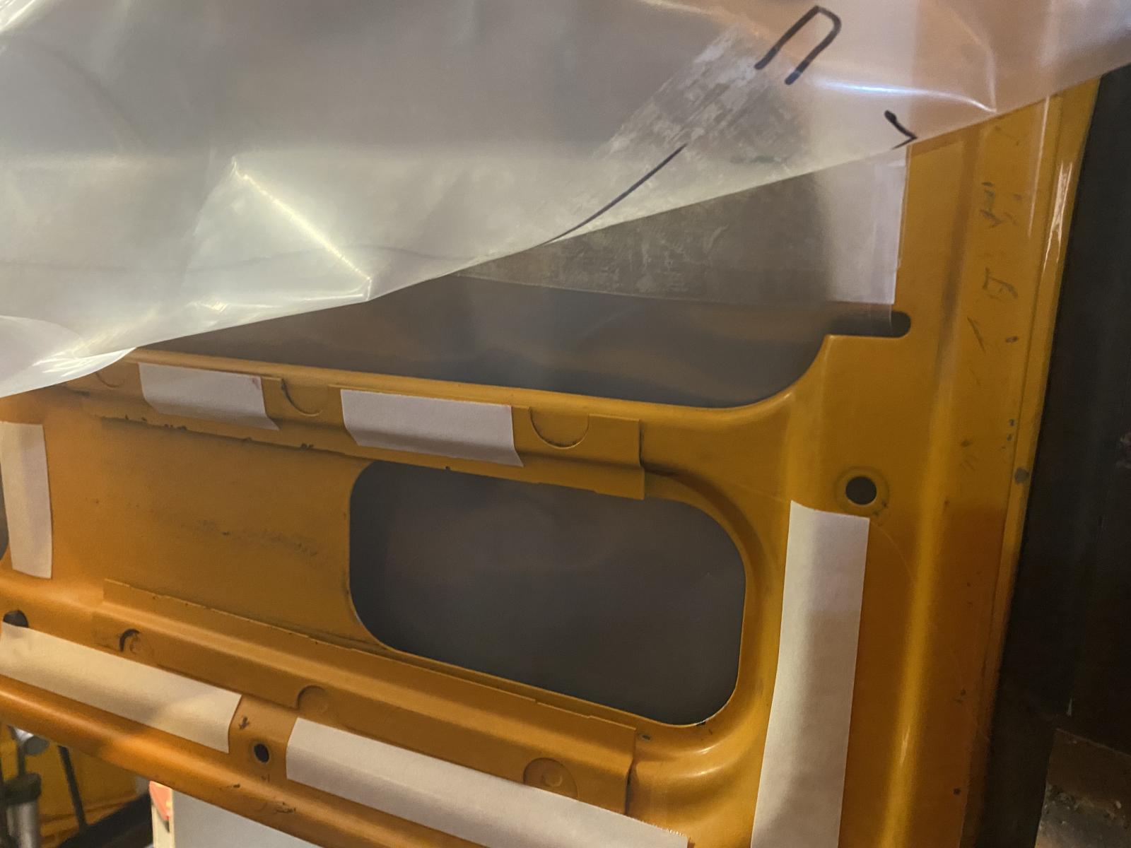

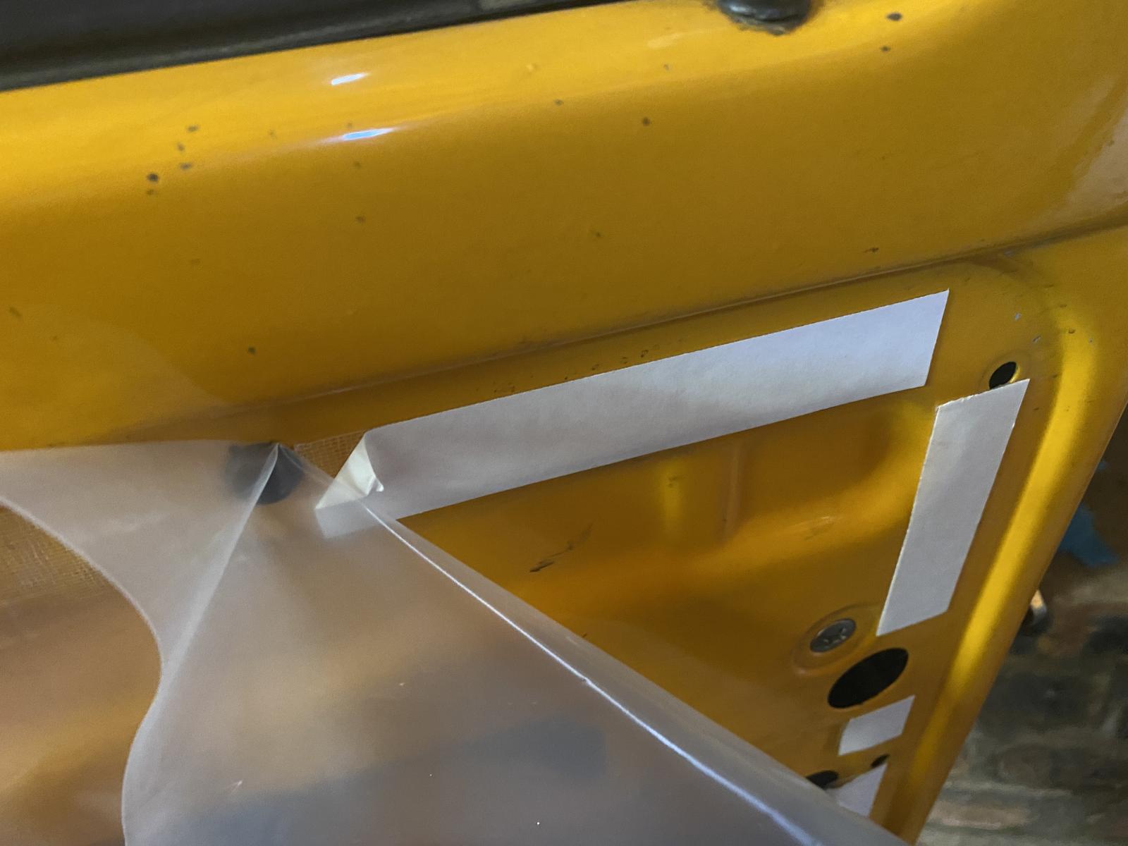

Take these measurements to your plastic sheeting and just rough in the glue line parallel to the top edge of your sheeting. "Borrow" an inch within the measurement (if it is eleven inches, for example, make a line at ten inches), to be your glue line. I used spray adhesive, so I had to put protective plastic over the barrier so it would not get spattered with glue. I borrowed another inch (if the barrier flap is seven inches, cut to eight) and protected the flap from overspray as well:
A medium coat of glue comes up very fast on smooth plastic. Allow to dry until tacky. Then apply the flap one inch gluey surface to the one inch glue surface on the barrier. Plastic likes to slide and slip, so make sure the surfaces are tacky before joining:
9) If you're feeling lucky, punk, you can cut the perimeter of the vapor barrier to your drawn line. I do trim it down for easier handling but keep an inch for safety, and do the final trim on the door. Now you need to mask the window winder foam, the door pull rod and foam silencers, the door panel perimeter AND mask the air extractor AND mask the entire inside opening of the inner door panel. I threw in the towel.
So many people don't bother to prep and wonder why their windows always roll up dirty, and they wonder why the inside of the door fills up with crud and drains terribly, and the next time the panel comes off, the foam tears out. The BobD was a mess of WaxOyl smearing the window from the contaminated flap, and there was bondo and screws and washers glued to the inside of the door down at the drains. Your tape job only needs to cover a couple of inches away from the adhesive spray, it is not like primer that drifts all over the place.

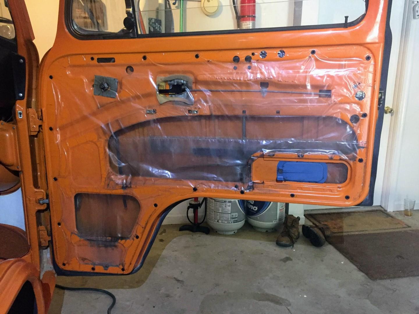

10) Test fit your barrier and make personal notes of how you are going to work in the flap into the slot at the rear of the door as you negotiate major stickiness. Spray the clip perimeter and the painted surfaces of the door. Once tacky, pull the masking tape (and towel), fold the new vapor barrier at the glue line, and keep the flap away from contacting the sticky door. Start the flap into the slot at the rear of the door and insert above the extractor frame. Try to index the door clip hole just above the flap's rear slot with the corresponding dimple on the vapor barrier, work your way up to the top edge. Smooth out the vapor barrier from the middle to the outsides all the way around the door. It wants to be only sort of taut. There's a grooves on the inner door panel leading to a hole. Do not mush plastic into this groove and hole. Just let the barrier adhere across the surfaces below it:
Here is what it looks like once the plastic has been proferred to the entire adhesive sprayed surface. I was a little bitty high on the glue line-at-rear-slot, but not enough to mess anything up. Use a fresh razor blade to trim the plastic to an exact perfect 1/4" past each grommet all the way around the door. Don't let the plastic bunch under the blade. Now you are going to join the ranks of the insane. You are going to puncture each door clip hole. The holes with good grommets, you are going to work the grommet edge over the plastic. I used a small screwdriver with a plastic spatula to work the plastic under the grommet:
Shut-up. That's how they look from the FACTORY. In the above photograph, you can see a few grommets that I got the edges over the plastic. The holes without grommets, you can just stick new grommets in . . . Good Luck With That! Fully half of my new rubber grommets were too big/too dry/too hard. Help them get stuffed into the hole with a correctly sized phillips screwdriver up the middle to stretch them skinnier just a tad. Too much and you will poke a hole through them. Wax on the outsides of the rubber grommets may help. Don't want any more leaks? Make sure they are all intact and installed flush. A closer view of a successfully fluffed out grommet edge on the left, and the next one in line to the right. There are only sixty ninety billion thousand grommets:

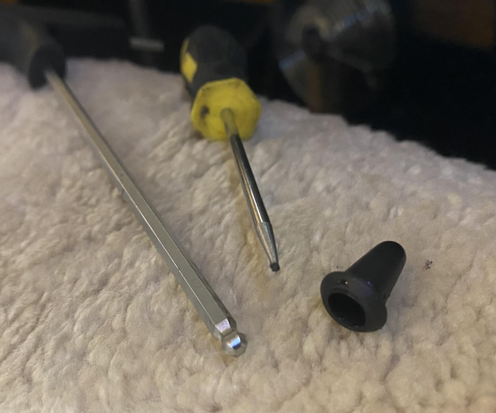

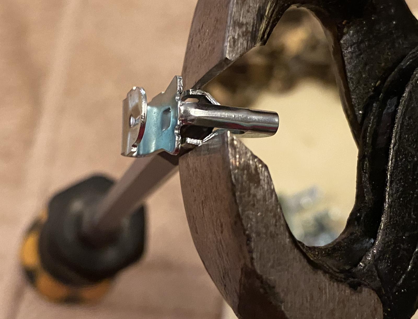

11) Lubricate each hole with a little Vaseline. Double check the barbs on the new clips that you squished the "arrow tip" a little to help them enter the grommets. You want the panel to easily pop off next time, right? without tearing the cardboard?
Slip the air extractor knob into the grill of the door panel in your hand. Visually align each clip with its corresponding hole along the top. Make whatever little nudge-adjustments you need to, but keep them to a minimum. Once all clips are ready to go, start pressing each clip in. Maintain a resistance to gravity and start aligning the clips along the front vertical of the door with as little movement of the clips inside the cardboard holes as possible. Press in, one at a time. Finish the perimeter of the door. Reinstall your hardware. The window should be closed firmly, and the winder handle installed exactly horizontal, it will droop below horizontal when released.

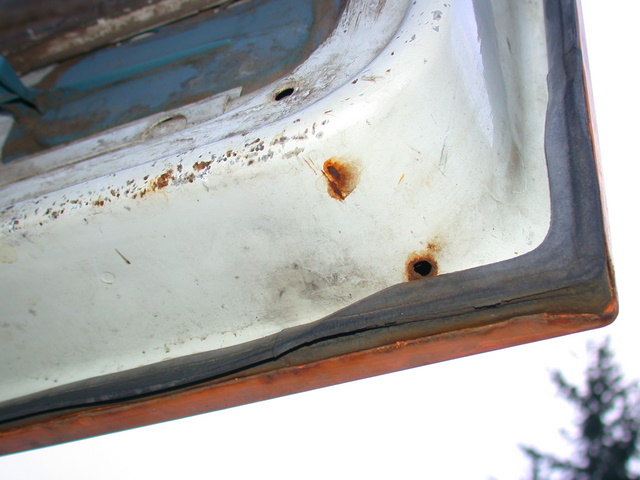

I have added drains to the rear of my doors. I don't like that it drains the water into the channel along the top of the wheel arch and then out the door gasket, but it is better than having a door sitting partly full of water when the bus is facing up hill. I can at least keep the wheel arch well painted, while it is hard to do much of anything for the bottom interior of the door. I have seen one bus where someone drill in hole in the bottom rear exterior skin to get the water to drain outside the bus.
I have thought about blocking all the door drains temporarily and partially filling the door with some phosphoric acid to eat up the rust and form a corrosion resistant barrier. Maybe someday. |

Here is one of the drain holes in the rear lower corner of my passenger door.
