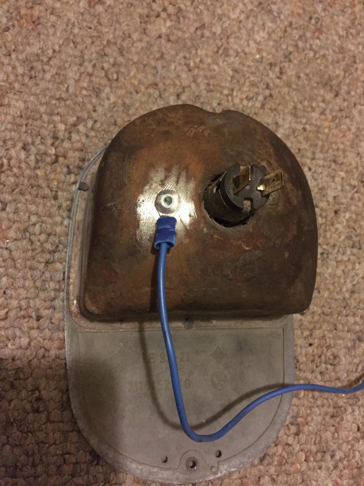

Okay, so I cleaned and polished both light sockets, connectors, grounds, and the connections on the bulbs. Still having the same problem. I looked at some of the diagrams for newer buses (70 and up) and I noticed that each of the tail light housings have their own ground wire where I only have that on my right tail light (I'm assuming because this housing is aftermarket). So I tried adding a ground wire to the left tail light housing since I thought it wouldn't hurt anything but to no avail, it did nothing. Anymore ideas anyone?
Bagged 1968 Neptune Blue "Deluxe"
Tcash
Joined: July 20, 2011
Posts: 12843
Tcash is offline
PostPosted: Sun May 29, 2016 11:35 am    Post subject: Re: Brake Light Problems Reply with quote
Run a wire from the light socket to the ground you added and retest.

Solder the wire directly to the outer part of the bulb socket, sometimes those aftermarket units lose continuity between the case and the socket where it's pressed in.

Alright. So this time I soldered the ground wires to the bulb sockets on both tail lights and the problem is still there, except now its the left that works with the headlights on Brick wall

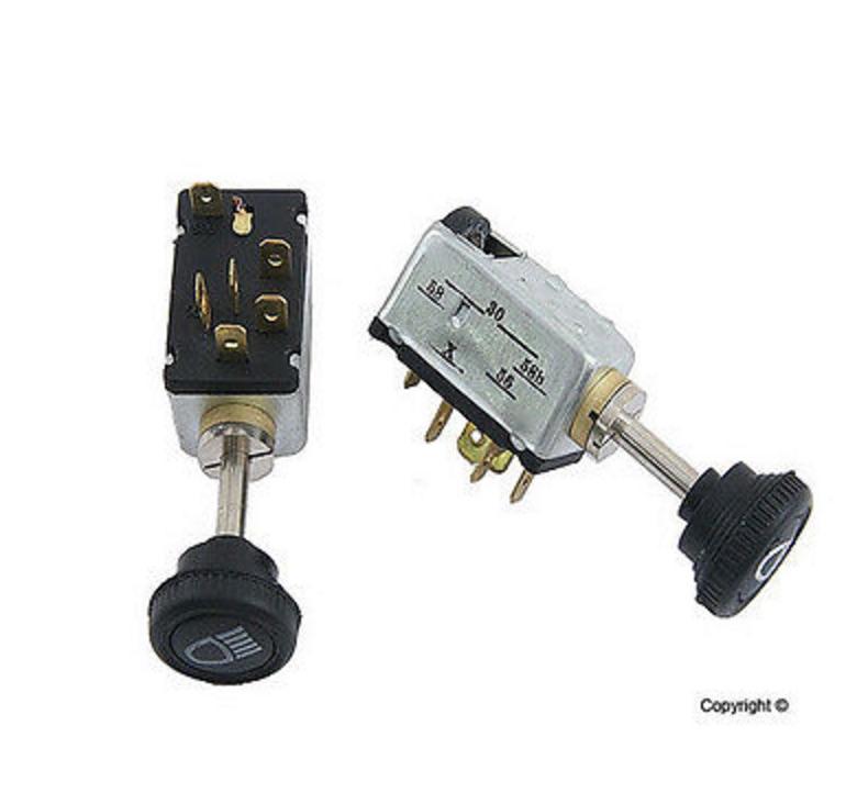

So I think I might have found the issue. Since the problem only arises when the headlights are on, I thought I turn to the headlight switch. Turns out the rheostat in there is broken and I'm thinking that might be causing the problem so I'm looking at getting a new switch. If it isn't the switch, at least I will have a non-broken one. Since I have a 68, it is looking pretty hard to find a headlight switch in stock anywhere. I have seen a couple of these though but the pin orientation looks slightly different and the rheostat is on the opposite side as the one in the car.
Only 6 of the 8 pins on mine have wires on them though. My question is if this switch would work in my application or not.

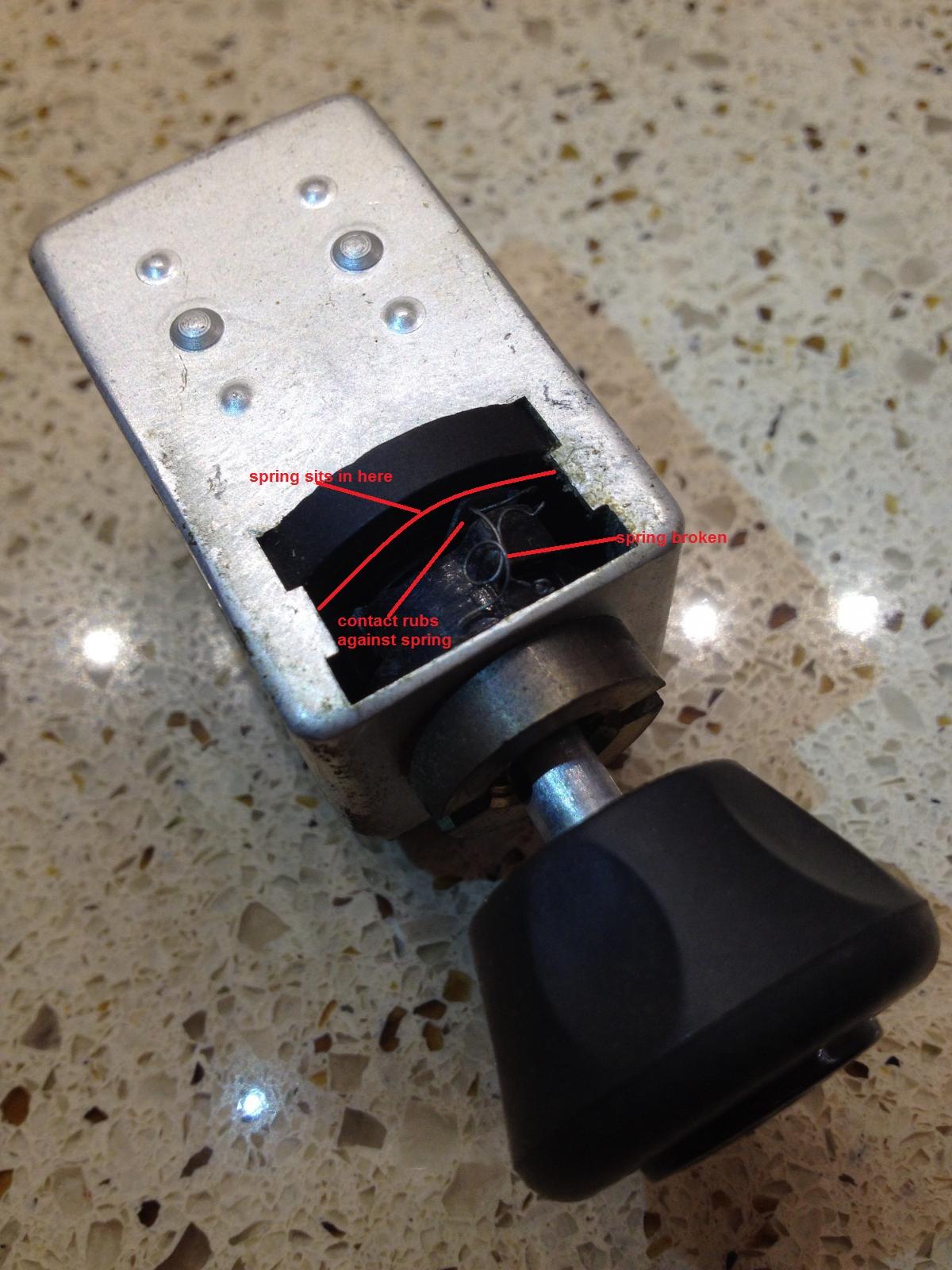

That seems to be a common problem and will cause various types of wonkiness. My engine would only start or run with the switch in the parking light position. Turning the headlights on or the parking lights off would cause the engine to die. Very difficult to diagnose that problem, but very possibly not the source of your problems. The early bay light switches are a breeding ground for electrical gremlins.

Found one on RockAuto with the corrected terminal layout and put in an order. Lets hope this works!

The old rheostat in our 69 uncoiled and caused huge problems including shorts and burning inside the switch. Got a new switch and the first time I rotated it the rheostat uncoiled on it too. Everything else worked fine and the light dimmer was stuck in the "full on" position. So everything now works fine.

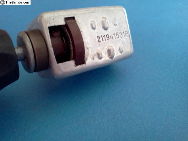

For the future
Broken rheostat
Good rheostat
I would cut the wire out before it starts causing problems and leave it on full bright. Dimmer switch my ass there is only can't see and off anyway.

So I got the new switch in today and I was wondering if there was any particular way that I should remove the rheostat so that it doesn't break into a bunch of little pieces. Any help Tcash?

You're saying you bought a new headlight switch? If so, run it as is.
Removing the rheostat is a method of successfully using an old switch.
Now that said, the headlight switch has nothing to do with brake lights. If you're still having brake light issues, get a test light and check the brake lamp signal back at the rear light fixture. If the test light lights (ignition on, brake pedal pressed), then the issue is in the fixture itself or its ground. If the test light doesn't light, the problem is upstream: turn switch, 4-way flasher switch, brake light switches, associated wiring.

No need to remove it on a new switch unless it breaks. I would leave it.
Use a small pair of diagonal cutters and cut the wire out.
