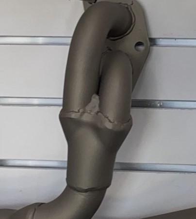

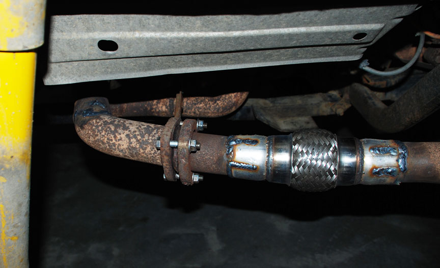

I have welded up my stainless exhaust (2.5L Subaru) for the last time. Mine started cracking within 9 months, and currently it cracks whenever I drive fast over a mountain pass. Its now 25 months old and has been welded so many times it looks like bamboo.
Note the appearance of Stainless at 22 months. This does not bother me. The cracks bother me.
I suspect Stainless steel exhausts cannot handle the heat. Also the Stainless causes the exhaust nuts/studs to corrode/freeze.
Does anyone have a recommendation for a tested and reliable exhaust for Subaru-Vanagon?

If you do a search over on the SubaruVanagon Yahoo group you'll find some discussion of different stainless steel alloys that supposedly make a difference in durability. There are also some different design that are supposed to relieve some of the stress in some designs. I'm curious who's system you have now. I've got a Small Car header that's holding up last I crawled under there (about 8 mos. and 10k mls.) but I'm worried that it won't last based on a large number of reports of cracked headers I've read.

I have the KEP header and it broke over and over too. It's pretty thick steel by the look of it. I put a flex joint in the long pipe between the heads and it hasn't had a problem since. _________________ 1986 Vanagon Westfalia EJ25

from: SubaruVanagon.com http://www.subaruvanagon.com/tom/SS%20Exhaust/Exhaust.htm
(Edit....) But for me,,,this does NOT fit a Syncro.... (...Edit) The flex joint is interesting.
I tried adding a flex joint HERE but it didn't help at all, had another crop of cracks in 2 months.
After welding up all the cracks my headers were super-stressed (left to right) could barely get them off the studs. So I extended them 3/8" to slip-on perfectly over the studs. YES 3/8" Now after reading Presslab (above) and SubaruVanagon.com I'm wishing I had put a flex joint in the middle. _________________

Interesting.. Here's what Stan says about Stainless headers
http://www.stans-headers.com/faq.htm
"Stainless steel headers take more heat and, although they discolor, they still look good. A lot of people want a stainless steel header even with their high cost. We make our Stainless steel headers with a "304" stainless flanges 3/8" thick and "409" stainless tubes. The "409" is an exhaust grade stainless and is more "malleable" which means that it will not crack as bad as the "304" tubes tend to do in time."
Here's the ball couplers and flex tubes from Stan's headers.
