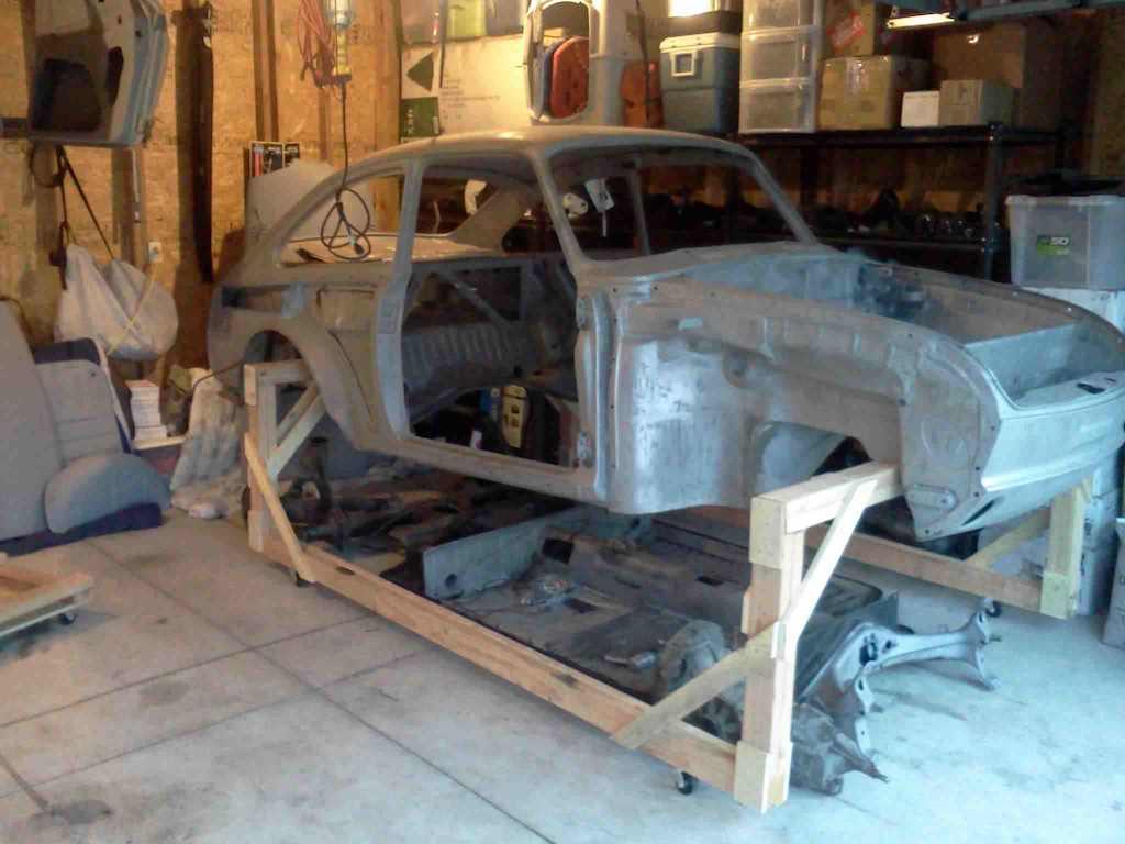

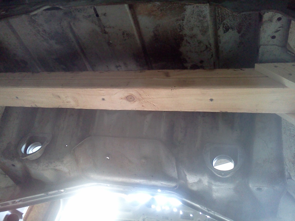

Well that's the brief history on it. This past weekend I built a dolly so I could move it around and now I can push it to 'my' side of the garage. I separated the body and pan yesterday. Initially I was going to keep it together, but with the condition of the pan I separated it. Broke 1 bolt in the process. I'm glad I went to body off, sandblast media gets everywhere, I was surprise how much was hiding still. Now I'll have a chance to really get it all out before I prime it.

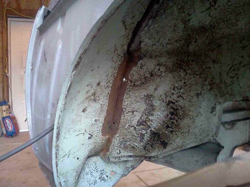

Now for the pics. Today I used my needle gun to get off an enormous amount of black rubberized, old and hard undercoating. The underside of the car had an insane amount of this stuff. I only got one of the rear wheel wells done and will give the neighbors a break until tomorrow!

The rust holes I found. Will get it welded up soon.

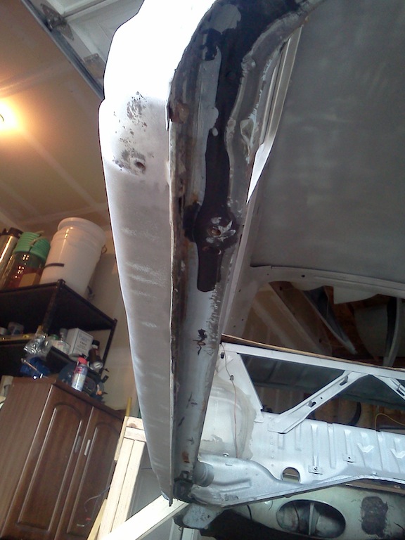

Looking at the holes from the top.

On wheels.
Put away for tonight.

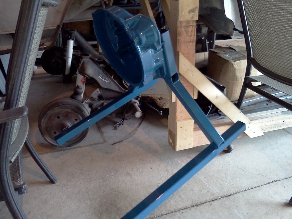

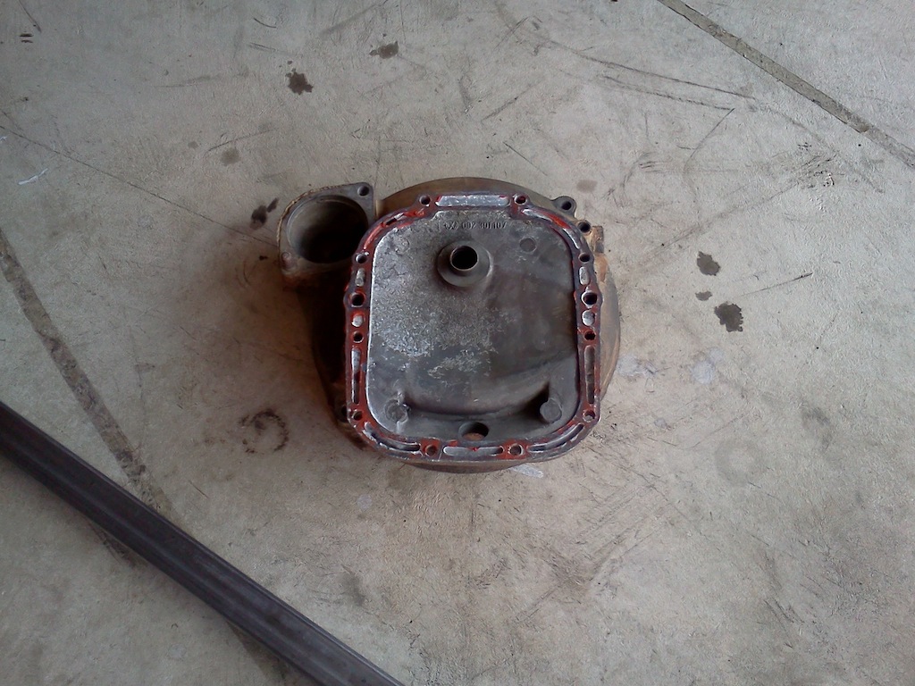

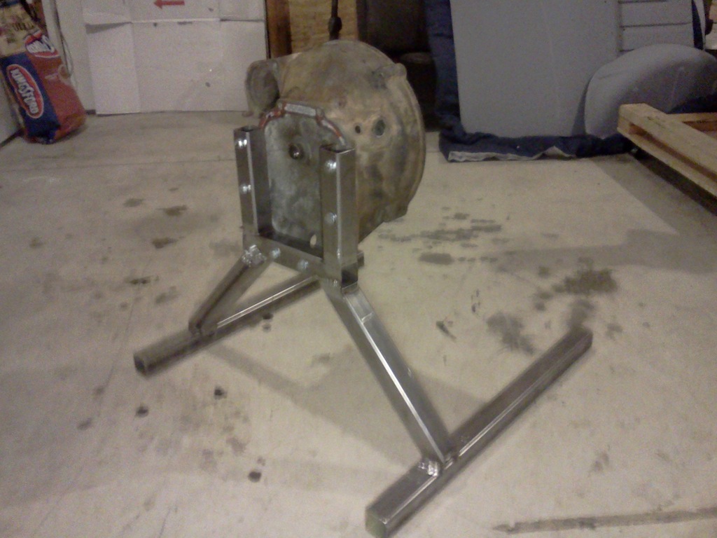

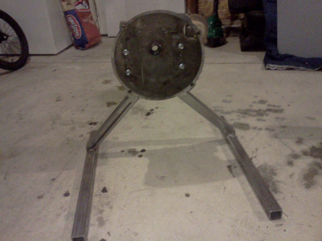

But, I did recycle a bus 002 bell housing. The tubing and bolts came to $30. It will be nice for when I get the engine back.

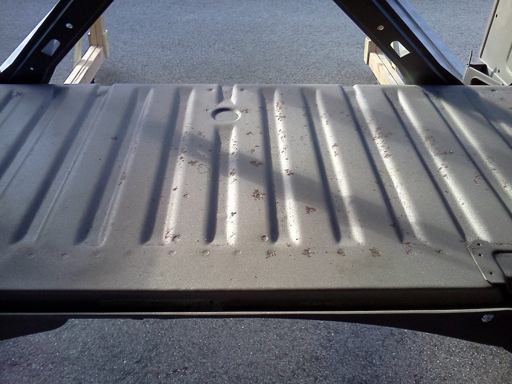

Got a lot done the last couple days. I finally finished sandblasting the body. I use a low silica product called Black Diamond which is crushed coal slag. It cheap, works well and I can sweep, sift, and reuse a couple times before it turns to dust. There's a couple small spots of grime here and there, but I'll just hit them with a wire wheel. Took a shot of my bent apron I'll need to get straightened out.
There's a little bit of surface rust on in the trunk area from letting it sit too long before I prime. I'll use some Ospho to take care of that area.

After I cleaned up, I painted my homemade engine stand with some thinned out blue rustoleum using my HFT purple gun.

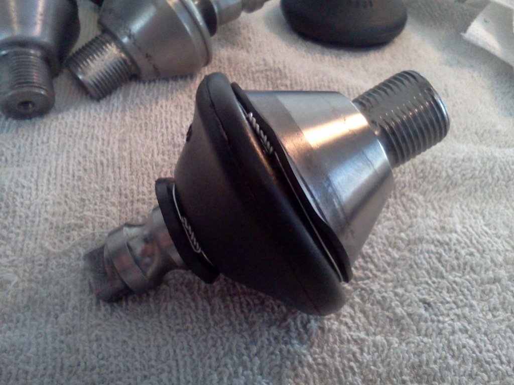

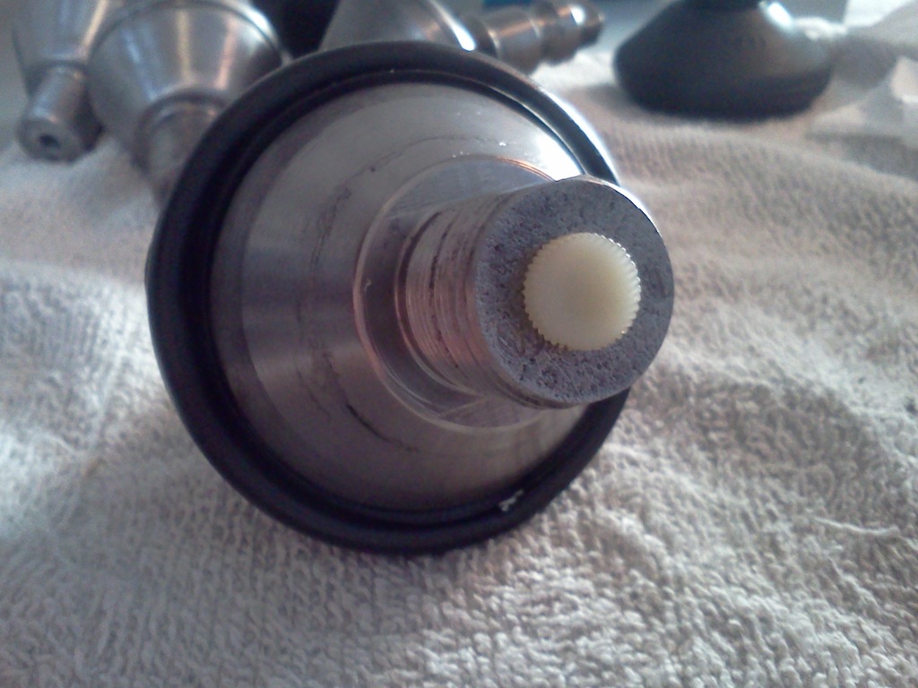

I salvaged my original ball joints and rebooted them today. The lowers seem tough to find and really expensive, so I'll just reuse these. I picked up the donors for about $11 each from rockauto. They only have uppers, but the boots seem to fit both upper and lower ok. $50 total, much cheaper finding NOS ones.
I cleaned them really well, wire wheeled, then greased with moly grease and then swapped the boots. Thought I'd share the pics of the process.

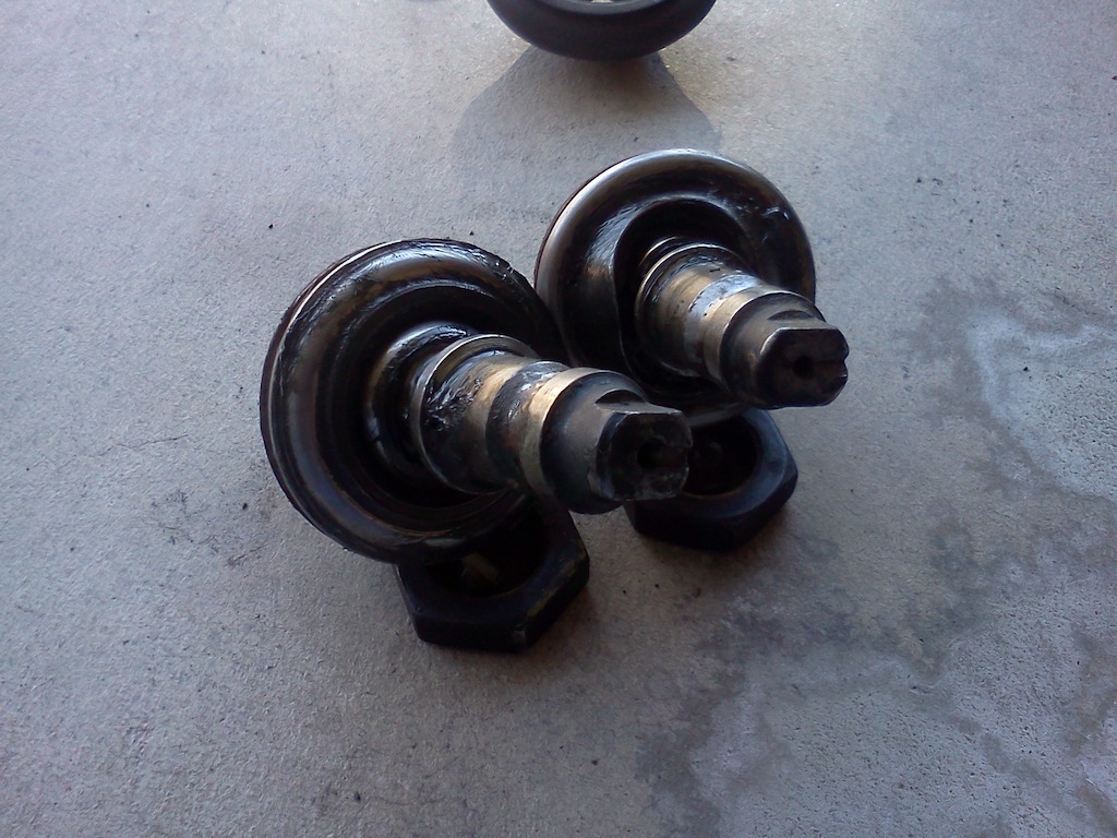

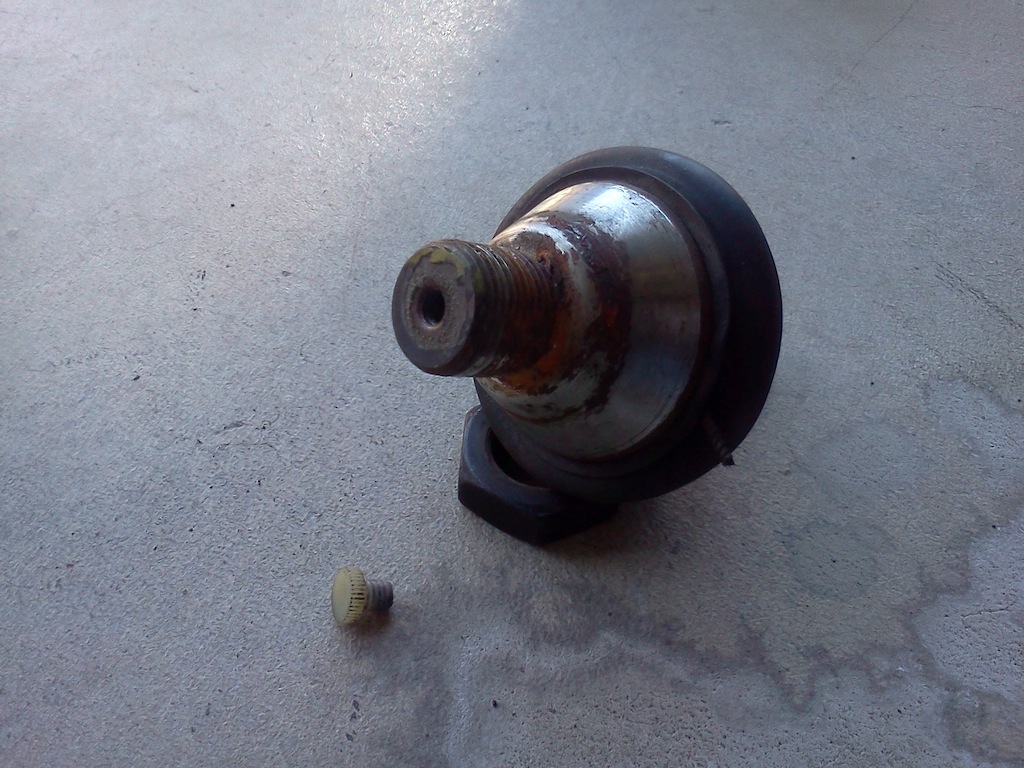

Before
The donor; the grease was pretty hard, must have been sitting awhile.
All cleaned up.
Greased from the bottom.
Wired boot on. Installed plug.

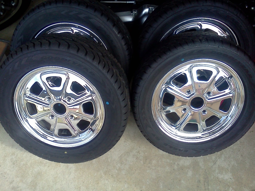

Bought some Picklex20 for the body while I get the pan together, and also had tires mounted on my 2 liters last weekend.

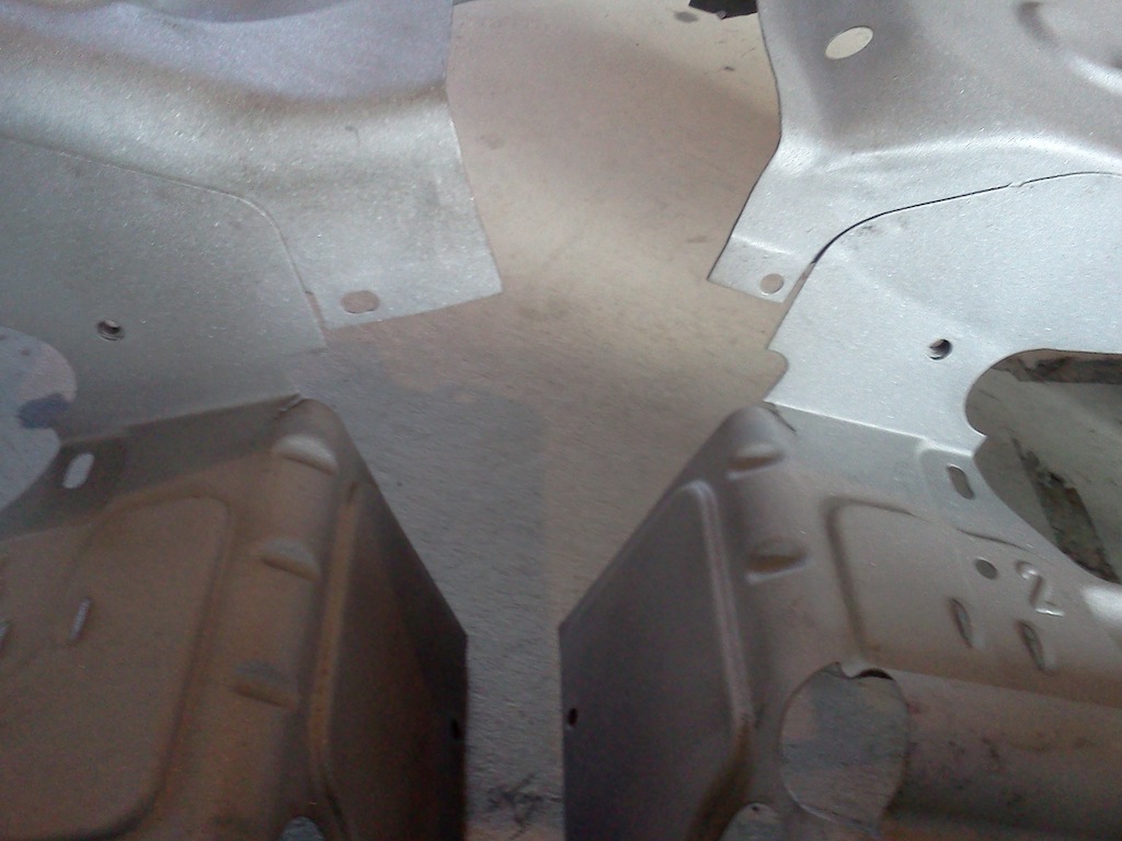

This update is a bit tough to write. I had welded in my KF pan halves and measured them incorrectly. Once it was all done, I bolted the pan to the underside of the body just to check if everything lined up. The right side was off by about 3/16" and the holes didn't line up right. I guess I just got a little over ambitious and hurried though it. So what I learned: bolt tunnel to body first, align pan-halves , tack in place, then remove and finish.
I had to walk away from it for a few weeks due to my frustration. There was another local pan with almost no rush I picked up for cheap and cleaned it up. I got my first coat of Masterseries on it tonight. The bottom and the 2nd coat will be over the next few days. I still have the other pan but haven't motivated myself to undo my botched work.

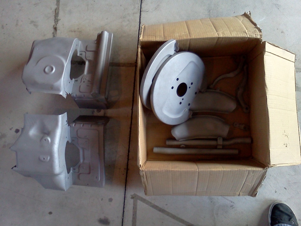

In other news, I received my transaxle back from Daryl at AATransaxle with a 3.88 R/P. And, yesterday my longblock came from CPR. I'll get pictures up of both this weekend when I unpack them. But here's the build spec sheet and pics of my mad purple gun painting skills (sorry the before shots are blurry, must have been something on the lens):
