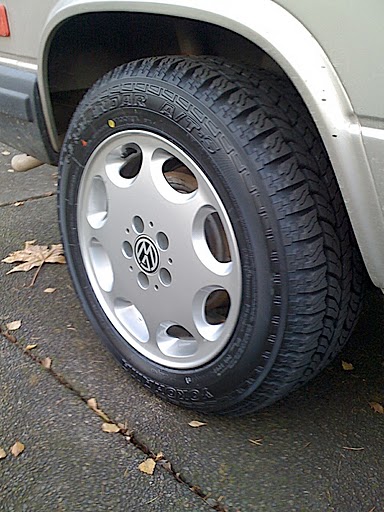

PDXWesty Samba Member
Joined: April 11, 2006 Posts: 6234 Location: Portland OR
Posted: Wed May 04, 2011 10:38 pm Post subject: |
A buddy of mine has them on his van. They're excellent tires.

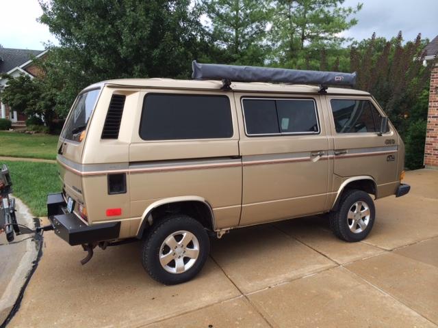

tencentlife Samba Member
Joined: May 02, 2006 Posts: 10067 Location: Abiquiu, NM, USA
Posted: Thu May 05, 2011 7:41 am Post subject: |
shizzon wrote: |
225/70 16 ? Hmm... Do you have a lift on that? My understanding was that it would be difficult to go above 215/65 16 without running into rubbing issues. Unless you have a lift, that is... |
Syncro, standard springs, front is 18.5" axle-to-arch.
16x7 ET45 Audi Allroad wheels on 8mm spacers (effective ET37). Tread height on the ground is ~27 5/8".
My front tires can rub the rear edge of the fender with a good bump on a sharp turn, happens very rarely. Other than that, good clearance everywhere. My 2.2 wbx has no problem pushing the Syncro with this tread diameter, in fact the overall gearing is much improved with the larger size. And I'm at 6000ft.+ altitude all the time (~20% less hp). You would have ~18mm shorter sidewall with a 215/65, or 36mm lower diameter, just by the numbers.
Quote: |
It is debated that (and I have to post the thread) that 65 may be too much tire even for and EJ22 powered van. |
If an EJ22 couldn't handle that then why in hell would anyone do that swap, it would have to be pretty lame if that's even a question. But I know it's not that lame, Walt's just a worry-wart. _________________ Shop for unique Vanagon accessories at the Vanistan shop:
