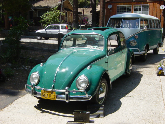

I've owned this beetle for 22 years now. Purchased in Lake Arrowhead for $680. Built 13 January 1961. Delivered to the USA.
It has a three finger front apron
screw terminal wiring
no foot rest
had a plastic plug in the dash for a choke cable now running a 36 hp.
red handled oil dip stick
H rear apron
vertical door handle keyway
1960 type turn signal switch
I believe it is an original sunroof although the birth cert does not indicate this. I base this on my last headlner install. The OG color was Pearl white it was green when I got it.

tasb wrote:
vin # 3 591 436
honestly some things like door handles, turn signals and dip stick are very easy to change. Others like the lack of a foot well and aprons and wiring would be dificult to change.
We owned #3509444 from '66 to '71 and it had all of the '61 features, but still had the 4-tab hood. I'm guessing your car was rolled early in its life and the og '61 hardtop body was swapped out for a '60 ragtop body.
Thanks,
Jan K.
