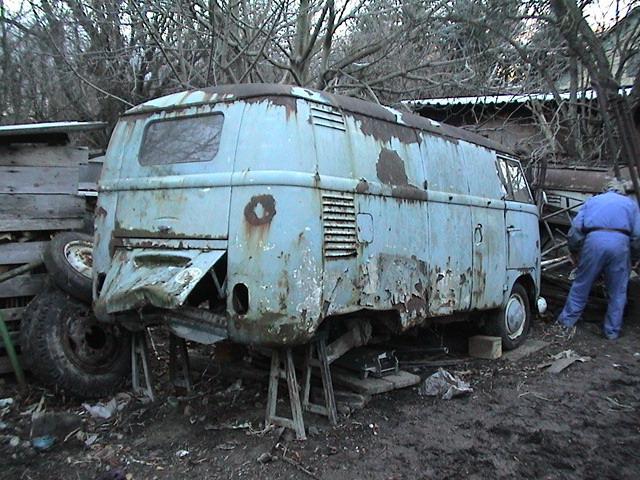

with all the fun going on here i thought i would post a thread dealing with my ongoing resto. first pics are at the place where the bus was found. belonging to an old man it was used as a storage bin in his "garden"

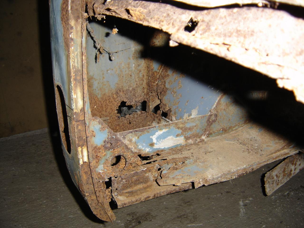

the bus was lying flat on its rear part, engine and trans were pirated long ago, rear bumper was missing accordingly. in the rear sombody tried to lift the bus in the middle of the rear apron and only stopped when it and the decklid were damaged beyond repair. later lights were cut into the rear corner, it originally had the small taillights (early 61). while trying to lift the body with a forklift it was dicovered the hard way that there were a lot of sacks of concrete cement inside Shocked
so parts of the chassis were damaged too Embarassed

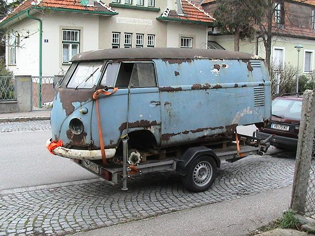

this is how i first saw it - it was about to be scrapped. i felt sorry for it, i just cant stand the thought of a split being extinguished. since i only paid a very moderate amount of cash for it (just what the few usable parts on it were worth) i thought what the heck - i just cant live without a split (i just sold my 65 21-window the week before)
stay tuned

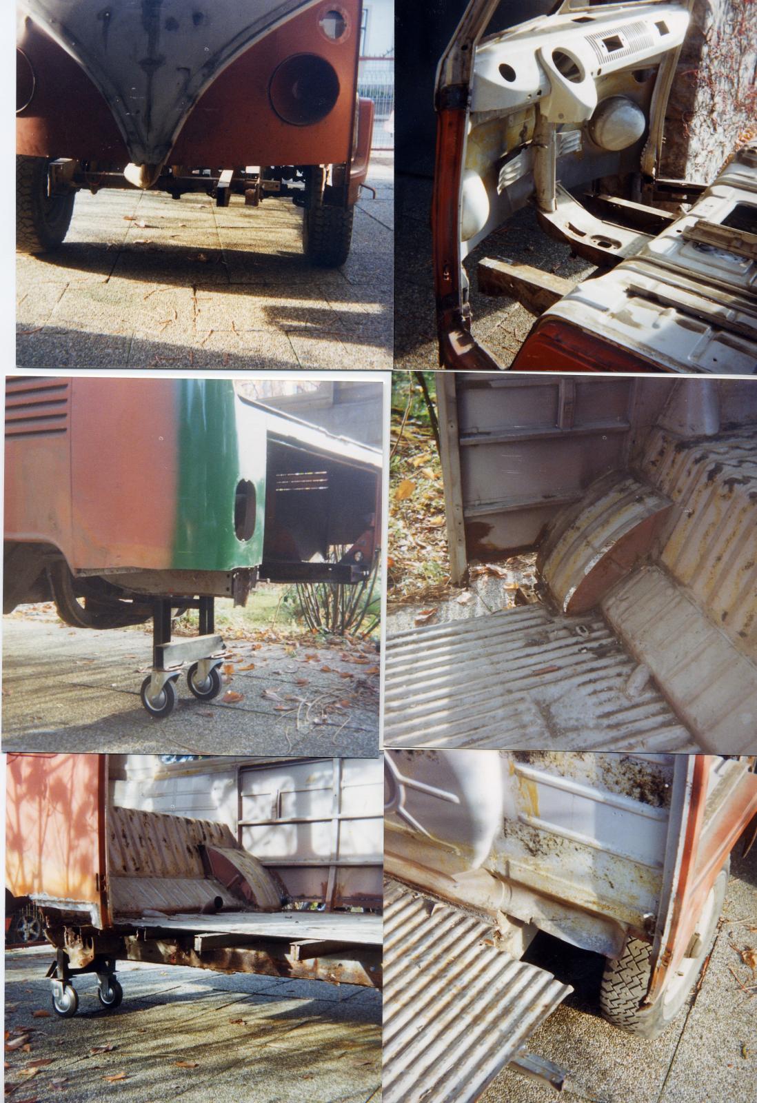

i do have a faint clue of what is involved with a resto like that. i have turned this:
into this:
i also restored an ovalwindow ragtop
both cars were multiple show winners at local VW shows and have been featured in german magazines

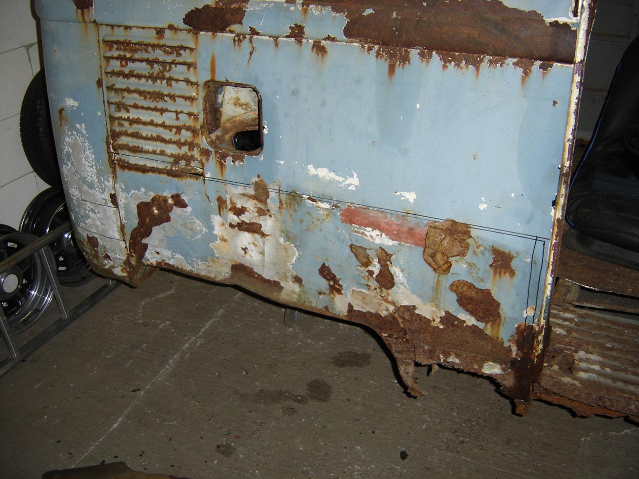

if you see the bus on the pics and think it is bad, you are wrong - its real bad. its basically going to need close to everything repaired sheet metal wise
just an idea how this thing looks:

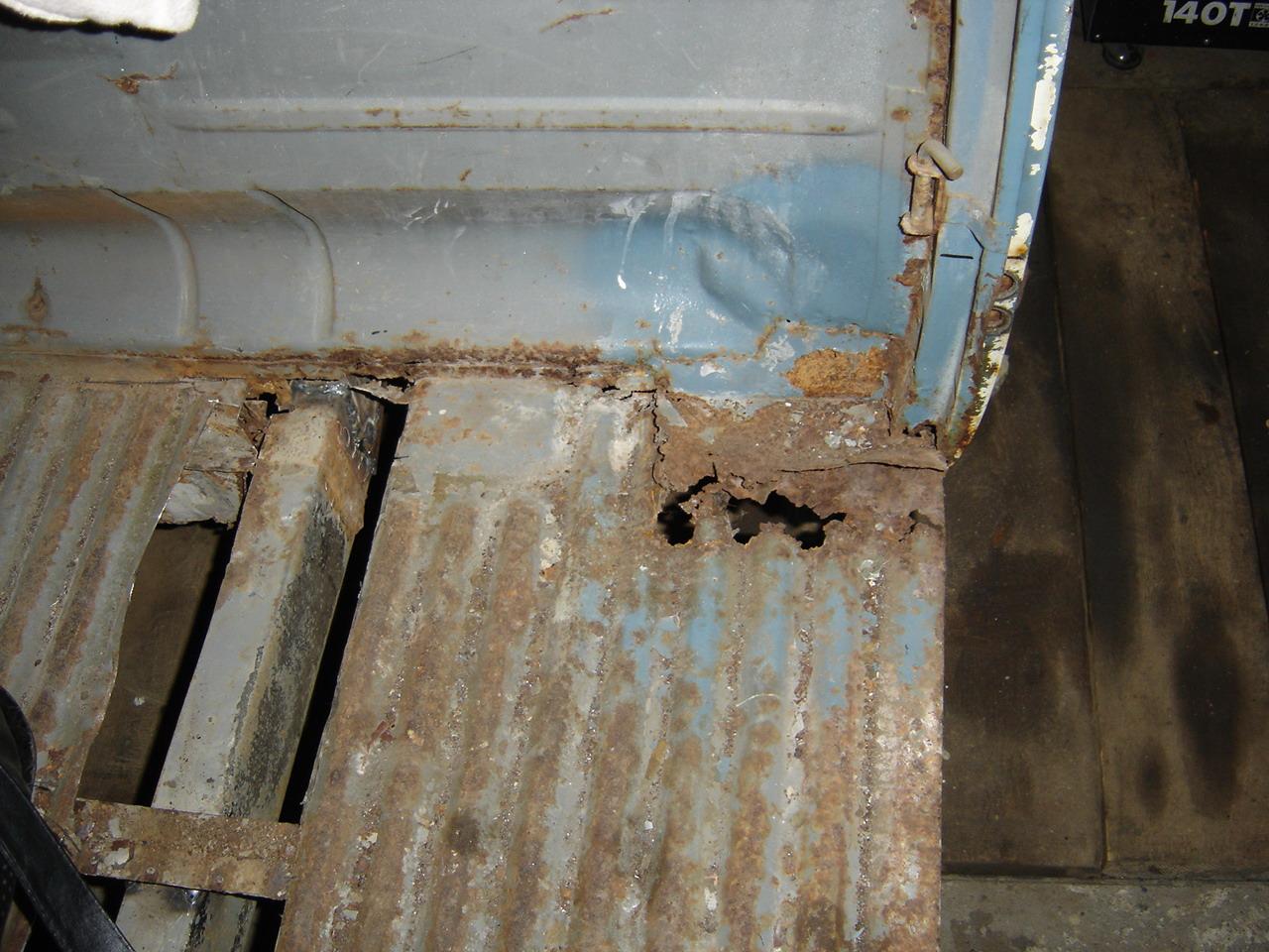

first on the agenda was repairing the framerails on the right side, these were damadged by the forklift and i had the fear of the whole car getting out of alignment. i will remove the floor of the loading compartment later, but now i still need it for structural strenght. i cut a slit from above to get to all the places i have to weld

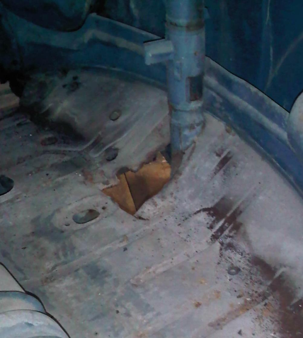

one of the biggest problems is that the rear right torsion tube is rusted through. here i have allready cut it off
this shows what i cut out
i had a pice machined to replace the rusted out section
