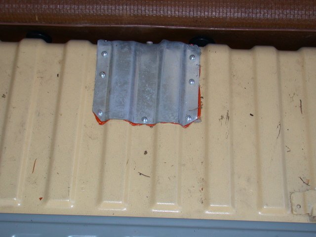

Here is the one in my 78 Bay, so far it has been opened three times, twice to replace a sender and the third to make arm stop adjustments on a new sender so the gauge would be accurate. Before I knew better I accepted the abuse of pulling the tank and did a few senders that way, have sold several buses that I cut access holes for the sender and not one buyer complained about the job or wanted $$$ off. Back in the day if you took your bus to the dealer for a sender replacement you got an access hole cut.
Any idea what they did to seal/cover the hole?

EZ Groove - On page 90.4 of the Second Edition Type 2 manual (orange one) the repair is shown. VW had a kit with a cover plate with four screws. I do not have a scanner so unable to post the page.

VW sold a little metal cover to do the job, the cover was flat and they gave instructions on flattening the area around the hole so the cover would fit. The VW recommended hole was too small to allow for easy access. The first one I cut was to VW specs and it was very hard to get at the sender and the sender would barely fit through the hole. I feel the hole should be squarish and at least 3 1/2 x 3 1/2". It needs to be located 1 1/2 inch to the right of center, just far enough to the rear of the front edge of the deck so that there is a little flat area left on the deck to screw the cover into. For me making a corrugated cover wasn't that hard to make, but you could easily cut one out of the deck of a junkyard bus if you can't make one. I sealed mine with high temperature silicone so if I got a tank fire it would take a bit before fumes could get into the cab. With a metal cover the same thickness as the deck the flames themselves shouldn't be an issue.
I would not use a plastic cover or one made of metal thinner than the original deck, buses just catch on fire too easily for this to be considered safe.
I made this hole too far forward and had to bend the cover over the front of the deck, which made it much harder to get a good fit. It still works well and is never seen unless I have removed the carpet to work on the engine. I personally see no negatives in having a cleanly done hole.

When I bought my '77 I pulled the tank, cleaned it and replaced the vent lines while I had the engine out. Within a year the sender crapped out and the hole got cut while I was out on the road which accounts for the hole not being centered fore and aft quite right and the cover being a less than a perfect fit. If I had to do it again I would have cut the hole while the tank was out and I had all my shop tools available.
With the tank out it would be an easy matter to heat the metal around the hole and with a 3 pound sledge held underneath and a ballpeen above beat the rips flat so that you could use a flat cover verses a corrugated one.
A 3 1/2" squarish hole with the corners drill out using a 3/4 inch hole saw makes a nice clean hole. A little file or die grinder work will remove the rough edges.
