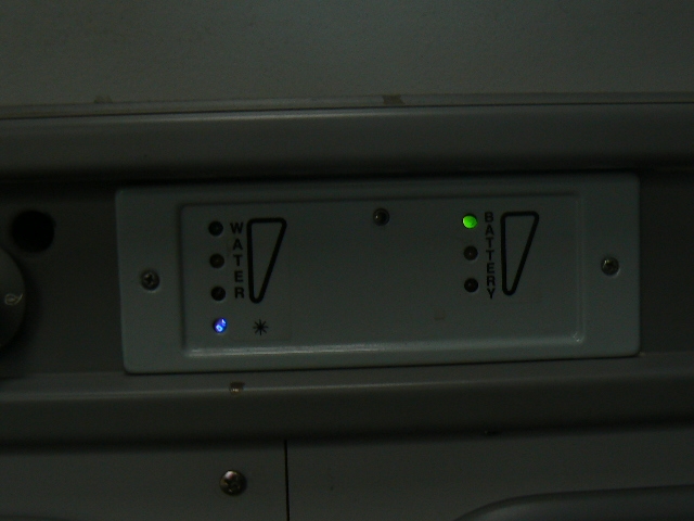

I've posted this a couple of times but I'll do it once more because it's SO much easier:
The sight glass in the Dometic is a royal PITA. Far better way to verify your 'fridge is on is the LED light on the panel. If yours is dead or really dim, the Radio Shack p/n for a blue 'fridge-is-on-and-attempting-to-cool-your-beer LED is 276-316:
It's an easy fix. You just have to get the polarity of the LED correct. One lead is a hair longer than the other (but I can't remember which way it goes in. If it doesn't work, reverse the LED and its should come to life). _________________ 1984 Westy with tencentlife power! |

Hi MootPoint, I was going through a similar situation the other day and found that my light works on ac but not when on propane. _________________ 89 wolfsberg weekender carat

The 4th light on the left with the * symbol is for the fridge. It glows bright on 12 volt and glows dimly when the fridge is lit on propane. But there is a delay after it is lit for the voltage to come up enough to light the led. Same delay when the flame goes out. And some are brighter than others. To get around that, I hooked up a multimeter to read the signal off the black wire from the thermocouple that feeds that led. That is SO MUCH better than any other method of seeing if the flame is lit and it tells you a lot more. Totally worth the trouble to figure out how to hook it up. I also pulled out the plastic eye glass and I can see the flame directly through the hole even in daylight. The plastic thing can go right back in the hole from the inside of the fridge to keep the fridge sealed up.

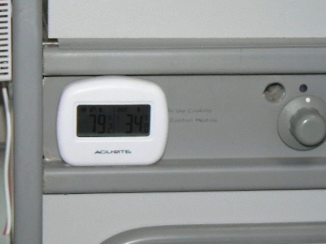

I'm pretty stoked. My fridge ran all night. It was 24 degrees this morning and peaked at 41 degrees this afternoon. A couple pics to prove it.
I did find it doesn't want to light on propane without me running it on 12V or 110 for 15 minutes or longer. My other fridge didn't need that, but I guess they all have their own peculiarities.
Good luck with yours (and to me that mine keeps running) |
