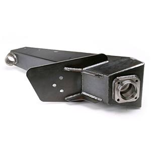

Weld in adjusters on the front of a Thing will get you about 2" before the ball joints bind up at full extension.
The 1" longer arm from Moore is a nice piece. But... it has no provisions for mounting shocks.
Shock mounts can be welded on, but NOT in the stock location for either upper or lower mount
2 OUTER notches on the rear will get you about 3" of lift. It's also all the stock CV's are good for AND you'll need to notch the spring plate for "Droop" or down travel clearance or it will ride REALLY REALLY bad.
Standard Beetle Tie rods ('69 and later) are a perfect fit.
Your stock anti-sway bar will work just fine. If you do feel the need to beef up the front anti-sway bar you MUST add a rear bar to maintain balanced handling.
Lastly... Stock size KYB GR2's would be near perfect, maybe a bit rough. I prefer these front and rear, but they are a bit pricy ($35 each), especially when you add in the required front mounting kit ($26 each).

If you use longer boxed in arms your emergency break cables are not going to be long enough.
I cut a piece of 1"x .120 tubung and welded it through the arm to accomadate mine. I made bolt on shock mounts and bump stops.
The bigger CV's are too heavy on bearings in a stock trannyI was told . I went through all of the trouble to put 930 cv's on mine . A week later I talked to the guys at Rancho and they said to take them off . To get the max amount of drop with stock CV"s without the CV's pulling on the axle clips I machined a an 1/8" spacer to go between the stub axle and CV. It has worked for me.

Love it!!!! Another one headed down the same path. I have the up Yer Bug 3" Body Lift, Cut, turend and adjusters in the front, Mckenzies 1" longer by stock. I changed the tortion bars to stronger ones for the addional weight of roll cage and kids/people in the back on big woops. Mckenzies has 2 shock mounts standard. Spend the extra 75 buck and get 930 CV. Cost minus selling yours to someone else. Yes you do have to leghthen the tubes out of the rear end of the chassie for the E brake then Lengthen the cable at the ebrake handle with a long nut and bolt. I would avoid the longer spindles. Not as strong as the other methods. If you have any questons let me know. I have gone through the gammit of surprises and have over com'ed them all. |

I seem to be stuck at the same spot. After checking with McKenzies and Avery's Air Cooled, nobody makes 1" longer trailing arms that allow you to use the current shock location. They both require you to add shock mounts for the bottom and make your own for the top. Rather disappointing especially considering the steep $640 price tag for McKenzies. Avery's suggested I build a full cage to attach the upper shock mount to. I'm not a welder or fabricator that's trying to build an off road monster. I'd just like to give my Thing a modest lift. Are there any other options out there? |

Why are you so stuck on 1" longer arms?
When a simple 2 spline adjustment will get 3" out of the rear with the stock arms, stock CV's and stock shocks. _________________ --- The major difference between a thing that might go wrong and a thing that cannot possibly go wrong is that when a thing that cannot possibly go wrong goes wrong it usually turns out to be impossible to get at and repair.
