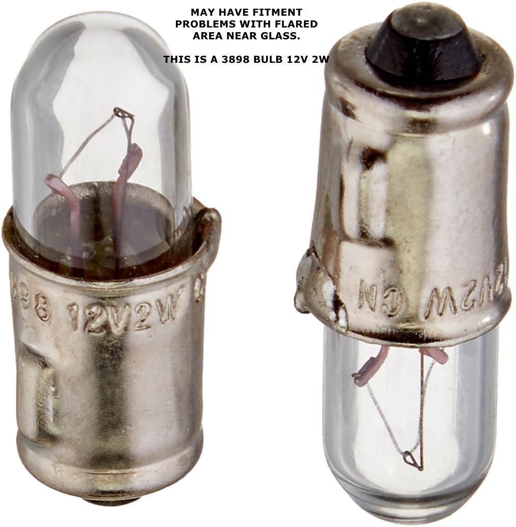

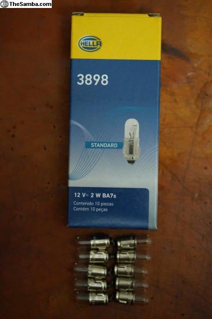

PostPosted: Wed Sep 25, 2024 2:49 pm    Post subject: Re: Part # for instrument light bulbs? Reply with quote
Hella uses 3898 for their part number.

PostPosted: Wed Sep 25, 2024 3:36 pm    Post subject: Re: Part # for instrument light bulbs? Reply with quote
I sell those for $6 a box.
