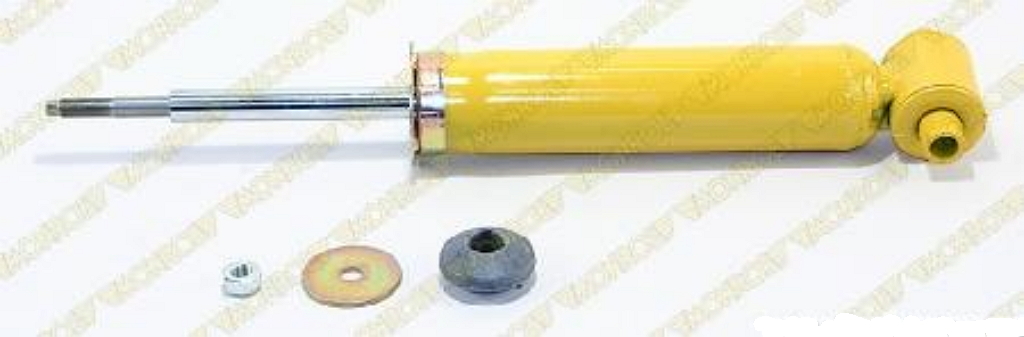

Anybody use the Monroe 34970 shock on a Vanagon?
It is listed as the shock for stock applications.
The part number is mentioned in 3 threads, although nobody states using them.
http://www.thesamba.com/vw/forum/viewtopic.php?t=361395&highlight=34970
http://www.thesamba.com/vw/forum/viewtopic.php?t=351169&highlight=34970
http://www.thesamba.com/vw/forum/viewtopic.php?t=352053&highlight=34970
Compressed Length 10.375"
Extended Length 14.500"
Travel 4.125"
Parts Pack P694
Gas-Magnum Shock Absorber
The Monroe® Gas-Magnum® truck shock absorber is designed for mid to full size, hard working pick-up trucks and vans. These units provide firm control without a harsh ride. With up to twice the fluid capacity of standard 1"" bore shocks, Monroe Gas-Magnum truck shocks work more efficiently with less effort.
All Weather Fluid: Contains special modifiers to reduce friction and ensure smooth rod reaction.
Full Displaced Valving: Better valving range on both the compression and extension cycles of the unit for a smooth comfortable ride.
Sintered Iron Piston: Stronger than traditional metals, enhances durability for longer service life.
Nitrogen Gas Charged: For improved ride and handling, helps maintain tire to road contact by reducing aeration.
"2" Reserve Tube: More fluid for more consistent performance.
"1-3/8" Bore: Lower operating pressure than standard 1" bore units.
"5/8" Piston Rod: Heavy-duty nitrocarburized rod* for long service life.
Special Seal: "Self-lubricating" fluid seal designed to retain gas without excessive wear or friction.

PostPosted: Wed Oct 19, 2011 8:29 pm    Post subject: Reply with quote
I just installed the 34970's in my 82 diesel westy. Installation is easy - 30 minutes each side if you don't have to fight with rusted bolts.
much better than the 30 year old ones I had in there before - just seconds after I shot this picture the old one started leaking oil.

Got a pair on the back of my WBX..no complaints. Surprisingly good deal too..Monroe Gas-Magnum Shock Absorbers were very inexpensive at the FLAPS. Wish I had not just installed Bilsteins on the front at 2x the money. I would have used Monroe G-M up front too.

Any thoughts from you shock techies on the pros v. cons for the Billys versus these? Do they give the same performance and life as the billys? would they work with the GW 1.5 lifter springs?

I only can compare my old ones with the monroes and it's a different world. much smoother ride now. I have the monroe sensa trac coil over shocks in the back. I'm happy with the combo.

I have these on my van front and rear.
I have an Adventure Wagen interior(roll out bed and some cabinets) no pop top. So I'm not as heavy as a full. I run Hancook RAO8 195R14 tires.
My opinion on these shocks is that they kickass. When I'm road tripping and the van is loaded for the good times, they perform great. When I move(seasonal worker/change locations 2x a yr)the van is loaded quite a bit heavier than for road trips cuz all my shite is packed into it, they perform great. On those inbetween times when the van is more or less emty, they give a firm ride ride. Not harsh, but not soft. I always feel very connected to the road you might say. These shocks accel on crappy dirt roads, washboards, gravel, forest service roads etc but still have great pavement characteristcs.
I got turned onto them by my friend who's owned his westy for about 13yrs, and these are about the only shocks he's ever used. His van had Bilsteins when he inherited it. After he switched he never went back. I got another westy owner friend to put these on his van this past summer. He loves them as well. In fact, I drove his westy a bit, to check them out on a heavier van, they seem better suited to the weight of a full westy.
I don't have any techie info for you however, just what I've experienced for myself. Mounting is a breeze and they fit perfectly. Put some blue lock-tite on the threads of the lower mounting bolt(front), mine loosened up after about a thousand miles or so of dirt/gravel roads. The big plus with these shocks is the price coupled with the fact that if one goes bad, Monroe will replace it for free! Also, Napa sells the same shock and my Napa guys said they could take in a Monroe on exchange. The only difference is the box they come in. In fact my rears are from Napa and the fronts are Monroe. The Napa variety are called Gas Grand Fleet or Gas Series 60(one of those is the old name)
tarandusVDub wrote:
They sound like a great deal. Any idea if they would work with the GoWesty 2WD lift springs that are about 1.5 inches higher than stock?
Compare specs:
Travel 4.125"
Parts Pack P694
Napa pt #s
front NS76970
rear NS76971
The local huge Napa central ware house is down the street from our business. I went there and found the following:
Monroe 34970 = Napa 76970 Gas Series 60 = $54 + $7 freight and 3+ days to get.
http://www.napaautoparts.com/Catalog/Result.aspx?N...=3&N=0
Shows two shocks with the same part numbers:
1. Gas Series 60
2. Gas Grande Fleet
Go figure....same yellow shock picture as above, too.
I think I will be shopping elsewhere for mine. I need shocks for my Multivan with stock springs. I will pull the trigger on front and rear. If I do not like them I will sell or use on another project. (My son complains the front of our van bounces too much. I hardly notice it.....)
