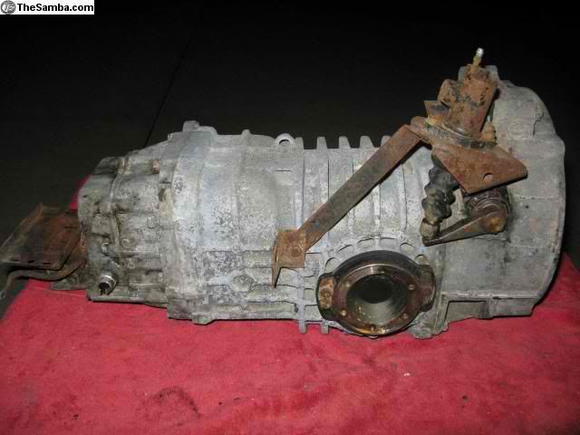

ok so rumaging threw a Junk yard today for my dodge, came across a 81 westy vanagon real good cabinets by the way, I took the Z bed frame and swinging table (for sale) and worked my way around the back of the bus and there sitting on a tire under still connected by the axel's was a 6 rib tranny,
curious to know what, and if it could work in my 71 bay 1776..?? I did see a hydrolic clutch with a lil master bolted to a plate and thats what threw me off, I have been told change the bell housing and nose cone but not sure if there is a difference

Vanagon has a side shifter and I think getting everything to line up in an early bus would be a problem.

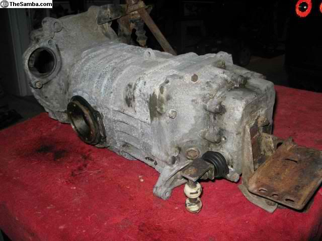

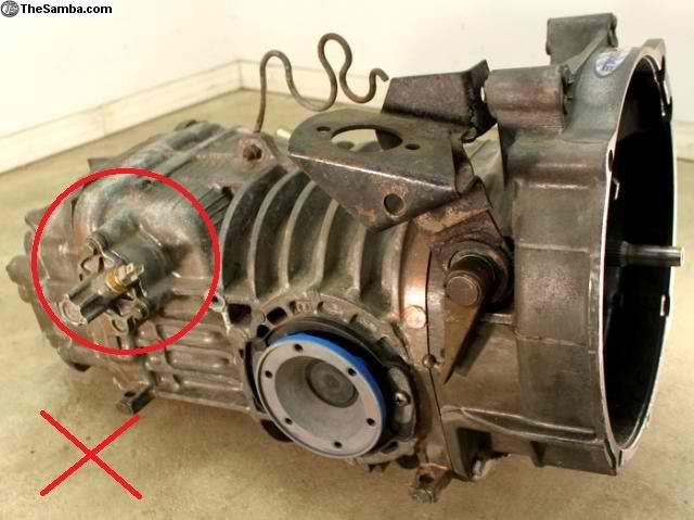

according to this:
http://www.thesamba.com/vw/forum/viewtopic.php?t=143138
which should be stickificated in this forum,
*Note: This is the one that can be converted to nose shift.
Essentially the same as the Bus 091 and can be converted to nose shift.
Found in '80-'83 Vanagons with the T4 engine.
the mid shift can not be converted:
091-Mid Shift
*Note: This one cannot be converted to nose shift.
This may actually be an 094 instead of an 091, but I haven't verified this yet.
Found in '83-up Vanagons with the Wasserboxer engine.
I would verify that it is a front side shift as shown in that photo. If it is I grab it for the core value - hard to go wrong at $50 when they charge $400 for a core, then contact Rancho or another trans builder about converting it.
would you really want to jump from 5.37s to 4.56s in a '71?

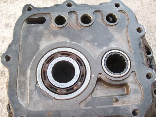

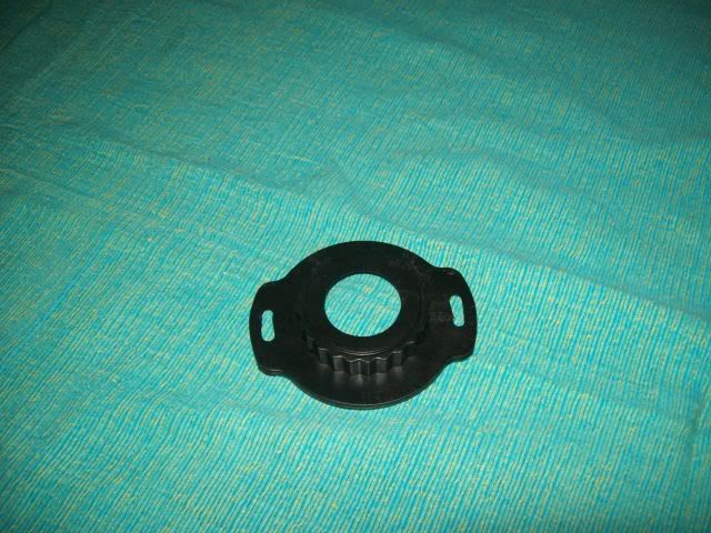

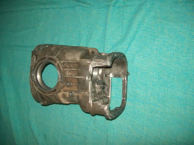

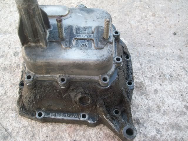

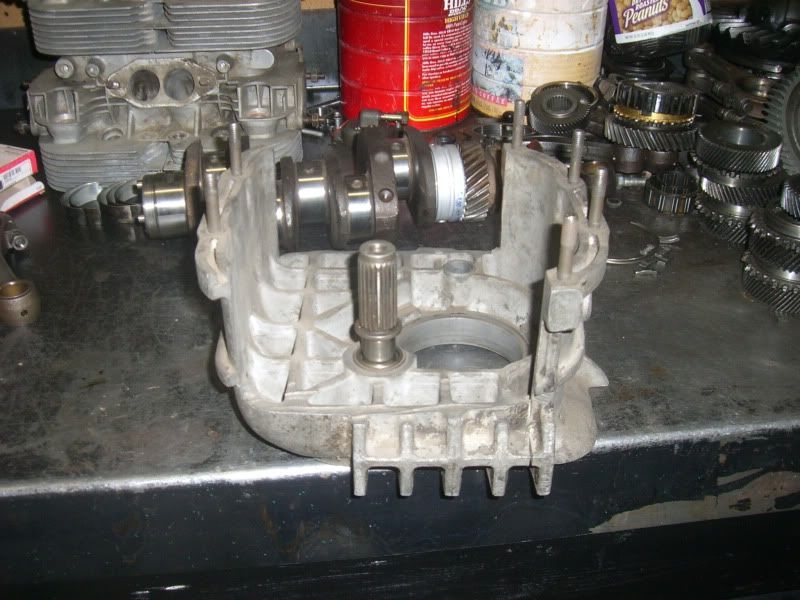

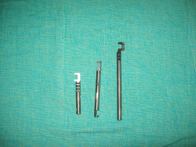

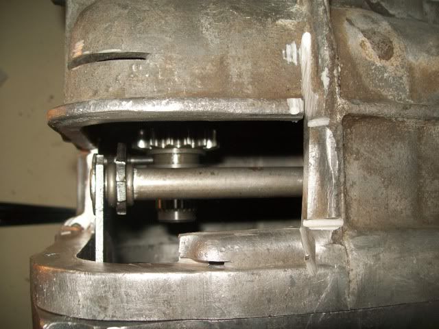

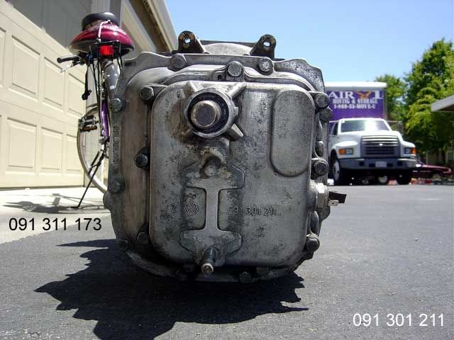

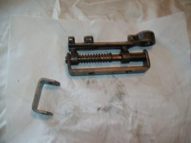

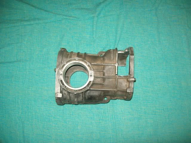

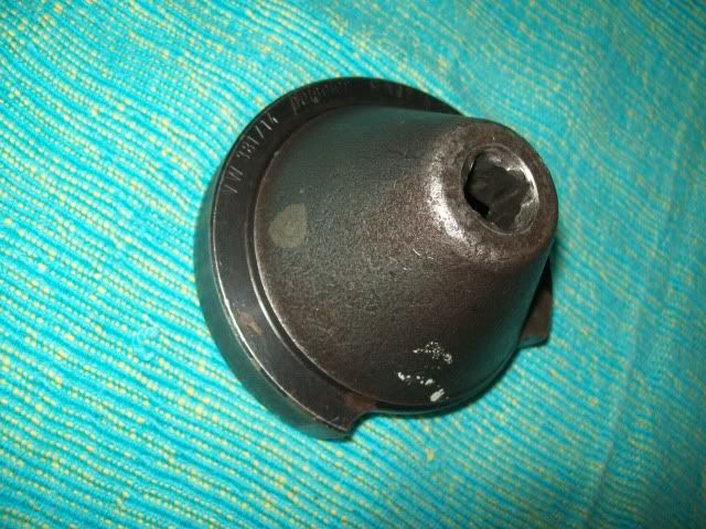

Its not an easy job to converted an 81 trans to a front shift however not impossible to do it.
Get the transmission for that amount you wont regretted.
The codes that you are looking for are DK and DP which have 4.57 ratio and the later one has LSD M-Code 220.
Dont get this one:
You really dont want to swap the pinion,pinion shims and differential from one case to another cause you will need more specified tools to do the job right and have a correct geometry.

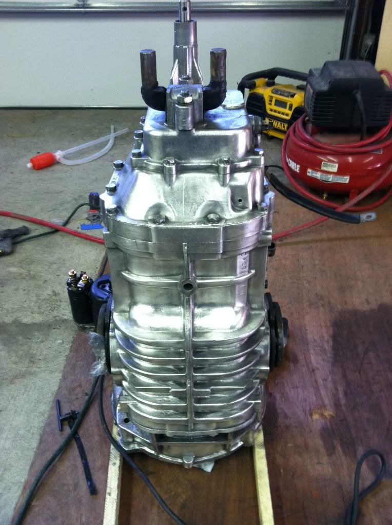

This is the transmission that you need:
You need some tools to accomplish the swap.
VW 381/14 To remove the pinion nut and split the case from the gear carrier.
VW294B To adjust the forks and reverse,if you cant find that tool or its too expensive you must sacrifice a case.
I know its wrong, however you may save way more transmissions this way,trust me on this one.
VW231/15 To remove adjusting ring or start by taping in the beginning and than use one of the covers.
At last you need a press to change the gear train from a vanagon gear carrier to baywindow style and I will explain the cause of it.

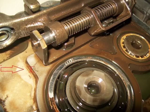

Those are the vanagon fork rails not correct for the job:
It would have been nice to just change the fork rails from a vanagon to baywindow and bolt everything back together and done with it.
However 81 gear carrier does not have the ability to hold the relay lever bracket as it is.
You may drill the carrier and make it work with some spacers underneath the bracket cause the depth is not the same for a correct geometry of the lever.
Not correct in my opinion,its better to have the following gear carrier:
Keep also in mind that if you want to swap gears they must be swapped as a set, not all gears are the same,you dont want a noisy transmission after all this trouble.
Its up to you.
