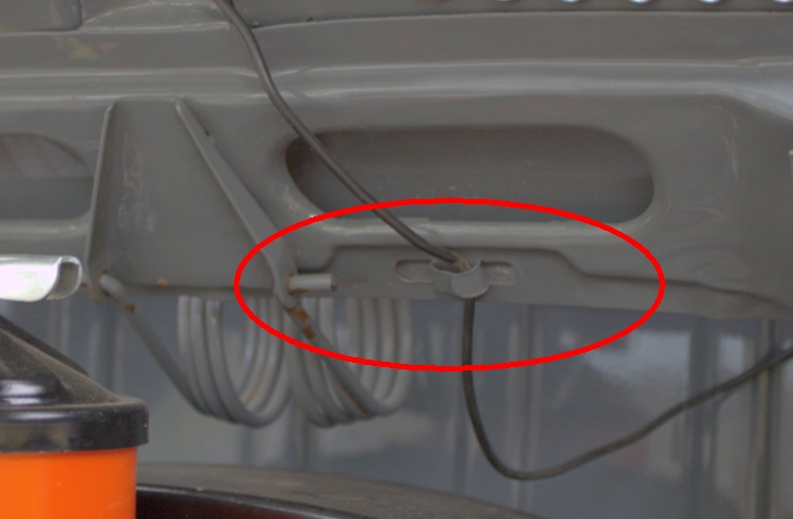

PostPosted: Sat Dec 14, 2013 10:49 am    Post subject: Reply with quote
Thought I would add this here as it brought up an interesting point that was never fully answered
http://www.thesamba.com/vw/forum/viewtopic.php?t=479574
So does anyone know for sure when this indent was introduced?

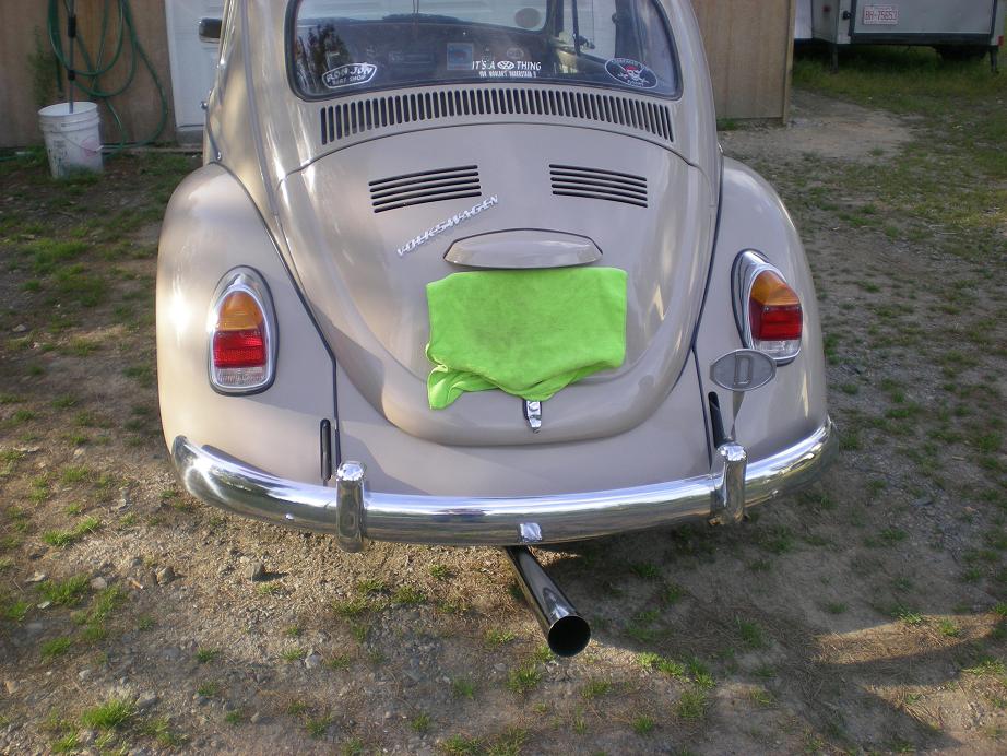

PostPosted: Tue Mar 04, 2014 8:30 pm    Post subject: 67 deck lid on my 74 Reply with quote

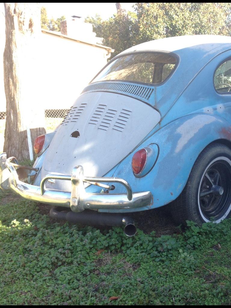

I have a 74 that I have dressed as. 67 by swapping rear fenders, light and other stuff. I found a clean 67 deck lid on craigslist local. Will it fit my 74 standard? Thanks

PostPosted: Wed Mar 05, 2014 2:19 am    Post subject: Reply with quote
No, you'll have to swap the apron.
If you're sticking with the decklid stand offs it would be easier to just run a 68 or 69 decklid if you want the earlier no vent look.

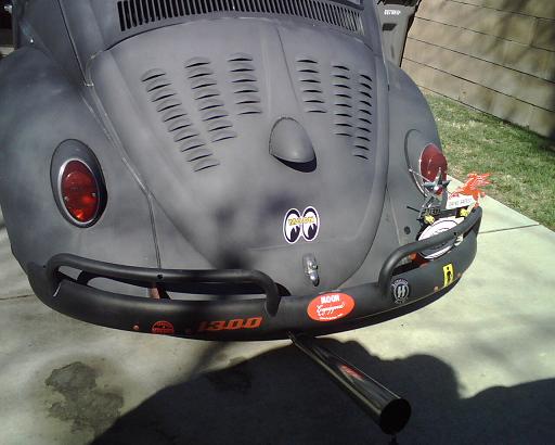

PostPosted: Sat Mar 22, 2014 9:45 pm    Post subject: Reply with quote
This is a 1964 bug but I don't see this deck lid posted. Any info?

PostPosted: Sun Mar 23, 2014 5:47 am    Post subject: Reply with quote
a link
http://www.thesamba.com/vw/forum/viewtopic.php?t=462507

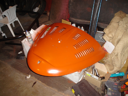

It simply a modified 58-63 lid with punched louvers.
Punching in louvers are a popular kustom touch for some of us.
Its an old hot rod thing..
From page one..

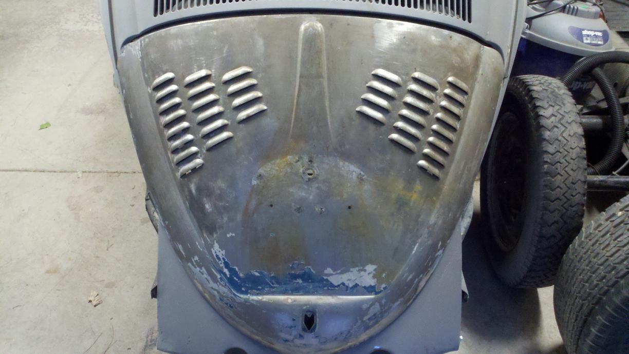

VOLKSWAGNUT wrote:
I have one version of a 1967 modified decklid. It has multiple small press punched louvers. I use it for extra cooling in the warmer seasons.
and some others
Sick for this last one.. Laughing

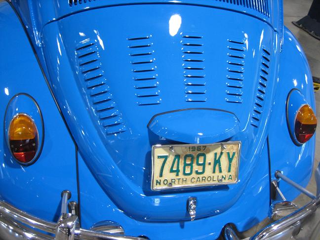

PostPosted: Sun Jan 25, 2015 11:36 am    Post subject: 1967 Deck Lid measurement Reply with quote
Earlier someone posted that the easiest way to distinguish a 1967 deck lid from a later one was to measure it, but they did not post the measurement you would be looking for. If you measure the inside centerline from the leading edge near the hinge spring to the trailing edge near the latch (straight across, not wrapped around the outside surface),
a '67 is 29-3/4" long. The later ones are about 3" shorter.

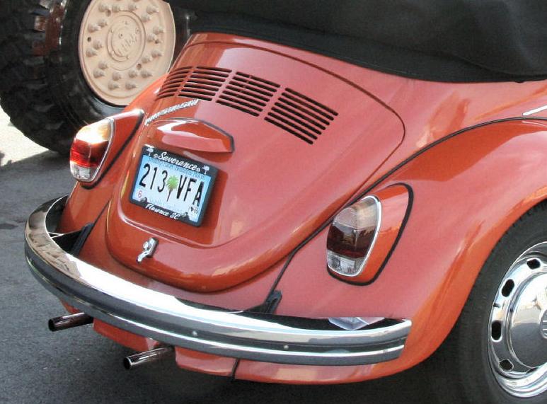

Not sure if this has been brought up -- but the 70/71 vert pattern is 7/7/7/7 vents. In '72 that changed to 7/6/6/7 vents (for vert and sedan) -- actually 2 fewer slots in the middle than the 70/71 vert vent.
I wonder why they reduced the number of vents in '72 -- only to add additional vent under the plate light assy -- or with the 8/6/6/8 config of the later brazil bugs.

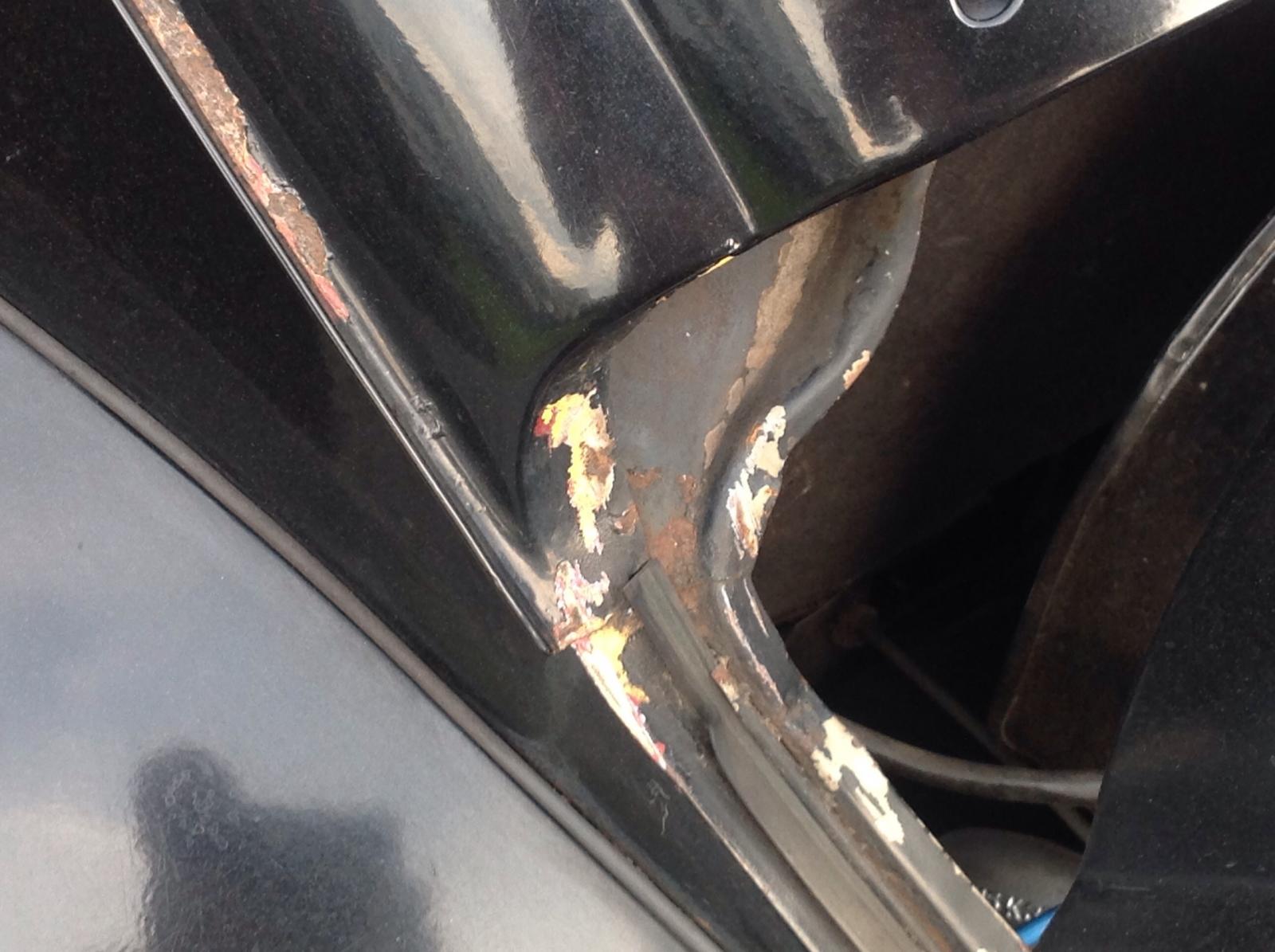

PostPosted: Tue May 26, 2015 5:02 pm    Post subject: Reply with quote
This is my 1966 bug that I just got ,, I need any help you may be able to give I have spent hours trying to get it not to rub and have had no success. Not sure if these are the correct parts or not thanks

PostPosted: Tue May 26, 2015 5:20 pm    Post subject: Reply with quote
Looks like the engine lid is bent, and the spring mount messed up as well. Do you have the other end of that two-piece spring hooked as shown here?

PostPosted: Tue May 26, 2015 6:15 pm    Post subject: Reply with quote
Yes but it keep turning or twisting a little bit,I have straighting and it keeps twisting where it hooks behind deck lid,hope you can understand that if not I can get another pic tomorrow
