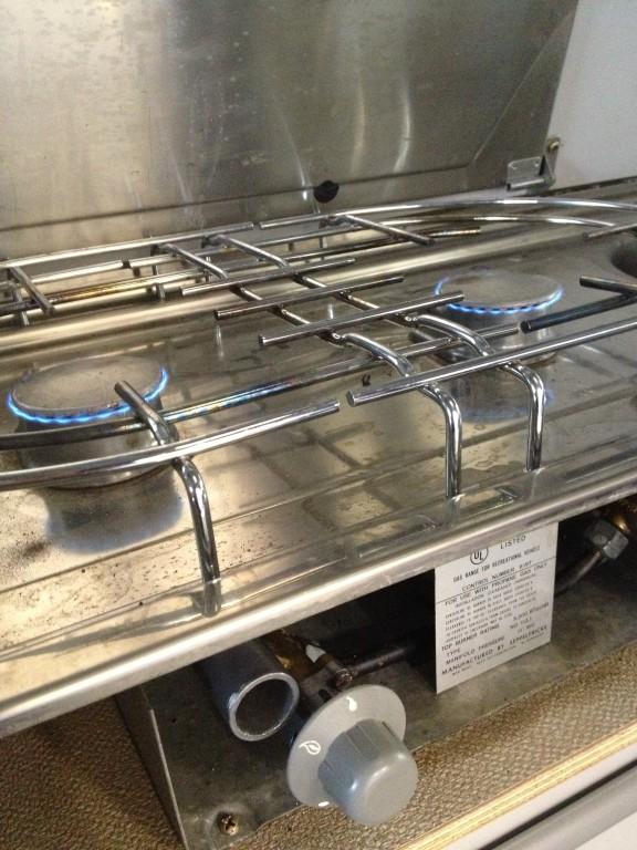

I found the flame control on my stove was pretty unpredictable and lighting it sometimes was an adventure. Seemed like one of the burners didn't want to stay lit when I turned it down too far. Also seemed like the control knobs on the front would occasionally bind making it difficult to light. I couldn't find much written up on the subject other than the occasional comment that it could be refurbished. I assumed something made entirely out of Unobtainium was probably worn out and would require an expensive replacement. I was happy to find out that a little cleaning was all it really needed.
The only “specialized” thing you’ll need is a small amount of heat and propane-resistant type of grease to lube up the parts. I read about rebuilding an old Airstream stoves and the suggestion to use something called “HyHeet Graphite Grease”. I found tube of it on fleabay for under $15 and now have enough to do approximately 1 gazillion vans since the tube is WAAAYYY more than you need for a single service.
My notes on other lube options: one guy suggested using 3-in-1 oil but I personally wouldn't want to run the risk of blowing my van (and myself) sky-high if it leaked. Also learned petroleum jelly isn’t resistant to propane so it will leak. Axle grease? Maybe but could be too thick and might plug orifices. Apparently LP specialty stores sell another acceptable grease so one could check with one of these vendors.
Anyway, on with the job....

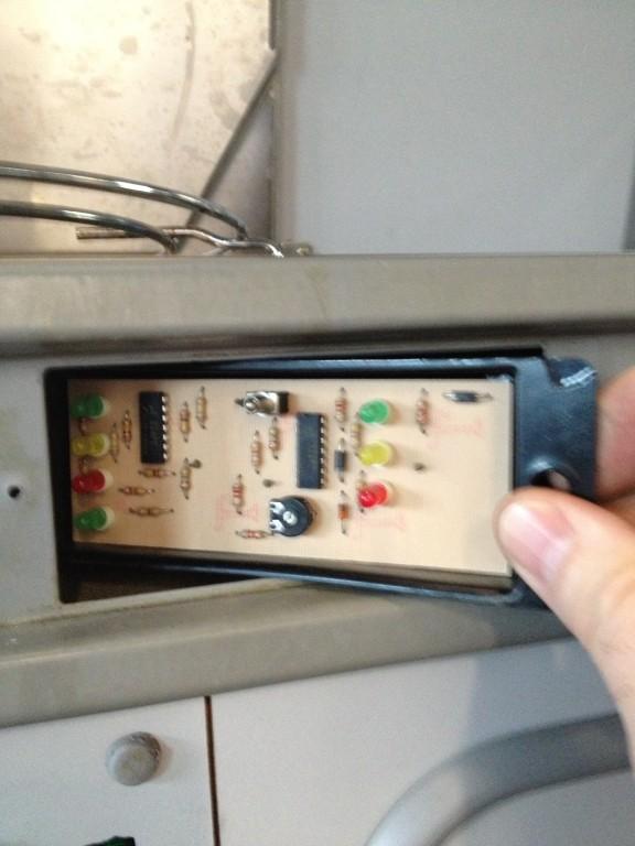

- Unscrew the two screws attaching the LED display plate.

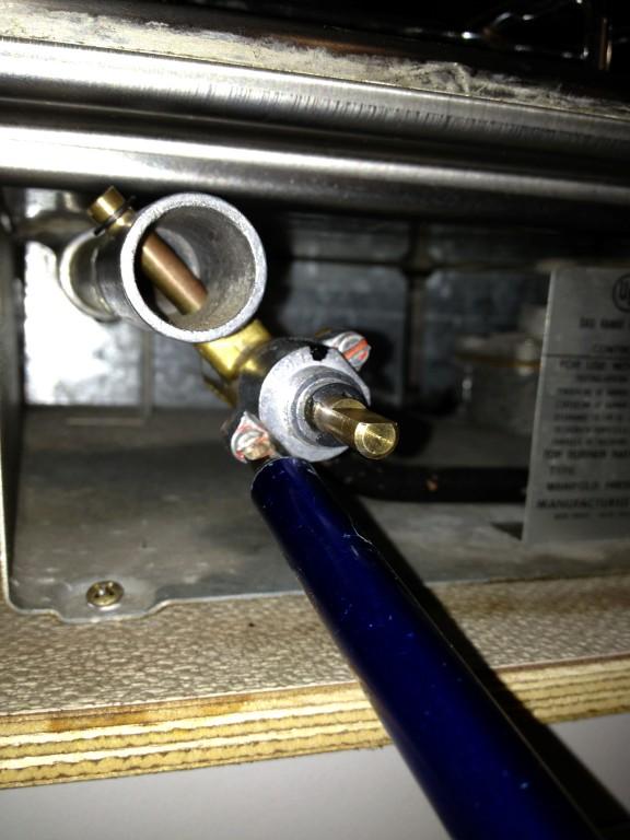

- Now with the valves exposed, use a sharpie marker and put a mark on the TOP of both valve end caps. This is to help orient everything for reassembly. (Trust me on this, I had to pull my valves apart a number of times to get everything back together correctly)
- Unscrew the 2 small screws holding the valve end caps in place; be careful of the little spring that is hiding behind these end caps.

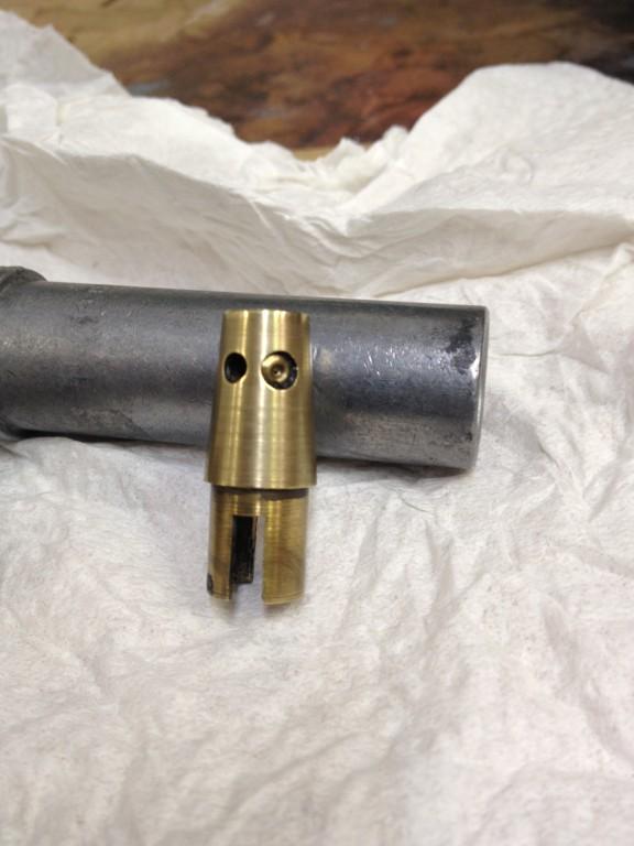

- With the end cap removed, this will expose the end of the brass gas controller. If you didn't move this during disassembly, it should still be in the OFF position. Mark the top of this with your sharpie so you know how to orient it when you re-assemble the valve.
- Pull this brass part out of the valve body and lightly chuck it into a drill so you can polish off the old, varnished grease. I read somewhere that some people use a gritty toothpaste for the abrasive. That might work, but I just used a mild metal polish. Do NOT use sandpaper to clean the brass as this will scratch up the mating surfaces and you will probably ruin the sealing effect!
- Unscrew the flange nut connecting the gas line to the valve body; separate from gas line.
- Pull valve body straight out from range assembly.

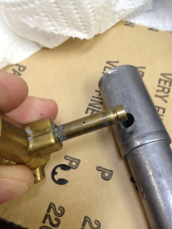

- Very carefully pry off the circlip holding valve body to the hookup pipe. I had a circlip fly off into outer space so proceed cautiously.
- Pull the valve body away from the pipe. Notice the tiny fuel jet hole in the exposed part of the valve body.
- Clean this jet hole and the holes in the brass controller using carb cleaner & compressed air. Pay extra attention to the pinhole in the brass controller (it’s a tiny hole in the middle of a depression). Don’t cram anything in these small orifices, just back-flush them with the carb cleaner. I got little wads of grease out that had been clogging my system when I did several passes.

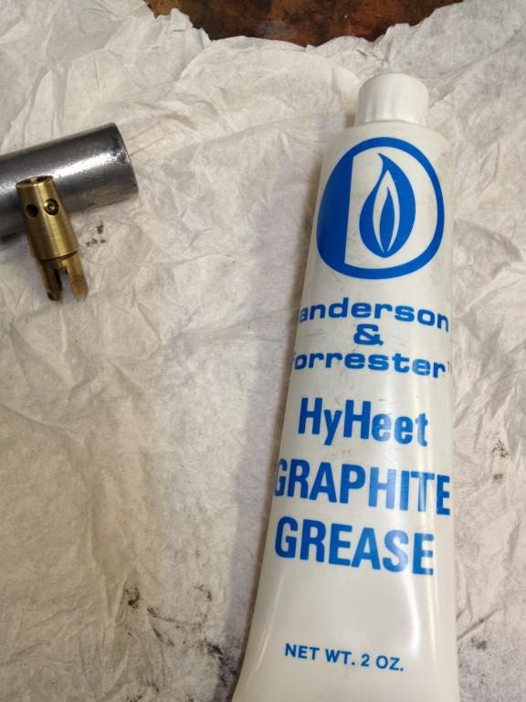

- Once cleaned, apply a small amount of grease to the entire contact surface of the brass controller. I tried to keep the pinhole and ⅛” hole (I think this is the “full flame” orifice) clear to avoid clogging it with grease. I also put a dab of grease on the inside of the valve end cap to lube the shaft for the flame control knob.
- Reassemble the brass controller into valve housing using, minding your ‘up’ direction marking.

my LED and switch sub-panel has a big white AMP connector on it - but I can't get it apart, and can't find any secret tabs, etc. to 'unlock' it
any ideas?

What other types of grease can be used on these valves? I don't have the graphite hy-heet.

When I was searching for an appropriate grease I learned that Vaseline is commonly used.

I used Vaseline. You only need the tiniest smear.

I've got a lifetime supply for every Westy in Seattle (it's a small tube but only a dab...maybe just a dab-ette is needed for each valve) and you're welcome to some (we can arrange a pick-up) but if the Vaseline works you might give that a try. I think you'll enjoy the results.

Just wanted to add to this thread. My burners were burning yellow and sooty, pretty bad. I took the whole thing apart and it turned out that the Oxygen inlet valves, the ones that are right in the front panel, were clogged with what appeared to have been the nest of some small bug or something. I cleaned everything up really well and put it all back together and they are buring a nice blue flame. Thanks a lot for the initial write up, stoked!

Wanted to say thank you to the OP and the rest of the the board. I had resigned myself to never having the simmer work properly, but now it does. Woohoo!
A couple of things I did differently because I didn't want to run to the store or was lazy and seemed to work out still.
I used WD40 instead of carb cleaner.
I used white lithium grease.
I didnt take off the circlet clip. I just shot some WD40 down there and then blew it out.
I also used a q-tip for some of the inside bits.
Really happy with the way it turned out.
