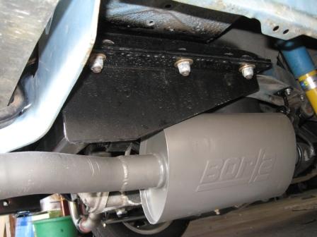

Neil, here is a picture of my custom trailer hitch. I extended the factory bumper bracket to accept a 3 rd bolt. I then sandwiched the sheetmetal between a peice of flat stock I bent up and the hitch I fabricated. Maybe you could do something similar if you are concerned. It is a little hard to see the upper bracket. Basically it is a peice of flat stock bent to 90 degrees. mark
Thanks Mark. Seems the carrier arms I built are similar. (though plate could be longer?)

Neil, you missed the point. I am sandwiching the factory lip between two 3/16 th plates. The upper plate is held in place with two longer bumper bracket bolts and a 3rd bolt further forward that I added by lengthing the factory bumper bracket. I copied the German trailer hitch for the idea. Does that make a little more sense?
Yes. Thanks. And adjusting contrast/exposure of image helped too. I see what you mean.
Neat. Not only is the carrier mounted to a stronger point, but it seems the frame lip only adds to strength and rigidness.

Neil, I could probably take a better picture for you. I don't have a picture of the modified bumper bracket. But basically, I added a peice of 3/16ths flat stock to lengthen the bumper bracket and placed the bumper back on the van. From the factory, the unibody, has a hole ahead of where the stock bumper bracket bolts are located. I marked my extended bracket through the hole, removed the bumper again, drilled the hole in my extension and then welded a nut to the extension. I had noticed in a picture that the European vanagon trailer hitch used 3 bolts instead of two.
So, this really backs up the entire corner. I was going for overkill on the trailer hitch and wanted it to also to be a clean looking install. From behind, all you see is the receiver. It came out so nice, I had it powder coated. I also ran some brackets up to the rear diesel carrier mounting in the valance. It really tightens up the entire rear of the unibody and I ended up incorporating my torque mount into the hitch as well. mark
Thanks for explaining further Mark.
I may not need to do what you did (no trailer hitch), but your solution is obviously much stronger and a great idea. Incorporating frame lip with all concerned is really neat.
