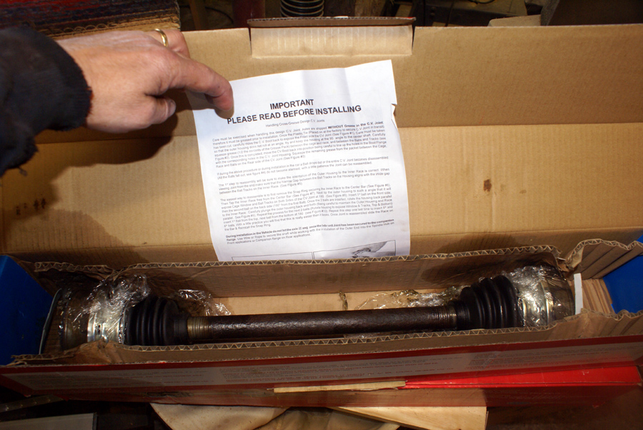

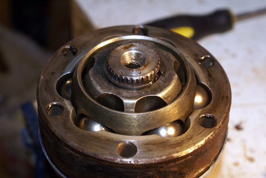

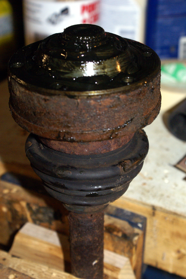

I guess I can answer my own question, now! Yes I can and No don't bother. The axles are
the originals that I have had in my basement for a couple of years, I started to do one side
of one of the axles but lost interest. It's been sitting on my bench since last winter and I need that
space for wood related crap. It's just as easy to take both off and get them to the bench than to
try and get some sort of time savings. It actually was fun, kind of like a puzzle. I used Bens' directions
but the directions that came with my EMPI replacments give a better picture of how they are assembled.
I'll scan it and up load to my gallery, if anyones' interested.
Here are a few pics of the second axle before completion.
Mid way to being done.
All done and back in a box.
