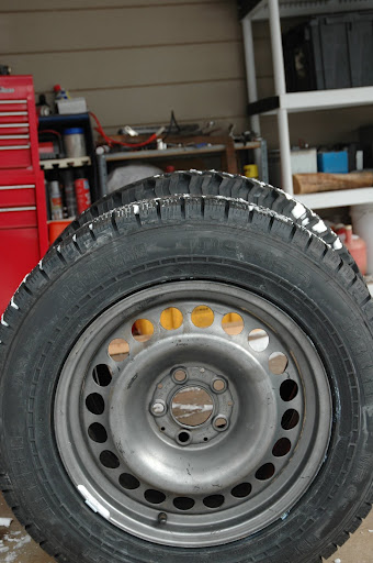

TopBud
Joined: February 28, 2004
Posts: 1104
Location: Flagstaff AZ
TopBud is offline
PostPosted: Tue Feb 28, 2012 3:38 pm    Post subject: Reply with quote
Finally got around to putting on the new tires. I spoke with Peter at van-cafe and he gave me some great suggestions. Jon slider did also- (Thanks). I went with the Nokian WRC 215/65/16 from Van Cafe. I decided to keep the 16 inch tires. I went to Discount Tire in Flagstaff and they charged me $70ish bucks to balance and mount 5 of them to my wheels/rims. We had some snowfall today and I was out driving around. I only put on a few miles, but it was a much quieter ride and handled very well. I can also notice the little bit of the power increase. I am posting a picture of the syncro with the new tires and also a comparison of the BFG's and the Nokian's side by side. I noticed I have a wheel bearing noise in the front now. Oh well, it should be out of town road worthy very soon. Thanks all
The BFG's are behing the Nokian, you can see the difference in size
another shot for comparison.
[/img]
86 bostig SYNCRO
66 convertible Karmann Ghia
