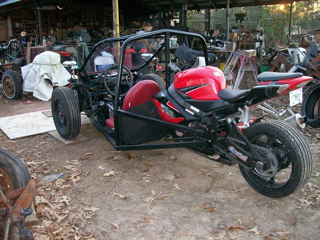

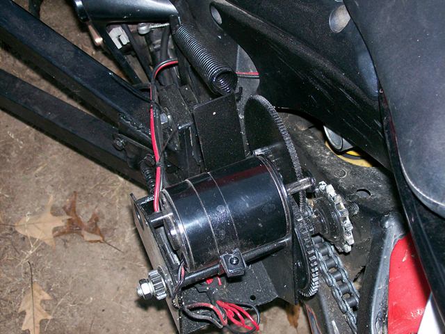

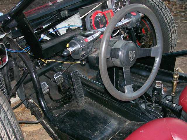

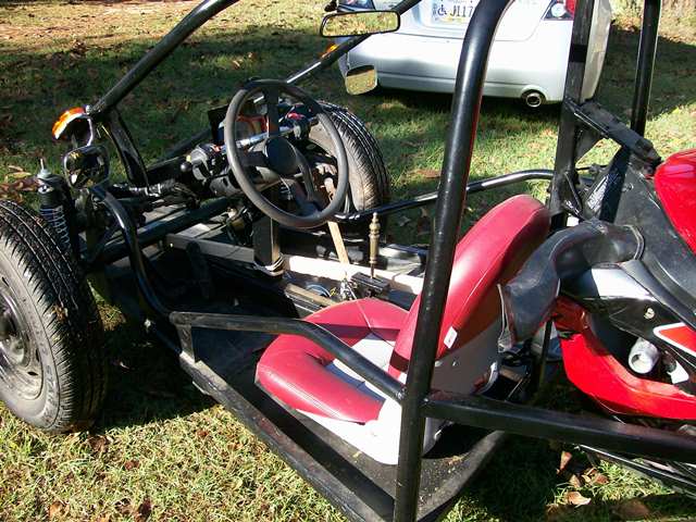

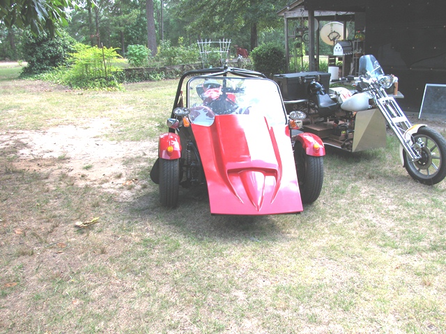

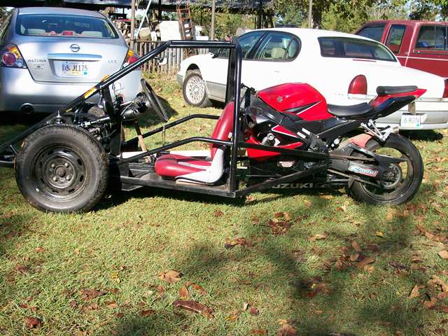

The front end of this machine is a VW. I don't know what year. It's one of my Dad's latest creations. Perhaps you can get some ideas from these pictures. Good Luck!
Reverse...
