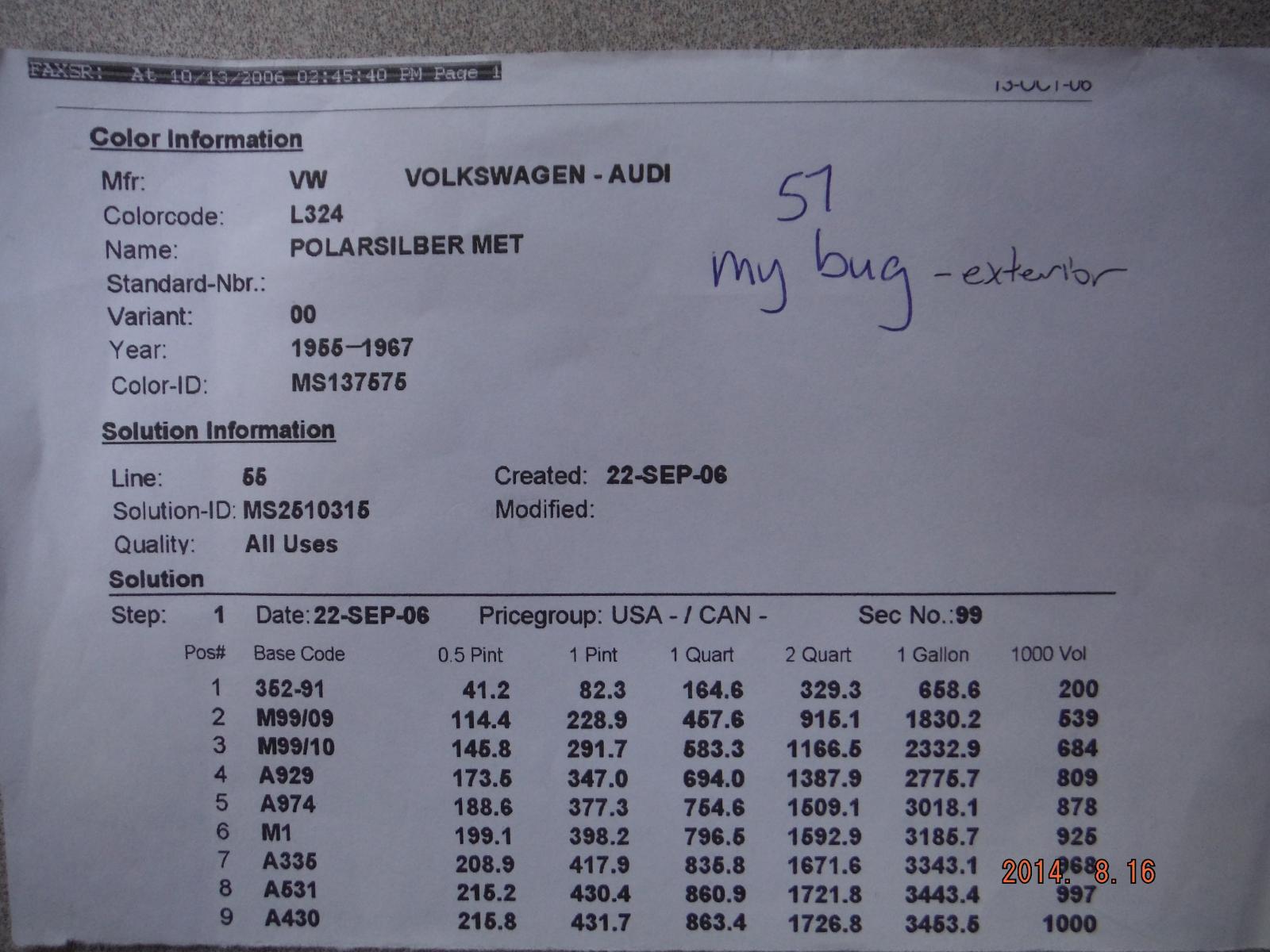

a57oval
Joined: September 28, 2003
Posts: 207
Location: West Seattle, WA
a57oval is offline
PostPosted: Thu Oct 03, 2024 4:21 am    Post subject: Re: Polar Silver Paint Reply with quote
I have a Polar Silver 57. I was fortunate enough to have access to a Glasurit mixing bank and spent about 14 hours dialing in a formula for my car in Glasurit 55 Line which is a basecoat/ clearcoat.
I did mutiple sprayouts after each alteration of the formula to verify it was very accurate. I used an inner door jamb as reference to match the color.
I consider the match very accurate to the original paint.
Peter
