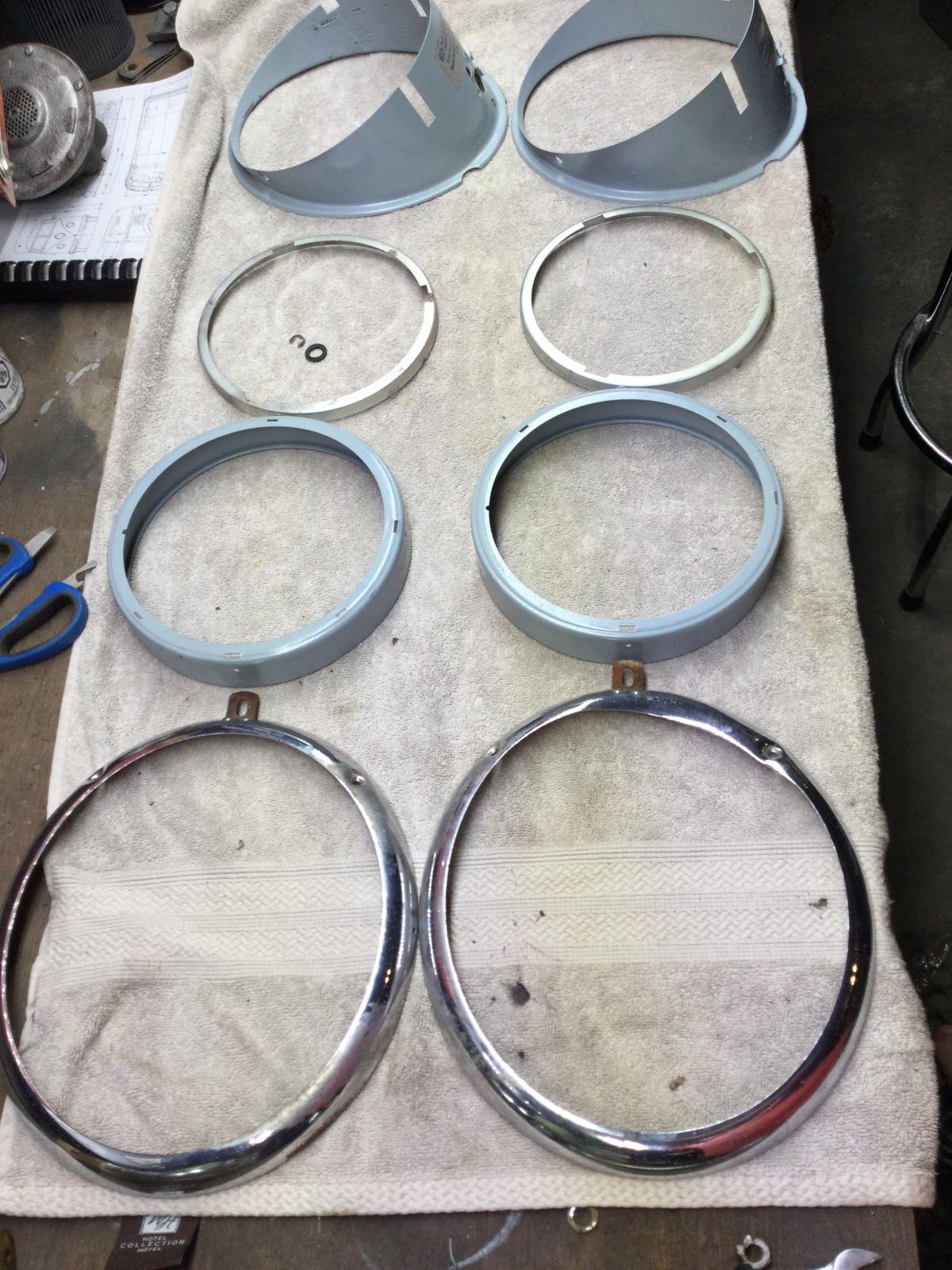

These were removed from a 1964. What it the best way to determine right and left while on the bench. Thanks

Rust pitting would be on the lower side of the buckets and the rings. Tabs for bolt on chrome trim rings towards the center of the bus and the drain hole in the chrome ring would be on the bottom of the trim ring.

Regarding the chrome rings in the bottom photo the one on the left is the right side based on the drain.

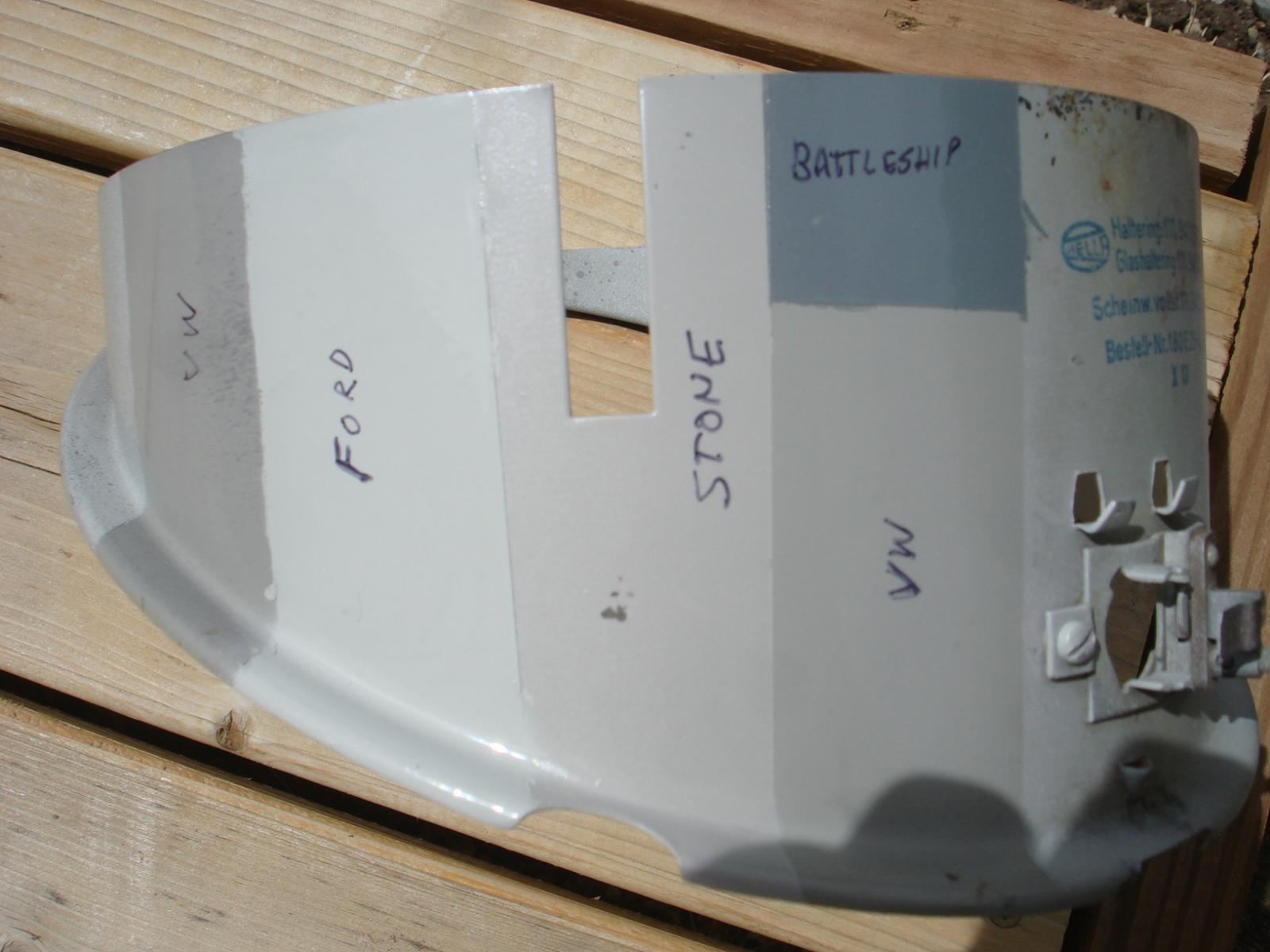

I just went through this. The headlight rings are marked left and right, the buckets themselves are the same. As far as color I tested on some 1962 Bug buckets but they were the same color as my 1965 bus ones. After taking some paint polish and cleaning them up I tried different spray paints. I thought that most I tried (including the Ford tractor gray) were too light, the stone gray was the closest even though it was still tool light and had a pinkish hue. One day I might respray them if I come across the right color.
