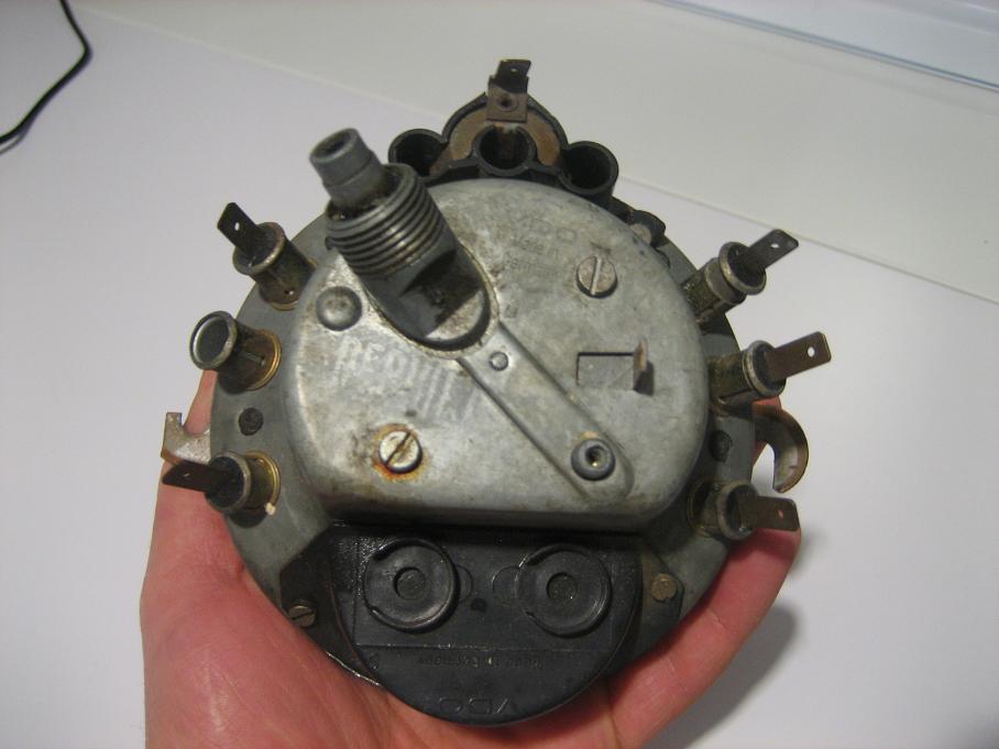

Here's one for the late model crowd. I've had this speedometer for quite some time. Its been used in 2 of my pre 67 cars over the years, and is destined for my current Volksrod project "Operation X". I found it in a box of parts in a car I purchased 25+ years ago. No date code which tends me to believe its a replacement or a "performance part". Its obvious a late model something, as it has ATF and rear defogger indicator. The fuel gauge isnt cut out of the face, and it has a dummy fuel gauge plug on the the back.
It is stamped VDO Germany
It fits a Beetle Dash perfectly.
Is this just a universal replacement?
If not
What was it originally equipped in?
The lack of a fuel gauge perplexes me.

There was a thread a while back, some body had one, the pics are gone now but it was identical to this one although the back housing wasn't cut for a fuel gauge and had no dummy plug.
www.thesamba.com/vw/forum/viewtopic.php?t=484830
General consensus was nobody knows.

Thanks Joel, I searched, didnt find that post.
I found many with 100 mph speedo's with fuel gauges, and I know what those are.
Here is some additional information.
The one I have has no VW stamp, no VW part numbers, It does have an ink stamp "Rebuilt".
Its always been a "keeper" for me.

I would say take it out of the bezel, and look for some more info inside. I did a search and couldn't find anything based on the 825 number you see on the face. Did find one on eBay though, same as yours but beat up.
With all the looking I did, I would say it came out of a Porsche.
http://cgi.ebay.com/ebaymotors/Vintage-Volkswagen-...4cefd62f56

http://www.thesamba.com/vw/forum/viewtopic.php?t=480631
Just found this as well. Same face as yours, but with a fuel gauge cut out. Could be from a super??

Perhaps`75 110 model original equipment?

I have the same one in my beetle, its out of a 75.

All of those "other" speedometers referenced above have fuel gauges.
This one has no fuel guage, No EGR, No CAT, No white center ring.
It looks like 1976 Beetle and newer style face font.
I did find this ad claiming its from a Porsche
I dont think it is though.

I *think* it is from a 1976 "Super Bug" from South Africa which isn't a Super in the sense that it has front struts even though it did have a curved windshield.
I have seen earlier (early '70s maybe) Mexican kph speedos like this without the gas gauge that go to 140, not 160--"oil" was in English. The gas gauge in those cars were rectangular similar to US bugs in the '60s.
I searched for pics supporting my memory but vame up empty.

I think if you look closer you can see that there is an area for a fuel gauge..Mine has all the same lights on it, but mine has a fuel gauge.
Scratch that, I have a 75 speedometer but it's not identical to that.

The last time this came up it was suggested this speedometer might be a replacement part for earlier cars.
I think that speedo would probably work great on my buggy with that cutout on the top rear. The high beam indicator lamp on my 64 speedo gets hit by my wiper linkage, so right now I can't run the lamp.
