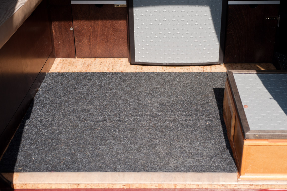

Since my van has a cork floor, I thought I'd chime in here.
The PO had installed this floor, doing a very nice job, and it has held up well for the 2 years I've owned it. While undoubtably it looks very nice, and gotten a lot of compliments for it, to me it is more about the show than the go.
I have bad knees as well, and I do not know where the impression that this is a "soft" material comes from- kneeling on it feels as hard as any other wooden floor.
As well, it can be quite slippery when wet, and the sand and dirt that you will undoubtably track on it will act as an abrasive- if you walk barefoot on it, not so comfortable, unless you are a clean freak, and keep it constantly swept. Not my thing.
What we've wound up doing, is covering the floor with a heavy door matt that we got at Costco, which we give a shake now and then, and every couple of weeks, remove to give the floor a good sweeping. It's a pretty expensive flooring to have to keep covered with a carpet.
If it had been my call, I would not have done the floor with cork, but rather used industrial rubber tiles, like the ones I've used for the door of the fridge, and the cover of the Propex box. I've had this tiling on my kitchen floor for the past 25 years, and the stuff is virtually indestructible, having survived events unspeakable in polite company.
A quick cleaning with any tire cleaner brings it back to new. It's Rottweiler proof, got a good grip when wet, and actually softer on the knees, and feet, than the cork. And MUCH cheaper.
Just my 2cents.
