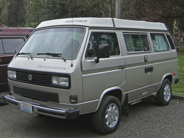

PostPosted: Fri May 04, 2012 11:37 am    Post subject: Reply with quote
Sorry, I kind of forgot about this. I don't have a great picture but this is the best I have at the moment with the new GW zero lift springs. I'll post measurements later. These did not completely correct the Westy lean (side to side or front to rear) though did improve it over the orig springs and I wanted to replace them regardless due to their age and the weight they've been carrying all these years.

PostPosted: Fri May 04, 2012 12:33 pm    Post subject: Reply with quote
Thanks Bill Smile
The ride is definitely firm now but I attribute A LOT of that to properly rated and properly inflated Nokian Tires (205/70 15XL Entyre rated at 100T currently at 49psi front, 51psi rear). It's a little harsh on rough pavement and abrupt bumps, ruts, holes, etc. However, the previous tires made the van feel squishy and it liked to wander some. Now it tracks and handles much better, which I prefer even with the somewhat harsh ride.
Would I do it again? I'm not so sure about the springs, especially since most of the lean is still present and I'd hoped that would be corrected with the new springs. Then again, I figure it's probably not a bad idea to replace 25 year old springs anyway. I have no real complaints but would say this setup may be a little too harsh and changing something in the mix would yield a better ride and I may play around with a little lower psi to get it softened up a bit. A lot was changed at once though. The rear shocks were done last year by the P.O. I added the springs, front shocks, wheels and tires.
For those interested here are the measurements. As I mentioned above, I don't have "before" measurements but can clearly see an increase of 1 - 1.5" if not more based on clearance to my garage door. These are all +/- 1/16th.
Front left: 17 7/16
Front right: 17 15/16
Rear left: 16 13/16
Rear right: 17 3/16
r39o
Samba Polizei
Joined: May 18, 2005
Posts: 9800
Location: San Diego
r39o is offline
PostPosted: Fri May 04, 2012 12:37 pm    Post subject: Reply with quote
Make a 3/8 inch spacer for the left rear and see if it does it. Might need a 1/2.
But that only levels the rear. You need spacers on both sides to make it level front to back.
How's the alignment?
At approaching about 17 1/2 inches all around, I am not sure you can call them zero lift, I think.
That's what I'm thinking - one spacer in the left rear and call it done. I don't care if it's not perfectly level, just get a little closer and I've read here that some folks have had decent luck getting the van level or close to level all around with just a single spacer in the left rear.
Altoona wrote:
Springs aren't going to magically even out the weight distribution of your van.
Nope, but there are plenty of level Westies out there with no spacers so I attribute most of the lean then to aging/sagging springs.
