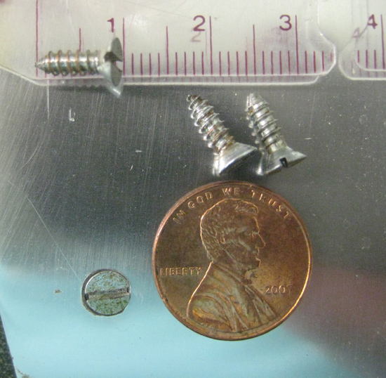

Second owner put these into the door top for the outside chrome trim - http://2.bp.blogspot.com/-owN2bewcQLg/T2OcFR-EHkI/AAAAAAAAAEs/AQSDf9nUbQc/s1600/DSC01249.JPG
Notice how the sides of the Philips screw has been grounded flat. The channel in the trim seems to be fine but had a dickens of a time making the trim finally pop off.
And the screws for the lock pillar ornamental plates were Torx screws. Need eight of those. Or is there a common screw that will substitute?

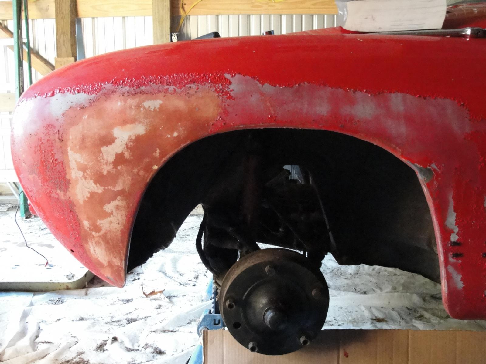

PostPosted: Sat Oct 13, 2012 5:26 am    Post subject: Front fender Reply with quote
John oh no I don't mind the advice.
So here goes a picture. Wink
I decided to strip down the front fender because there was a huge blister under the paint. I was afraid there would be rust underneath. So used aircraft stripper over the whole side of the fender. Waited only a few minutes and the paint bubbled up fast. Wiped/scrubbed it all off.
Safety note - if using aircraft stripper wear breathing protection, eye protection, gloves, and be well ventilated. Still managed to get some of the residue on a wrist and it burned! Surprised Quick wash with water solved it. So be careful.
As the above picture shows there was no rust under all the paint bubble. There is a dent in the wheel arch to fix plus it seems Bondo in other portion of arch. Once I was happy there was no rust, I painted the bare metal in red-brown primer to protect it.
