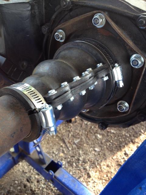

Finally had time for a little more progress. Installed the axles (getting that C-clip installed on each axle was a MO-FO!!), axle tubes, and axle boots.
These are the Wolfsburg West axle boots, but I wasn't too crazy about the clamps they came with, so I opted for radiator hose clamps with the screw head facing semi-downward in case I ever need access from down below. I haven't tightened the smaller clamp yet as I want to wait until after the transmission is fully reinstalled.

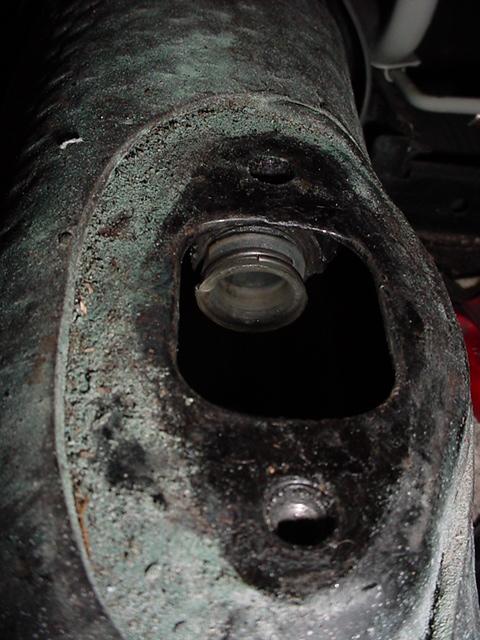

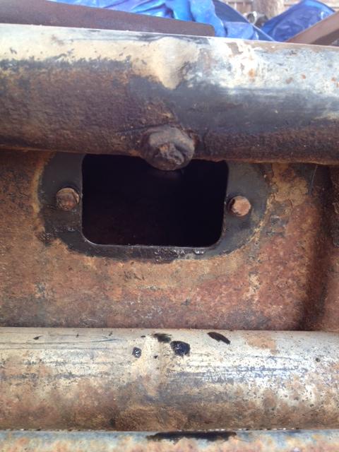

Next, I took on the task of replacing the shift rod bushing that I've read horror stories about. I hadn't even checked the condition of the existing bushing, but since I'm changing out most if not all seals, bushings, etc., I figured I'd change it out too....and it was a good thing because the one it had had disintegrated! So I started by removing the front access plate.
Paused 66 project bug

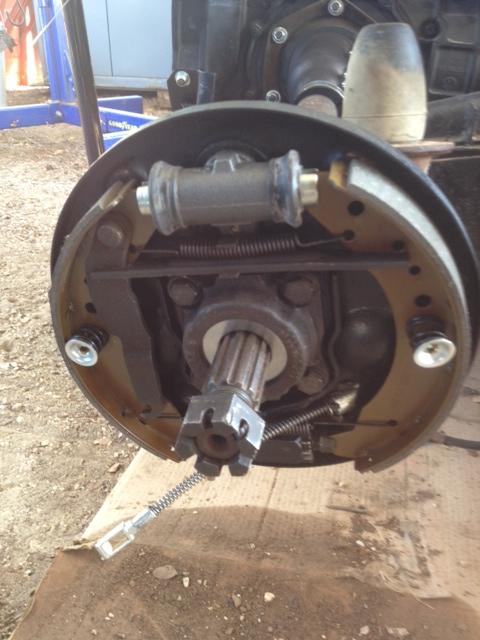

Getting the rear brakes, bearings, and seals done. Had a bonehead moment - was having trouble getting the new brake shoes to go in and couldn't understand what the problem was. Finally dug out the old set I hadn't thrown away and realized I was using the wider front brake shoes by mistake! Hey, it's my first time doing this stuff! Brick wall

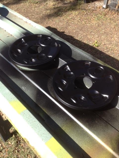

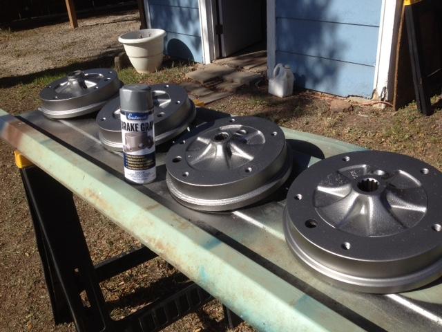

Not a lot of progress, but I did wire wheel my front brake backing plates and all 4 drums. I painted the drums with Eastwood's Brake Gray and the backing plates with Eastwood's satin black brake paint. Excellent products.

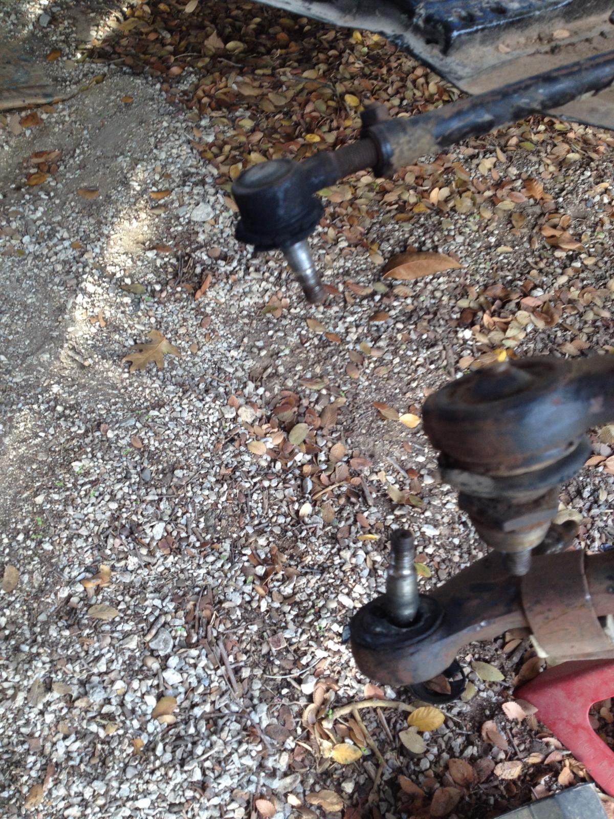

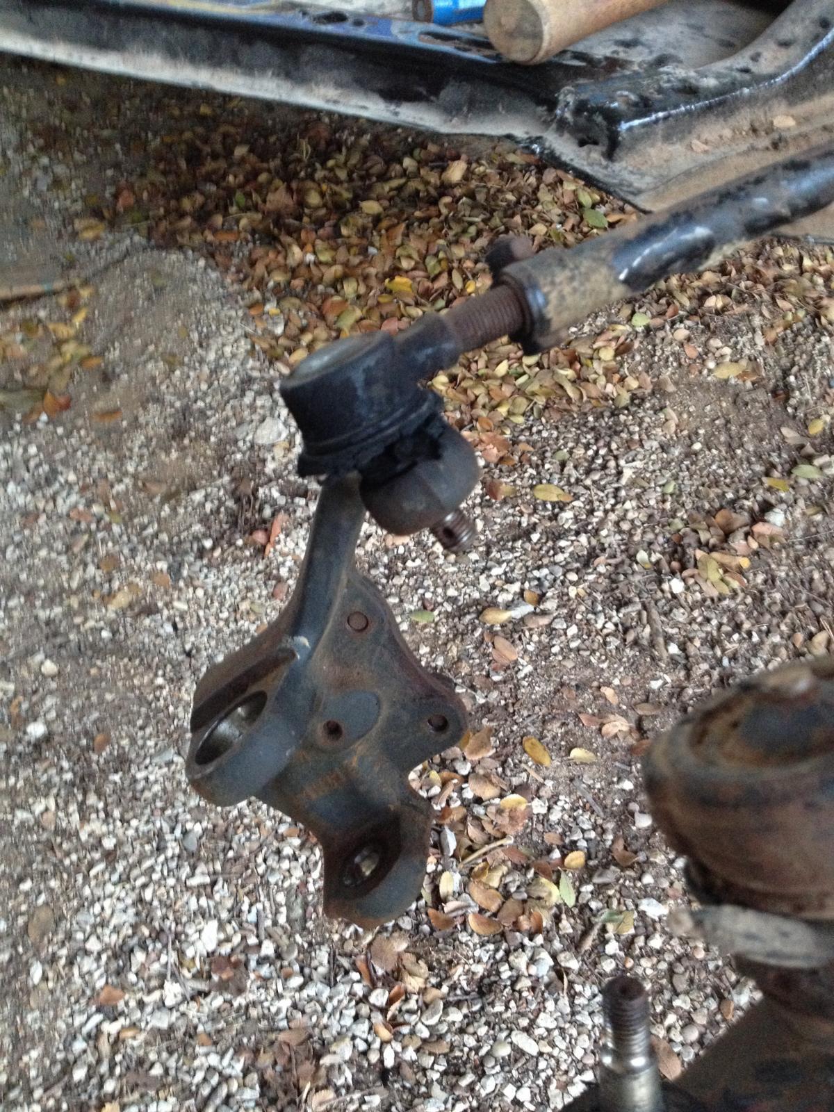

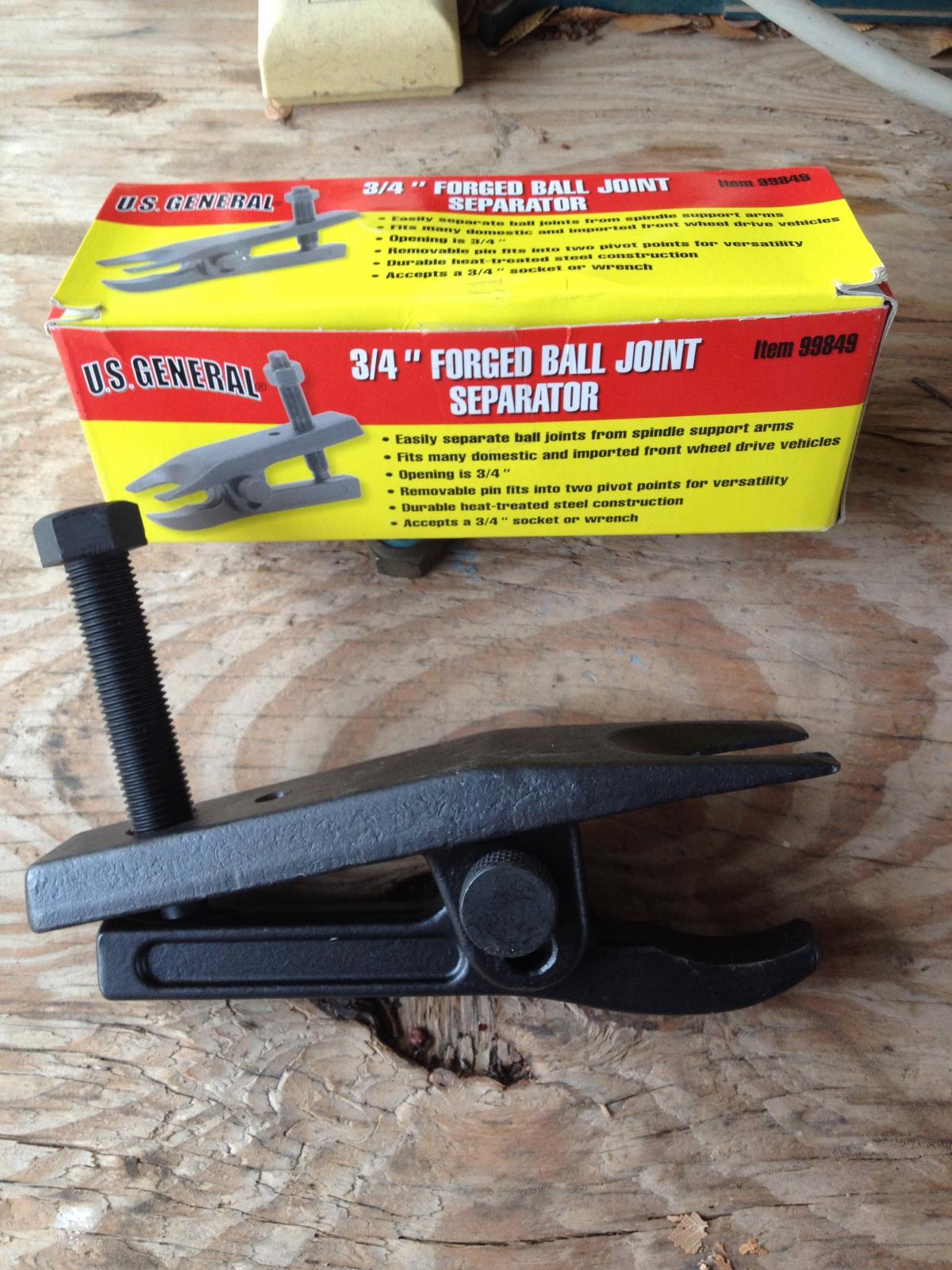

My snail's pace continues. Been having a hellish time getting the tie rod ends separated from the spindles. Tried soaking with penetrating oil for days, that didn't work. Tried heat - that didn't work (all I did was manage to catch the rubber on fire.)
Going to Harbor Freight to see if I can get something to help get these separated. Will update....

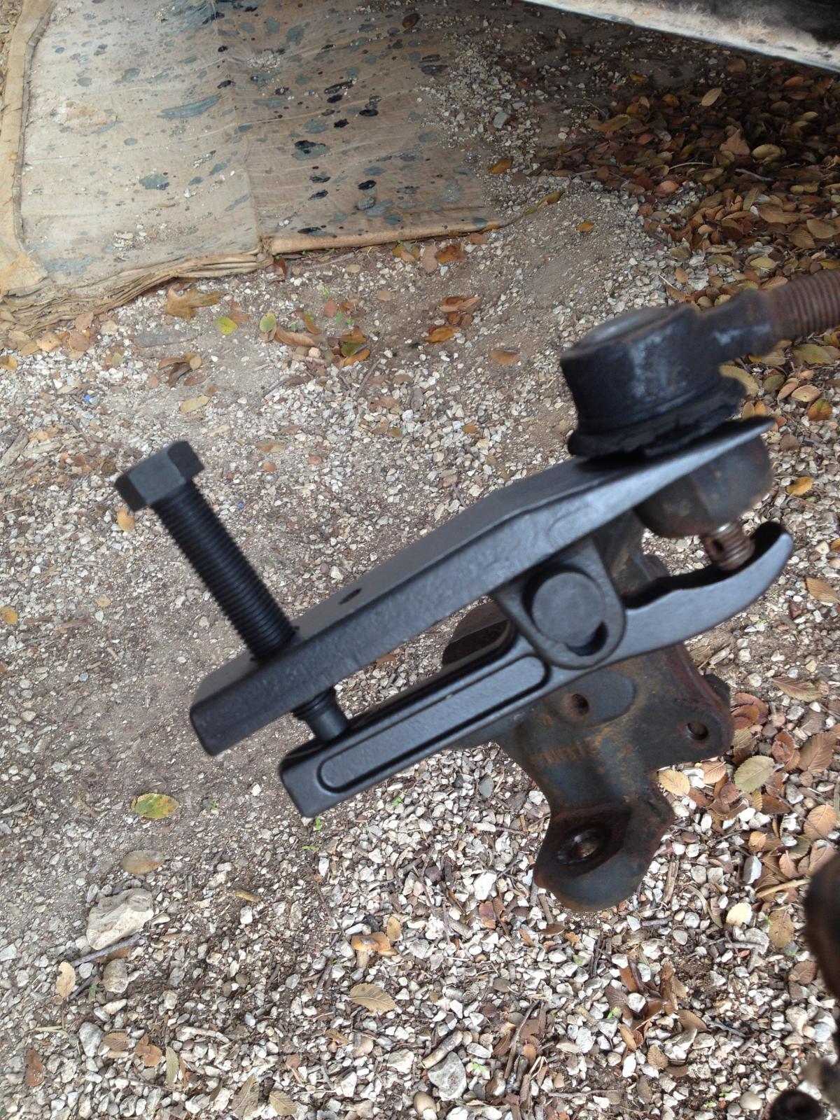

they make a tie rod end separator but I think is $60.00 JCW had it for ten but I never jumped on it now they don't sell it. I've done it with a pickle fork that I got on loan from the local Autozone. I had to make a plate to keep it from slipping off but it worked.
Thanks for the suggestion
I ended up going to Harbor Freight and picked up this ball joint separator for $20
It fit perfectly on the tie rod ends.
A few turns of a ratchet & a 3/4" socket.....
..., and "POP"! It popped right loose. It worked perfectly on all of the tie rod ends.

sportin-wood wrote:
That's great! I need to get one of those.
I tell you what - it really was a life saver (and a knuckle saver as I had banged my hands up pretty good trying to force them off without any kind of specialty tool). I'm sure you can order one online for the same price if there isn't a HF near you.

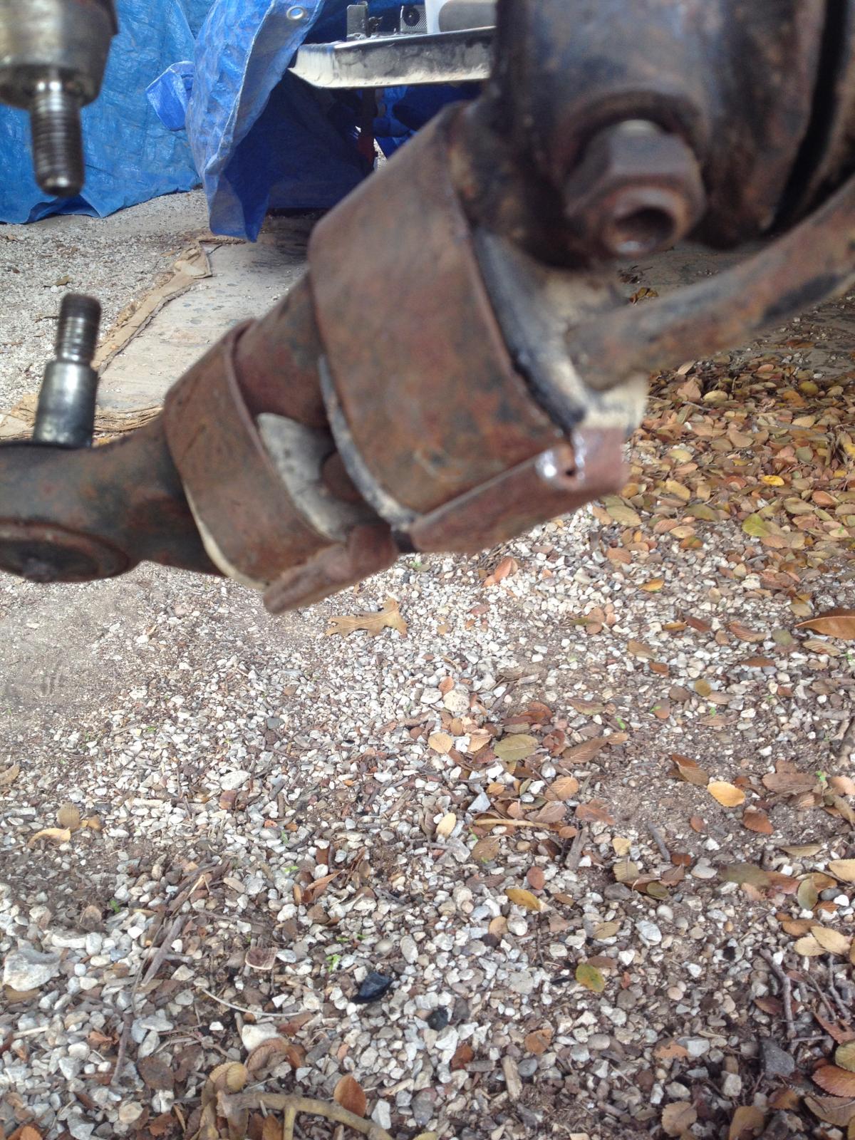

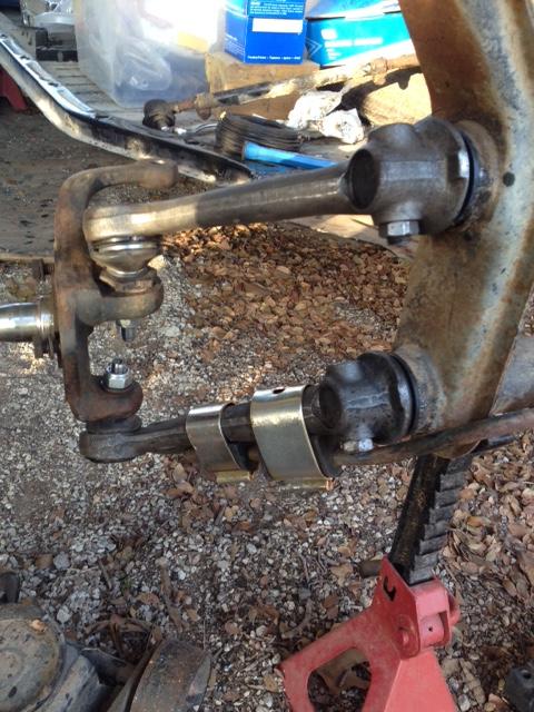

Moving along...took advantage of some decent weather and worked on the front end. Replaced the torsion arm seals, needle bearings, ball joints, and the biggest PITA of the day was replacing the stabilizer bar bushings. The old ones were cracking badly. Another Harbor Freight tool helped out BIG time - it was a giant pair of channel locks I picked up for about $5. It probably took me an hour and a half to change them out. I would recommend the upper torsion arms be removed if you're replacing these bushings. It gave me room to tap down in the bracket with a hammer to get it seated against the lower torsion bar while pinching on the bottom part of the bracket with channel locks in order to slide the retaining sleeve on.
Next will be the tie rod end replacing, mounting the shocks, installing new brakes, brake lines, master cylinder....man, I really need to get busy! Razz
