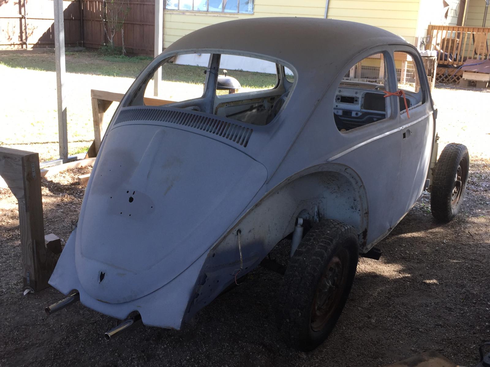

PostPosted: Sun Oct 29, 2017 7:31 am    Post subject: Re: '66 Project build on a budget of budgets Reply with quote
Enlisted the help of a couple of guys from work to lift the body off the body dolly, and onto the chassis.
It's nice to see it as 1 piece again - it's been a long time.

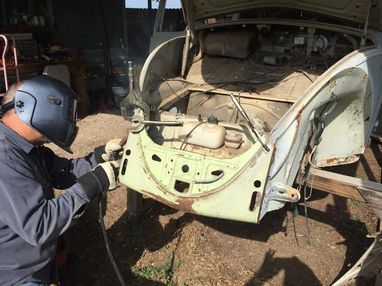

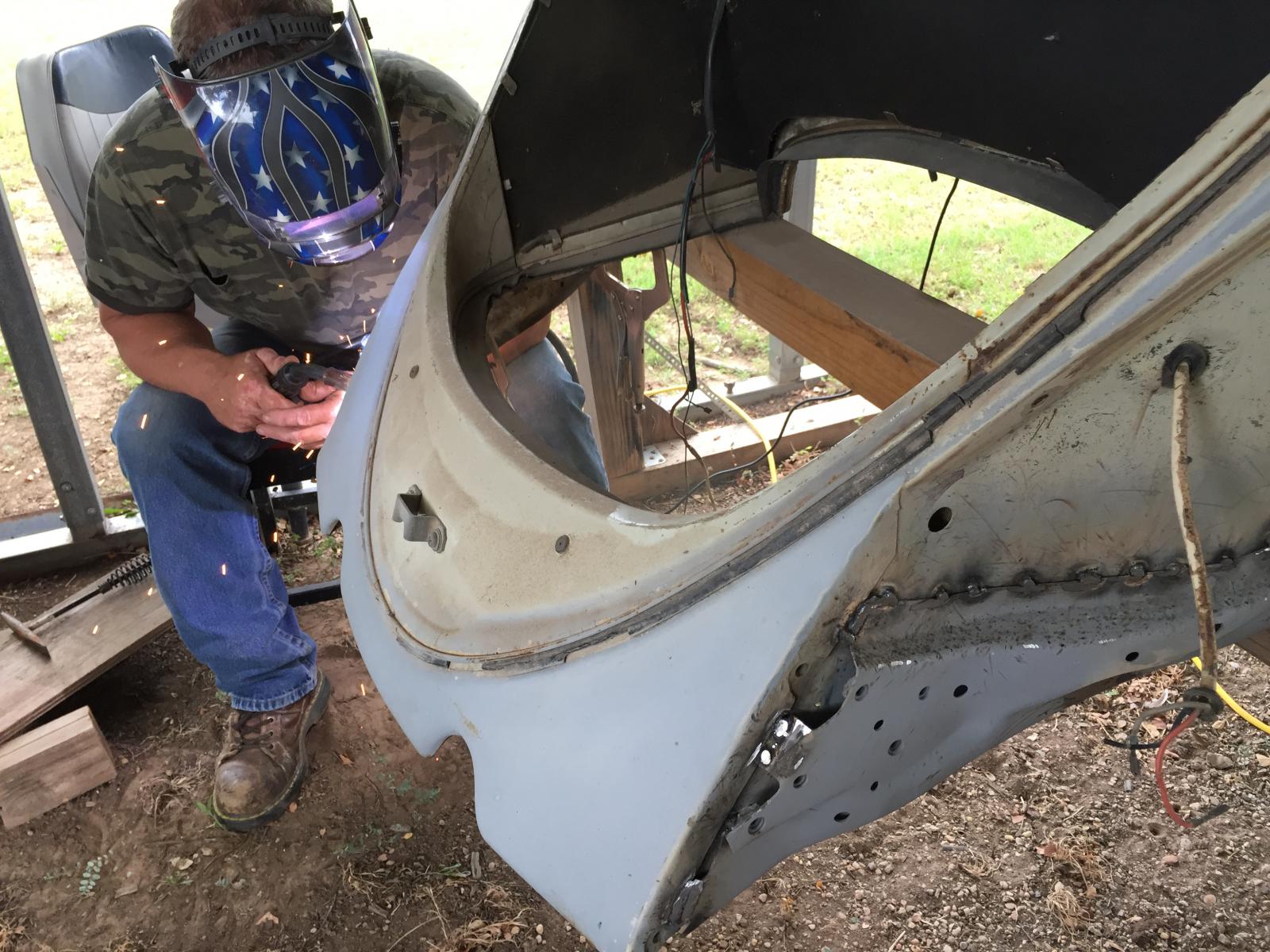

Took advantage of nice North Central Texas weather and had a buddy weld up my rear bumper mounts.
I also had a fender nut welded in place on the driver's side front fender area as well as a flange nut for the driver's side headlight bucket, but I made the mistake of trying to run a screw through the nut, not realizing there was some slag splatter on the threads that eventually caused the screw to bind and subsequently snap off. F@CK!! Next step is to try drilling out the screw without srewing it up completely....

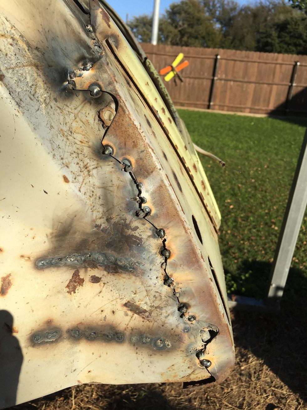

PostPosted: Mon Dec 26, 2016 9:58 pm    Post subject: Re: '66 Project build on a budget of budgets Reply with quote

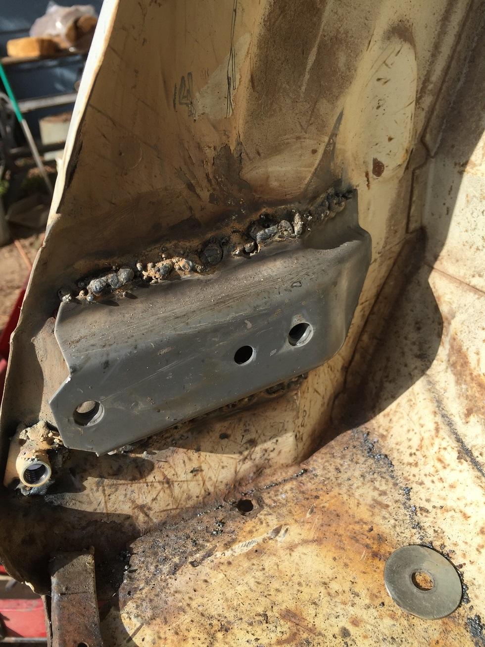

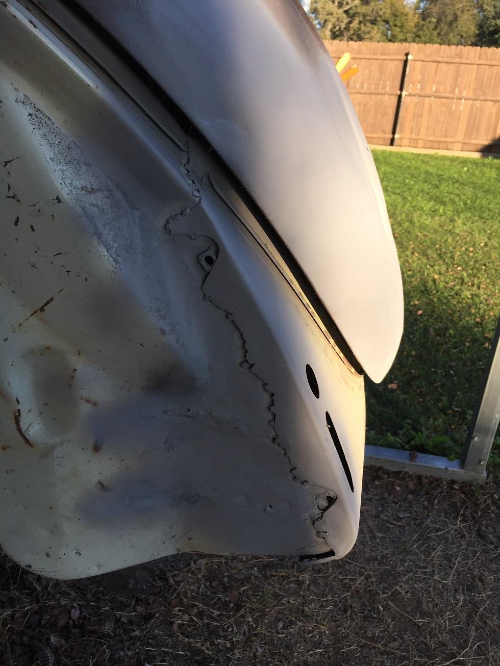

EA812 wrote:
I hate to point this out but all that rust and paint had an effect on them wields.
Actually, there isn't much rust, if any, in the welded area. I have a crappy MIG welder that my buddy was using to weld with. The wire feed wasn't working right, and the intensity setting didn't seem to be working. But the welds are holding really good, which I'm happy about.

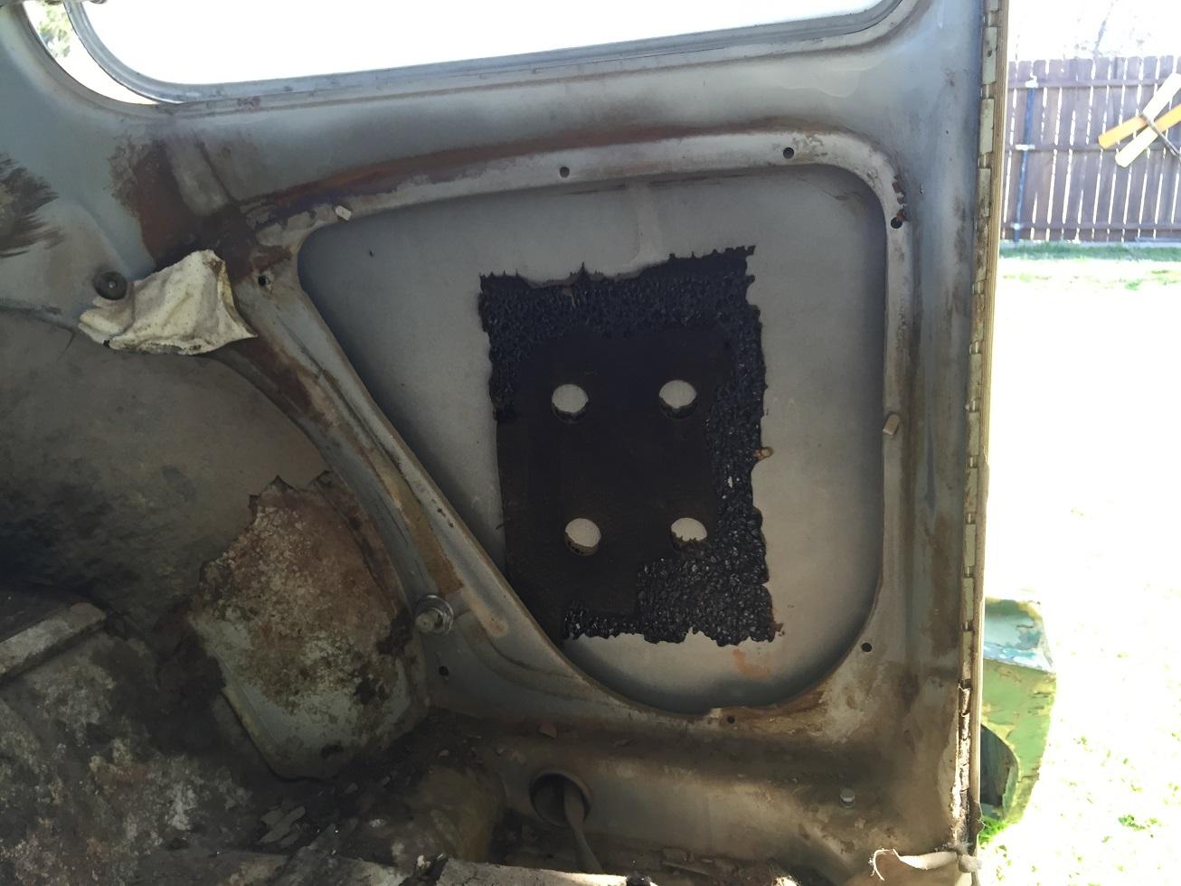

I took a few minutes to heat the door and quarter sound deadening tar boards with a propane torch, and they came off like butter.
Before
After
The sticky residue came completely off, but left a brown staining, which will be sanded, painted, and covered with new sound deadening anyway.

PostPosted: Sun Nov 13, 2016 7:16 am    Post subject: Re: '66 Project build on a budget of budgets Reply with quote

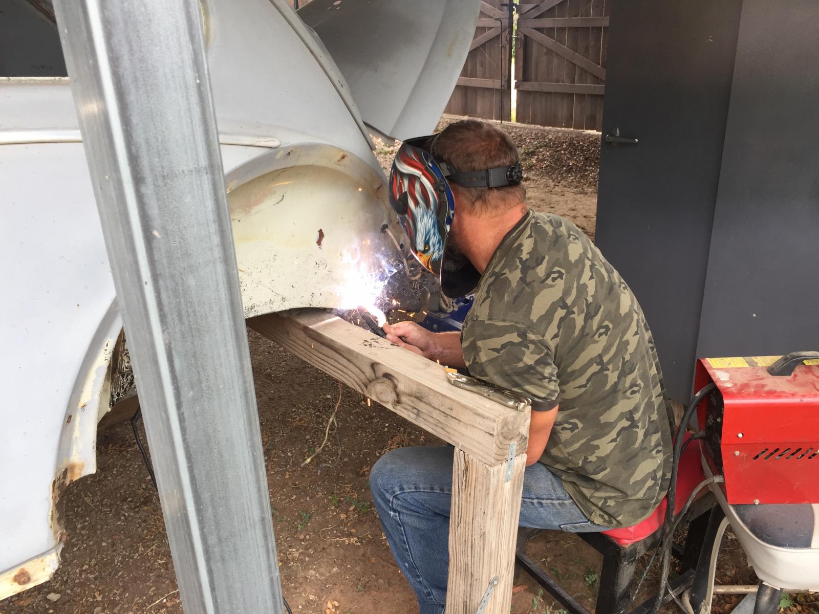

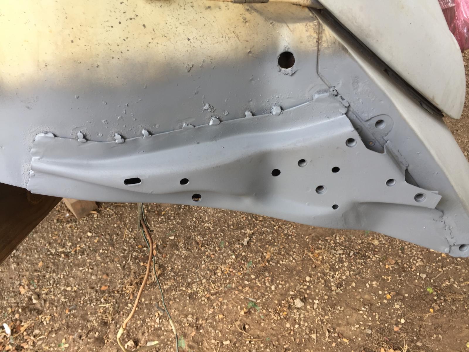

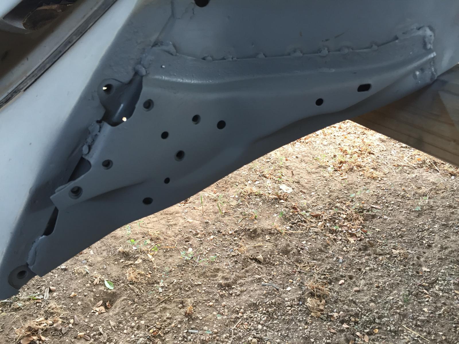

6 months later and a little progress update. Had the passenger side front bumper mount, 3 fender weld nuts and front apron welded in place. It's not pretty looking, but the slag is being ground smooth with a flap disk, then coated with some rattle can primer,

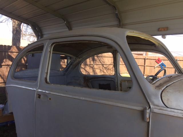

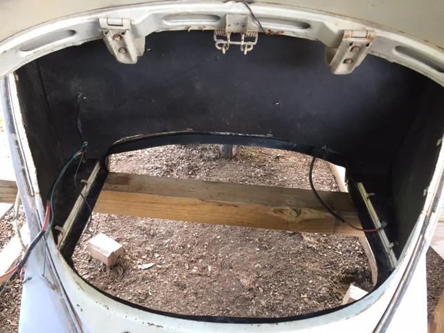

Try running a wire brush over the rust below the rear window . If you get holes through the metal you can replace it ......If you don't get any holes you can ospho it and surface fill and paint it .

Try to find some 18 gauge flat steel, (Ace hardware) or true value. Since most of the steel around your window bottom seems to look good your only dealing with flat stock with a L bend for the window.Make a paper template of the offending area's and go from there. I believe you have a welder? just make 4' sections and weld it all together. Or longer if you can. You can do. think it through and get it done.
You need to get this Beetle back together and start driving it. Your so close, Baby steps Man. I'm trying to give you some motivation here. Very Happy

lovethatconvertible wrote:
Good to see your getting closer Dave. You should just section in some new formed metal on the back window. make a paper template and get er' done.
Keep us in the loop.
You make it sound so easy! Wink What gauge metal should be used back there? Keep in mind that I'm clueless when it comes to metal fabrication. I'm amazed at some of the work guys do on their builds...

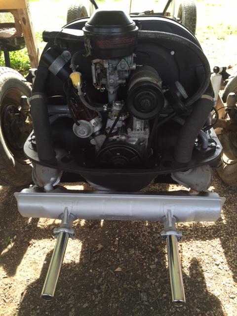

Was the voltage regulator on the engine when you brought it in? It usually gets put under the back seat on the12 volt cars. That may be why it wasn't installed.
Yes, it was mounted to the fan shroud. The shop that rebuilt the motor said they "assumed" I was going to mount mine under the back seat, but I'm not. I'll be mounting it on the fan shroud again.

I finally got my chassis and rebuilt motor back. My only complaint was after my 2 hour drive home, I noticed they had removed the voltage regulator and never reinstalled it! Not sure what the thinking was there.
[img]]
Looks like progress to me! Was the voltage regulator on the engine when you brought it in? It usually gets put under the back seat on the12 volt cars. That may be why it wasn't installed.

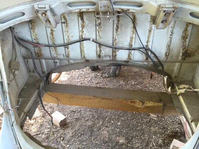

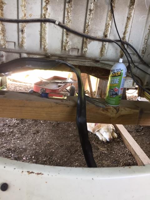

I ordered the firewall tar board kit from WW as well as the front & rear engine to body seals that needed to be replaced. I figured while the body was still off, it was the best time to do it.
I first installed the engine seals. Whoever said it was easy to do is a lying SOB! What a PITA! Took me about 1 1/2 hours. The silicone spray I had read would make installation easier didn't really help. I had to push the bottom half in, then push the top part in about 1/8" at a time with a screwdriver.

I removed all of the glass & old window rubber, as well as the door window mechanisms.
Discovered some rust at the bottom of the rear window. Not sure what the best way is to fix that. Any thoughts??

Before everyone starts in on the fuel filter, I know. It will be moved. Laughing
