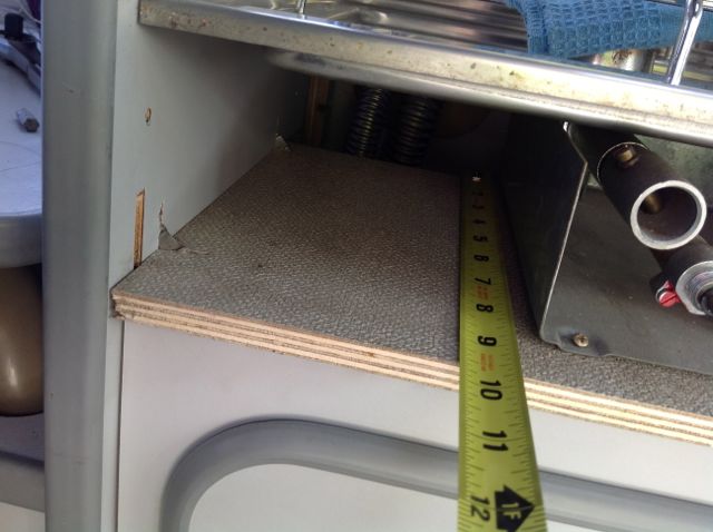

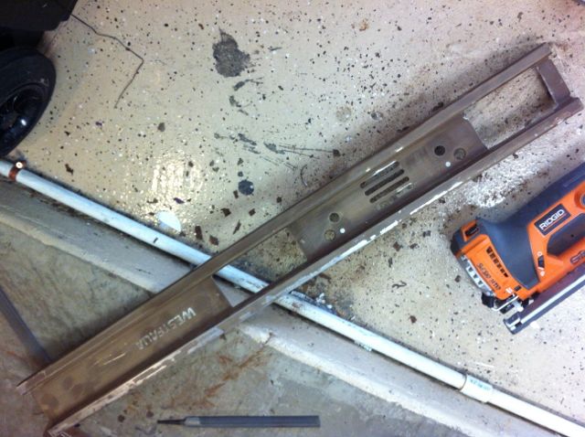

If you look at the area left of the burners, there is some empty space in there:
The back of it is ventilation for the fridge, but we're not going to go so far that it matters.

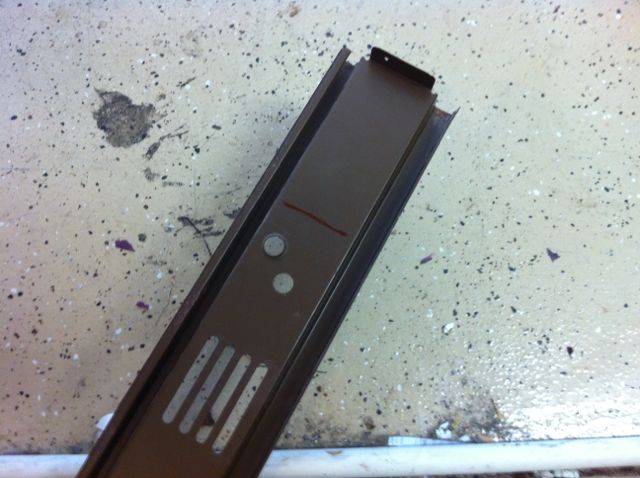

The first thing I did, because I know my craftmanship can be laughably bad, was to procure an extra stove front plate. I got it from the classifieds, I think it was $25 or so:
Then I marked how far I wanted to go, and attacked it with a jigsaw:
My strategy is usually "measure once, cut three times". Make sure to never hire me for anything that doesn't have an undo button Smile

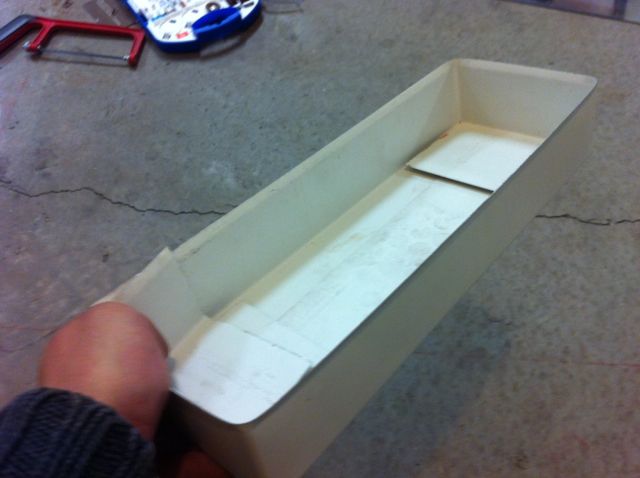

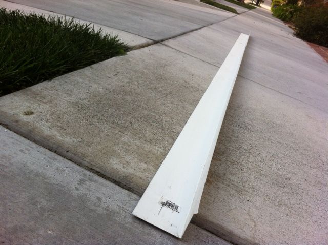

I went to Home Depot, and after a couple of hours of looking of inspiration, I settled on this thing, it's a roof gutter of some sort. What mattered to me was that it is metal, it has a 90 degree bend alongside, and one of the sides is about 2 inches tall:
By making cuts on the longer side and bending it I built this box, which is about 12"x4":
Not pictured here, but I epoxyed it in place, and left it clamped overnight.

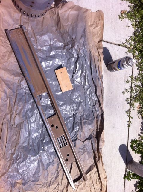

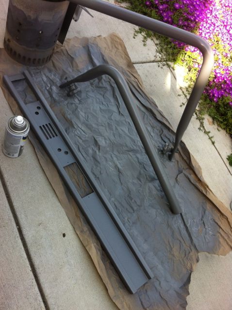

I made a wooden front, which I sanded until it fit snugly in the stove front. Here they are, pictured in my paint booth:
After a couple of coats. I painted the table legs as well.
When the paint was dry, I attached the front to the drawer using a handle that screws from behind, and then lined the drawer with some black rubber material so the stuff inside doesn't rattle too much. I also put some of that low friction tape that I used on the slider door, on the bottom and edges of the drawer.

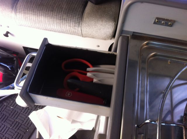

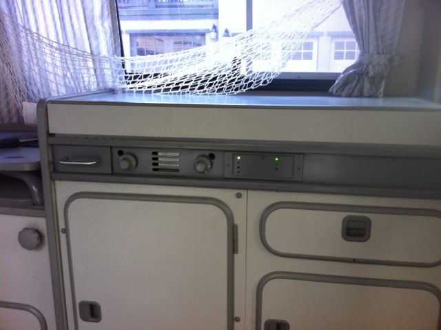

Voila, a new cutlery drawer:
Now I can use the main drawer under the sink for other stuff. I'm not too worried about heat, this is relatively far from the flame, separated by two layers of metal, plus my drawer itself is metal. So I should be ok.
The paint I used was Rustoleum Satin Granite, it is here if you scroll down a bit:
http://painting123.com/ProductInfo.asp?p2=I7
It's a bit darker than stock, but I don't mind it. My bad craftmanship shows a little bit, but it isn't too bad. And when compared to my stock stove plate, it is a noticeable improvement. The old plate had that greenish grey color that most original westy stoves have by now.
Here it is closed:

"roof gutter of some sort" It's called metal flashing, used under roof shingles to protect edges & direct water. Comes in various sizes. Nice job!
Ahh yes. Thanks. I was just running around HD looking for ideas, and found that in the roofing section Smile

"Drip edge" is what that stuff is called. Neat project.
