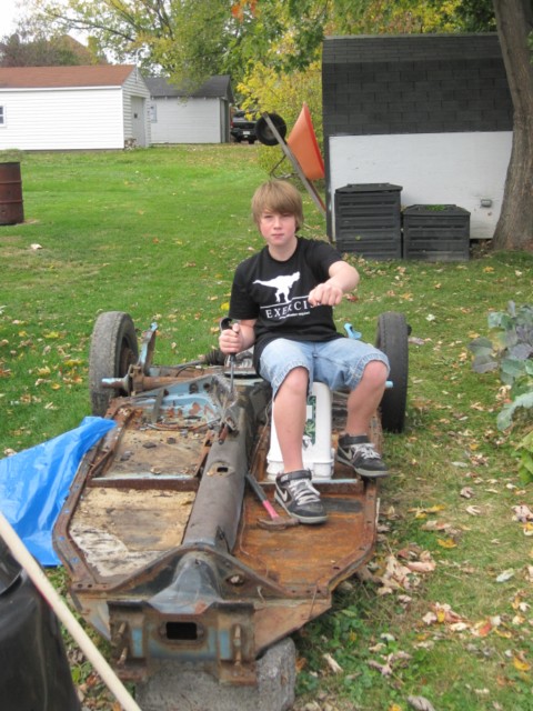

I've never started a build thread yet, and thought it was about time. Figure I'll jump right in to where I currently am. Thanks to all of those who have answered my PM's and helped with the posts of your builds. They really do help.
The dream was a 3 year build with my 13 year old son in our 3 car garage. And tonight he and his 11 year old brother actually helped for once! It was nice spending some time with them!
Tonight was a productive night. Offspring channel on Pandora, and jamming through the work. I know how everyone here likes pics, so here's a few....

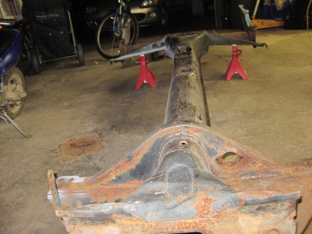

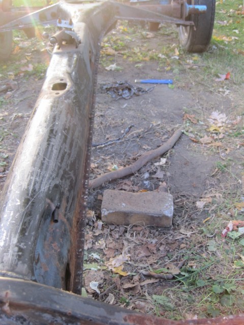

We started a year ago last fall with a tunnel that was given to us. Long story, but it took me over a 1 1/2 years to get the title.
We stripped it down using a hammer & cold chisel. Yes, eye protection was worn.
Stripped down to nothing. Only 3 stitches at 1AM one time, while getting the gas line out. Nothing like waking the misses from a deep sleep to tell her you're going to the ER.

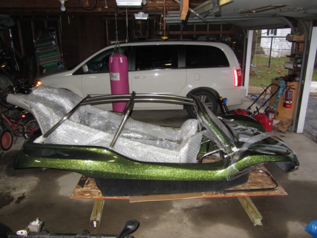

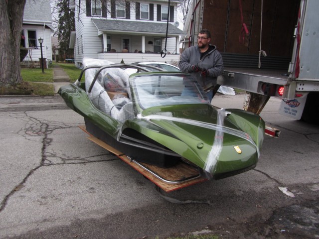

The body was delivered last February by Stewart Transportation. Luckily no snow then.
All tucked away next to the family truckster.

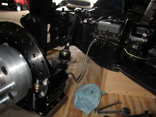

Major milestone, brakes installed & bled.

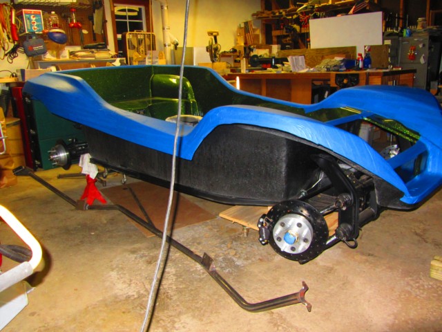

Blue tape to try to protect the finish from kids.....

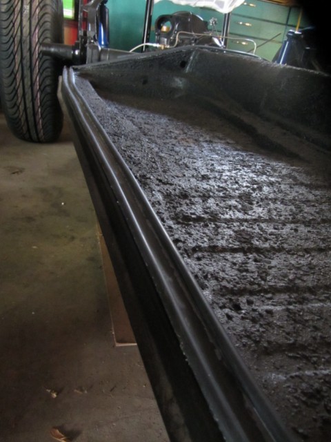

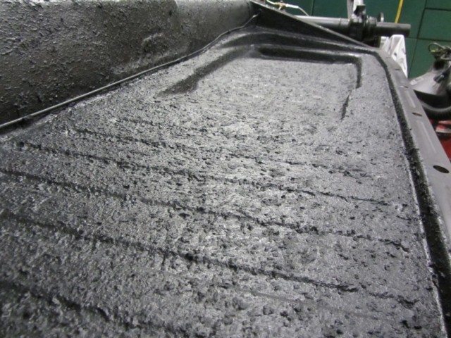

Rolled on Duplicolor Bed Liner, with Kevlar no doubt. Rolling Eyes Sixty bucks for the gallon. Turned out okay after 5 coats.

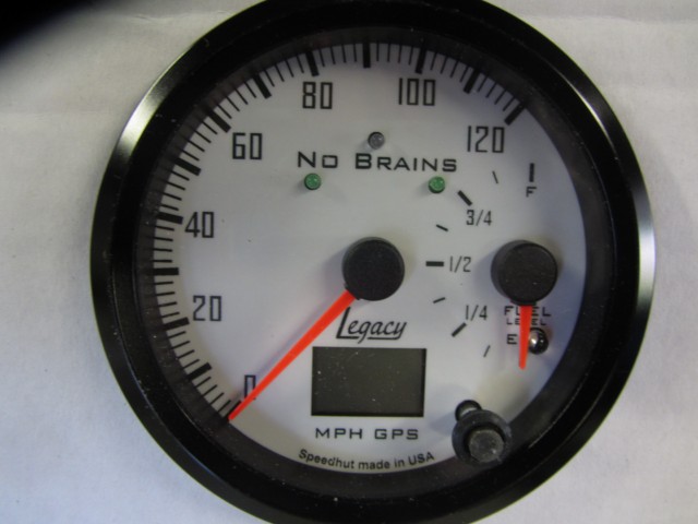

Speedhut Legacy gauges. I like them a lot. GPS and no messing with a speedo cable and regearing it since the front tires won't be stock size.

Nice! Love the color. I plan to use a Speedhut gauge also.
Why is yours showing 5 mph?

Adam - I can't "unsee" NERD either, but it's fitting and I'll drive it with pride. Cool
greg mom - the gauge was still in the box when I took the picture. I never noticed it showed 5 mph until you mentioned it. Strange that I looked right over that, how could I miss that. I'm hoping that once power is applied to it that it will sort itself out, but now you have me wondering.

Any chance you wired the speedo up yet? Looking to see how it's working out.

The speedo in our KickOut is also a Speedhut GPS. Out of the box it read 5 mph. I set it up in my pickup and as soon as it figured out where it was in relation the the various satellites all was well.
After installing it in the KickOut and leaving it sit for several months the speedo started to show 5 MPH again. I hooked the battery up and in about 20 minutes it sorted itself out again.
I think you are worrying about a problem that does not exist.
The speedo in the KickOut is more accurate than the factory speedo in my truck. It is going to be great not to have to find adapters for various tire sizes, and all the other problems that go with a speedo in a kit car.

Love that color. We have a Speedhut GPS speedometer in my wife's buggy. Works great.

Once I applied voltage it went right to zero and stayed there.

I got the body pan gasket put down with 3M weatherstrip adhesive. Worked great!

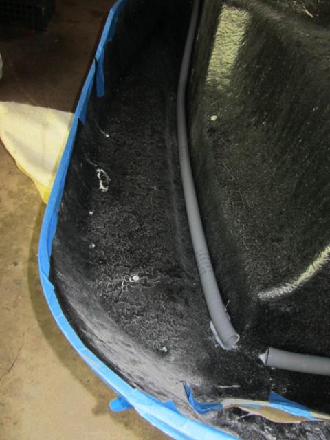

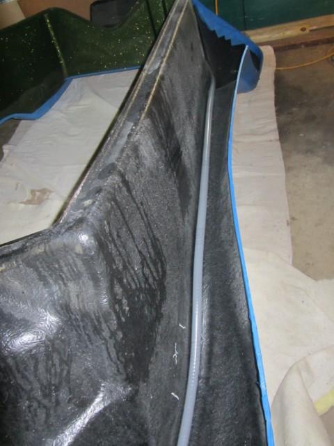

In the mean time, I glassed in some 3/4 inch conduits from front to back. This is my first time trying to use fiberglass. and over all it turned out ok. Most of my work will be hidden either by the roll bars or the side pods, so I'm not too concerned with how bumpy it is.
I hot glued the conduit down first with a HiPURformer glue gun. Probably overkill to just tack it in place, but I've had my eye on this gun for a few years now and this was a prime opportunity to buy it. The glue bonded so well I had thought about not glassing them in at all. But I was concerned that flex over time might not hold it.
I used Tiger hair to fill in the gaps. Worked ok, but lumpy. I could have sanded before doing the glass cloth, but being that it will be hidden I didn't. Also it would have needed to be hand sanded in most places since there wasn't room to get the die sander into the tight spots.
Glass cloth laid over the tiger hair. I found that I should have wetted the bottom before laying down the cloth to get it wetter. Where I didn't do that I had air pockets beneath the cloth.
And final product after rattle canning it with what I had, high gloss. I plan on getting a can of flat black to make it blend in a little better.

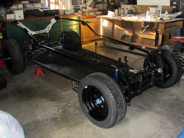

And the chassis is now a full roller! First time out of the garage this summer. I'm ahead of my self-imposed schedule. I planned on having it rolling at the end of summer. Time to start bolting the body to chassis next and getting the steering column installed.
