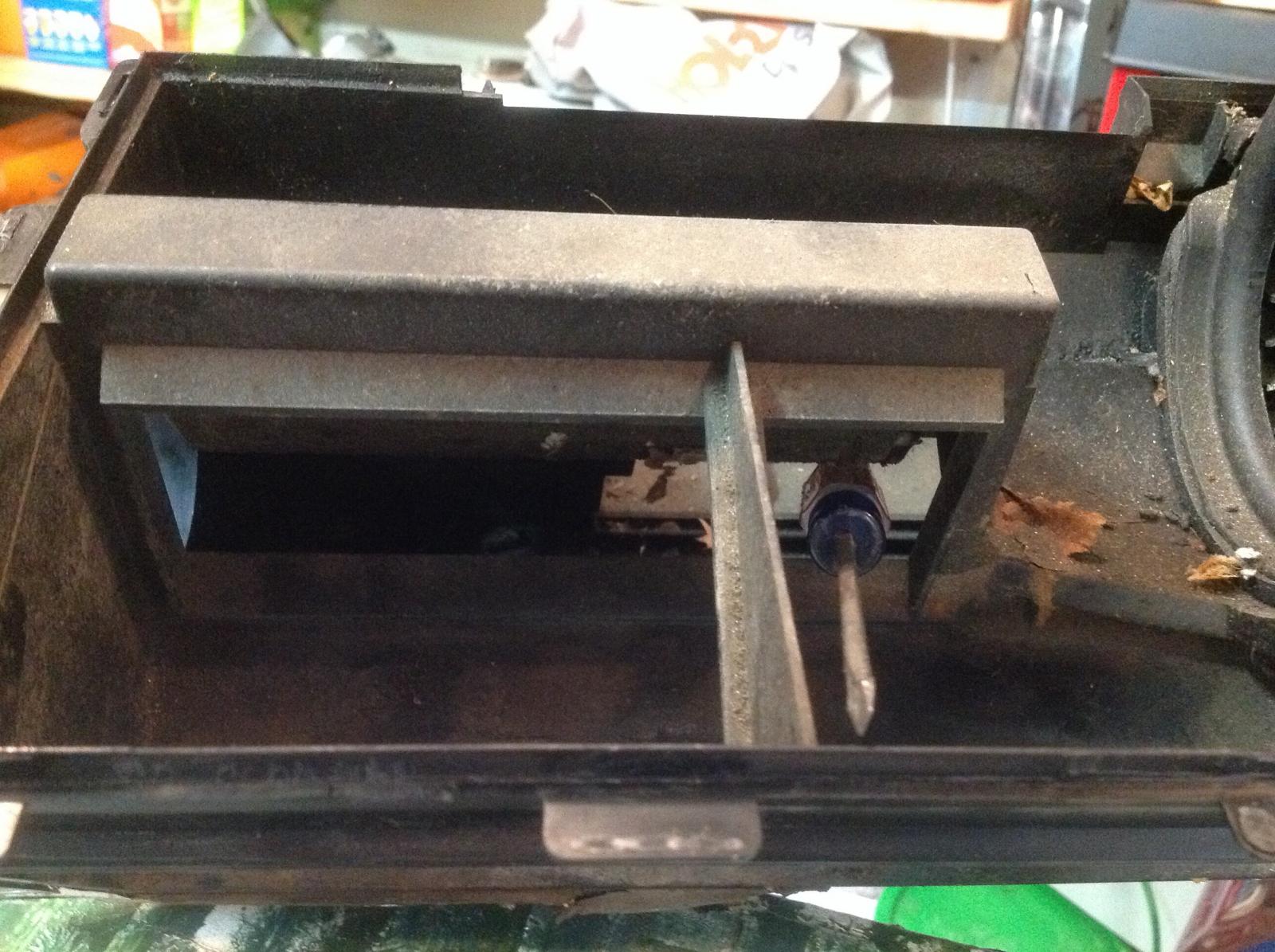

Air box towards fresh air inlet, it's dirty and the mice have been in here!
Screw driver point resting on closed gravity air flap (there are two of these flaps but just one close up in photo).......
Handle of screwdriver holding open the same gravity air flap.....

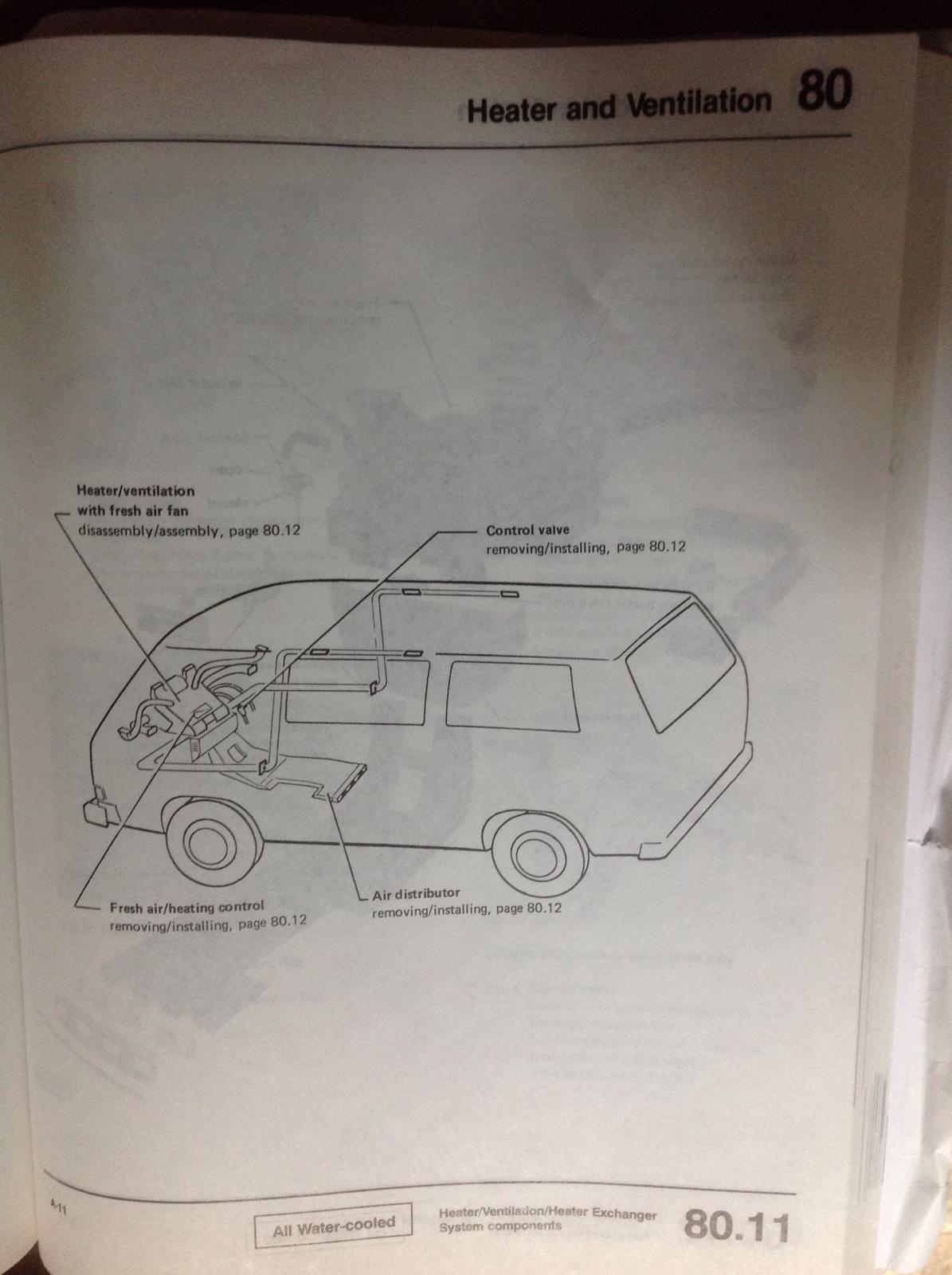

Heater Box Airflow schematic.......
Blow apart of Heater Box.........
Interestingly, mine does not have the shown "Main Cut Off Flap"......

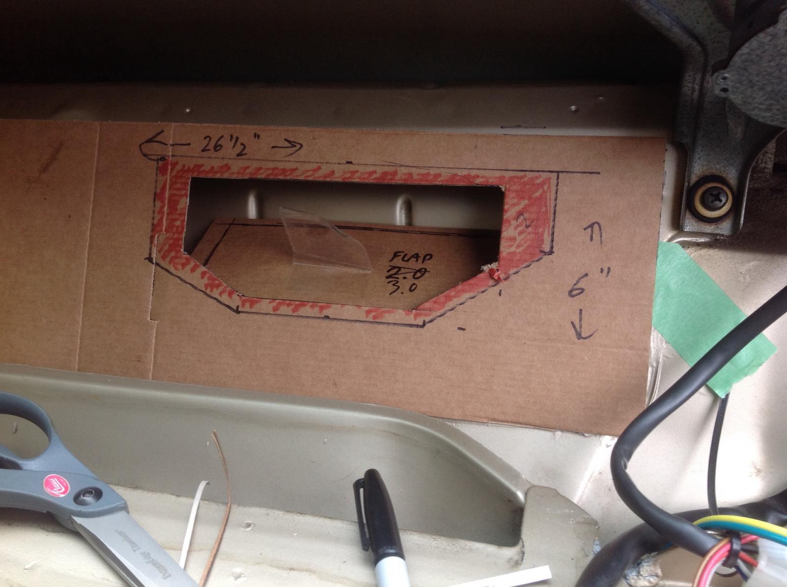

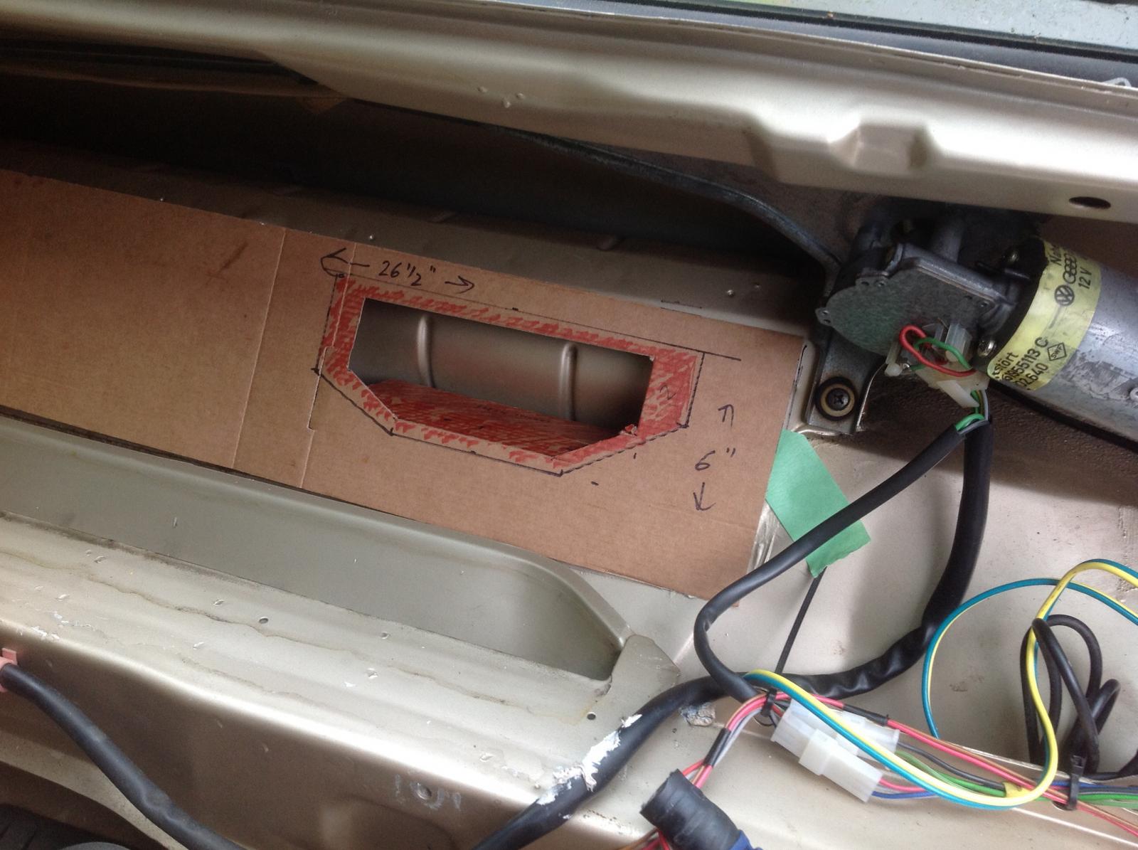

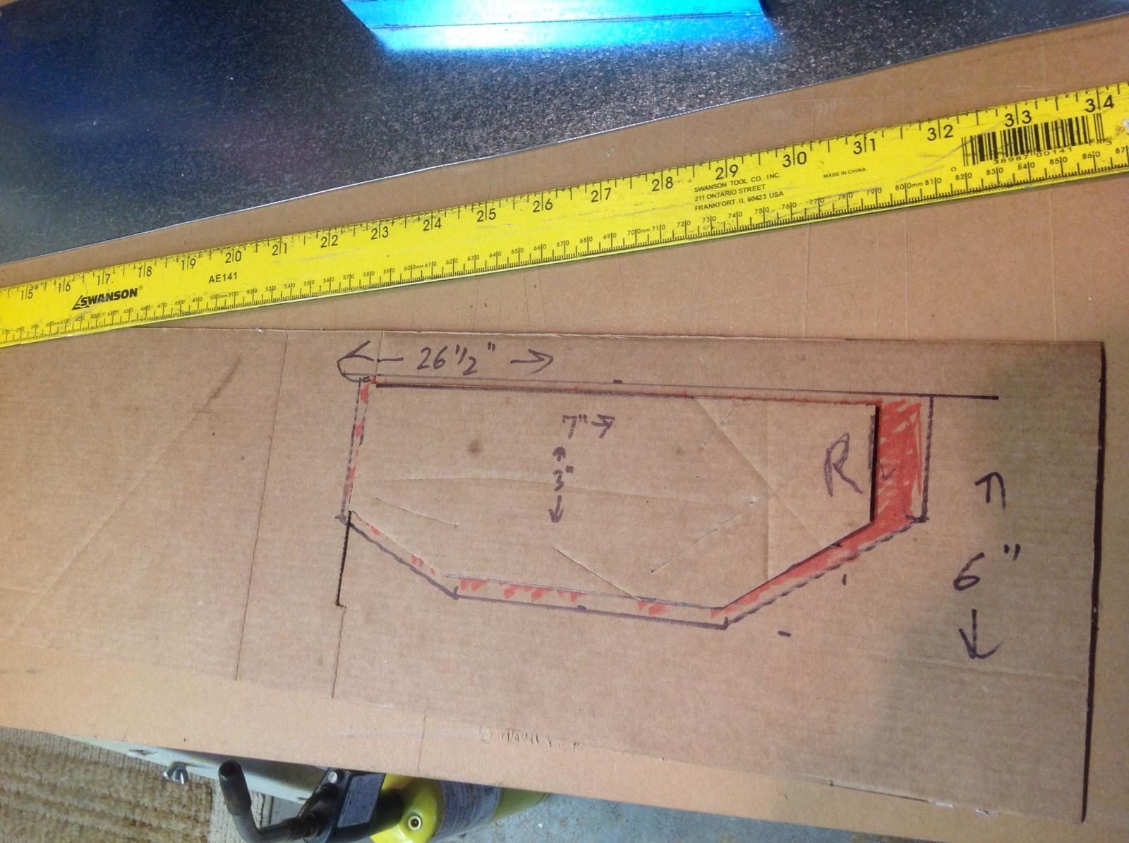

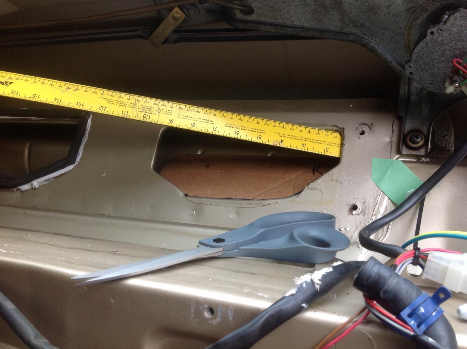

A template to block off air flow.......
The Right Inlet Drawn upon the Template......

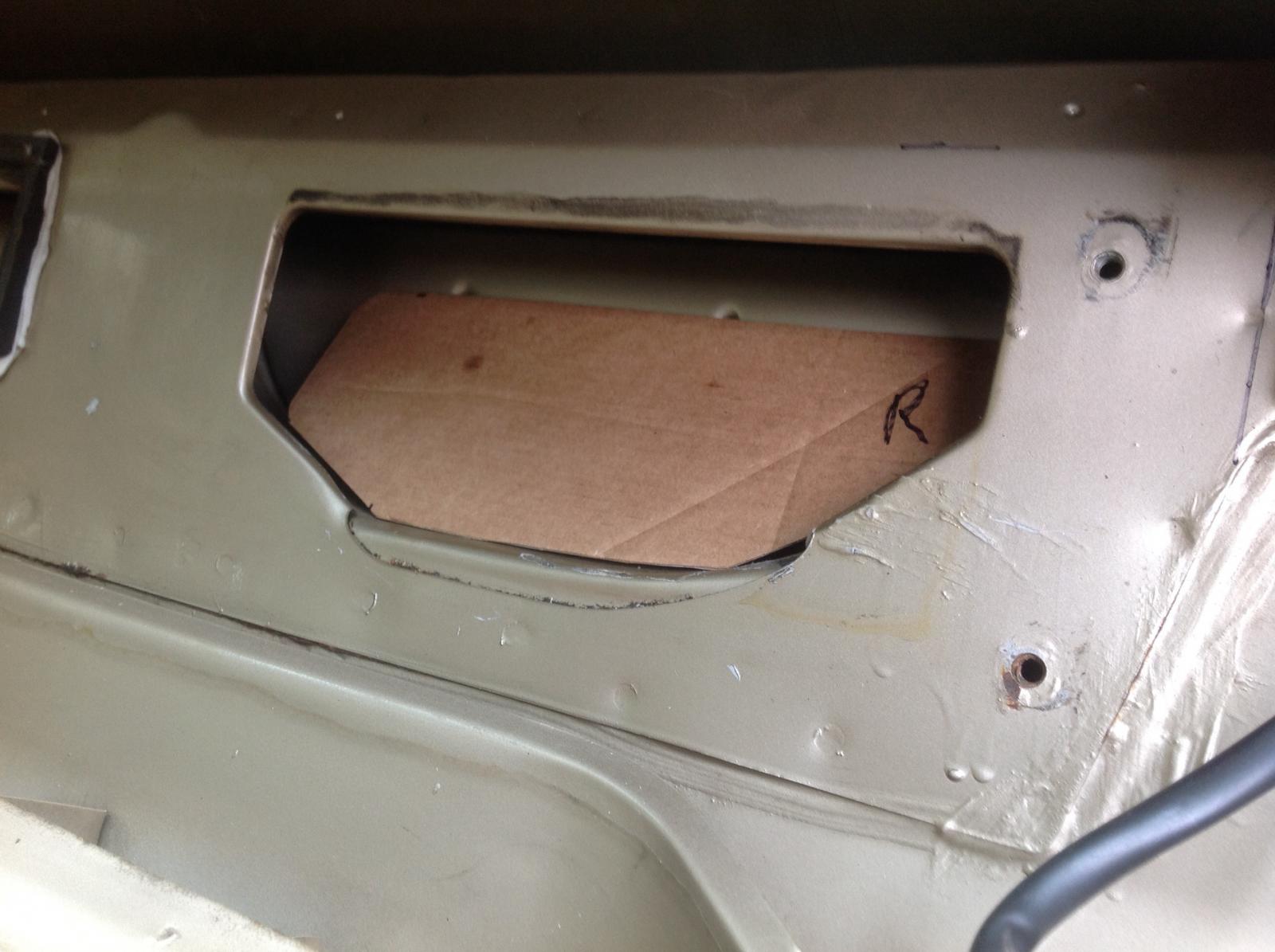

A cardboard door to see how much door I can make and any obstacles to being able to swing. Also how can I operate the door using a cable? ........
Hmmmmmmmm.........
While I think that making two air control doors able to work simultaneously is completely doable if I link them with a single rod............ Let's be honest, there are some huge obstacles to overcome.
I think that if I use one door for now, it will tell me if I'm heading in the right direction with minimal effort put forth!
Pulling the Heater Box really isn't all THAT much work! Shocked
To pull the dash again for modifications isn't out if the realm of possibility at a future date.
Everything I'm doing for this modification is absolutely 100% reversable except for a hole or two drilled.....easily fixed if need be! Wink
Hmmmmmmm ......... looking at the fresh air box.........
I have space next to the upper Right mounting bolt where I can drill a hole to run an operating cable.
If I fasten a rod to the back of the door I can make a loop of cable to slip over the rod........... I of course need to make an adjustable cable housing holder below the Wiper Motor somewhere.......

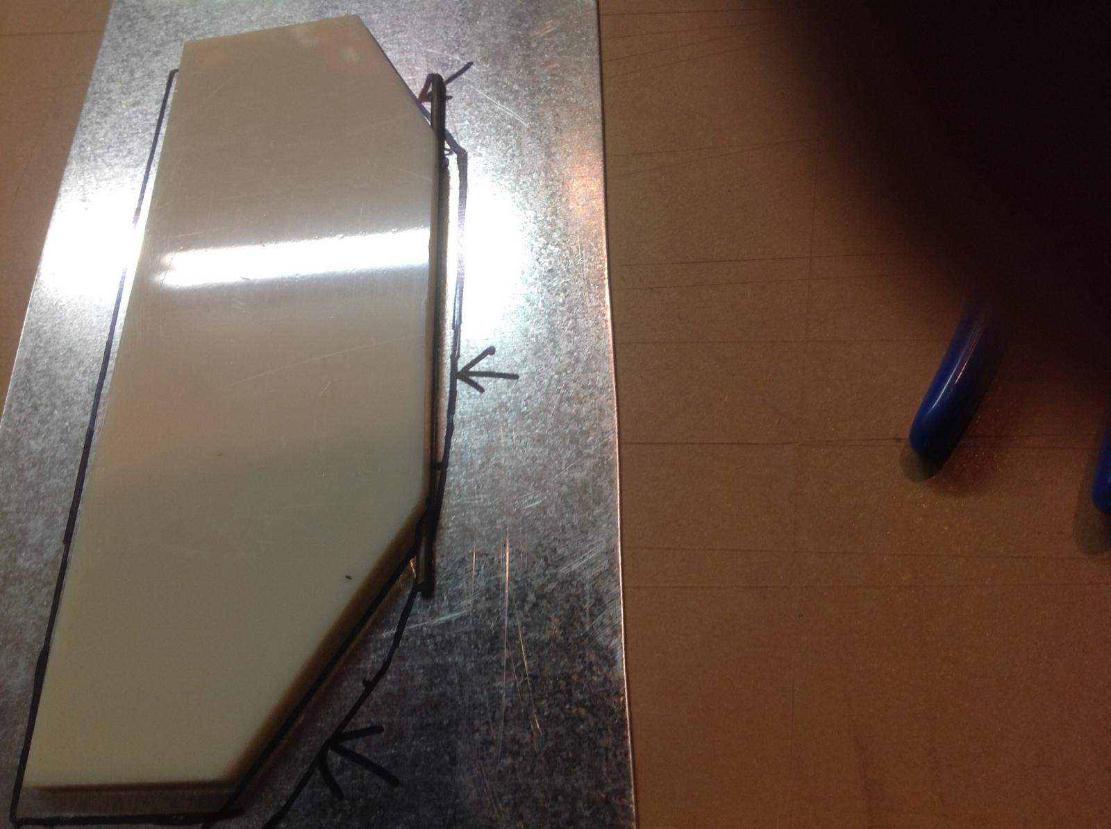

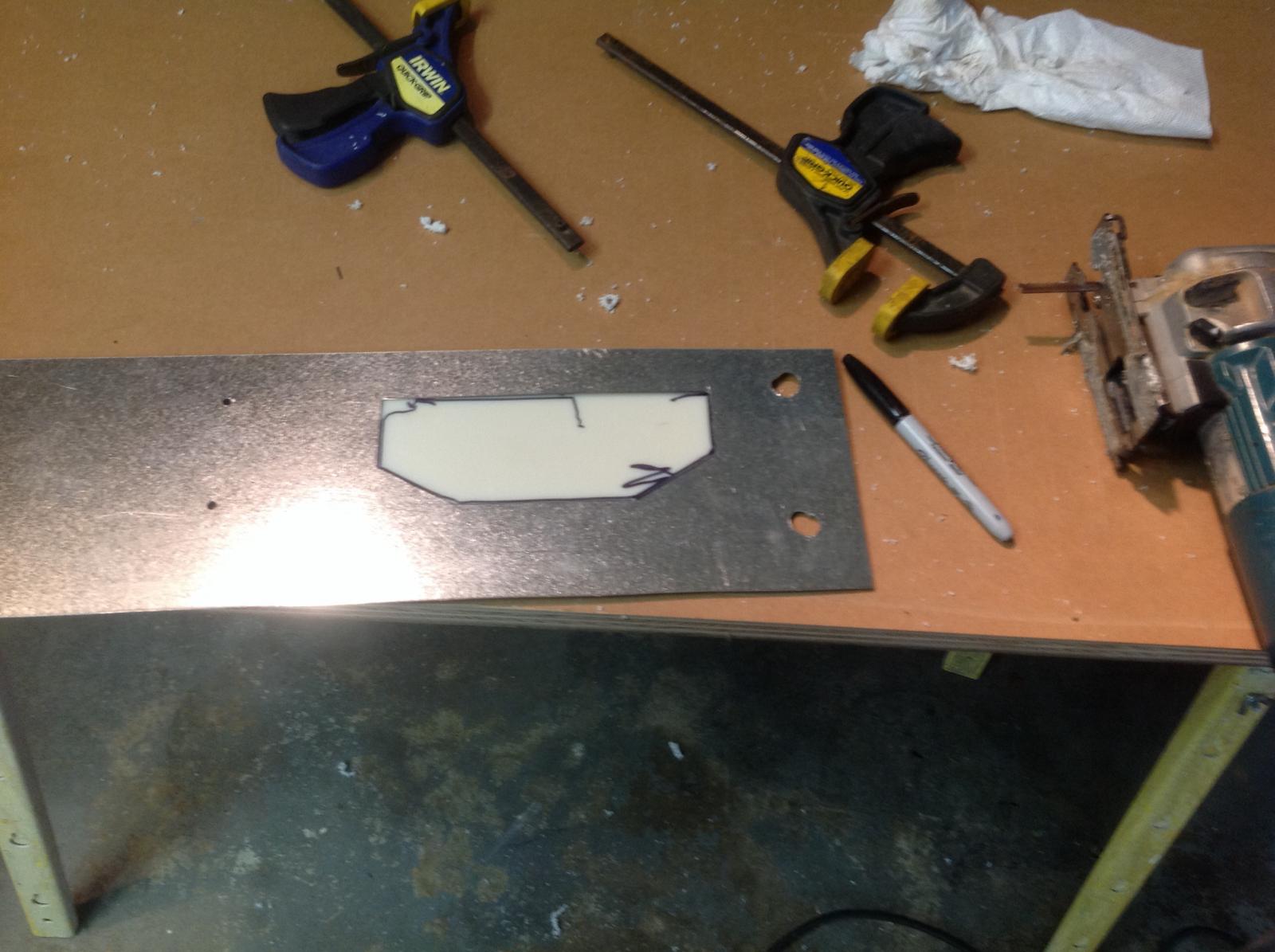

The best is the piece of off white 1/4" ABS left over from a task years ago that I will make the operating door from, rigid, easy to work and easy to glue......
Sheet Metal, ABS, ABS Glue, small steel rod for the hinge and the operating lever......... Cable...... I've got a cable somewhere in my stash!
It's time to design the actual door, make it out of cardboard, tape the rod to the door, insert operating cable........

Trying to Keep It Simple Stupid KISS........ I'm opting for a simple rectangular door right now.
Yes, it's smaller than I had envisioned but...... We're experimenting Right?? Embarassed
14 sq inches of opening........ The factory has two (2) 27 sq inch openings........ Going from 54sq inches to 14 may be a tad too much do you think?
I guess it wouldn't be difficult to add height and angle the bottom leaving room for the hinge right near the Air opening on the Van...... I do need to leave a 1/2" or so for the flap to seal against the metal......
Cutting the metal block off plate.........

Ok....... Better, not huge but visually more comforting anyway.......
Flap created out of Card Board......
Here's why you use cardboard!
Flap 1.0 was lacking sealing surface mainly on the top!
Flap 2.0 fixed this issue! ........
Test fitting in the Van..... Flap 2.0 became Flap 3.0 because of trimming needed to clear the sheet metal opening!.........

Cut out transferred from cardboard to metal and is cut out using a air powered die grinder fitted with a fiber metal cut iff wheel.
I chose this method over tin snips because I did NOT want to distort the sheet metal at all.
Any distortion would make for air sealing headaches once installed.
Opening cut!.......
I marked out the Heat Box mounting screw holes on the card board and then transferred the openings to the sheet metal for accurate placement....... I also filled the cut edges smooth and dull so as to not cut myself or hang up on the foam air seal that I will install.
Test Fit with the cardboard door!.......
Now to cut an ABS Door...........

Trying to figure out how much room I have for making a hinge, I removed the ABS Flap and traced the Fresh Air opening onto the Sheet Metal
The flap removed with two tracings on the Sheet Metal.
The outer one with arrows is the Air Box opening in the Van Body,
The inner one is where the air flap sets and works clearing the Body opening......
Now for the HINGE.........
I'm thinking of doing a simple rod and pivot point hinge.
It's easy to make, cheap and I already have the rod! Wink
Just a basic 1/8" steel rod available at any hardware store USA.
I will cut out the bottom edge that sets against the sheet metal about 1/16" deep by 1/8" wide. I don't want flush ti the sheet metal for I will be putting on a foam gasket to seal out the air when closed........ (The black arrows are the trace of the heater opening I made while I was test fitting the ABS door.)
Unfortunately when I do this, because I enlarged the size of the ABS flap I've shorted myself on hinge space! I am too close to the bottom edges with my hinge rod.
To fix this I will need to cut away just a tad of the Body as noted by the Green Arrows pointing at the two black marks where the metal will be removed.....
