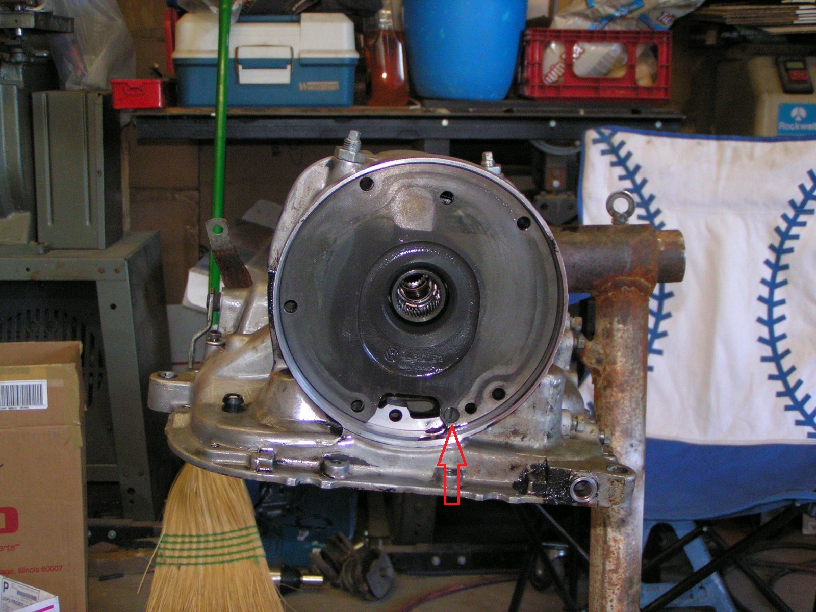

The first sign of trouble was when the Trans would leave a good size fluid spot on the drive way. The fluid would only appear after the car had sat for at least an hour. I was lazy, so I kept on adding fluid until one day about 20 miles from home, I lost 3rd gear. I nursed it home on slow side streets then grabbed the Bentley. Started trouble shooting and discovered that I had lost the Direct / Reverse clutch. I installed an auto from a T4 in it to get me going, but it has issues too. So now that I am off work (College Instructor), I decided to rebuild the original. I picked up a master rebuild kit from Rockauto and prepared to get to work.

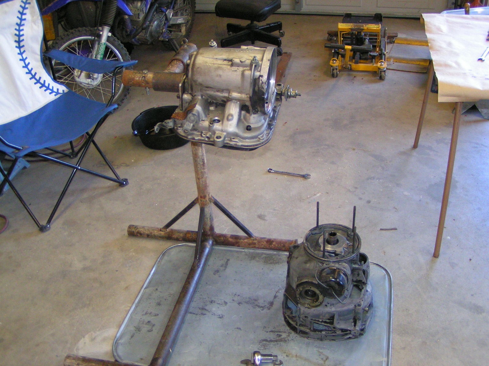

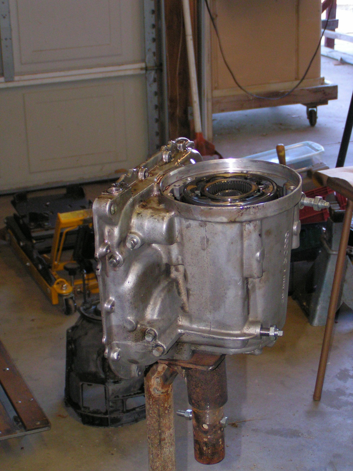

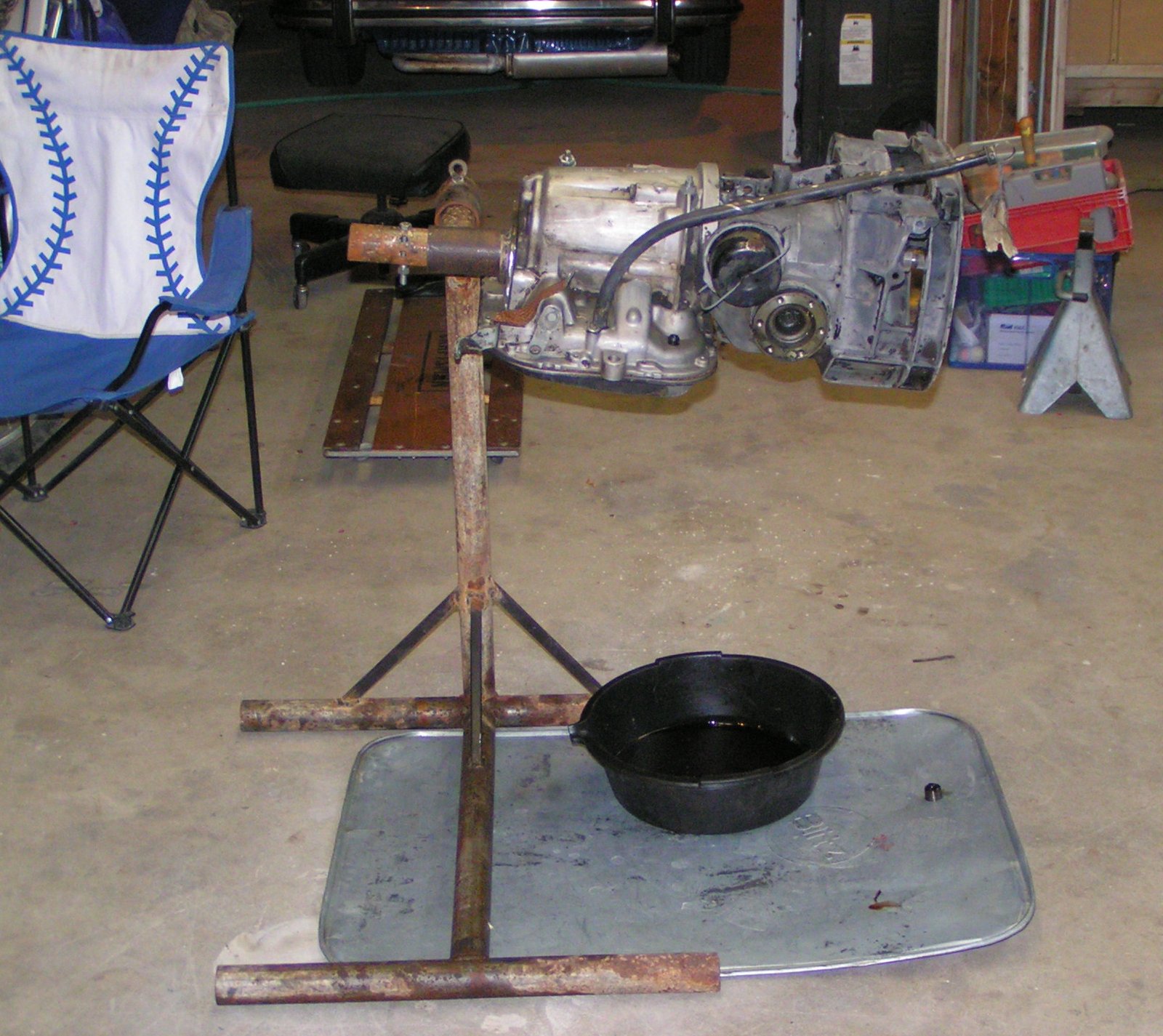

Before the tear down I knew that I would need a good way to hold the unit, so I threw together a holding fixture for one of my engine stands.
You don’t have to have one this complicated, but being able to rotate the Trans on two Axis’s really makes life easier. So first the complete transmission was placed on the stand and I drained both the transmission and the differential overnight.

The next morning I separated the Trans from the diff and began to rebuild the Trans section.

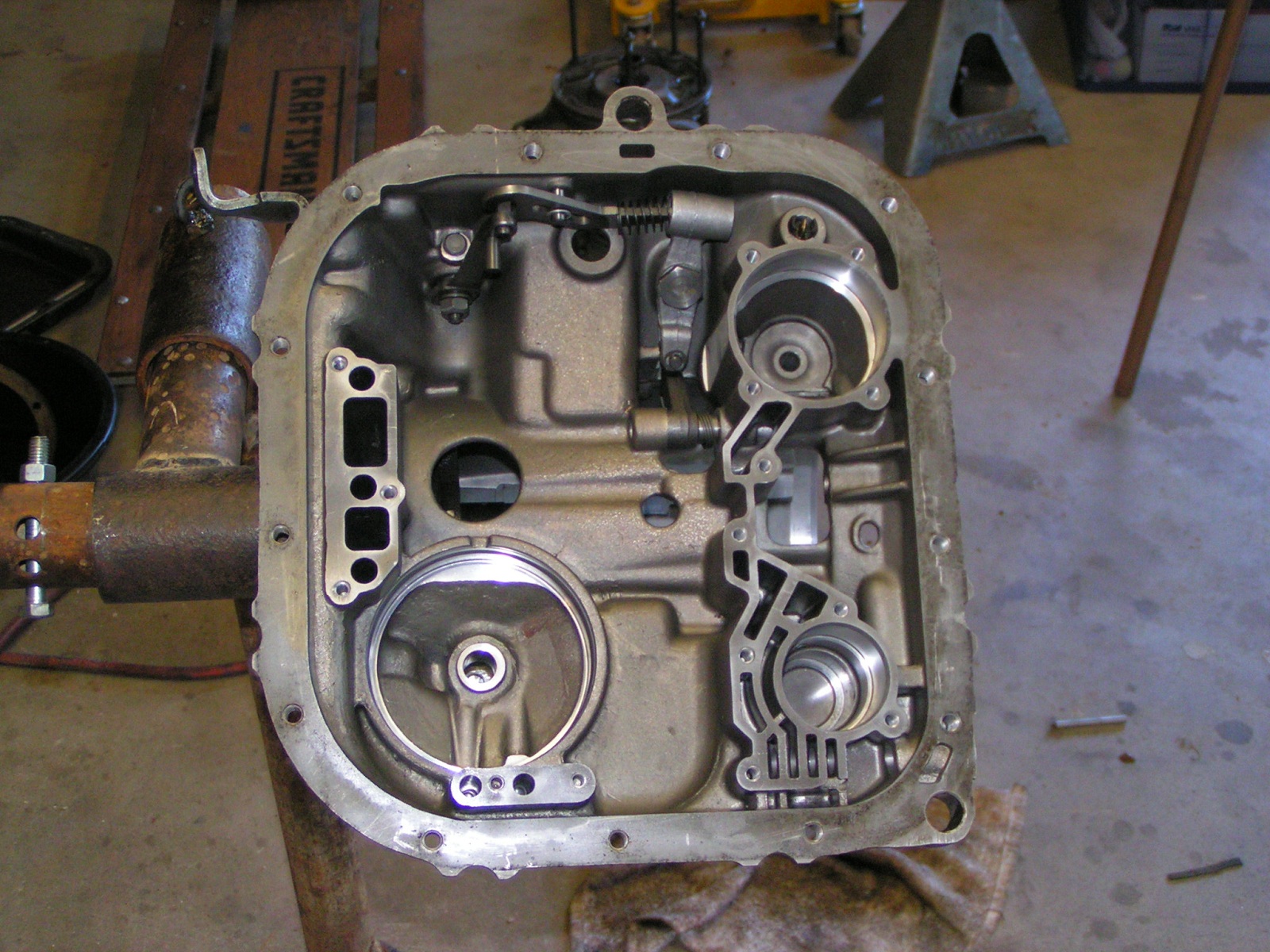

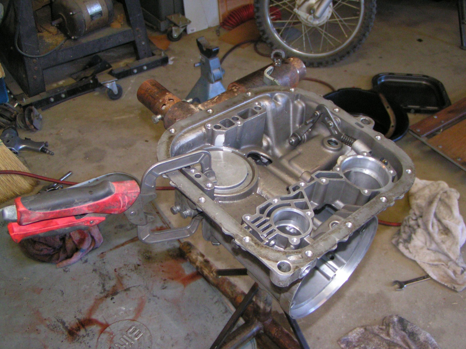

I found that it is easier to start from the bottom first. I removed the pan so I could start on the valve body and servos. You can see what a burnt clutch leaves behind.

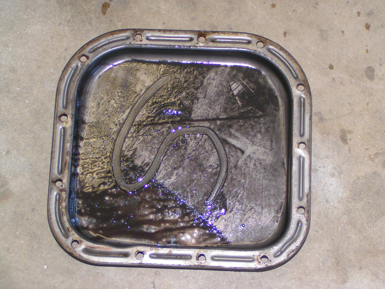

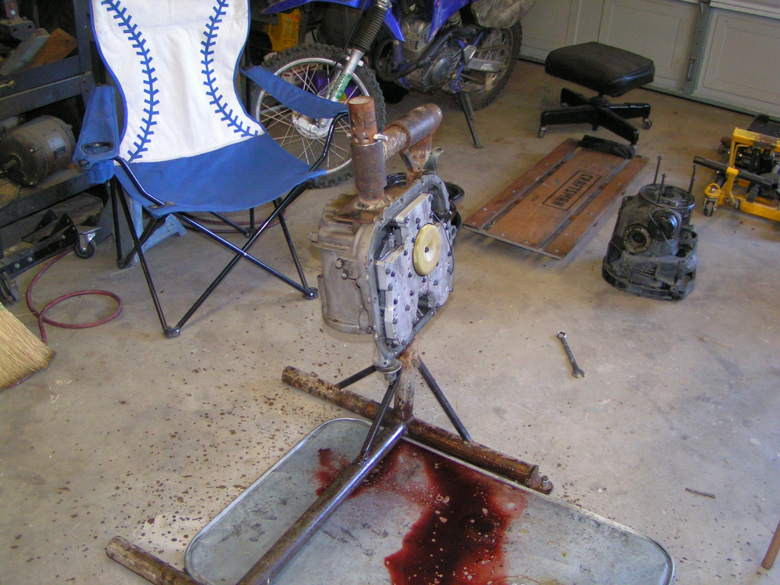

This is a messy job, this is how much fluid was still in the case after draining overnight, Notice the color (Burnt Clutch)

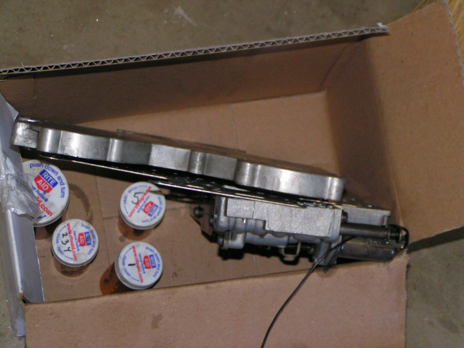

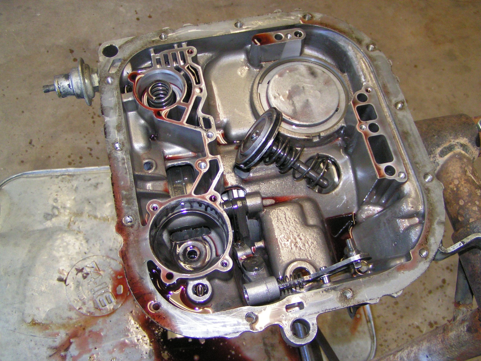

I was a little confused with the Bentley talking about the screws and bolts on the valve body. What I found is that you DO NOT want to take out any Phillip screws, just the bolts. Take out the 14 bolts and the whole valve body unit will come free from the Trans. (Note – The 1st gear servo will pop out of its hole when you remove the valve body, keep an eye on it)
Set the valve body unit on the table, and then remove the Phillip screws. The Phillip screws are what hold the three sections together. Once the screws are out, slowly separate the three sections. Have some small containers to hold the screws and springs (pill containers). Pull out the balls and screws and put into containers and label the containers.
You can see that the clutch material gets everywhere.
Remove the 2nd gear servo and the accumulator and place into boxes. Keep parts organized by their relationship to one another

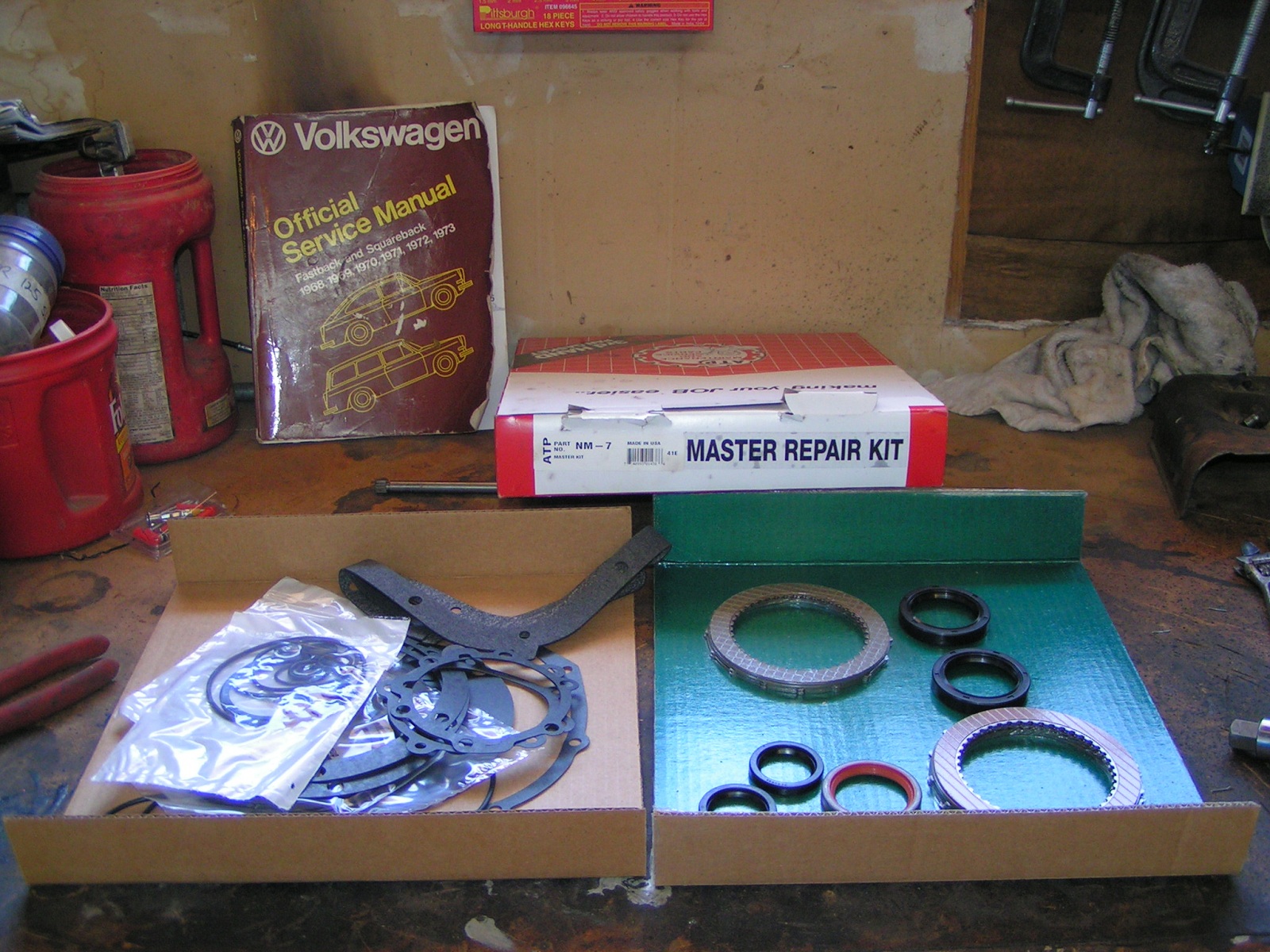

I noticed that the repair kit came with several similar, yet different gaskets. So, before I disassembled the main body, I matched up the correct gasket and made a note on it so I would know which one to use and how it would fit.

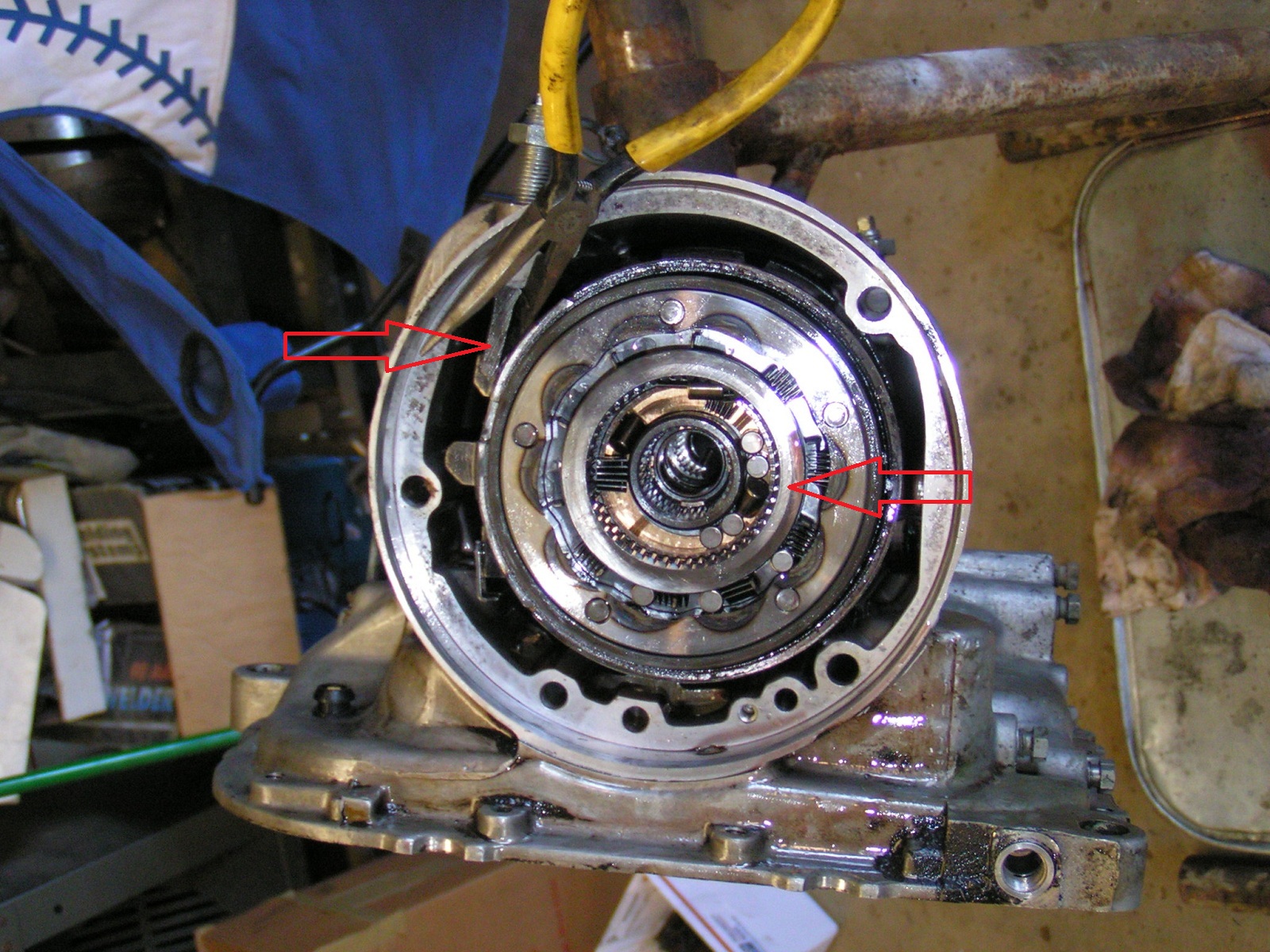

Now it’s time to pull the main components out of the case. The bearing flange is held on by one screw only. Remove the screw and it is ready to come out. The Bentley said it requires a slide hammer, but mine came out without one
Next, loosen both brake bands completely and remove the wedge for the 1st gear brake band (Pliers) and remove the band. I skipped this step and made a mess out of the one-way clutch. Note – Remove all components by grasping on the outside only. I used my thumbs to grab the inner ring of the clutch, causing the rollers and springs to fall out (they don’t fly out).

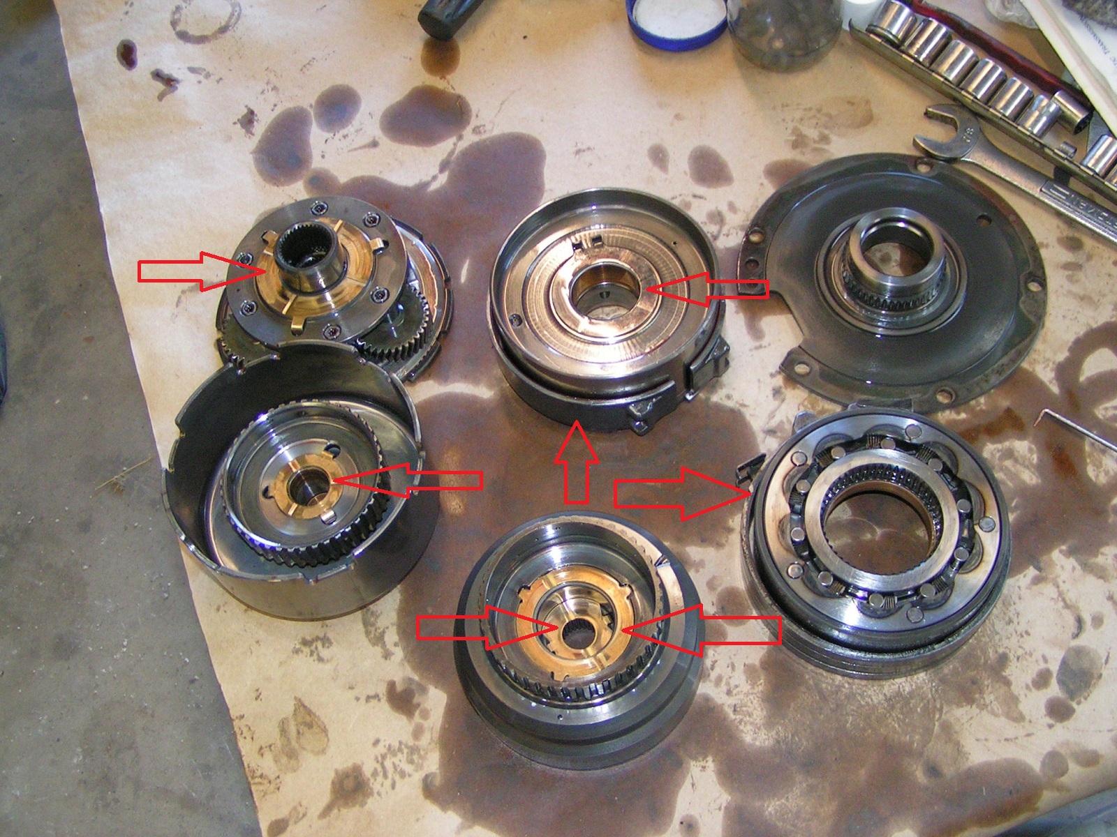

Next pull out the planetary gear set. Notice the roller from the one-way clutch
Pull out the rest of the components as per the Bentley, and place on a clean surface. Keep all brass thrust washers and the clutch bands with their respective parts so you remember how they go back in.
The hardest part to remove was the direct/reverse clutch. It tended to get hung up on the oil pump sealing rings. To get it out, I turned the stand so that the Trans opening was facing down and between gravity and wiggling I got it out.

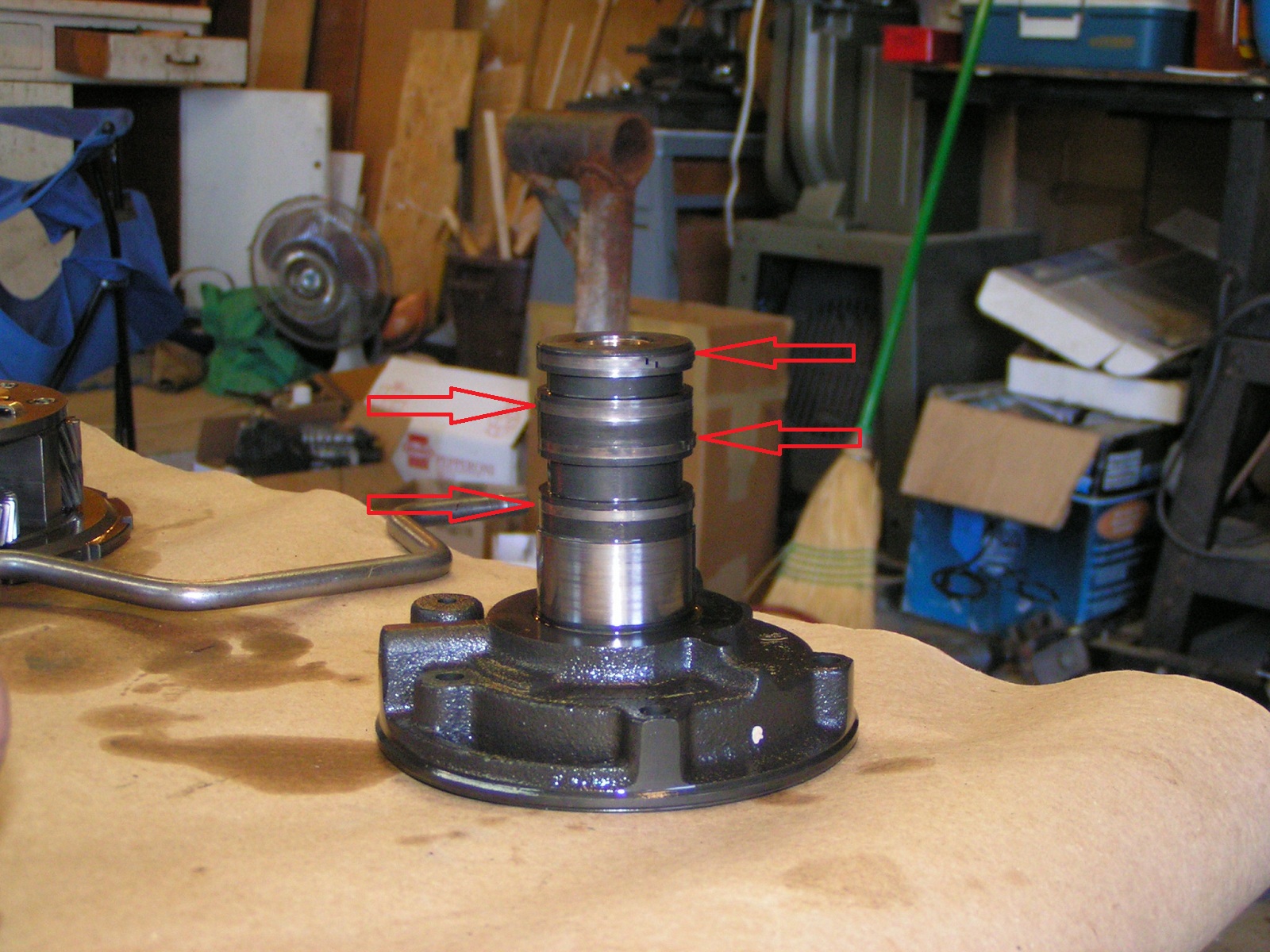

Oil pump and sealing rings

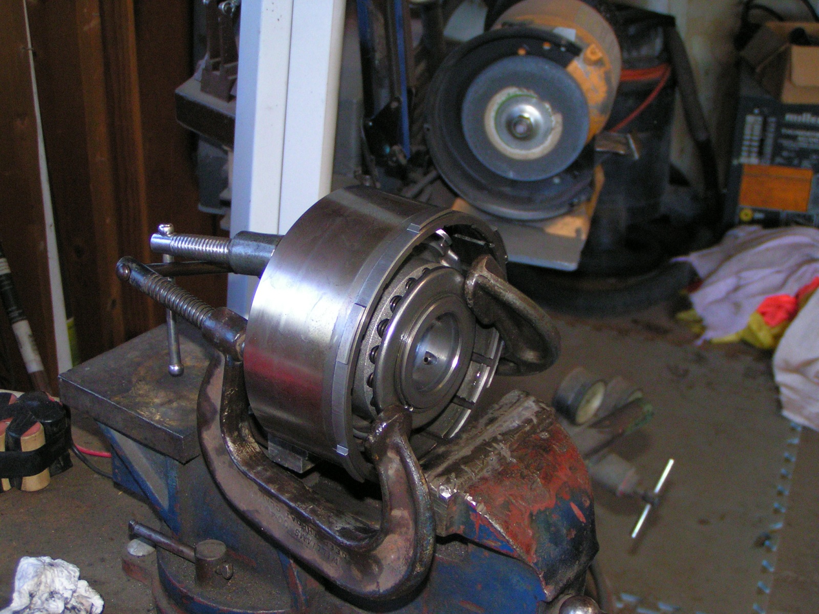

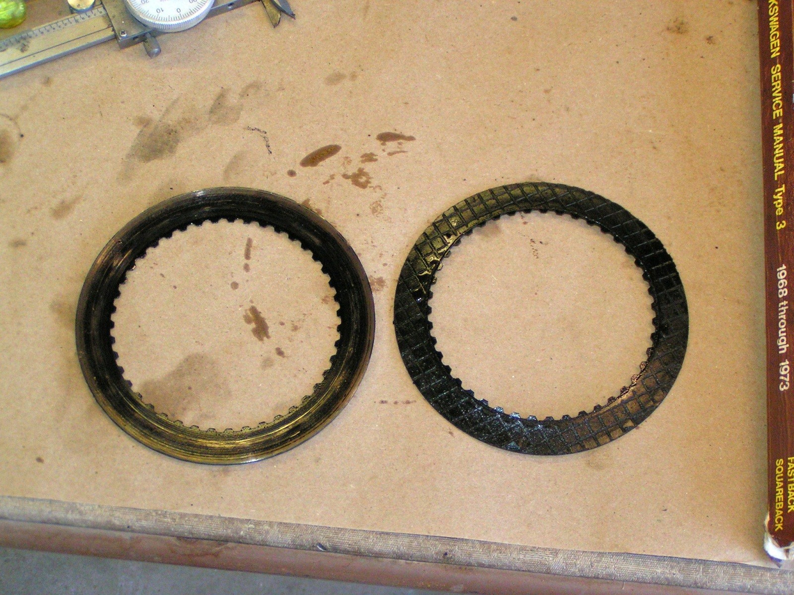

The next step was to rebuild the clutches. Only the direct/reverse clutch was bad, but since the kit included both clutches, I replaced both of them. Here the Bentley was confusing. It said that the direct/reverse clutch should be put in a press to disassemble. However, it did not show a picture of the tool. To disassemble this clutch, you have to compress 18 small springs, AND take out a C-clip. I was scratching my head when I decided to check just how stiff the springs were. The spring pressure was pretty light so I used this method to compress the direct/reverse clutch.

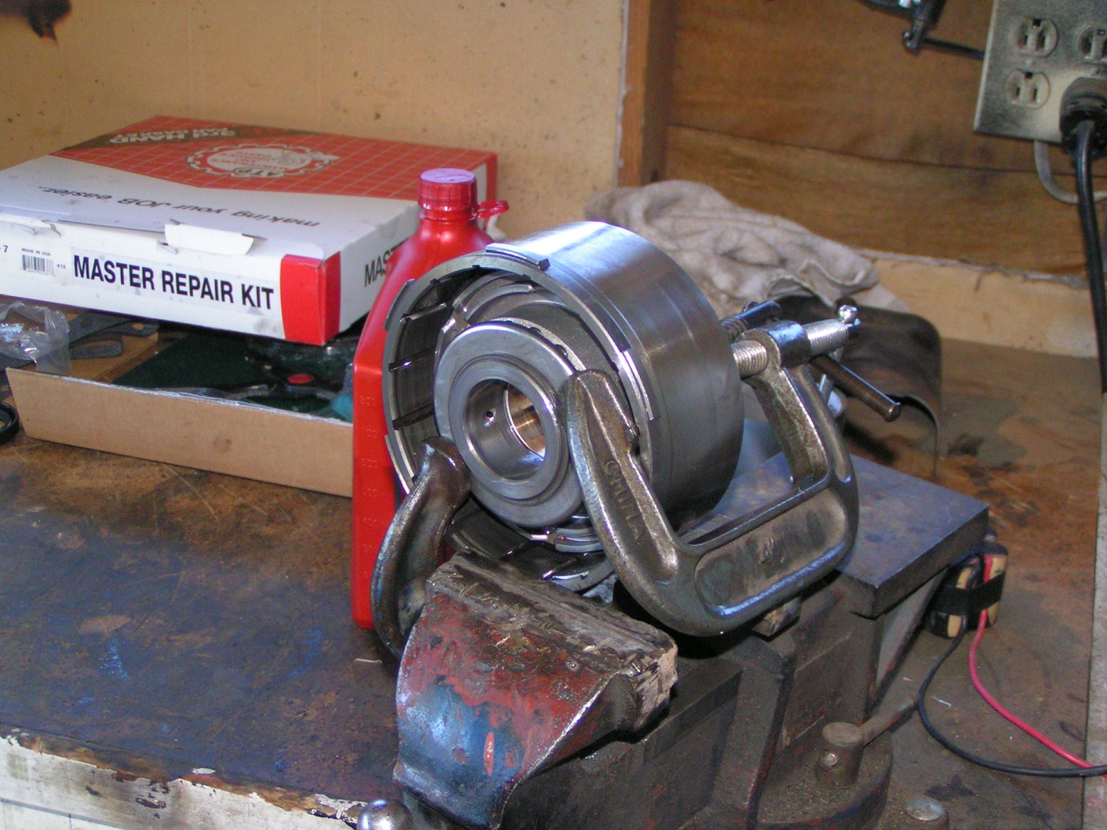

A FEW WORDS OF CAUTION HEAR. If you do not have soft jaws for your vice, make some wood or plastic cushions. You do not want to mar or burr the clutch basket. Also, even though the springs are not under a lot of tension, you should always have eye and/or face protection (Face Shield)
Once the c-clip was removed, the clutch was pulled apart to reveal the burnt clutch plates. Notice on the left plate, the waffle pattern is gone. Both plates are like this, plus they are cupped from heat.

Install the oil pump and using the long oil pump rod, make sure that the oil pump turns smoothly in a clockwise direction.

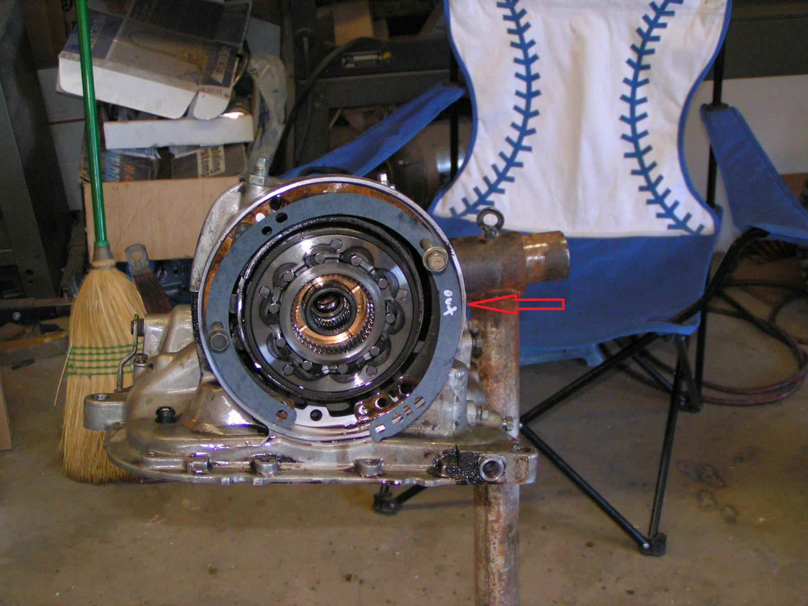

The last little trick involves mounting the bearing flange and the gasket. Previously, I marked the correct gasket so that I would know its orientation for assembly. However, due to the gasket shape and the number of holes in it, it was rather difficult to get lined up. There are 6 holes total that must be lined up for the gasket to be installed correctly. Four of the holes mount the differential and two of the holes provide Tran’s fluid to the governor. To make sure that all of the holes were aligned, and that the gasket was installed correctly, I used six 8mm bolts. Each of the bolts was placed into a hole through the bearing flange and gasket. A slight tap seated the bearing flange and the 6mm screw held everything lined up perfectly.
