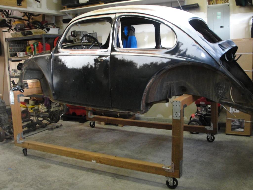

I'm getting ready to remove the body on my '66 project. I've seen 2 kinds of body dollies I like. I'm wondering which would be best to copy. Any advnatage of one over the other? The major difference is the distance between the 4X4 posts that the body sits on - one is a little wider than the other, so one body pretty much sits on the posts even with the fender wells. Any opinions or advice is appreciated. (thanks to the guys whose dollies I'm posting pictures of as a reference!)
Body dolly A:
Body dolly B:

I am the one that build the second one. They are pretty much the same. I builds mine so the body rested on the heater channels with the ability to move the body forward and backwards to get to all the metal under the channels. Also I had to keep it short so everything would fit in my garage. I will say I like the wooden reinforcement on the top one. I tried to use metal brackets and ended up using additional wood supports. One more thing, get the biggest wheels you can. Mine are from harbor freight, they work good but it is tough getting back in the garage because the little step at the garage door.

dolly A will leave you room to weld in heater channels if you have to.

I opted for the longer version so that I would have access to my heater channels... I think either will serve your purpose.

Even if it goes on dirt there is a solution... below is a link to Harbor Frieght and the 10" pneumatic caster they offer. Just shorten the upright 4x4's to adjust for the added height of the wheel and you are set.

I made this with my granddaughter, in about 20 min. Its the longer one so I can work on my heater channels and roll the pan under it. I added 2x4 gussets at each corner for strength and added safety . Not pictured.

I've run one like this.. never had issues. Even moving it, it never felt like it was going to fold over.
The problem I had before with legotech7 design was if those tiny wheels got into a crack and I was pushing it, the dolly felt like it was going to fold..
I then added braces and larger tires. MAN! Is it nice!

Can anyone give some measurements? One, the height needed to clear the pan. Two, width. Three, length to front/back of pan.
I think I would like to copy the one made of 4x4's that the black beetle is on but it looks a bit high.
I would hate to make it too high/too low and have to redo it.
Any info, thanks in advance.

The one that you see with the black bug, is exactly like the one I made for mine. My granddaughter helped with mine. Worked out perfect. Can't recall the dimensions off hand.... But easy to build. you can build it High enough and wide enough to roll the pan underneath to save space while your working on your ride.......
