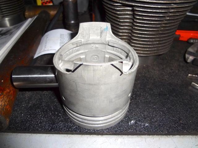

I need to cut away part of my piston to clear the crankshaft. What is the best way to do this? I guess I need to get a scale to keep the weight the same on all 4 piston.
I marked the spot I need to cut.

They do stick way out of the cylinders. I am setting my deck height with .100" of shims to get .040". I got all that under control now though. I am just wondering about cutting away part of the piston skirt for clearance at BDC. I searched but I have not found any pictures of this.

die grinder with a carbide bit for aluminum, or just a belt sander.be sure to not chamfer the edge as that can lead to a smoking motor,as it will "funnel "more oil than the oil rings can handle, the piston is slightly sharp there so it sheers off the oil from the cylinder, the clearance will let the proper amount stay on them.good luck and have fun.

Only remove what you have to. .050 clearance is enough. I agree, keep the edges sharp. Re-balance the weight of the pistons after they are trimmed.

Did this yesterday. I went to habor freight and bought a balance scale. I balanced all of them today and started assembly. It is coming together nicely so far.
