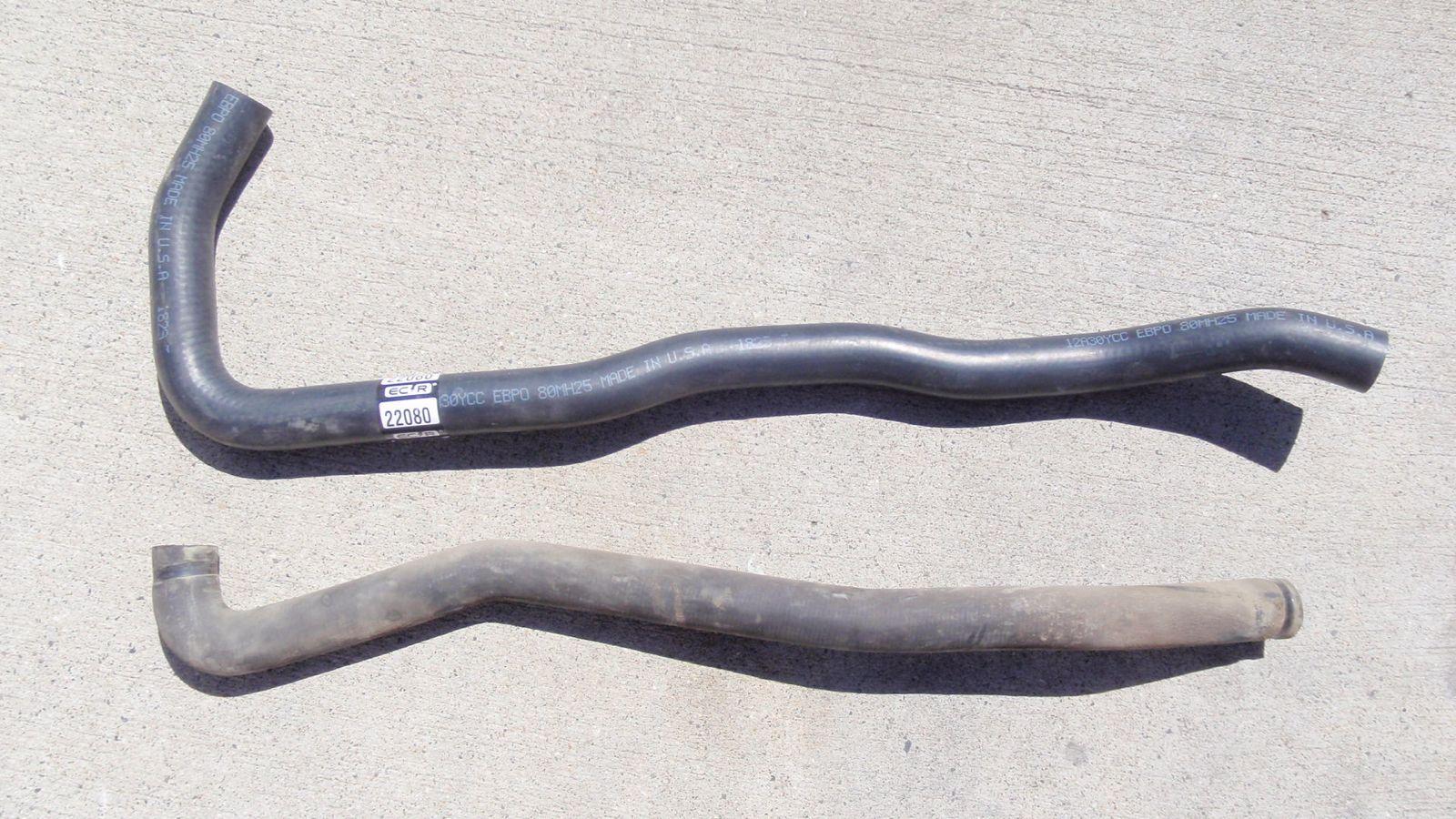

My radiator cracked in a bad spot,
so I decided to replace all the coolant/heater hoses along with the radiator. I had a hard time finding the front radiator hoses online, so I took them out and brought them into an oreiley parts store. The straight one is easy to replace. I forget the diameter (1 5/8" or 1 1/2" ?), but any auto shop will have a straight piece that'll work if you trim it. For the other radiator hose with the 90 degree elbow, the guy in the shop found me this for 20 bones (pictured above stock hose - Gates hose # 22080 - intended for a 90's cadillac):

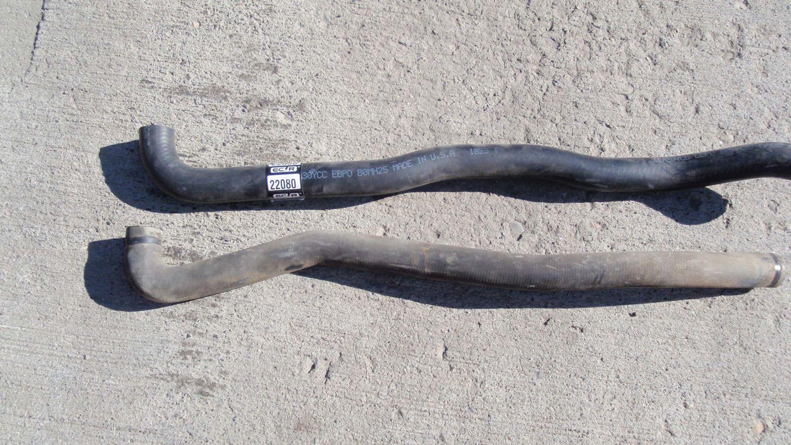

It looked close enough, so I trimmed it....
and it looked even closer. So, I put it in...
and vuala! The new straight hose is in background. I also removed the wire upper supports for the spare tire because my 205/75 r14 spare on an alloy rim wouldn't fit inflated. I bolted in the clamshell, and the spare fits with this hose in place. The hose does touch the spare, but is not pinched in any way to affect the coolant flow. I have the spare strapped to the clamshell. It's all burped and running nicely now.
This hose can be found online for less than $15 online I think, and same with the straight hose. The heater hose was $1.29 a foot, and I went though 35' after buying 40'. I also replaced the other hoses, thermostat/gaskets, pressure cap, fuel lines, fuel filters, and resealed and painted the gas tank (thank you kayakwesty for the tutorial!!). It's been a productive week....
