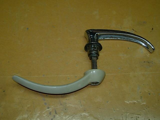

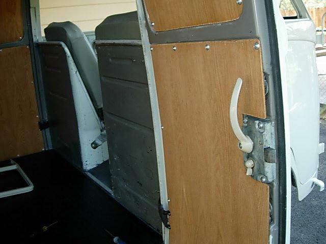

This is a photo of my 63 panel bus, it has the inner handle on it already. Iam thinking it is OG to the bus because all of the locks on the bus work with one key. Anyone have a photo of their panel with no inner handle?? The key code is marked on the square shaft that runs thru the locking part of the handle.

Here is another shot of the handle itself.
IIRC, the w/t panels used an outer cargo door handle that took the inner handle.
The bench seat panels used the short outer cargo door handle w/o inner handle.
It probably also is better to not have it catch on cargo.
