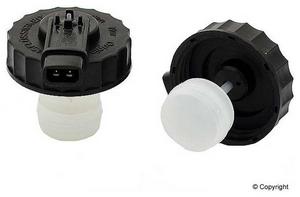

The photo of your brake fluid reservior cap does not look right, it should look like this
the part (cover) to hold down the blue thing is missing.
That could be at least part of the problem.
Best bet would be to replace cap see if that helps your problem and and then go on to bleeding brake & clutch. Then on to master, slave cylinder and brake cylinders.
Also think about what could have cause that cover to pop off. Knocked off accidentially? Kinked or blocked line causing excess pressure in system?

I just looked at your photo.
The 'blue thing' is part of the low brake fluid warning system. When the float goes down all the way from loss of fluid, the contact on the top will ground on the contact in the cap and VOILA!, warning light.
Its not your problem - the problem nost likely lies with the slave cylinder.
