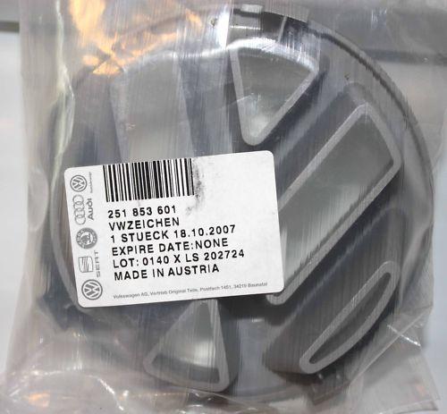

PostPosted: Fri Oct 19, 2012 11:21 am    Post subject: What later VW emblem fits a square headlight grille? FOUND! Reply with quote
Is there a VW emblem from another (newer) model that fits or can be adapted to fit the square head lamp grill?
The emblem in question is 125mm chromed 251 853 601 and seems to be about $30. I just checked and they are not extinct any more as I thought when I began this, but now an curious if an alternative is available. One might harvest from a wreck, for example for little or no money, so when this part goes extinct again, that the bling can still be shown.

1J5853601 and 1J5853601C seem to be the A4 Golf and Jetta front emblems.
Cost is not cheap either at $36 or $52 for them.
It is unclear which is which actually in the catalog.....

1J5853601 = front grille
1J5853601C = rear hatch/trunk
You are right, I looked again and the C part number is for the rear on the sedan and estate Jettas.
I now see there is a 1J5853601 and a 1J5853601A which are constructed differently.
Both the Vanagon and the A4 Jetta front are listed as 125 mm and the rear of the two look the same.
Now I will have to post pictures......
This is looking promising as the A4 emblem can be had for about $15 shipped.

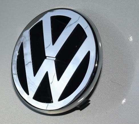

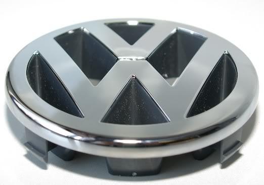

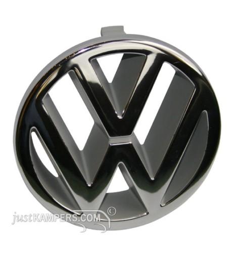

PostPosted: Sun Oct 21, 2012 12:34 pm    Post subject: TOP Reply with quote
Vanagon top
A4 Jetta top

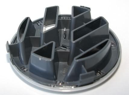

PostPosted: Sun Oct 21, 2012 12:36 pm    Post subject: Bottom Reply with quote
vanagon bottom
A4 Jetta bottom

PostPosted: Sun Oct 21, 2012 12:37 pm    Post subject: Back Reply with quote
Vanagon back
A4 Jetta back

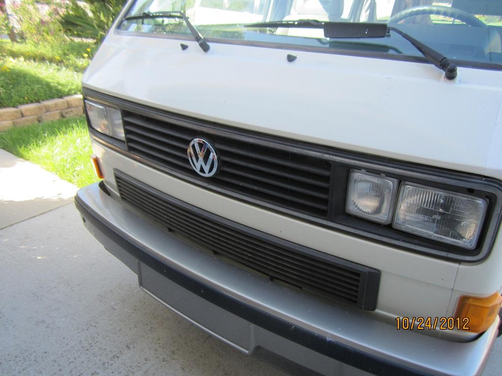

PostPosted: Wed Oct 24, 2012 2:53 pm    Post subject: DONE! Reply with quote

PostPosted: Wed Oct 24, 2012 6:13 pm    Post subject: Reply with quote
Did it just pop in, or were modifications necessary?

FYI, Chris Turner posted this to the Vanagon email list server in 2001.
Many had this emblem in place soon after.
Run a fine tooth saw behind the snap hooks to make some more room for them to hook into the late Vanagon grill.
The eBay cheapie copies will tarnish within months and the chrome looses its look quick.
Dealer quality emblems are much better and yes twice the cost.
Enjoy.
syncrodoka wrote:
They need to be tweaked slightly for mounting though.
While test fitting mine just popped in. So I left it. This was before the file was mentioned. I did measure with a caliper and it was the same so I left it alone. I may look closer some other time. For now it stays...
