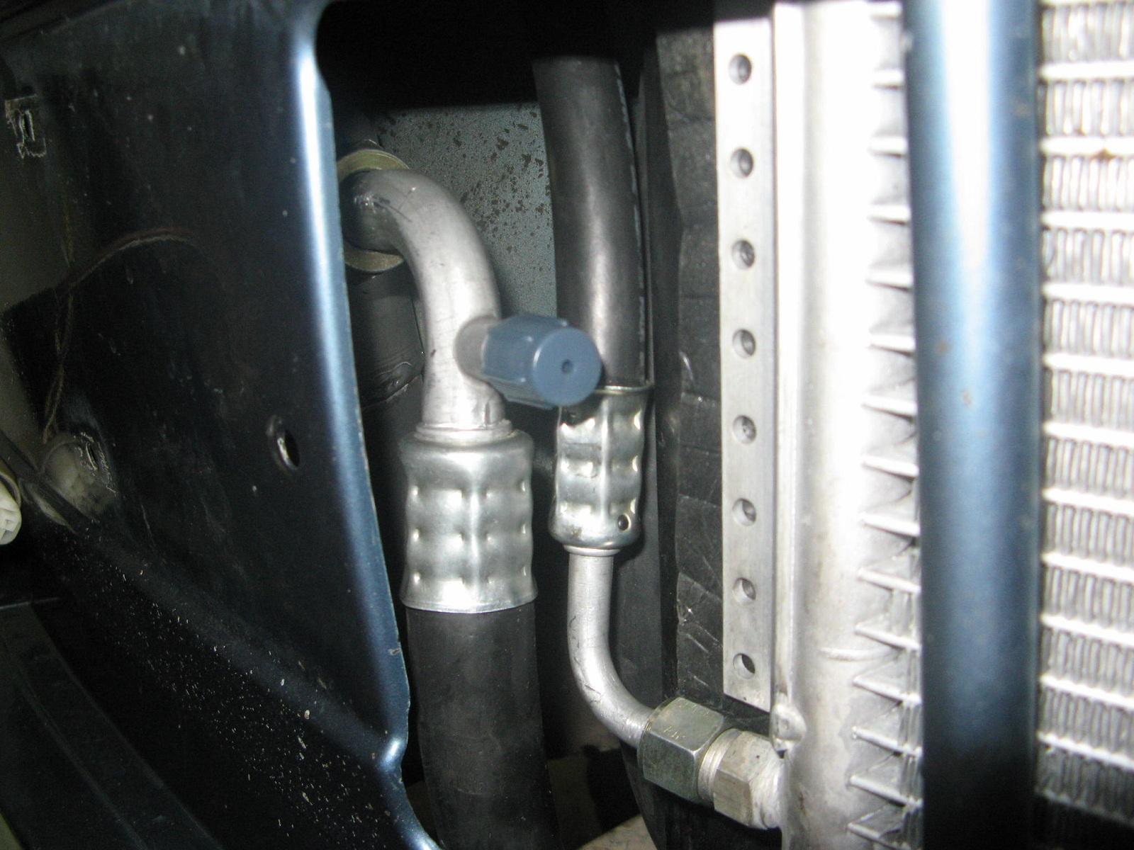

Here is the trial fit of the suction line fitting to the compressor after braing on the hose end, but before and clamping the hose end.
Marked the hose and ferrule for orientation:
Lifting the hose up to use my crimper:
Suction line now installed and checking the discharge fitting orientation to decide on placement of the hose end fitting to braze on. Yes, the discharge line has corrosion on it. The factory SVX line has rubber over this area and it appears to have kept water or some other corrosive in that area, causing corrosion.

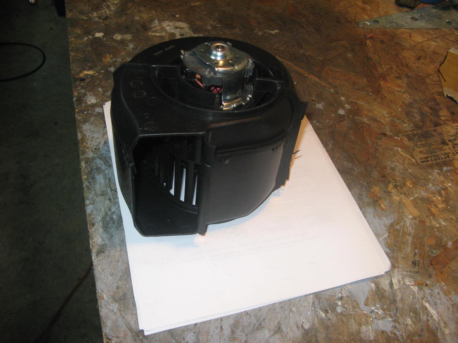

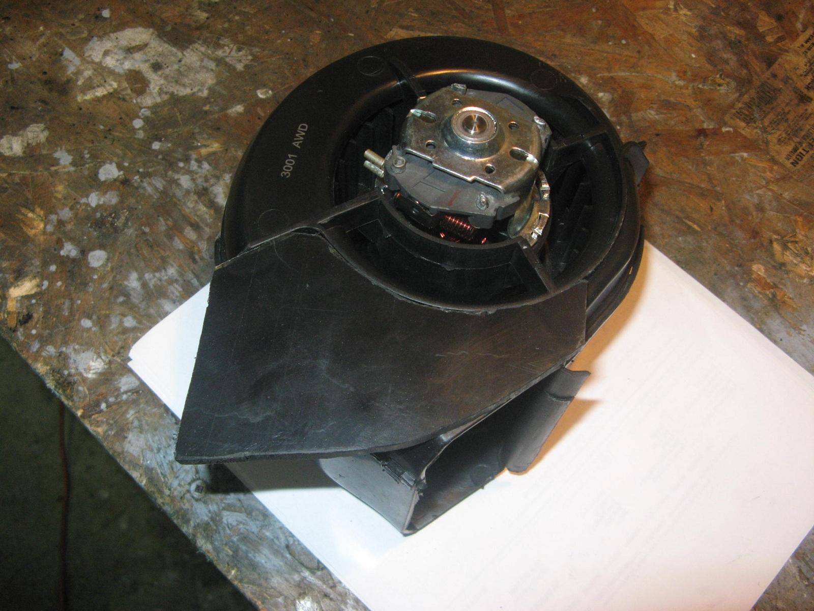

Here's the first bit - - getting the fan in place. Below is a standard, new, Vanagon blower fan.

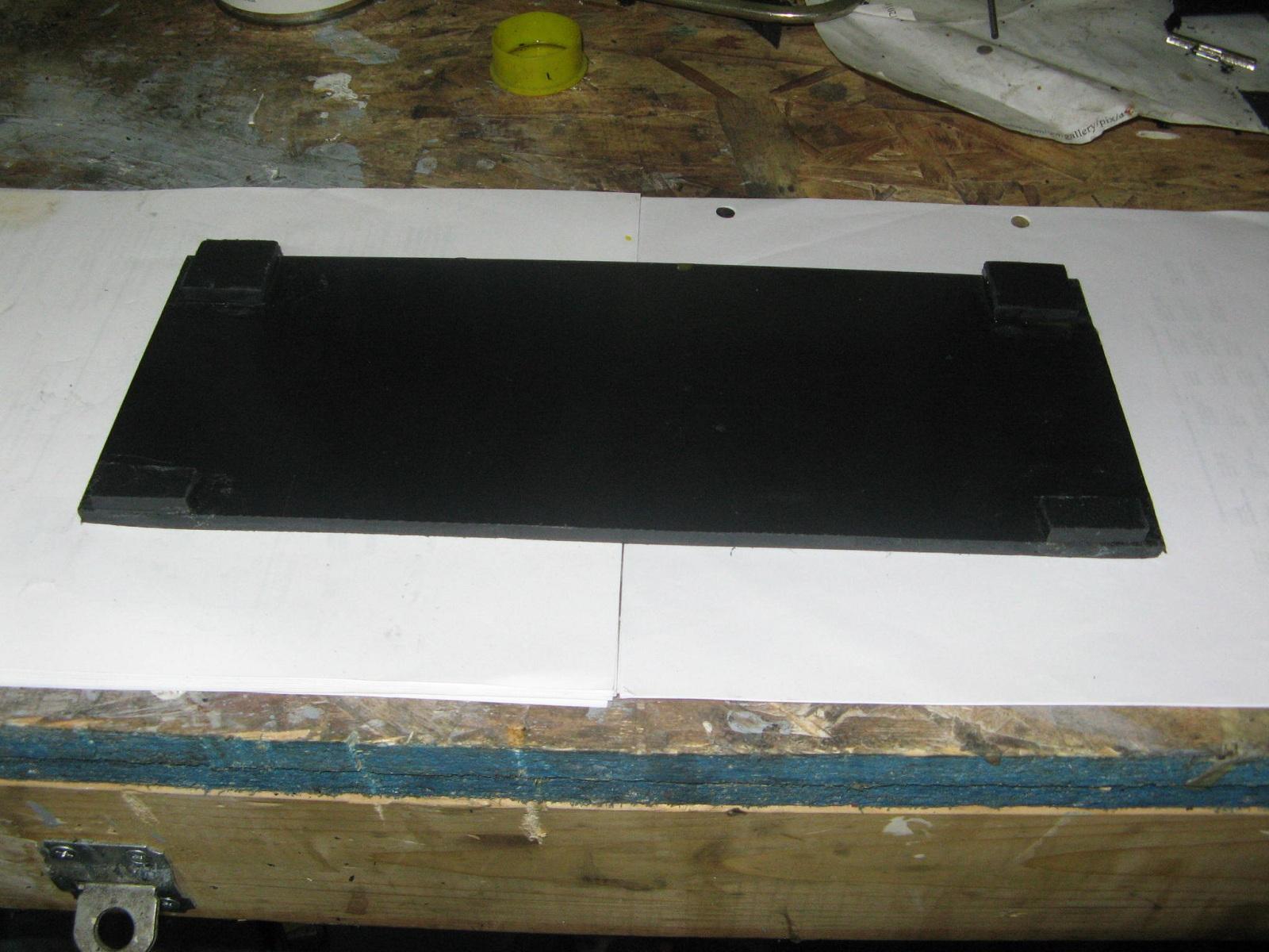

I need to mount the fan and made up these flanges for each side of the fan.
Dry fit before gluing:
The beauty of ABS is it can be formed with heat (carefully) cut with a sabre saw (as here) and "plastic welded" using ABS cement. This is found at any Home Depot. It chemically melts the plastic so it bonds to the piece you are joining. At room temperature, the bond is almost immediate, so you need to be quick and accurate on this. My garage was cold (say 45 degrees F), so I had more "open" time with the glue.

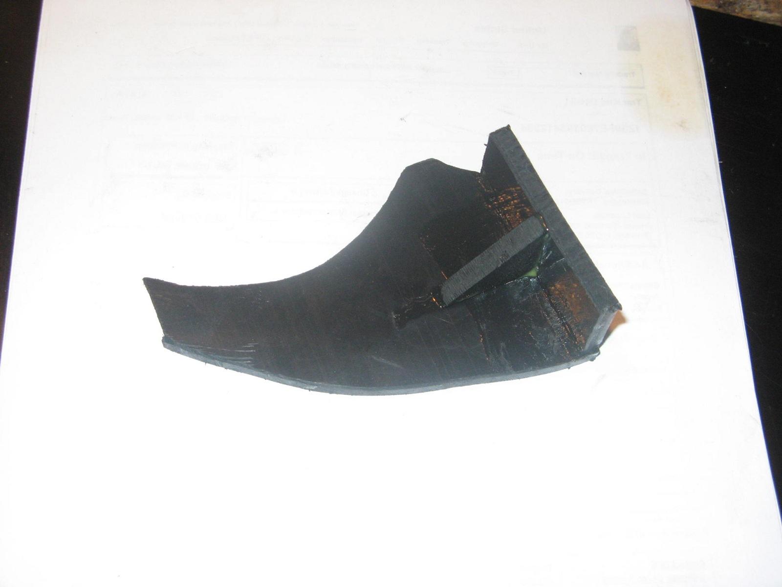

Here's one of the flanges finished and ready to glue to the fan. The small tab is where my mounting bolts will go.
Now a duct-tape assisted dry fit to double check in the fan's intended location. The weather stripping is only there to isolate any fan vibration from the sheet metal the fan will bear against.
And the fan with flanges glued in place and ready to mount (after drilling mounting holes):

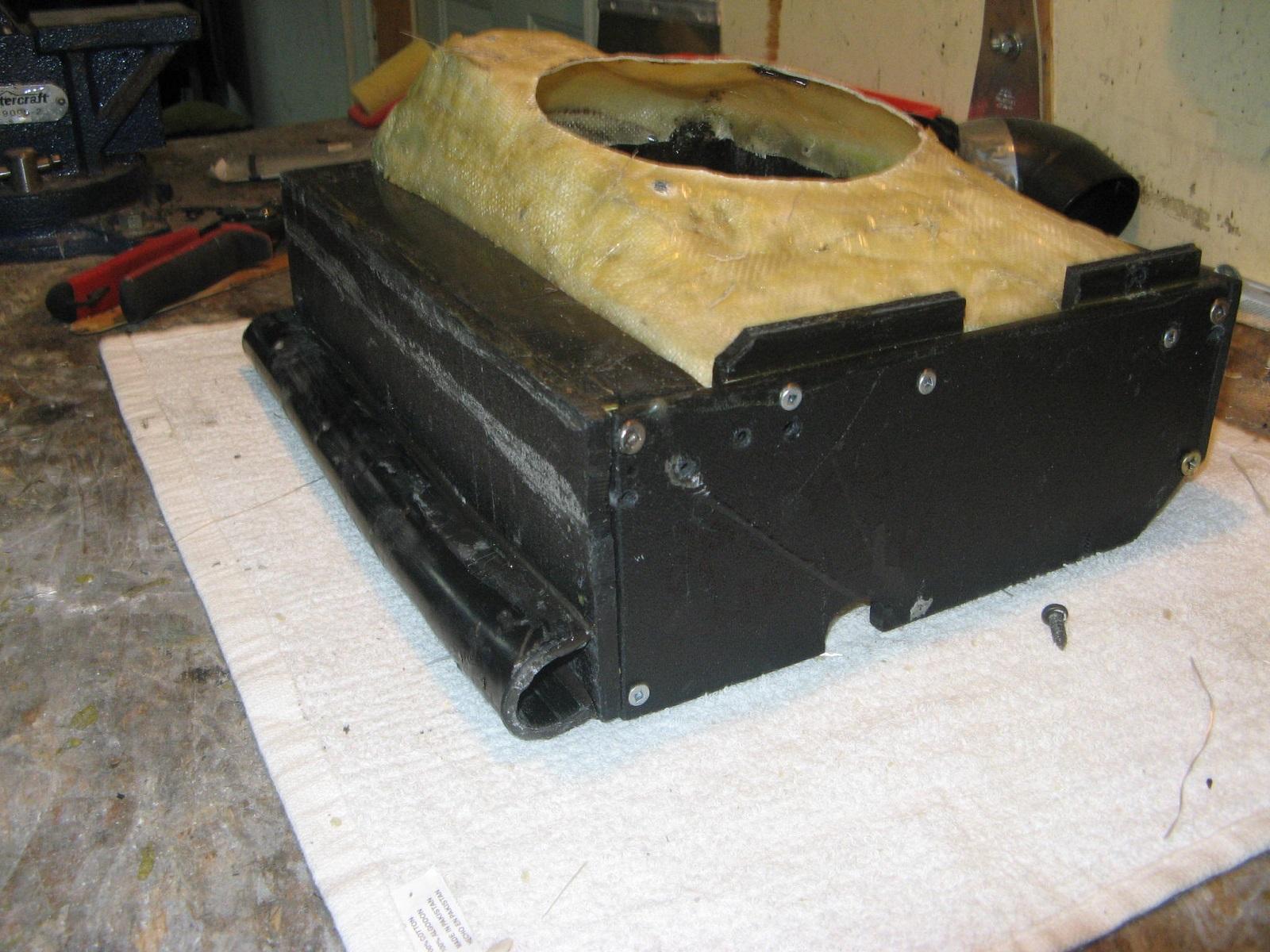

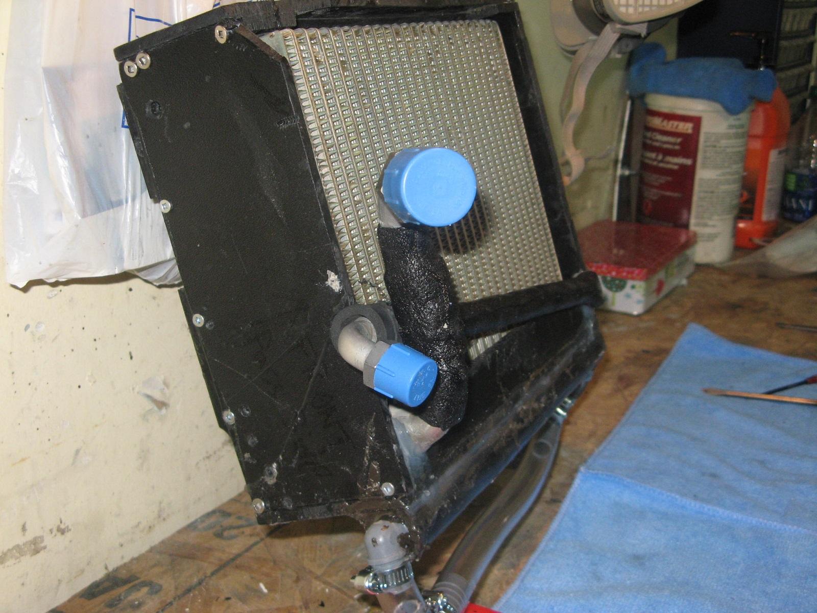

I am using 1/4" ABS sheet plastic to make the evaporator housing. ABS can be heated and set, solvent welded or screwed together. I use all these techniques. I solvent glued these tabs to the bottom of the housing to receive screws. I know fibreglass would likely have been easier, but the resin smell would last forever and a day.

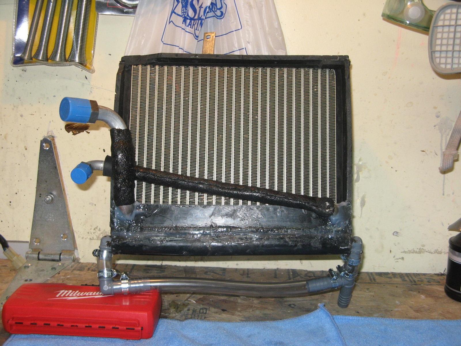

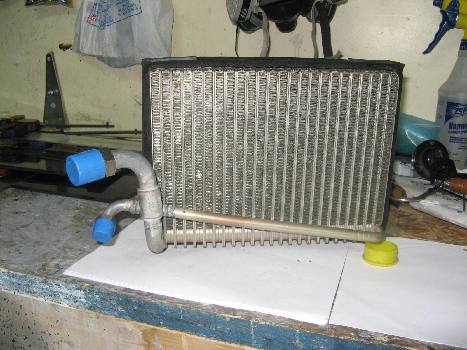

Here's the evaporator core after aluminum brazing on the required fittings for my install.
This is the orifice tube holder with my awful (but leakproof) aluminum brazing.

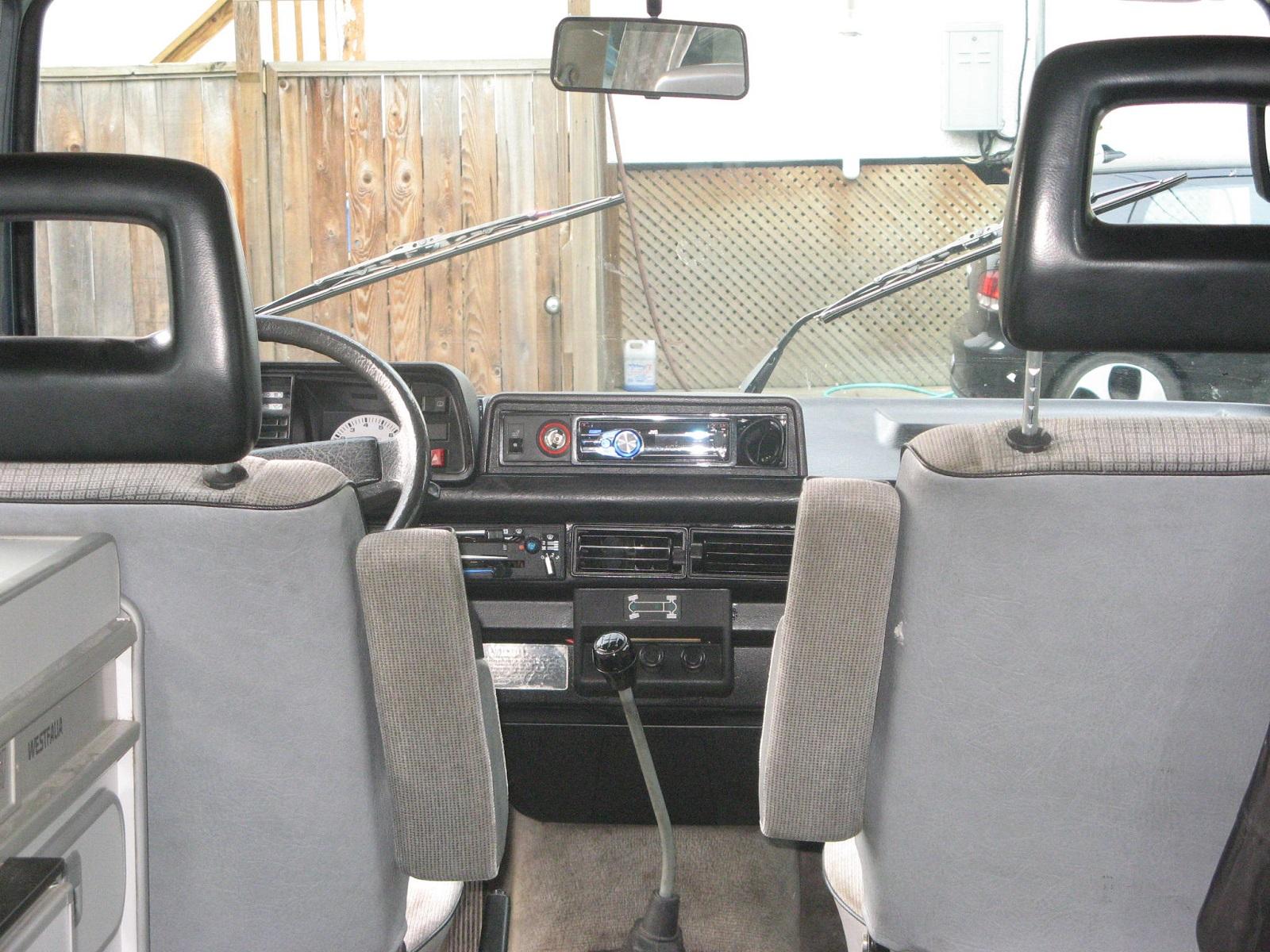

This shows the modified vent through the ash tray hole. This will be the right hand vent of the two centre vents.
There is no sense in having a front AC system if hot air can still come in through the VW fresh air ducts, so I installed closing flaps that will be operated by a vacuum servo. The flaps are also need for cool-weather de-humidifier operation since I am ducting some (not a lot) of chilled air into the Vanagon air box. Here are some pics of the fresh air closure flaps:

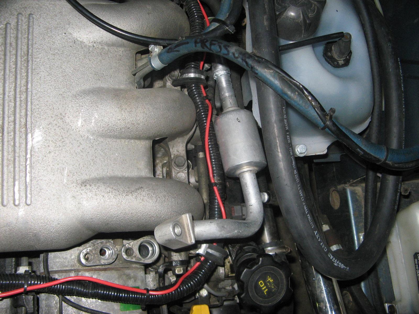

Here's my high-pressure side aluminum brazed solution. It was the last braze I did and the least ugly!
The accumulator fits, but just barely. My knuckles are knackered.

I have had to reconfigure the evaporator from my original plan. The original plan was to use a Vanagon blower fan to force air through the evap. In the end, the space was not sufficient to permit this. The blower fan outlet was right up against the evaporator core, so most of the evaporator area would not get air and only a 2" by 4" area of the evap core would get air from the blower.
The solution was to use a fan on the cold side of the evaporator to suck the air through the evaporator and blow it into a plenum that directs the chilled air to 4 large ducts (one each for the four vent grilles) and two small ducts for my patented Krotch KoolerTM outlets.

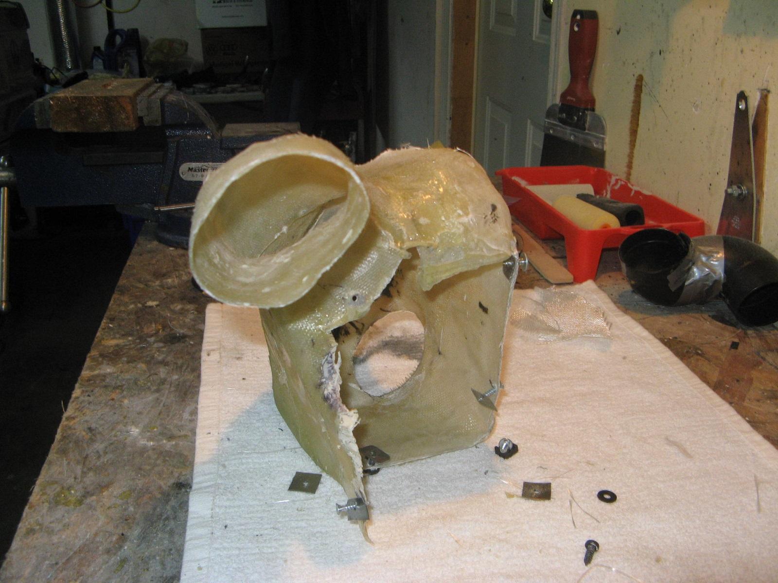

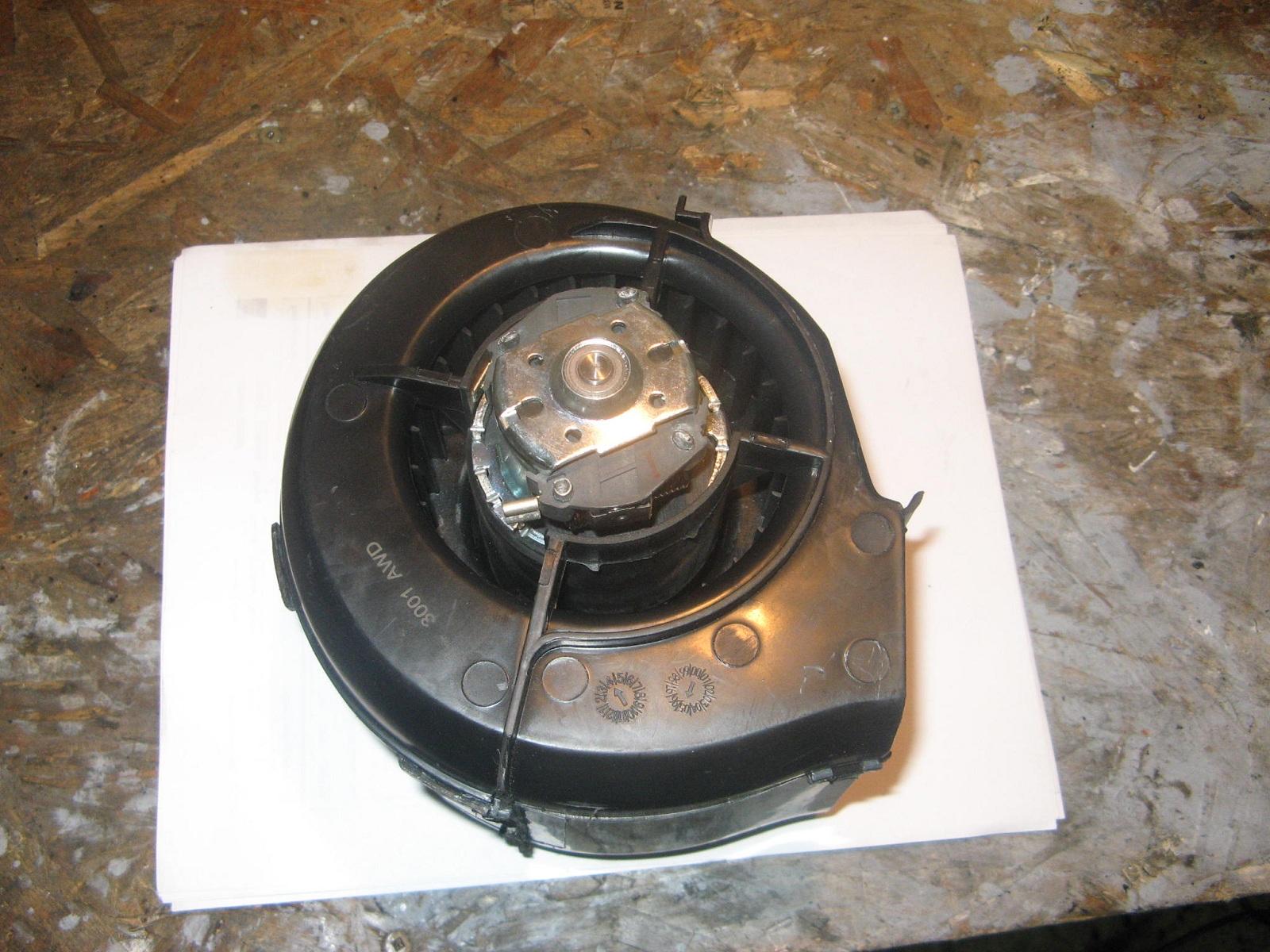

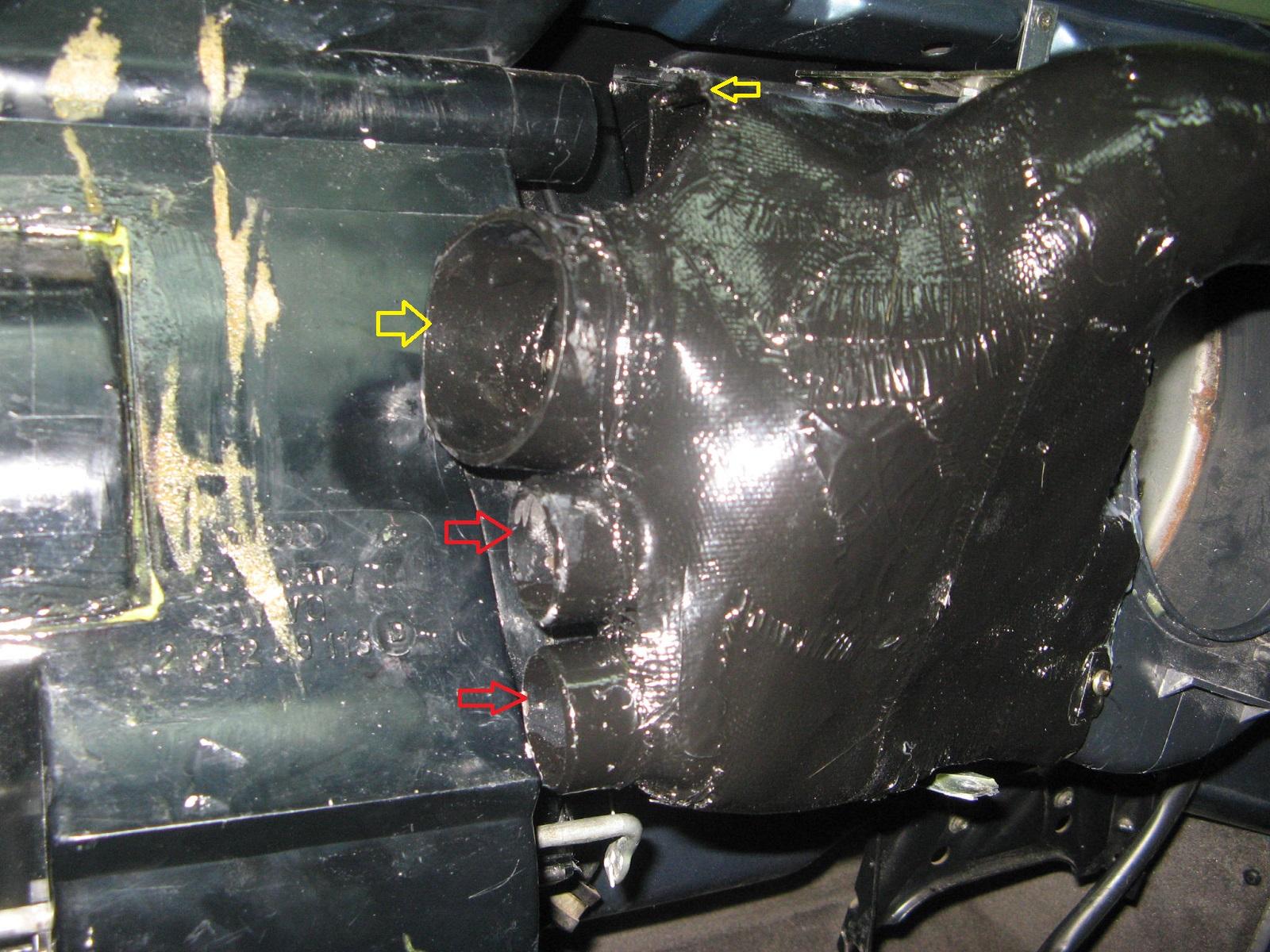

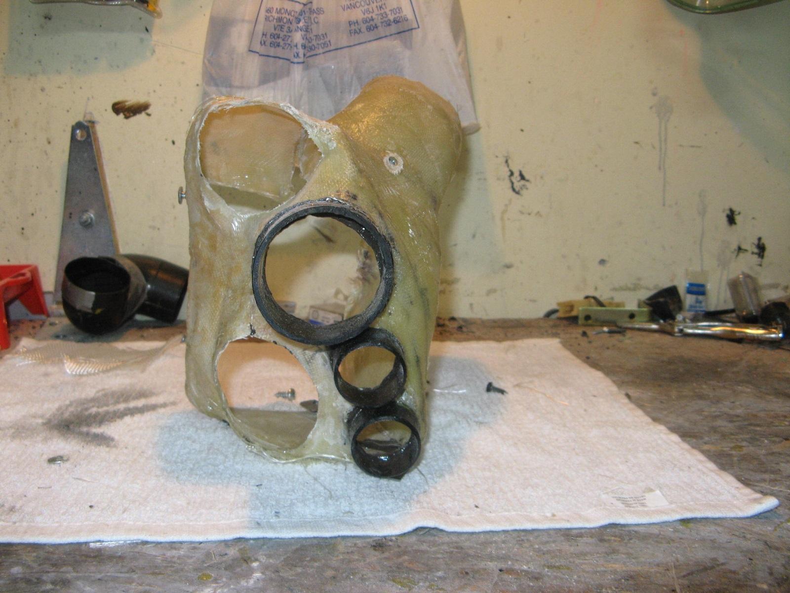

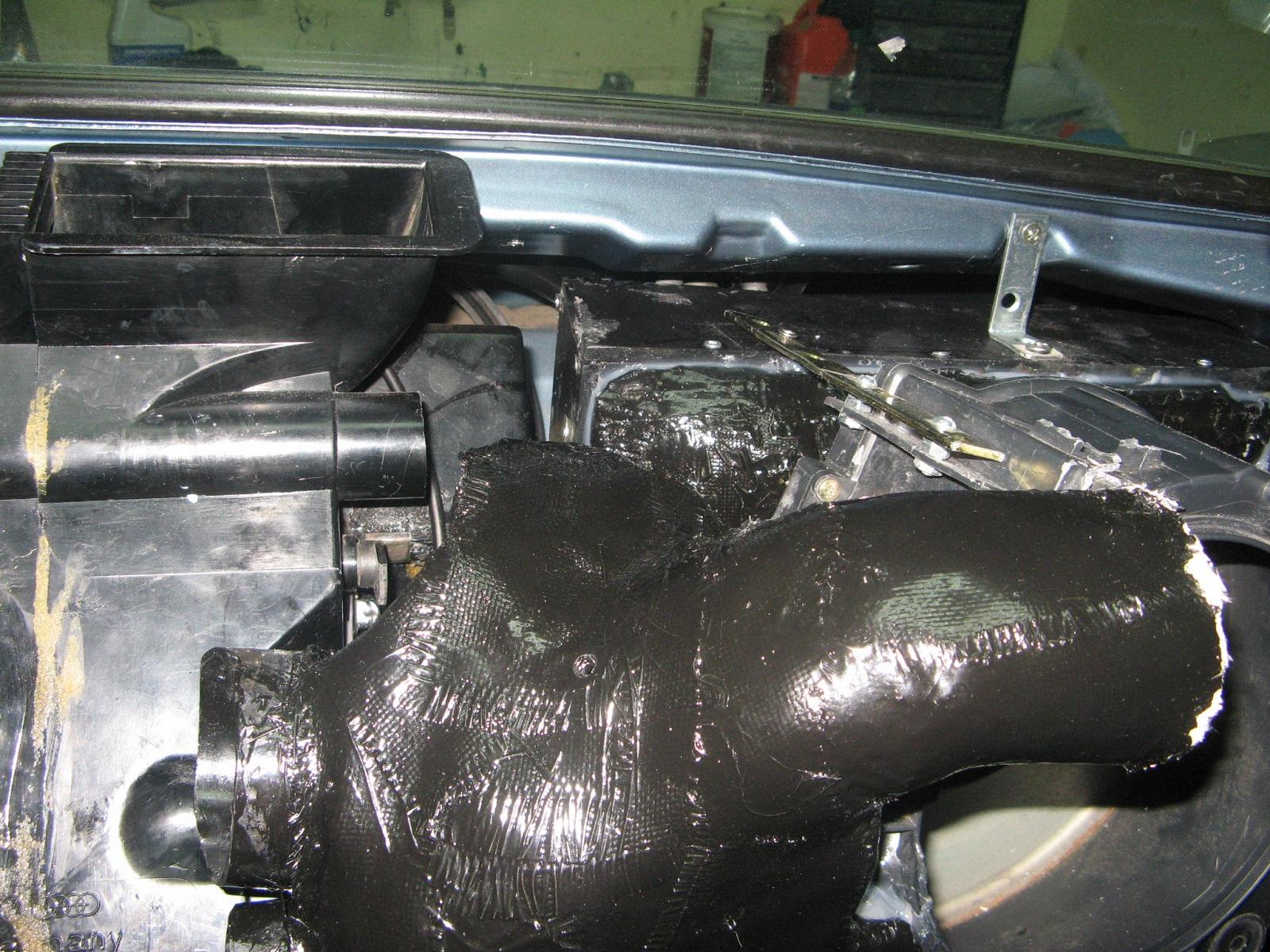

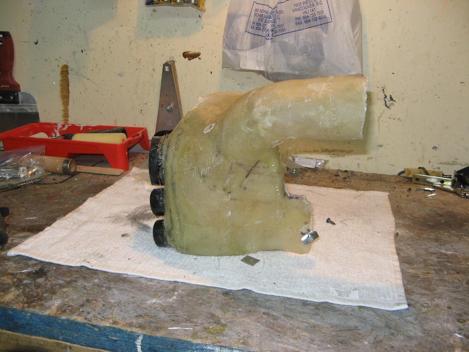

The 3 pics below show the plenum I made which receives the chilled air from the Toyota 4Runner (1990 to 1995) blower fan. I made 4 large outlets and two small ones. I gave up on ABS as I just could not get the shapes I wanted. I used fibreglass to fabricate this stuff, using modeling plasticine to make a one-time only mold. The long nozzle in the first pic is the duct feeding the far right dash vent.
The 3 pics below show the shroud I made to attach the Toyota fan to the evap box and draw air through the evaporator core.
This pic shows the water drain for the evaporator box:

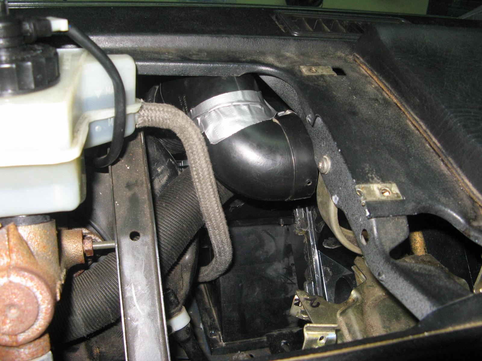

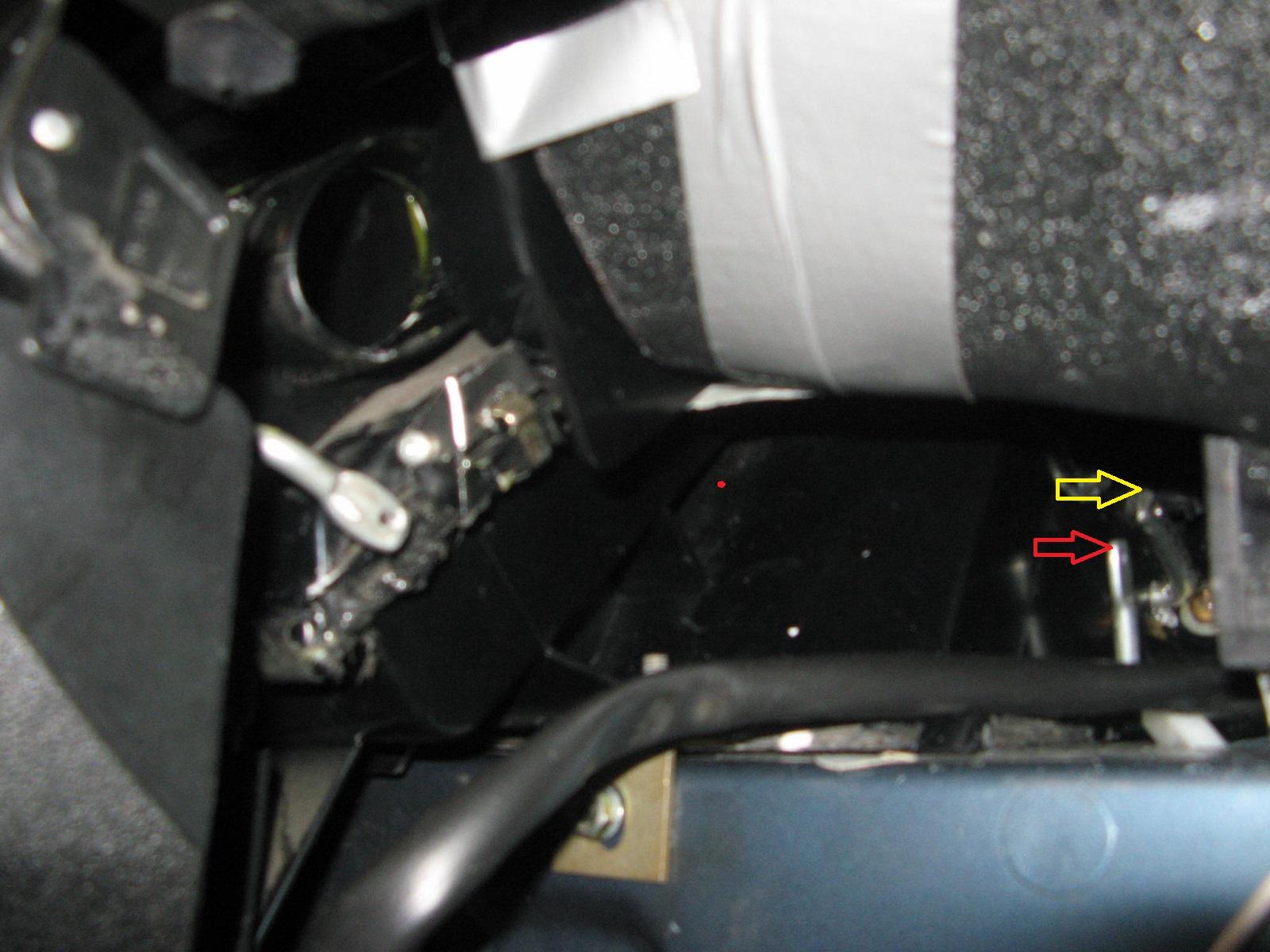

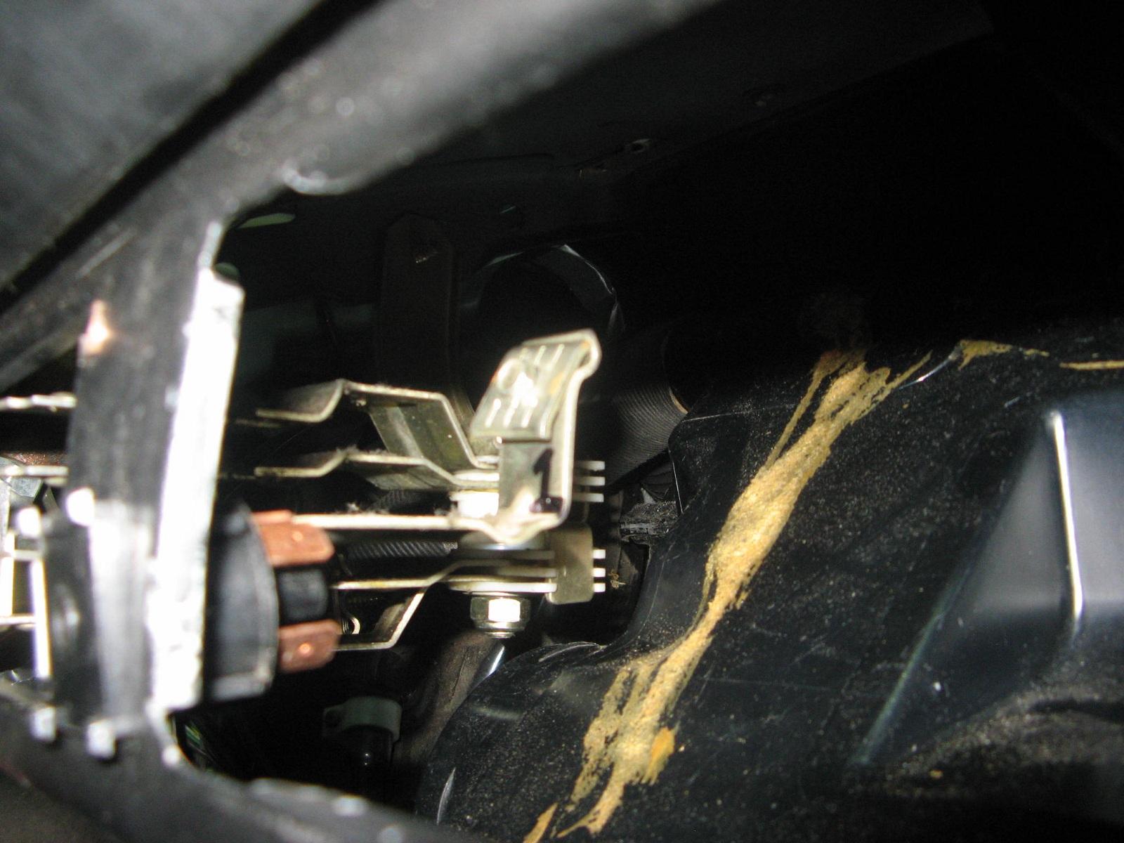

In the pic below, the yella arrow shows the lever arm for the fresh-air block off doors I made. This keeps all the outside air outside when you select that setting. I use the bowden cable that used to operated the fresh-air doors that feed to the ducts in the front doors. Those doors are wired shut.
The red arrow shows the space available for duct hose to supply the Krotch Kooler TM vents (green arrow).

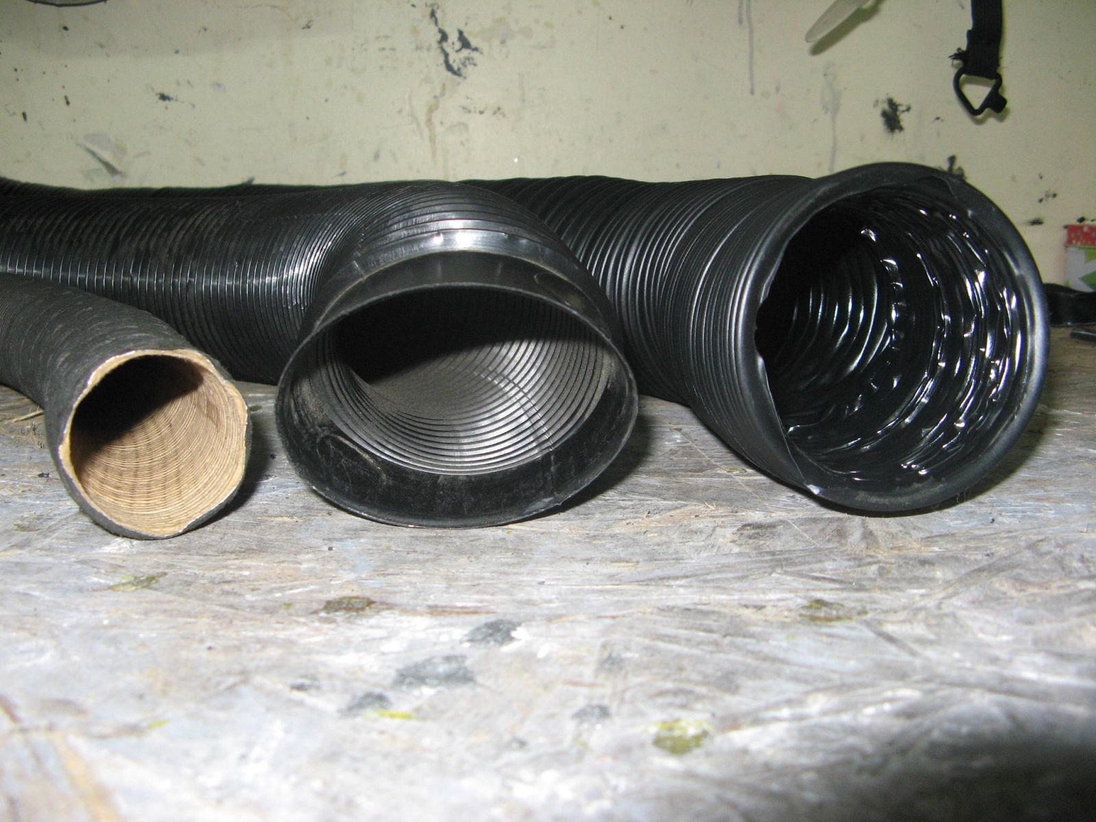

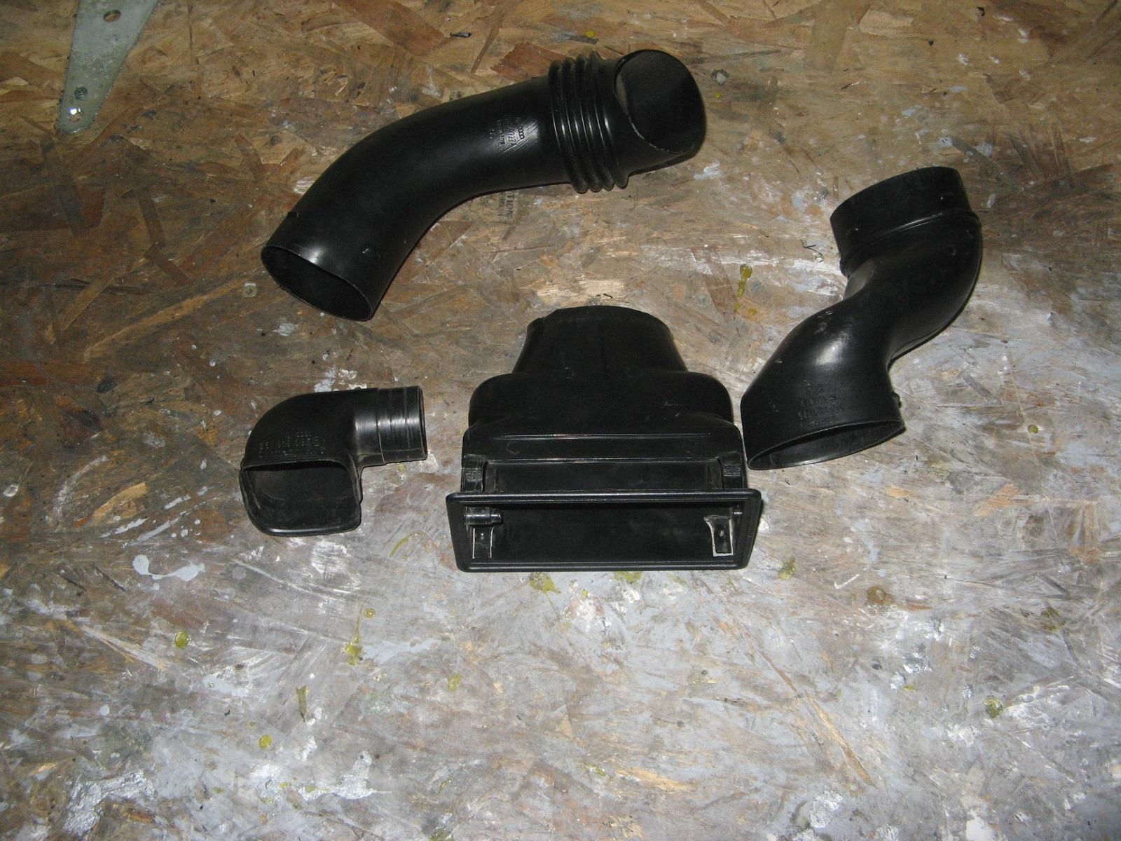

VW actually has a lot of useful bits for ducting. Don't be shy at the pick n pull.
VW defrost hose left. VW main vents hose centre. Right pic is aftermarket AV vent hose. |I don't like it for long distances as it will, I think, reduce air flow compared to a smooth duct. This is also why I spent a lot of time configuring my plenum attached to the toyota blower fan.
The VW vent outlets are easy to modify for tight spaces:

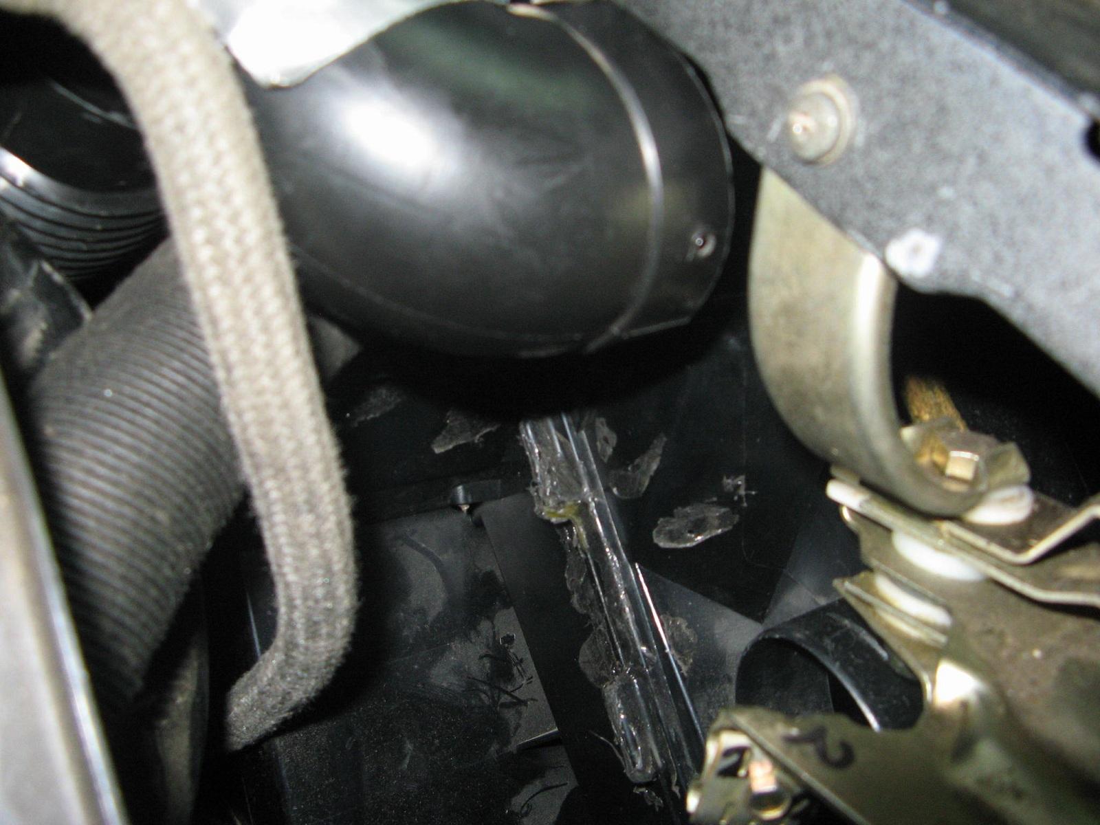

For the DIY guy, silicone is your friend. This shows the evap box with drain lines installed.
Ditto:
Ditto:
The shroud and plenum I built from fibreglass stank of fibreglass resin, so I painted both with POR15 and they do not not smell of anything now. Inside the shroud, I used JB Quick epoxy to glue in small metal plates to accept the machine screws that attach the blower fan housing to the shroud. Here are two pics:
The next two pics show the 4Runner blower fan housing mounted to the shroud. Circled in yellow are the 4 screws that attach the blower fan housing to the shroud using the metal plates.
The plenum looks ugly, but it works. Should have used low gloss paint!

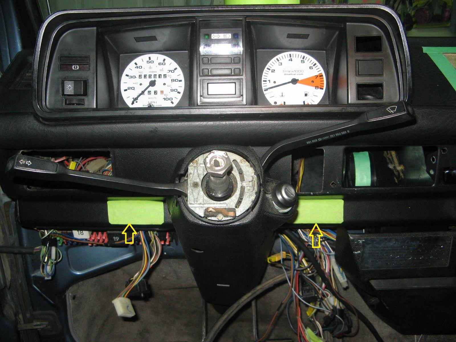

The yellow arrows point to the ducts for the far left (driver's) vent and one fo the two centre vents. The red arrows point to the ducts for the Krotch KoolerTM vents. The duct that swoops around to the right supplies the passenger side vent.

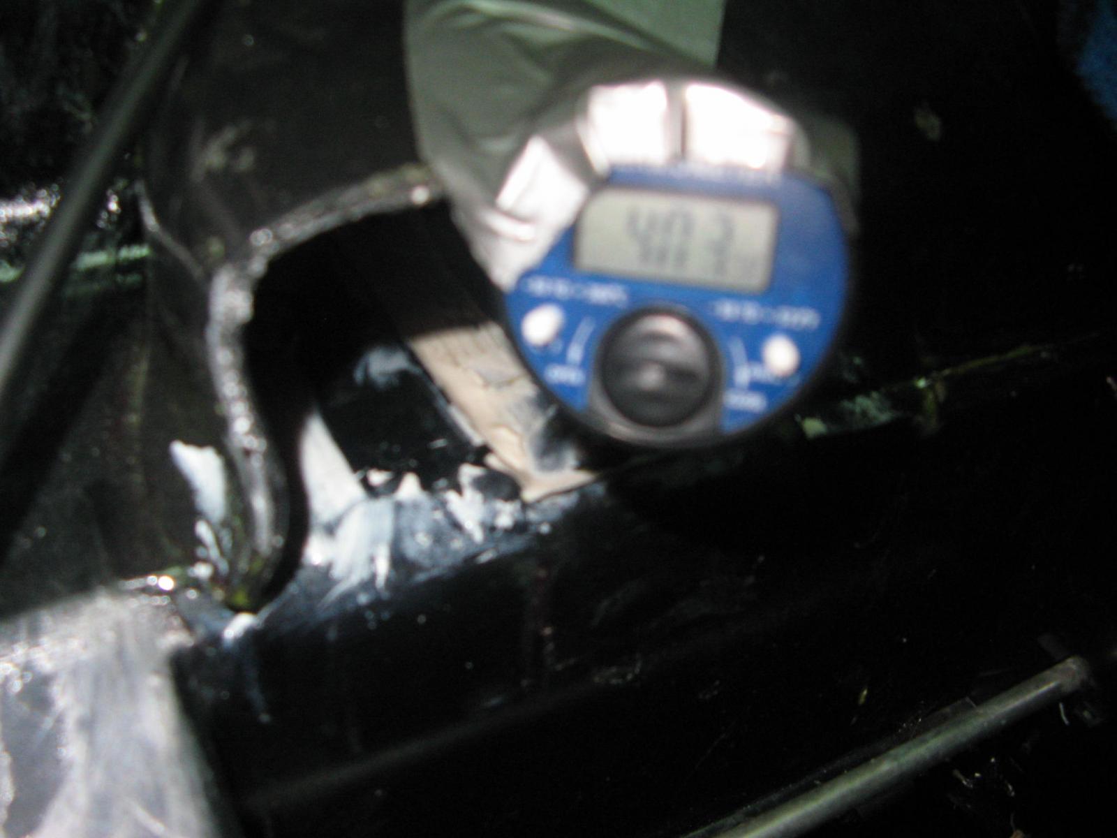

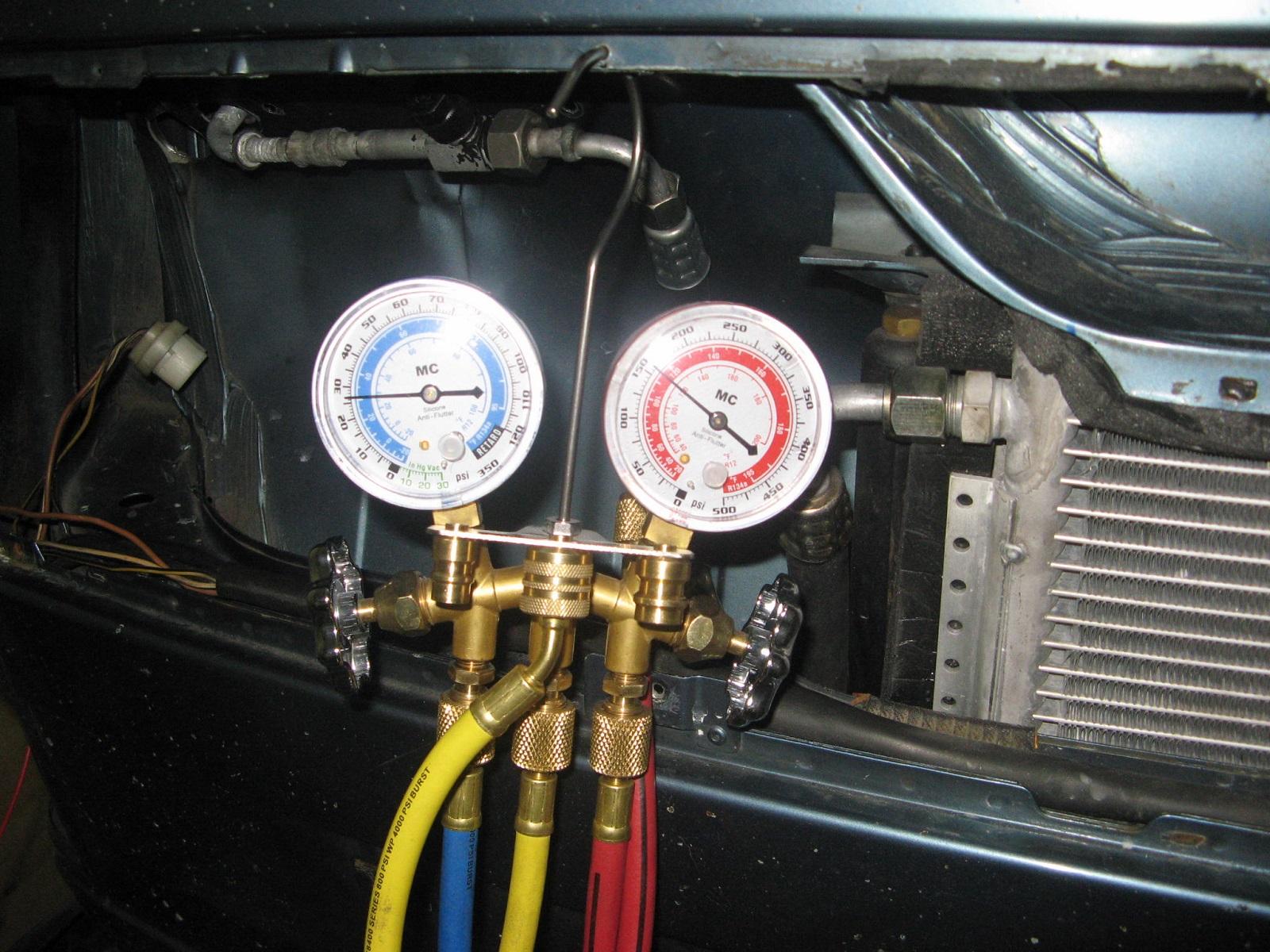

Nice high-side pressure (rad fan on high)and good low side pressure:
40.3 degrees F at the centre vent and (shop/garage at 75F interior at about 85F). Right side vent was at 38.1 degrees F, but the pic did not turn out (damn flash!)

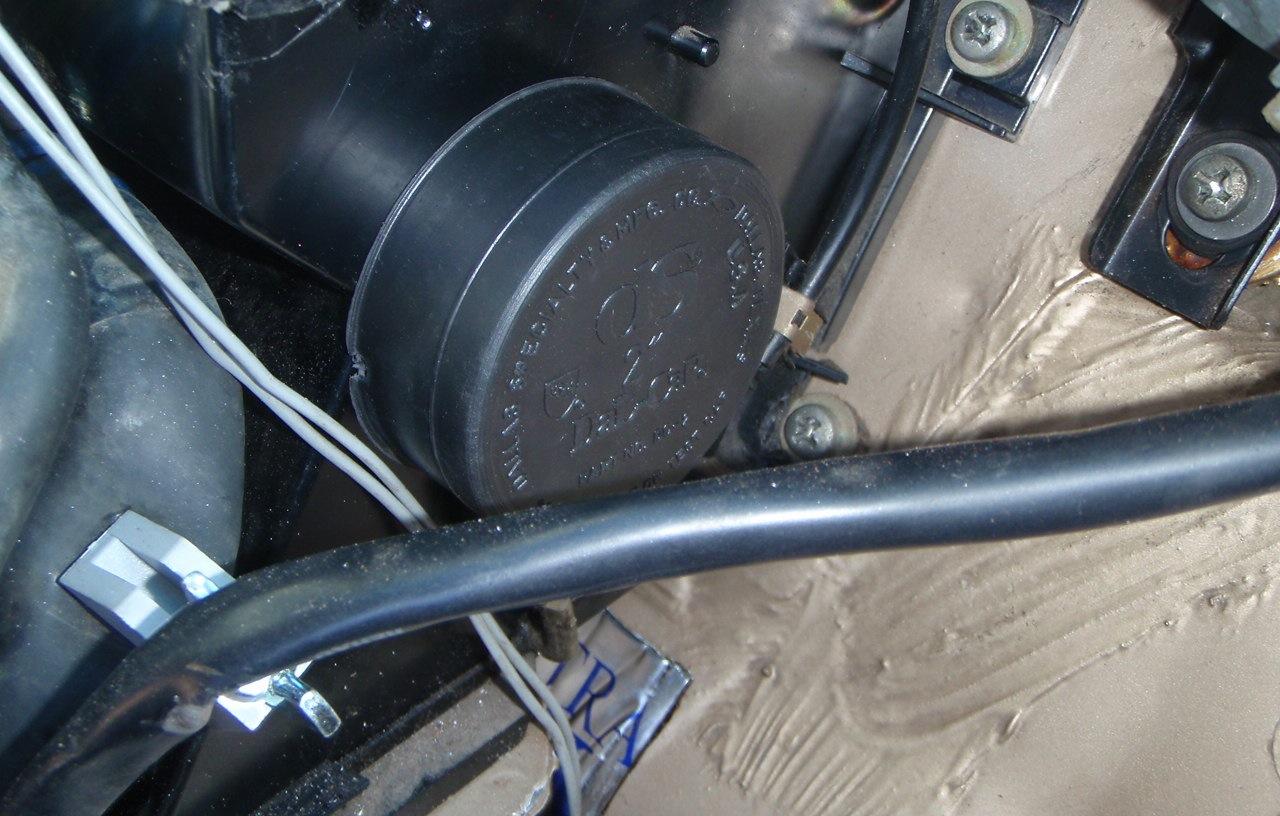

Thanks, Dobryan. With the new configuration pulling air through the evap instead of a pusher approach, I probably would not need to clock the windshield wiper motor. It also turns out that I did not have to use the Vanagon heater/ventilation box for one of my ducts with this revised evap location and set up.
For anyone wanting to replicate this setup, this means no clocking of the wiper motor is needed and the only mod to the vanagon heater/ventilation box is to install doors to keep out hot ambient air. If all your seals are in good shape, then even that is not required, making this more of a bolt in. I wanted the extra flaps to that I can feed chilled air to the factory vanagon heater/ventilation box in future if I choose. That is still an option with the way I built the plenum.
The major work for me was getting the orientation of the evap box, custom shroud and custom plenum just right to take advantage of the space actually available under the Vanagon dash. No off-the-shelf unit except the Behr unit really does this effectively, so I had to DIY.

A much-delayed response here. The Behr unit requires you to forego the glove box. My approach saves the glove box. The aftermarket evaporator units mostly use comparatively lower-quality tube-and-fin evaporator cores that are not necessarily easily sourced if the supplier stops stocking them. When I say lower-quality, I am not suggesting that they will or may fail, but only that they absorb less heat for a given physical size of evaporator. If you have lots of space, tube and fin is just fine and easily cleaned if you have a compressor failure. I have space constraints.
Also, using an OEM-style evaporator allows you to go online and get a great price on a quality aftermarket (eg Four Seasons brand here in Canada) evaporator. But mostly, the new high-efficiency design of the evap core I used was the selling point. It's small, but really absorbs a lot of heat! Of course, I will have more to say on this after testing in the 100F temps of our desert country this summer.
I have thought long and hard about an easy solution to converting the stock air handler to use an evaporator core inside it. I am sure there is a solution and that it would be more compact than my approach. But the real difficulty in the Vanagon is in the fresh-air intake. It is located very centrally, whereas all OEM cars and trucks with a fresh air AND recirculating air handler have the fresh air intake on one side, usually feeding an air handler that has both the evaporator and the heater core and ducting doors/vanes that control air flow through or around the heater core. Toyota has the fan blow through the evaporator in a separate evaporator box and then into the air handler. Audi's large cars pull air through the evaporator, into the fan and then through the air handler. All those systems have dimensions that will not fit into the vertical space in the Vanagon.
The aftermarket systems which I have seen installed in Vanagons shown on the Samba and elsewhere did not utilize a fresh-air intake for the heating/defrosting function. Since I drive in both very hot and very cold ambients here in BC, I still needed the fresh-air intake for the cool/cold weather. Hence, a stand-alone AC system was my choice - - for now at least. Now that I have a few AC tools, I am not hesitant to try other things.
I have finished the system now and will post pics and conclusions shortly. The approach I ended up with, using the Toyota 4Runner (1990-1995) blower motor blows HUGE amounts of air. Here's the Toyota blower fan in my install:
Using as many smooth ducts as possible, I suspect, helped a lot with the air flow. I can run the blower with the compressor off, due to the kind of AC thermostat I used, so I can get interior airflow without any compressor drag when only air flow and not cooling is desired.
I was, until I tested it, dreading the possibility that after all my work, the system would just wheeze out a bit of slightly tepid air. No such thing. It's not just awesome, it's AWESOME . Very happy camper here.

Nice work! I think you have uncovered an important fact with your Toyota fan. I have the Vintage air system in my dash, It makes cold but doesn't move the air like I think it should. I'm going to look into some different fans now that I have seen your work!

PostPosted: Sun Apr 07, 2013 10:30 pm    Post subject: Reply with quote
Well, project now finished. Here are some interior pics.
The "mini instrument panel" is from a 1990's Audi. That's where the red-lighted 12 cigarette lighter receptacles came from, as well as the seat heater switch. No seat heater is yet installed - - that's for Autumn. On the Vanagon heater controls, I installed the AC on/off switch. The bottom lever now controls my fresh-air/recirculation flaps. The small control panel on the far right has the AC thermostat on top and the 4-speed fan switch on the bottom.
Bonus: I still have a useable glove box with 1/2 to 2/3 of the regular space available.
To the right of the radio is the cubby that holds my USB extension cord. Yep . . . front and rear diff locks and decoupler, all from Darryl at AA Transaxle.

PostPosted: Tue Apr 09, 2013 12:41 pm    Post subject: DIY Front Air Conditioning: Now Complete! Reply with quote
Well my front AC is now done. It works very well and I am very happy with it. So now I will summarize what I used, what worked and what didn’t work.
1. I used my stock Subaru SVX compressor. It’s a Zexel unit. I have not used the variable-output capability it has, but hope to in future so that the compressor won’t cycle so much. Maybe someone clever with electrics (Crazyvanman?) can help me get that part working later.
2. I used the CCOT (cycling clutch orifice tube) system for robustness and also to allow me to install an auxillary rear evaporator if the front unit fails to adequately cool the rear of my westy.
3. A lesson learned: The accumulator used in a CCOT system is very bulky and if I was not mulling over a rear evaportor being added later, I would have used a TXV (thermal expansion valve) system for tighter packaging. On a dual evaporator system, the secondary evaporator almost always uses a TXV, with the front (main) evaporator using a CCOT approach.
4. I am very pleased with the Nostalgic Air parallel-flow condenser. I got part the 16" by 24" unit. Fits well.
5. I used #12, #8 and # 6 AC hose throughout, no hardline except factory ends. If I did it again, I would consider using aluminum for some of the long runs. I fished the hose through holes I drilled in the chassis bulkheads to keep the hoses up high and out of harm’s way, since this is a Syncro and I do drive through some rough stuff (like sagebrush, rocky areqas, etc.) On a 2WD, I would not go through the chassis bulkheads with the hoses.
6. The evaporator is for an Audi A4. It’s just the right size to fit in the limited space available. I would use it again.
7. The blower fan is from a 1990-1995 Toyota 4runner as is the 4-speed resistor that comes with this unit. (I did re-locate the resistor for packaging reasons.) This blower fan and the installation pulling chilled air from the evaporator instead of blowing through it, was the single most important choice in making this system work. This is a powerful blower.
8. I made a convoluted duct through the Vanagon air distribution box to feed the left side outlet of the two centre outlets I installed in my dash. The right centre duct is fed directly from the plenum I made from fibreglass. If I had to do this again, I would not modify the Vanagon airbox in this way and would use one large duct with a splitter to feed the two centre ducts.
9. I am very happy with fresh-air/recirculation flap system I installed. Keeping the hot air out of the van in summer really depends on this.
10. I never did connect the AC plenum to the Vanagon air box, although this is still possible on my setup. I just can’t imagine needing it. The stock Vanagon air box has always done a great job of defrosting my windows in cool/wet and cold/wet conditions, so I won’t need the dehumidifying function in cool or cold weather.
11. I tried to use finishing parts that either were or looked like they were VW parts. So, I used an extra rear-heater switch I had to hold the blower fan switch and the AC thermostat. I also installed the AC on/off switch on the main heater controls. I got some Audi bits that look like they might be VW bits. Overall, I am happy with this and the function of the various parts.
12. Since my van is a syncro, it already had the heavy duty 450 watt rad fan. It did not, however, have the proper resistor to enable 3 fan speeds. I substituted tha rad fan resistor from the Eurovan.
13. I looked at the wiring diagram for the stock VW AC and essentially replicated that. The stock system has one relay which has two functions, and I used two separate relays to mimic that relay. The Blower fan has its own relay to control fan speed 4 (which is direct connection to 12V). The factory fuse panel allows you to use relay position 5 by adding two wires t the back of the fuse panel, so that part was easy. I did add a separate refrigerant high-pressure switch which switches the rad fan on to medium speed (up from slow speed) when the refrigerant pressure gets to 220 psi. There is also a separate normally-closed relay that disconnects the compressor whenever the rad fan circuit goes to the highewst speed, to reduce condensor heat input into the radiator. This also mimics the VW setup.
14. One complaint: When I switch my AC on, the rad fan comes on at the lowest speed, as expected. My fan, however, is quite noisy, even at low speed. My son's Westy, on low speed, is much quieter. I expect that installing the new fan I just bought will make this quieter.
15. Oh - - I almost forgot to add: I used RedTek as refrigerant, used the Subaru-recommended amount of PAG compressor oil, and added a bit of oil above that to account for the very long hoses in the Vanagon. Except for the compressor, every component in my system was new, so there was no old oil in the system.
