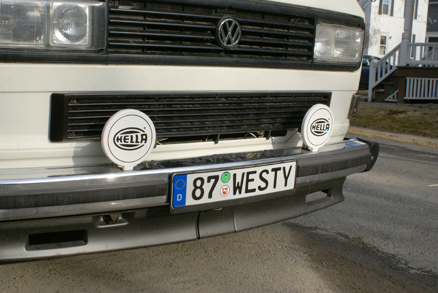

Get one of those steel plates with mounting tabs to mount behind your license plate.

PostPosted: Thu Nov 22, 2012 4:47 am    Post subject: Reply with quote
Read this thread.

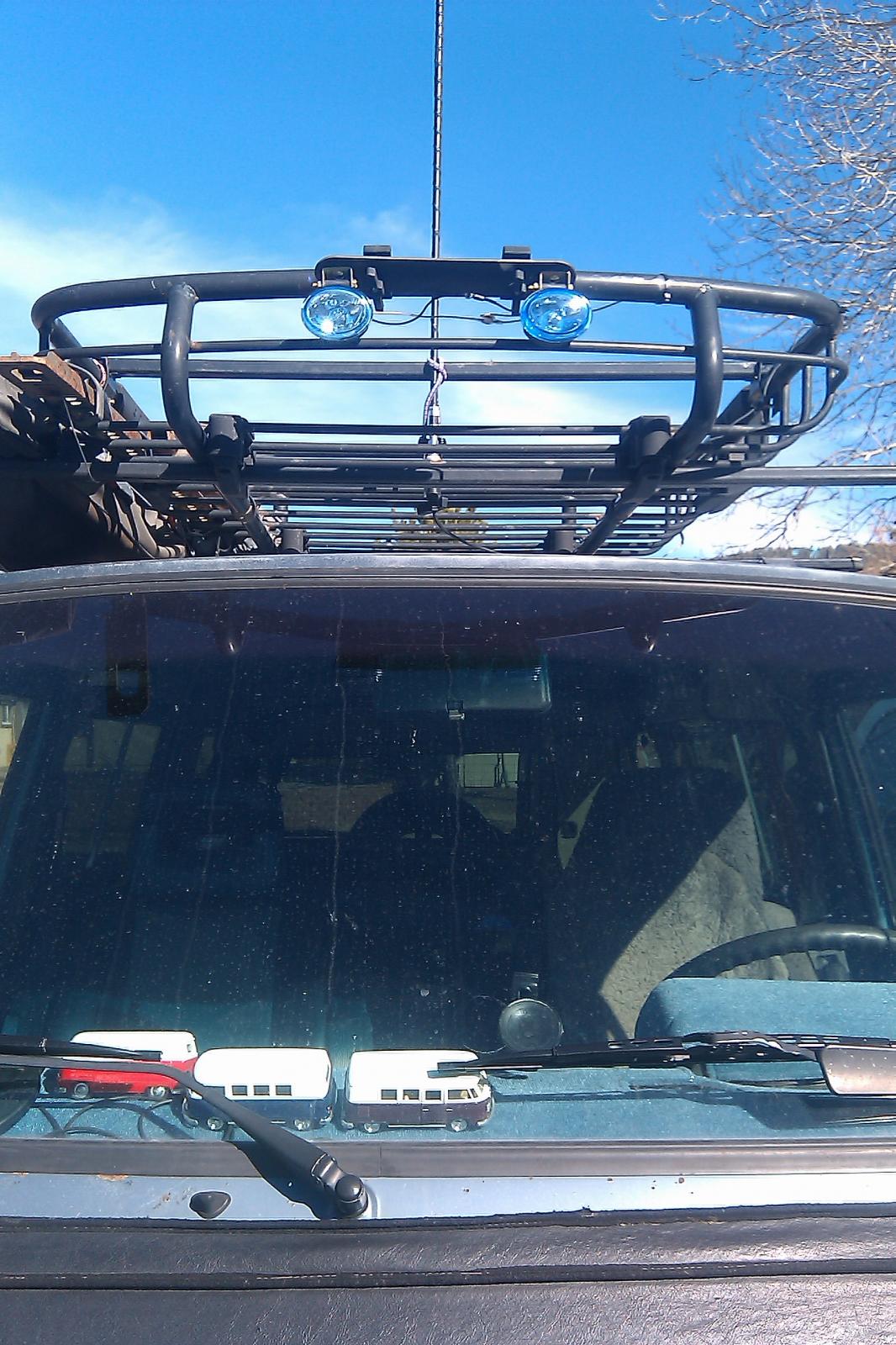

Blue Bay Bus Just a different way to mount .
I put these up high for off road use. Used a Yakima driving light mount, no holes just clamp on. The Yakima mount works great on a Thule basket. Very Happy I know someday I'll run the wires through the Thule basket tubes. Wink Had to go bigger or go home! And redo the wires to. Cool

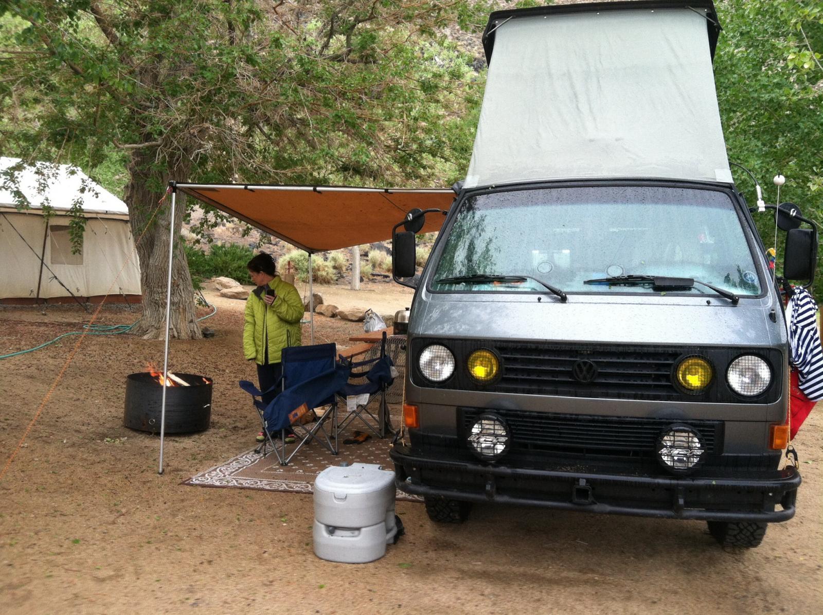

Nope, I don't drive with all lights on, but makes for a good photo. Cibié “Tango Plus” Driving and Fog Lights, with Hella Rectangular E4 conversion.
