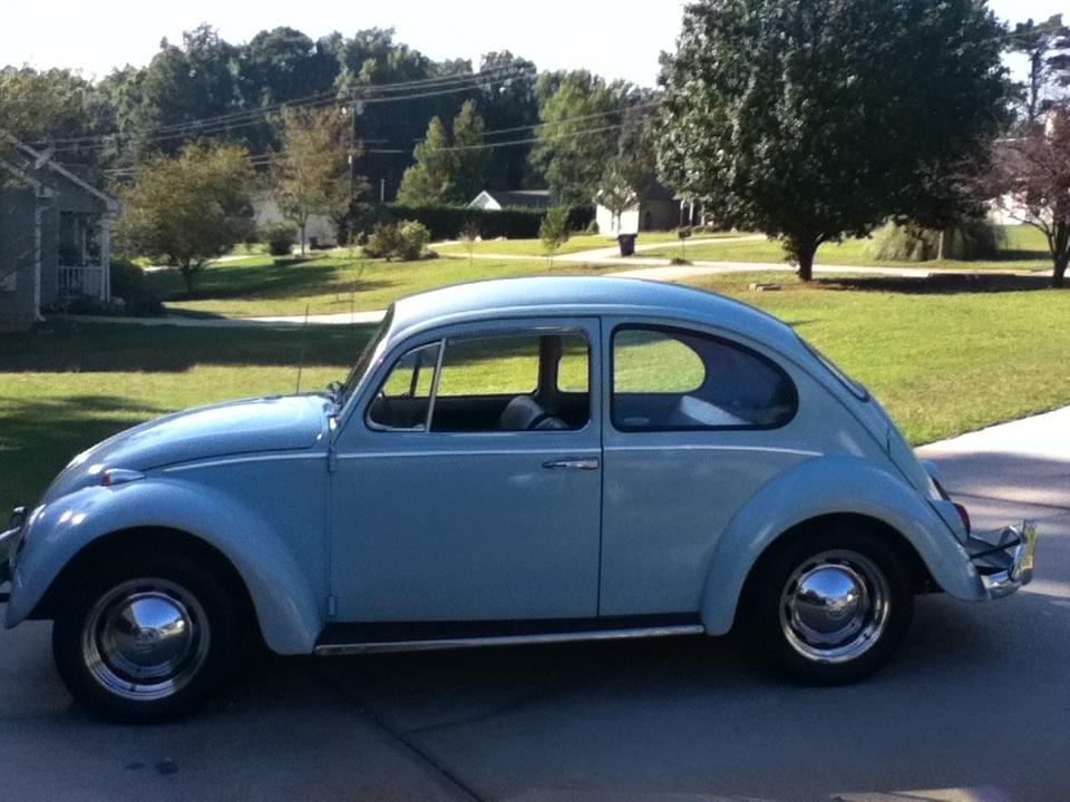

I thought I would start a thread for my bug. Seeing how it will soon be painted and worked on to bring it to show worthy condition, I can post some of the progress here when the painting process begins and the final touches are made.
Here's my car. More pics to come.
Thanks for looking. Any comments/advice are welcome.
jon65

PostPosted: Tue Nov 27, 2012 4:48 pm    Post subject: Reply with quote
sweet man! what are your plans for it? lower it? color?

PostPosted: Tue Nov 27, 2012 6:21 pm    Post subject: Reply with quote
Right now it's all about getting all of the mechanics running right. Not sure which color to paint it just yet. As of right now I'm gonna repaint it as it's original color which is a kind of sea foam green.
Yes I do plan to lower it. 2 1/2 inch drop spindles out front and maybe a little negative camber in the back. Not really radical lowering but enough to get a sweet looking ride. Twisted Evil

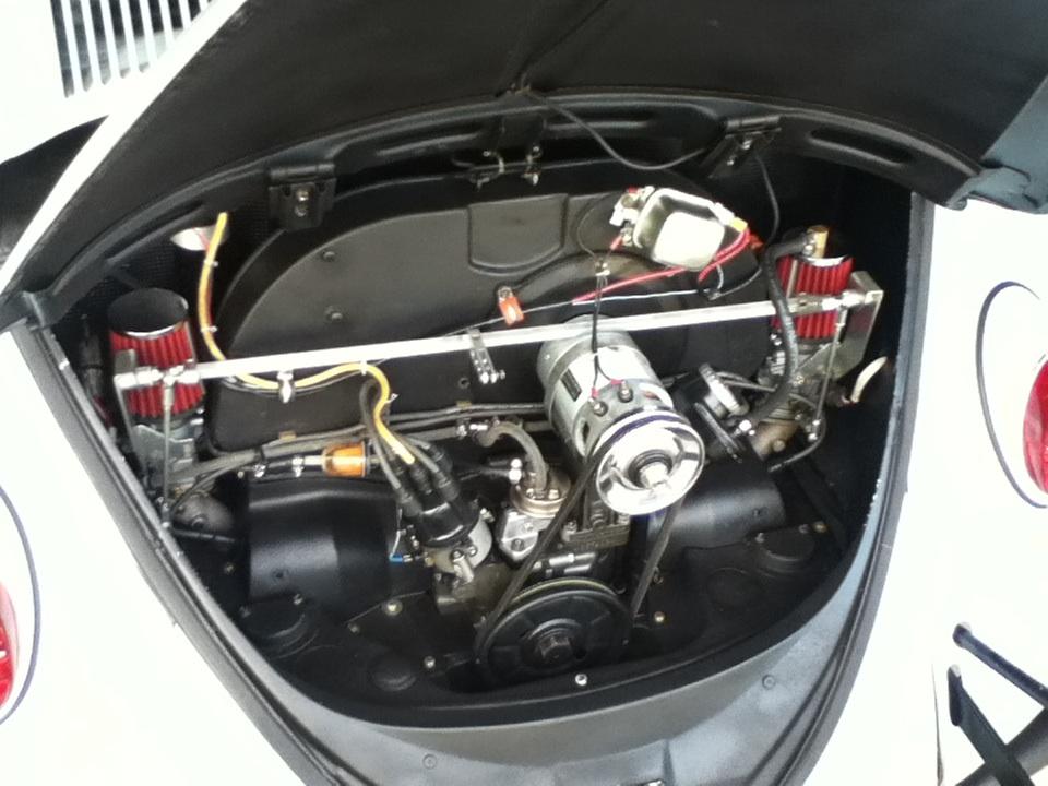

PostPosted: Tue Nov 27, 2012 6:26 pm    Post subject: Reply with quote
While I'm at it, here's the newest pic of the motor that I have. It will be different when it's out of the shop though, because it will have a single carb on it.
Here's the engine specs as of today.
Engine
1974 1600 case
Displacement: 1641 cc
Bore: 87mm
Stroke: 69mm
Carb: Dual Weber 34 ICT
Single port heads
Cam: unknown
Exhaust: EMPI Single Quietpack Extractor System
Ignition: 009; breaker point style
Transaxle: Freeway Flyer
Gear Ratio:
1st gear: 3.80
2nd gear: 2.06
3rd gear: 1.32
4th gear: 0.89
Ring and pinion (final drive ratio): 3.88
EDIT: I do realize that the generator is installed wrong, but this is an old pic and it's fixed now.

PostPosted: Tue Nov 27, 2012 7:41 pm    Post subject: Reply with quote
nice set up man! the Sea foam green color is a sweeet lookin color IMO Cool

PostPosted: Tue Nov 27, 2012 9:07 pm    Post subject: Reply with quote
The generator is installed wrong, it needs to be rotated 90* clockwise.

PostPosted: Wed Nov 28, 2012 1:51 pm    Post subject: Reply with quote
Thank you Glenn. But I belive you missed where I posted that the generator position has been fixed since the taking of this pic.

PostPosted: Wed Nov 28, 2012 4:43 pm    Post subject: Reply with quote
I did.
