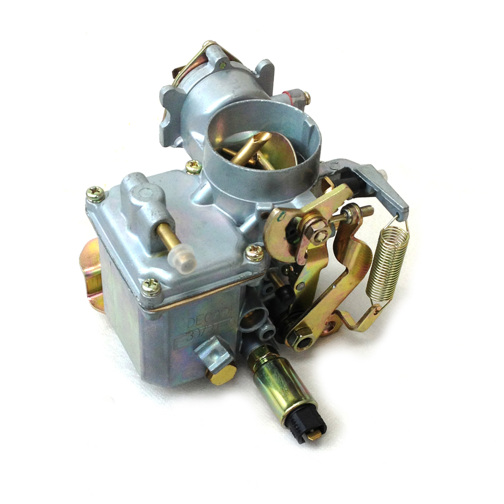

my driveway slopes down to the road at about 10-15deg. I am getting fuel in my oil when i park my 72 beetle on my driveway nose up the hill. And it is hard to start. If i park the car nose down the hill it does not leak in the oil and it starts great.
I opened the carb and blew out the inlet port, put another fuel check valve in the new EMPI carb and flushed the line before putting it back on the carb.. Gettting ready to startit up again...scared.
I'm assuming the fuel cut off valve is working because it is good nose down the hill.

You may also want to check the float height. If it is too high, it can also cause the symptoms that you describe.

when the nose is pointed down hill there is not as much gravity feed in the fuel line going back to the engine, if any. When its up hill fuel wants to continue back to the fuel pump on its own. I would be looking at the fuel pump. If the diaphragm inside is old and cracked fuel will leak through to the underside and into the crank case. Do you have one of the cheapo pumps or a rebuild able one? If rebuild able you can take it apart and check the diaphragm. If not you can pull the pump and if there is NO grease on the underside and it's relatively clean it's probably leaking gas. The pumps get packed with grease when installed.

Probably just flowing out of the bowl when parked nose up. See if the level of fuel in the bowl is too high.
