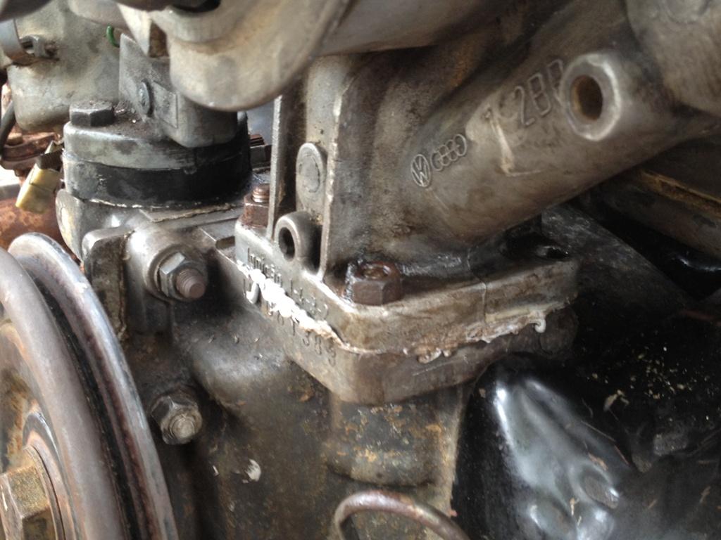

Hey,
I have broken down in Panama on my Chile to Alaska trip and I am reabuilding the top end due to a blown piston and some other stuff.
Anyways, parts are hard to come by and the only thing I could get my hands on here was some Silicone gasket paste that is NOT SUITABLE FOR HEAD GASKETS. I think because it is not resistent to Gasoline.
I have to use it anyway as I have no choice.
How far do you think I will get before I have to take the heads off again? I am hoping to make it to mexico.
Does a gasoline resistent silicone gasket paste exist in your part of the world? Maybe I can find it in Central America.
Thanks
Ben

If he had cylinder head gaskets and he takes them out, he will need to use cylinder base shims. He should also check his head volume and calculate his compression ratio. Not hard to do, all he needs is a shringe from a pharmacy.
He needs to set the timing a 28-30° BTDC at 3500+ rpm with the hoses off. Forget what the book says as that applies to new engines with all the correct non worn out parts.

Only use some gasket sealer on the base of the cylinder where it meets up the engine block. No gasket sealer is needed between the cylinder and cylinder head. If there were metal rings in there (between cylinder and head), take them out, and on the other side do the same. There may or may not be deck height shims under the cylinders between the cylinder and engine block.

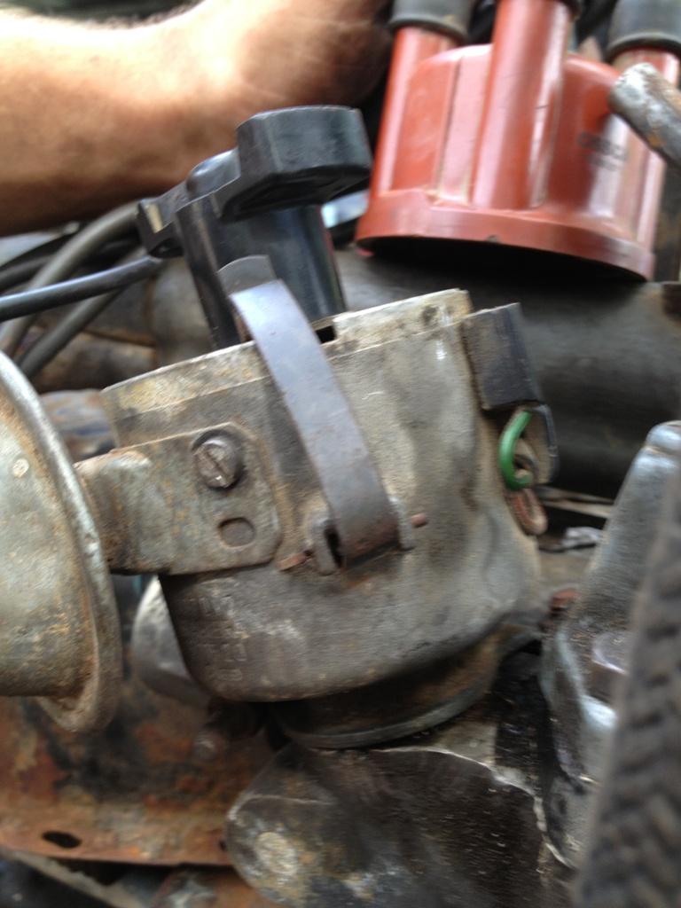

And we'll probably need an outside and inside picture with cap off to ID the distributor.
But, does it have a vacuum canister on the side? If so, does it have one or two nipples to hook up?

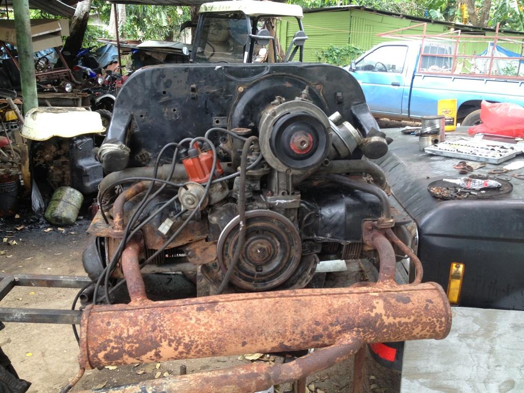

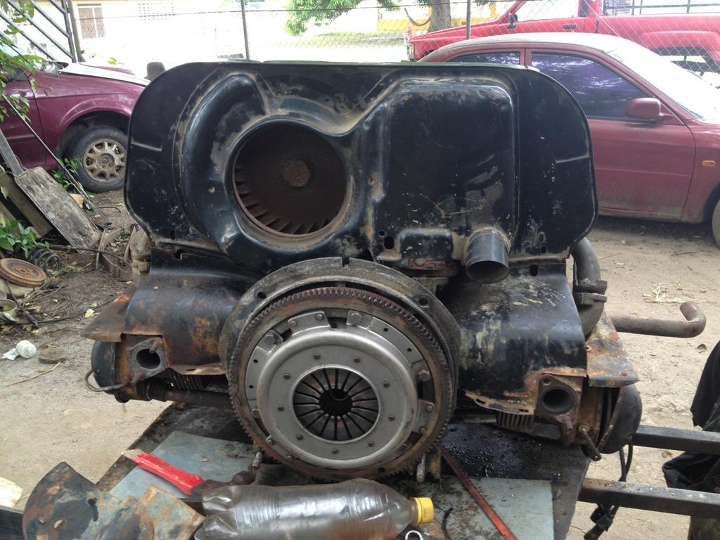

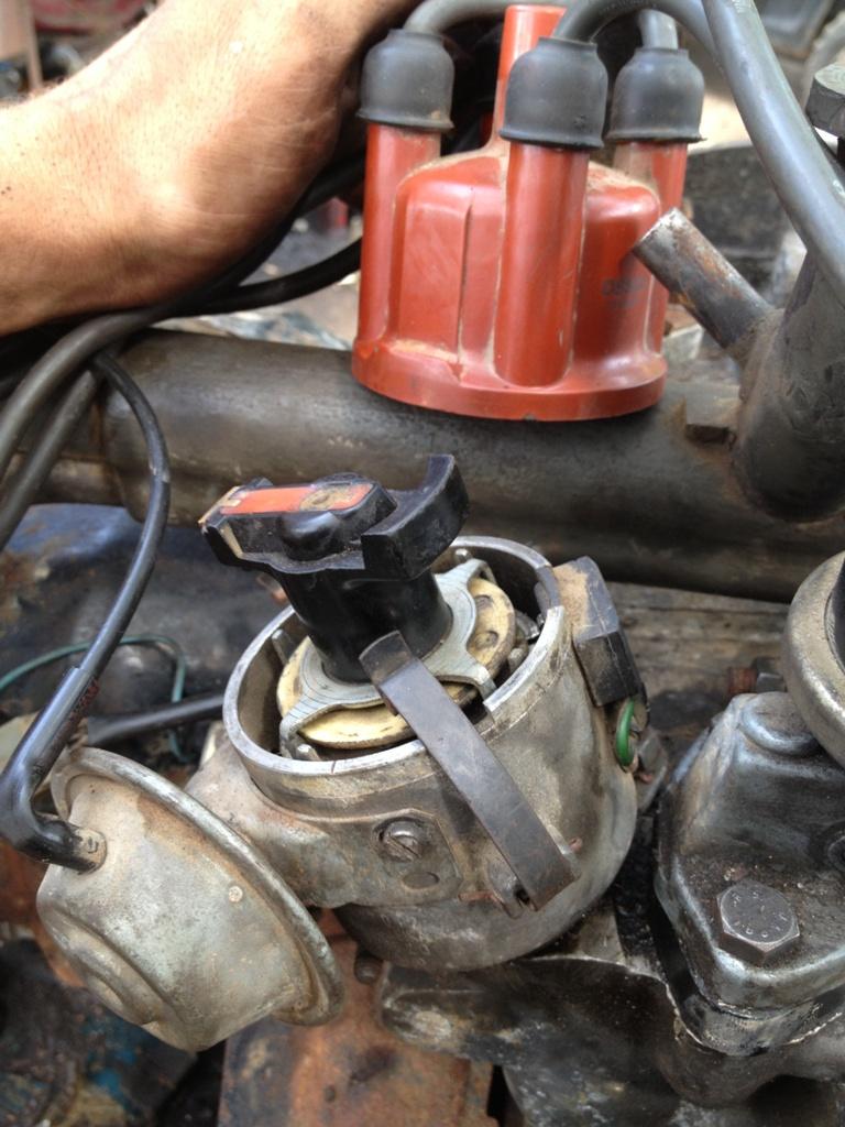

Okay, here are some pics from Ben's engine and distributor. Looks like he's almost got it back together - having some trouble with bolts going back into where they came from.
Seems like the timing will be the next big issue - need to get it right.

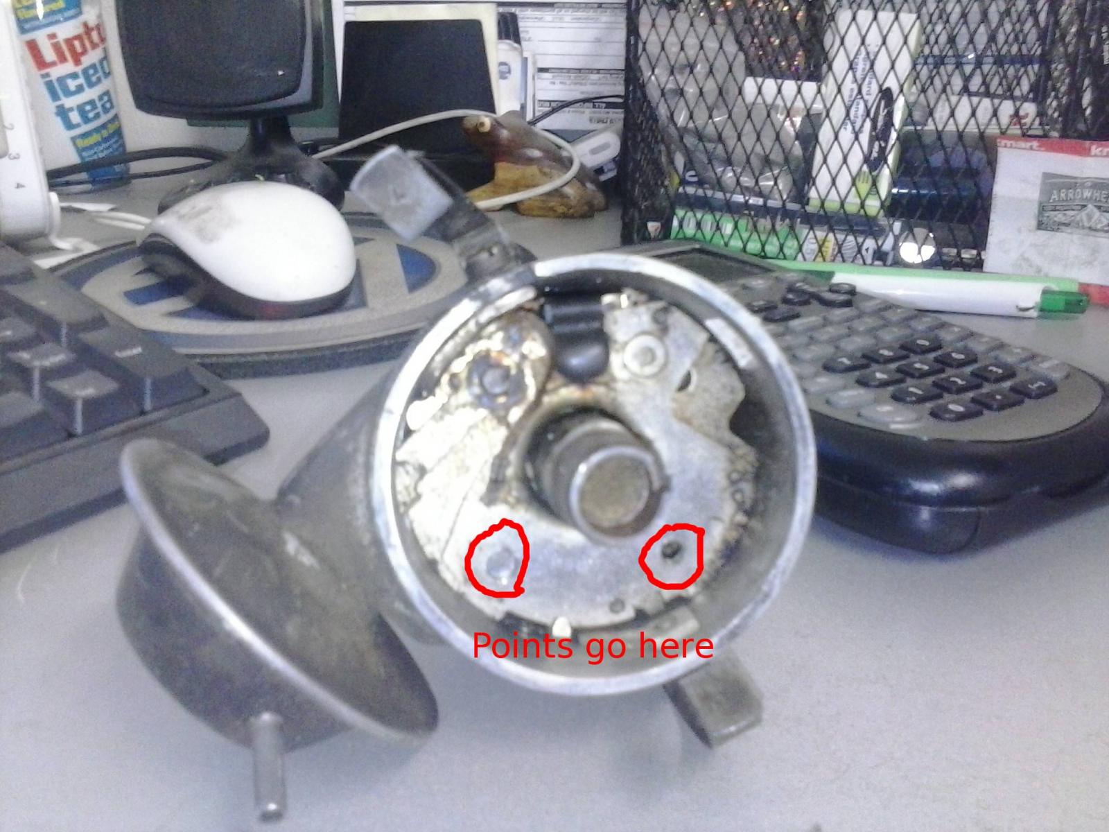

my instinct says to ditch the electronic ignition and get a points style distributor. any kind will do as long as it has points. you may be able to get a set of points which will fit in that distributor, if you remove the rotor and the electronic ignition inside.
i simply do not like the uncertainty presented with electronic ignition. points are a guaranteed mechanical entity which will present no trouble when installed and adjusted properly.
All your Buses are belong to us.
Love and good roads!
IN LOVING MEMORY OF ROB CRESS 1968-2012
View user's profile Send private message AIM Address Facebook Instagram Gallery Classifieds Feedback
Ian
Joined: August 28, 2002
Posts: 4922
Location: 713
Ian is offline
PostPosted: Thu Dec 20, 2012 2:21 pm    Post subject: Reply with quote
if you can tear your distributor down this far then you can slap in some points and a condensor and basically be on your way. the rotor will pop off by hand just give it a gentle pull and the electronic ignition should initially slip off and then have a plate that may be attached with a little screw.
part of the points sit in a little hole to be in the correct position and the screw goes in a little hole opposite it on the plate in the distributor.
don't lose the little points screw. if you use one too long it mucks up the mechanism, i see it happen from time to time.
you're probably going to need to bust out a valve adjustment real quick since the rocker and stuff has been off, so let us know about that because it's real important too.

I'm getting the impression that adding points to the mix here will result in him never leaving Panama, I say leave it as is, time it right and pick up an 043 distributor in Mexico.
If it ain't broke........

Ditto, leave it as is since evidently it has been working all this time. There is a good chance the timing was messed up and might have caused the prior piston problem. So timing needs to be set right but that's totally different than points or the electronic ignition topic.
Use the coil wire to set the initial timing as WT explained. And then a real timing light to set it at max advance once it's up and running.
It would be interesting to know the origination of that engine. A low profile fan shroud like a type-181 Thing, a not familiar engine code number, and evidently factory electronic ignition.

Agreed on changing to points - not an option at this time.
It's a Brazillian bus 1992. The carb on it is Solex (can't remember the model off the top of my head).
I think the plan is to get the engine back in the bus tomorrow, find the proper timing tools (if possible) and see what happens.
The issue here is parts - it's not like Mexico or Brazil. Some Central/South American countries are littered with bugs and buses, but not here in Panama. There simply aren't that many parts and people aren't used to air cooled engines.

Bit annoying about the gasket sealant advice I received from a local mechanic. Wish I had posted earlier as that would have saved a lot of time. FYI my cylinders were bored 5000km ago, 50% new pistons and new rings., there were no shims as stated.
