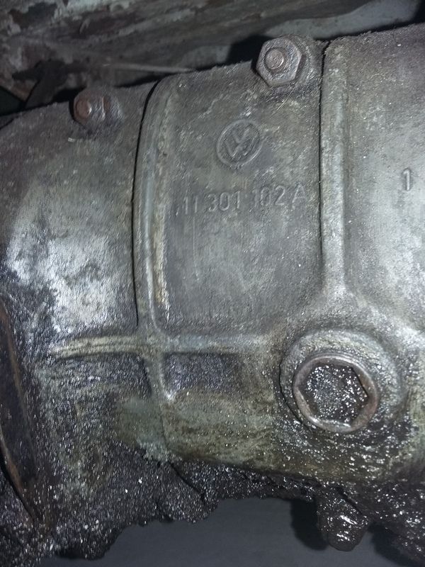

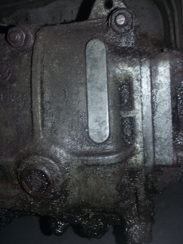

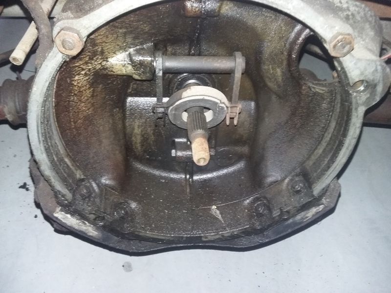

Hi,
I have this gearbox, in my 1952 Split window with part number 111 301 102 A.
I think should be a replacement gearbox, because has no number and looks like a splitcase, my question is, if can be a replacement crashbox?
Thanks

Looks like a post 1953 split case transaxle.
