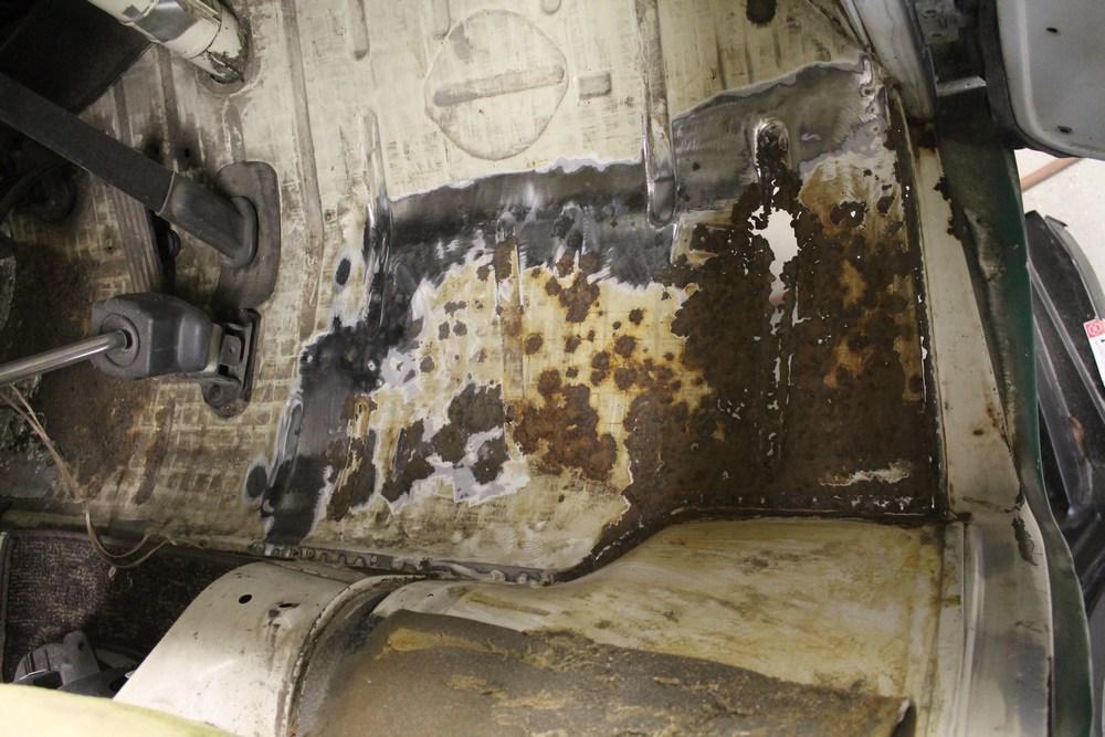

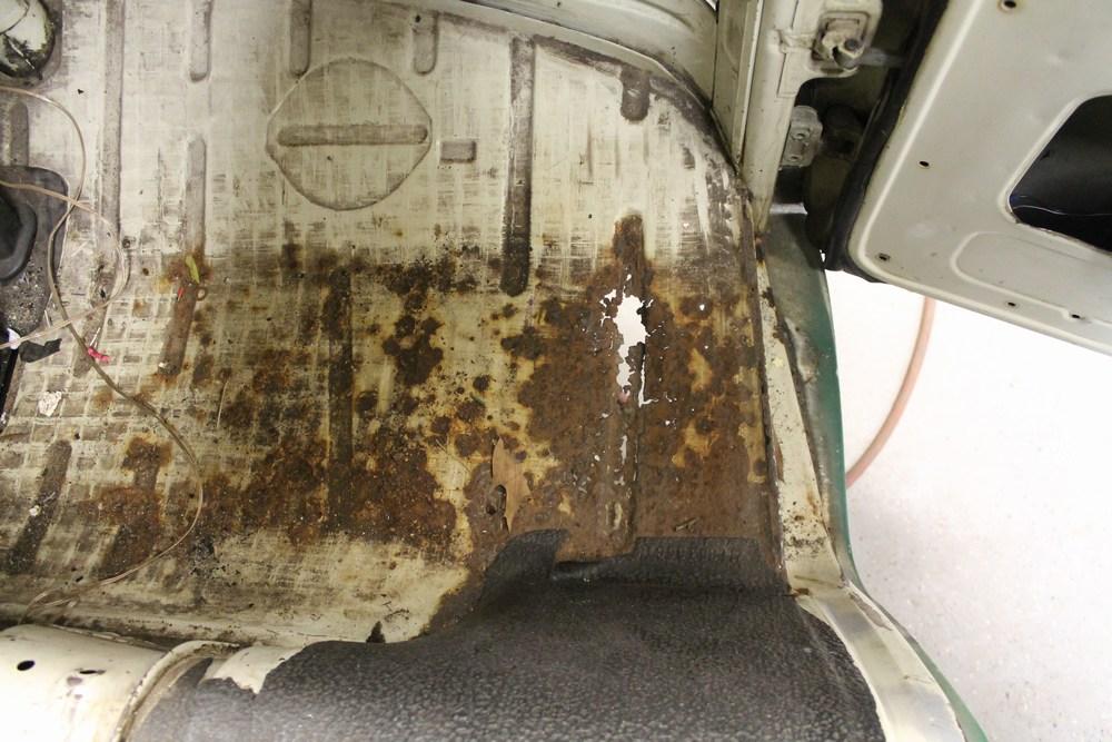

Bill dropped his 70 off for rust repairs and I got a start on it today. Its got a lot of the normal rust and quite a few dents that need to be fixed. I didn't get a chance to take a pic of the whole bus but will before I finish. Today I started to cut up the left dogleg and floor.
Looks like a small fender bender that previous owner tried to repair.
Some of the normal rust.
The floor I got cleaned up and removed in one piece to use as a template for the new panel.

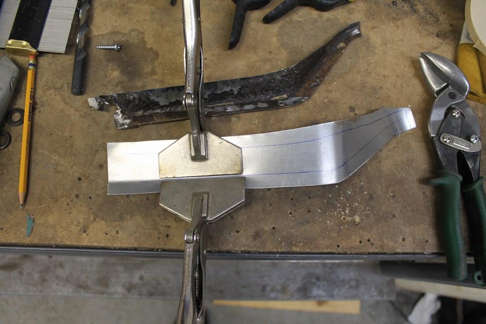

Once the floor was removed I started to cut out the rust in the wheel well.
I used some 1/2" tape to mark my cut line just above the rust.
Once the piece was removed I used it as a template to make a new panel from 20 gauge metal. I first made a few marks where the shape needs to be and used some tubing to roll the metal over.
I traced the rusted piece and used the 1/2" tape to transfer the lip that holds the floor.
I don't have a bead roll with a tipping die at home so out comes the duckbills.
I used my small duckbills around the rolled areas. Doing this tends to flatten out the shape so a little shaping with the shrinker/stretcher is needed.
Again not having a beadroll to make the steps on the end I had to resort to hand tools. I saw this chisel trick on a metal shaping site and it worked great. Make sure your chisel is blunt and take your time working both sides. A little smoothing with the hammer and dolly and the panel is ready for fitting.

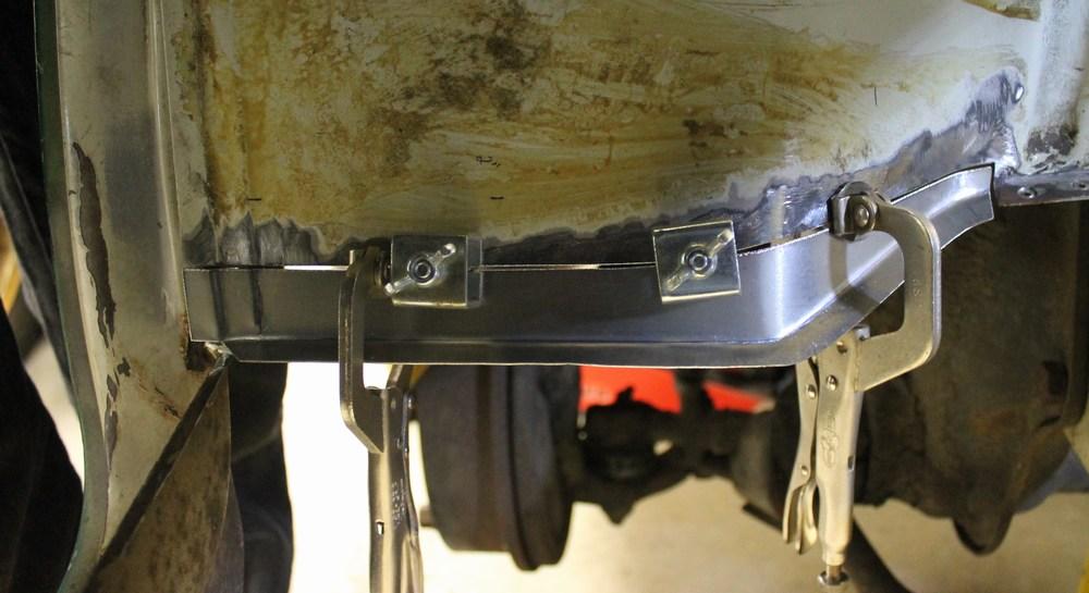

After some fitting the panel is ready to weld. I made some reference marks before cutting to get the height right and double checked with the straight edge.
Taking my time welding and grinding a couple times during the welding for a rust free wheel well ready for the floor.

wrstp wrote:
Forgive my metal working ignorance but what is at the top of the panel you made shown here? Looks like something to hold up the panel...

PostPosted: Tue Feb 05, 2013 8:18 pm    Post subject: Reply with quote
It's a Cleco - a small spring-loaded clamp.
http://www.righttoolusa.com/p/25-Pc-1-8-Cleco-Fast...PAodsngAVQ
