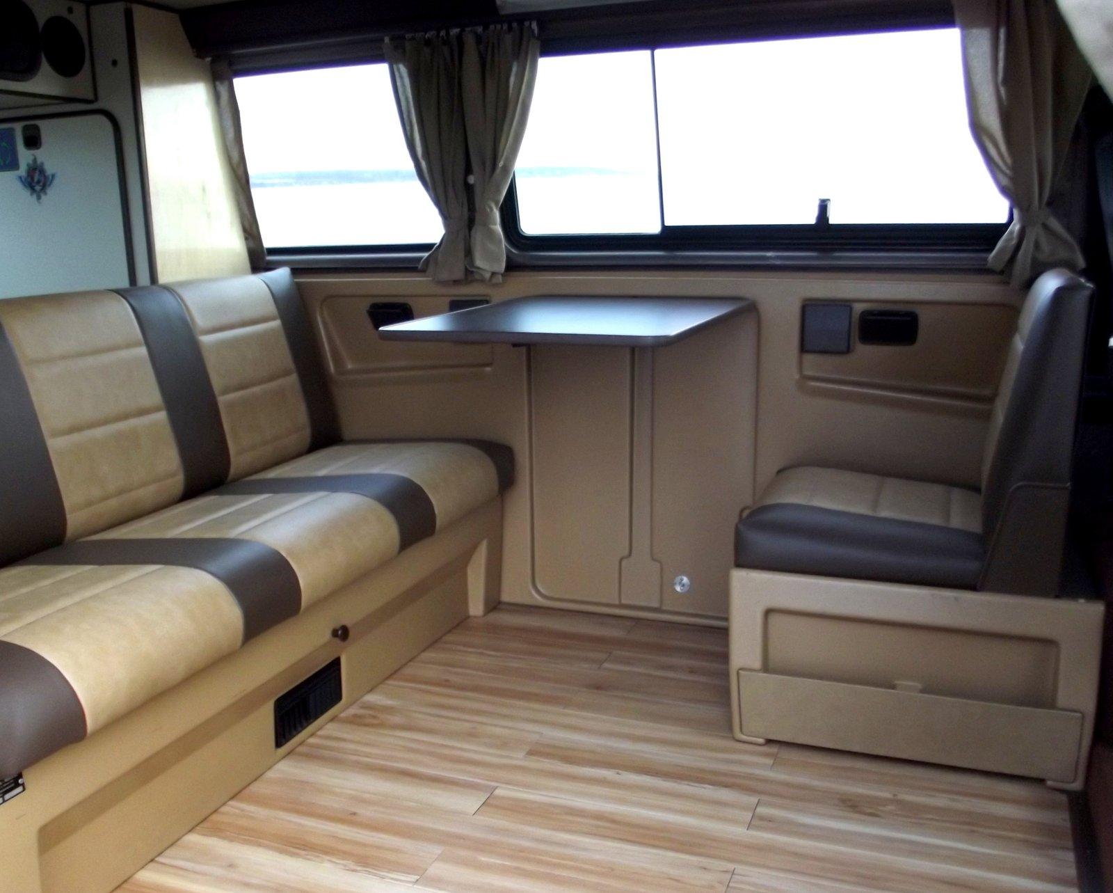

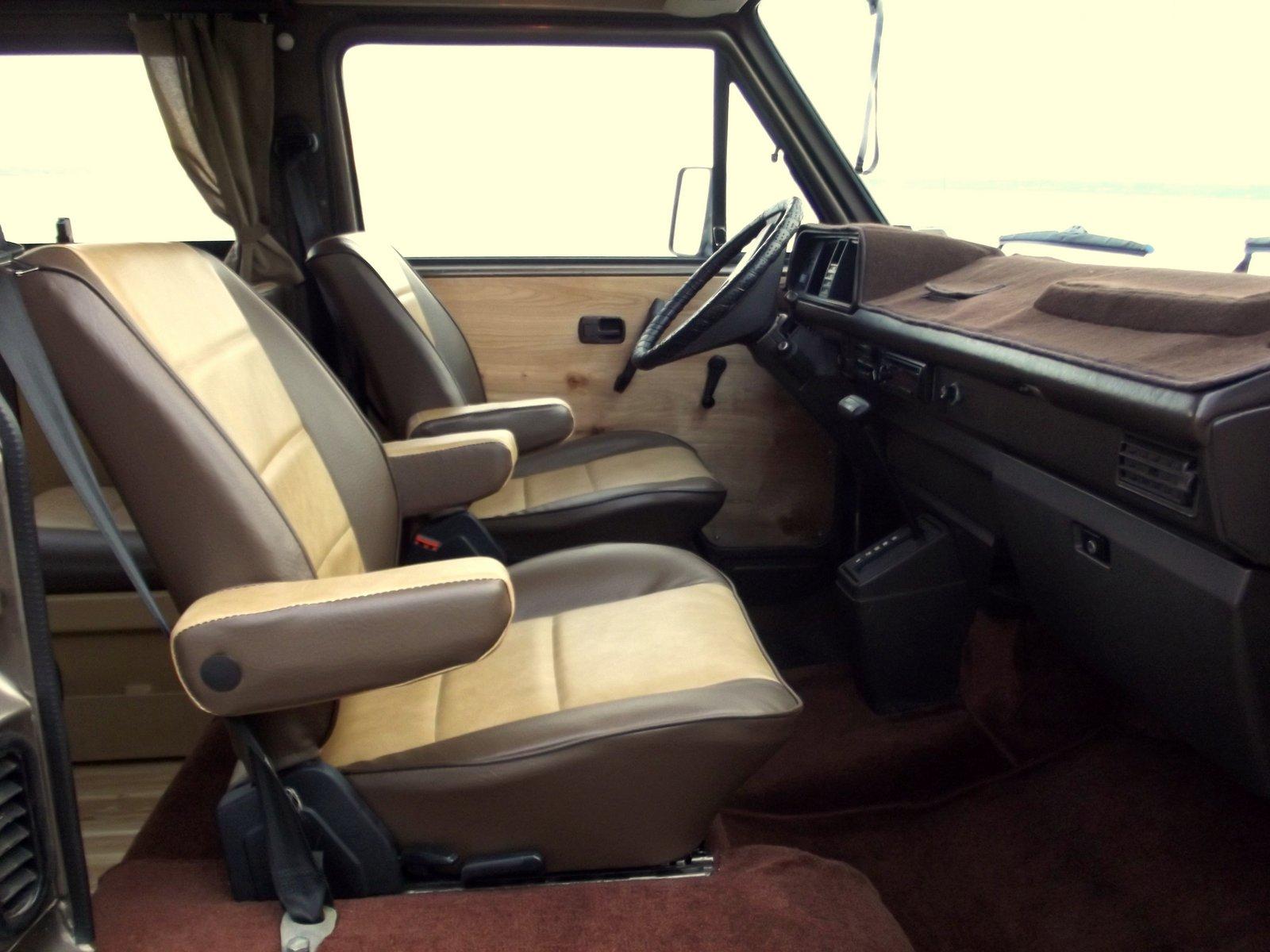

Greetings, I am looking for some ideas on ways to increase the seating capacity in my vanagon. Primarily the area behind the front passenger seat. I am having a hard time coming up with anything that jives with the plastic molded interior. My initial thought was finding another matching jump seat, this proved to be quite expensive and hard to find. Now I need to get creative... I know you guys have some great ideas, pictures will help a lot.

I love your interior. The seat cover inserts and hardwood looks fantastic! Guess this really doesnt help.

A rear facing fold up jump seat covered to match your very nice seats would be an option.

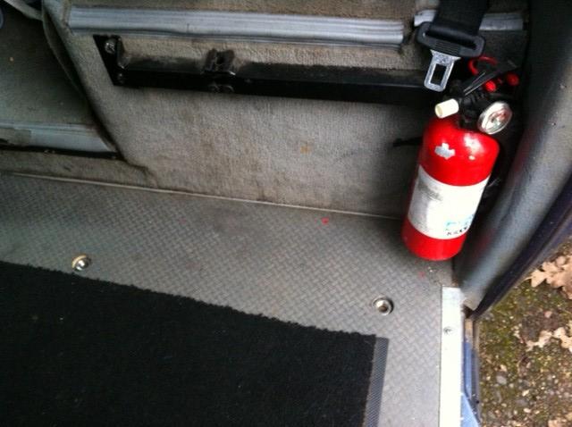

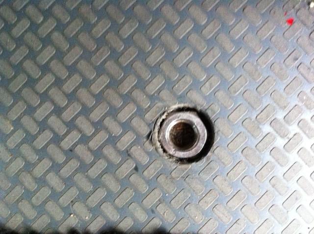

I did not have to weld or cut anything to install a stock jumpseat in my Westy. Drill 4 holes for the mounting bracket on the passenger side pedestal and 2 countersink holes down to the metal on the floor for the JB Welded nuts to anchor the legs, and it was done. Alignment and measuring took all the time but that would be true, regardless. Your custom upholstery looks good.

She's so pretty! I love the interior and the flooring. Will you have the expanded jump/bench seat with the same stitching? She sure is gorgeous all around!

I agree to the stock vanagon jumpseat, but you may be able to make one in wood similiar to your DS jumpseat.

Thanks for the compliments and ideas!
I have seen that thread in my late night searches for ideas and love the look of the matching seats. Like he also mentioned; very hard to find for a reasonable price if at all.

Singler3360: Could you by any chance elaborate a touch more on this? JB Weld and duct tape, I have become quite a master of these fine instruments. Pictures would be great as I have never had a chance to inspect one of these seats in person.

Winewagen I have pictures of my jump seat install in my gallery. Also have pictures of the JB weld floor anchors. Have a look I may also have a source for a jump seat like the ones in the photo.

I will take a pic of the floor anchors when I get home later today/tonight.

Forgot to come back and post pics. You can see the lap belt that came with the jumpseat, but I suggest getting the 3-point seat belt at GW at the same time you install the seat bracket, etc...
Up close. Can't remember the size of the SS nuts but I know it's mentioned in another thread. The floor and subflooring came out in one plug, IIRC, using a standard drill bit. Then I went back in with a grinder tip and scuffed up the metal so the JB Weld would adhere better.
