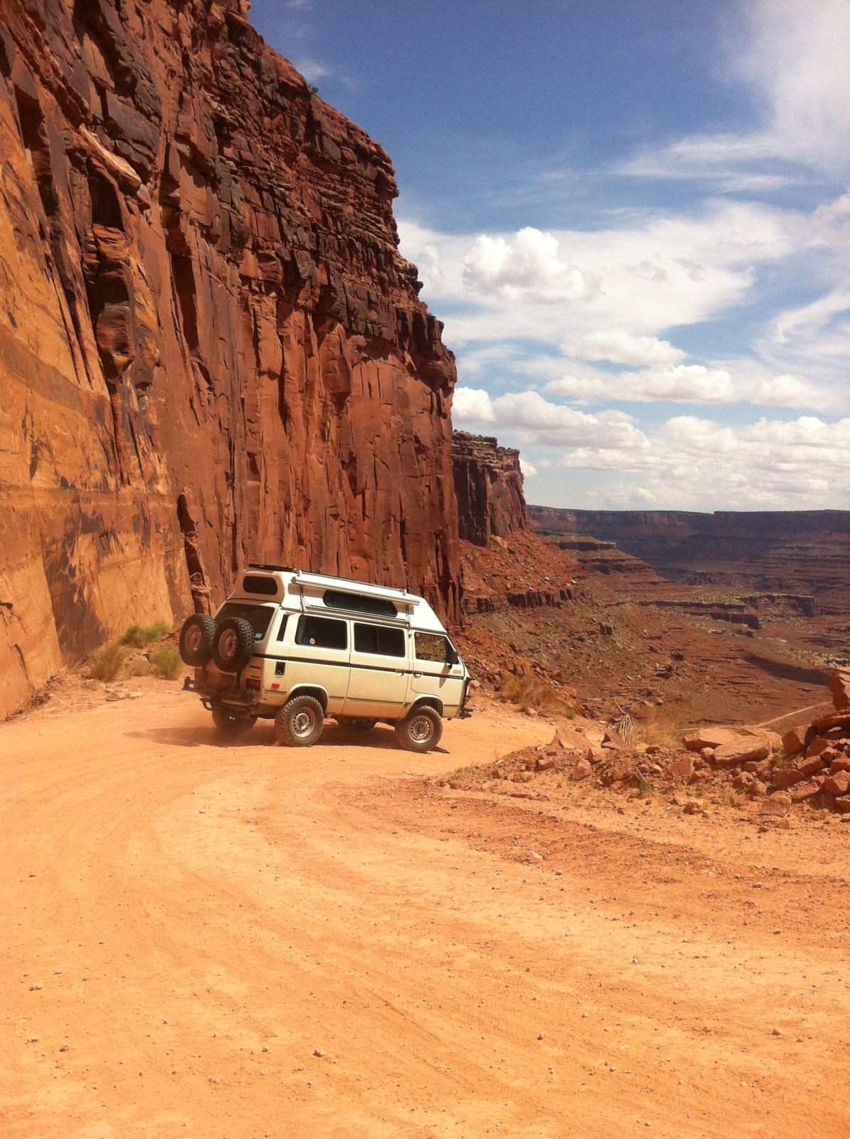

The solution is simple......swing out tire carrier for the other side!
Two spares. TEN gallons of gas, as 5 doesn't get you very far....
I've got some spare jerry cans if you'd like to borrow them. Heck, i've got one you can HAVE!
Otherwise, just stick the spare over the luggage rack and strap it down. It's been done plenty of times. No magic rack needed.
I would be carrying two spare tires for several reasons. First, it's a syncro so you need some tires with the same tread wear. Second, the tire you have is far from a common size/model to find in the great North, and buying 5 new ones will really suck....

PostPosted: Tue Jun 04, 2013 9:50 pm    Post subject: Reply with quote
But dual spares look. so. awesome...

I was thinking about this too. I have a decoupler, so can move the second spare to the front end if needed. I was thinking that if I could buy or borrow any sort of wheel and tire combination that fits the bolt pattern and is close to the overall wheel and tire height I’d think that would be ok for low speed driving for a limited time.
