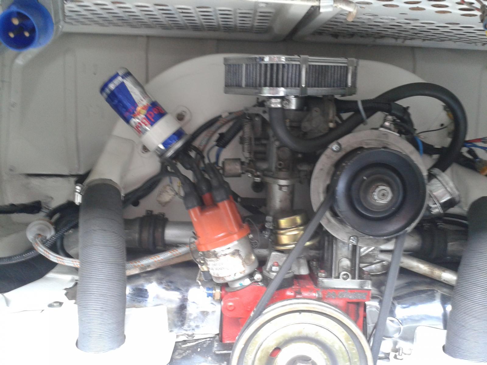

PostPosted: Sat Jun 22, 2013 2:15 pm    Post subject: Reply with quote
We need some photots of how yours is set up.
In the USA, the 74s came with something like this canister mounted on the firewall...

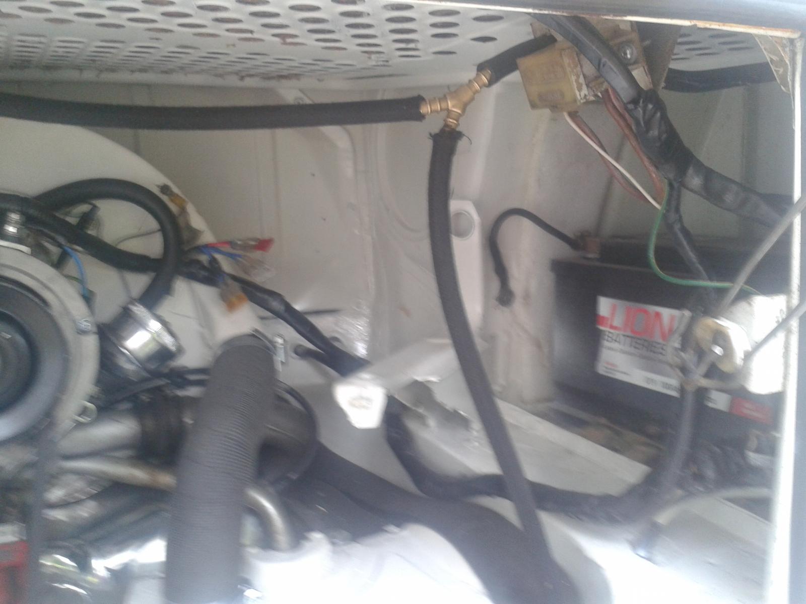

PostPosted: Sun Jun 23, 2013 7:20 am    Post subject: Reply with quote
Hi, here are some pictures hope that is what you needed I do not have the evaporated fuel charcoal canister like the photo you sent just the same system that you sent highlighting the blue red and green hoses. In the second photo I have linked the breather pipes together with a Y shaped fitting and will pass this to the outside of the van in the hope any fumes will not get in the cabin again, does this make sense?

PostPosted: Thu Jun 27, 2013 5:55 pm    Post subject: Reply with quote
I have a 77 Westy and the same issue...occasional overwhelming gas smell in vehicle.
I have the aux battery, so should I remove that and feel for the "#24" hose condition? I would love a pic of exactly where to stick my hand Razz Is it possible to change this with the engine in place?
Also, I have the charcoal canister on the firewall. Is that a possible source?

Randy in Maine
Joined: August 03, 2003
Posts: 34890
Location: The Beach
Randy in Maine is offline
PostPosted: Thu Jun 27, 2013 6:40 pm    Post subject: Reply with quote
Reach over the aux battery location up toward the side vent just behind the spare tire well. You can reach it about 15" up there or so. Feel around.

PostPosted: Thu Jun 27, 2013 6:41 pm    Post subject: Reply with quote
The red hose isn't hard to get at if you remove the tail light, a mirror ontop of the battery on a 45 degree angle and a light will let you peek. The canister is designed to eliminate all the stink so there's likely a leak in one of the many hoses leading to it from the tank, there's a small possibility the charcoal is dead but you wouldn't smell anything while driving if that's the case.
